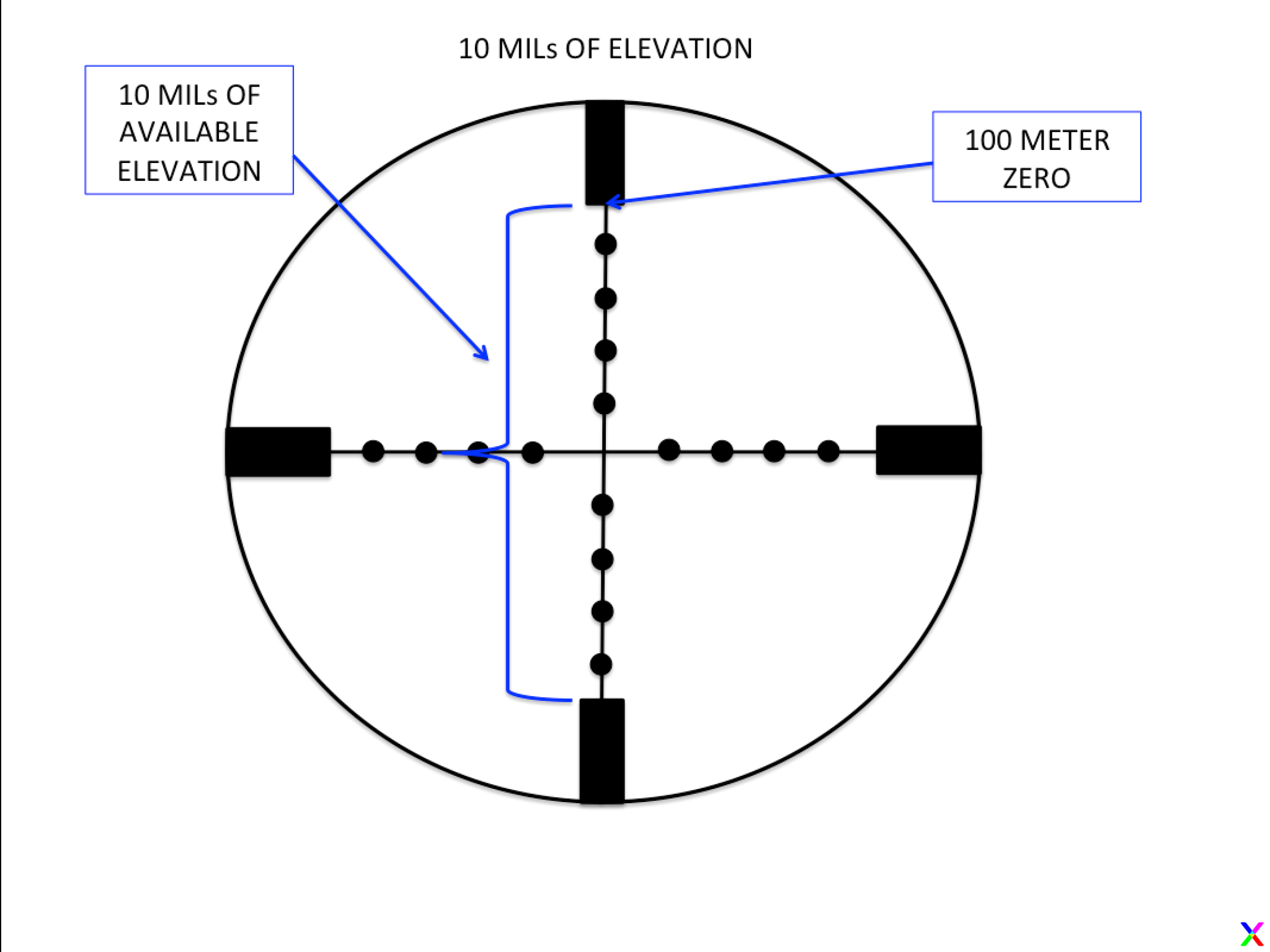

I learned some time ago that if you adjust your 100 meter zero you may actually obtain 10 MILs of available elevation.
Please see the attached visual aid:
-Krieger

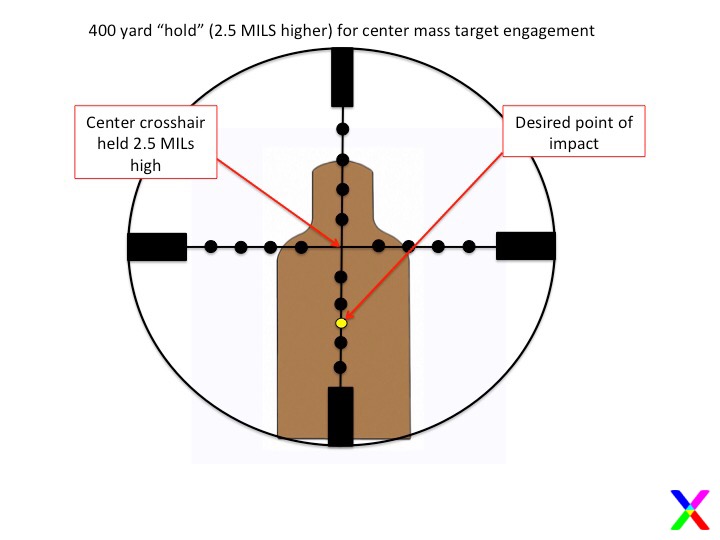

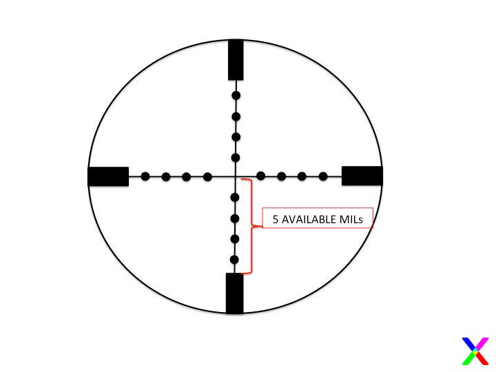

The application of this data would be thus: The rifle is zero’d at 100 yards. A target (as so deemed) presents itself at 400 yards. There are no winds to be calculated. The “hold” in MILs to engage a 400 yard target (with a 100 yard zero) is 2.5 MILs.
In order to engage a center mass or point of desired impact hit, the marksman would then “hold” (raise) the center cross-hair 2.5 MILs above the desired point of impact
NOT ENOUGH MILS AVAILABLE
Since there are only 5 measurable MILs from the center line to the thick black bar at either end of the cross-hairs of the reticle this process can be utilized to engage a target that is 600 yards away or less as any target farther away than 600 yards requires a hold of more than 5 MILs.

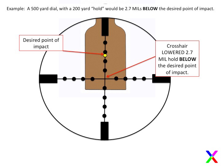

ADJUST FOR THIS SHORTCOMING
In order to compensate for this shortcoming:
1. READJUST the dialed on range to 500 yards. 500 yards then becomes the Point of Aim / Point of Impact.
2. RECALCULATE the holds in MILs from:
A. 500 yards to 100 yards
B. 500 yards to 1000 yards
Example holds with a DIALED ON RANGE of 500 yards.
YARDS / MIL HOLDS
100 / 3.4 UNDER
200 / 2.7 UNDER
300 / 1.9 UNDER
400 / 1.0 UNDER
500 / POA/POI
600 / 1.1 OVER
700 / 2.3 OVER
800 / 3.7 OVER
900 / 5.2 OVER
1000 / 6.8 OVER

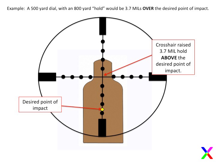

EXAMPLE
The marksman sees two targets.
The first target appears at a range of 200 yards away.
The second target appears at 800 yards away.
The marksman desires to engage BOTH targets.
Using the data above the marksman, in order to engage the target at 200 yards would “hold” 2.7 MILs UNDER the desired point of impact and engage the target:
Then, in order to engage the target at 800 yards away, the marksman would hold at 3.7 MILs OVER the desired point of impact on the 2nd target:

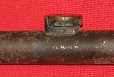

I have a question.
On the cover of this book it looks like the butt pad is on upside down.
Could you explain why?
