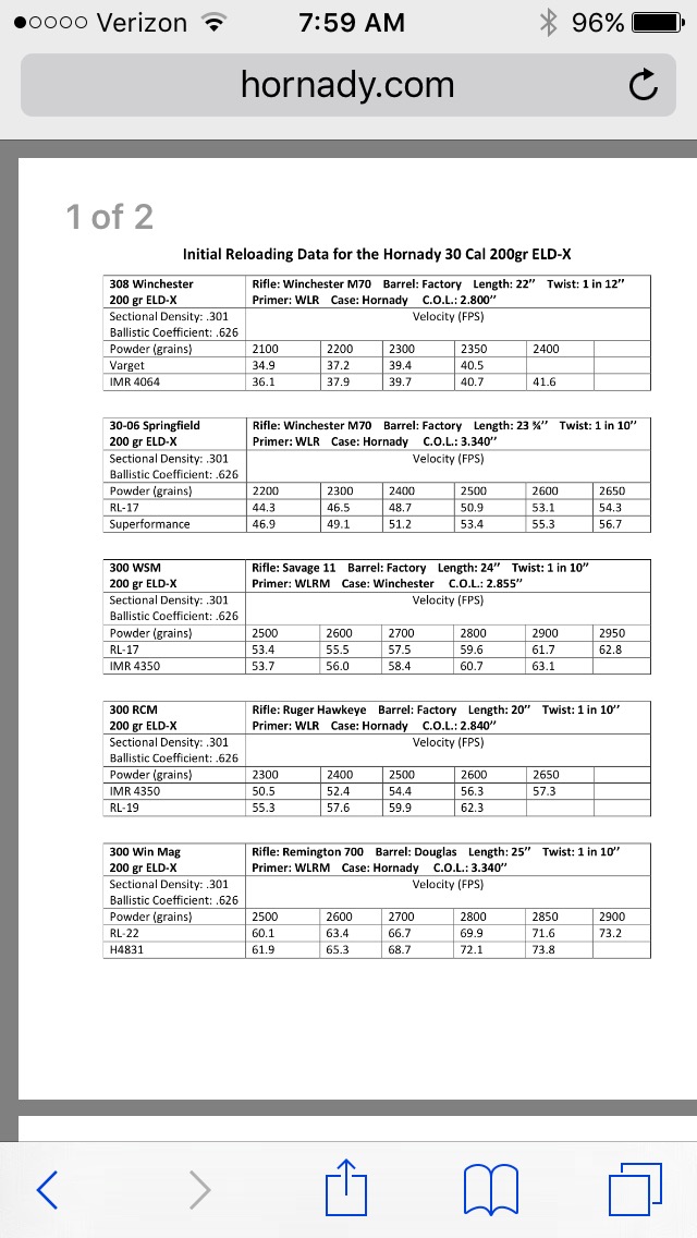

Anyone have a recommendation for a load start and max for H4831sc and 178ELD-X Hornady. New nosler brass and win primers. The rifle is a win fw SS . I haven't been able to find load data for this combination. Thank you for your consideration. .010 jammed in half grain increments. Thank you for your consideration.
Well mine is a 300 win mag and I load 75 gr of h4831 sc and 180 gr xbt at 3.345 - I get 3010 fps out of a 26" barrel,Winchester primers, Nosler brass.
