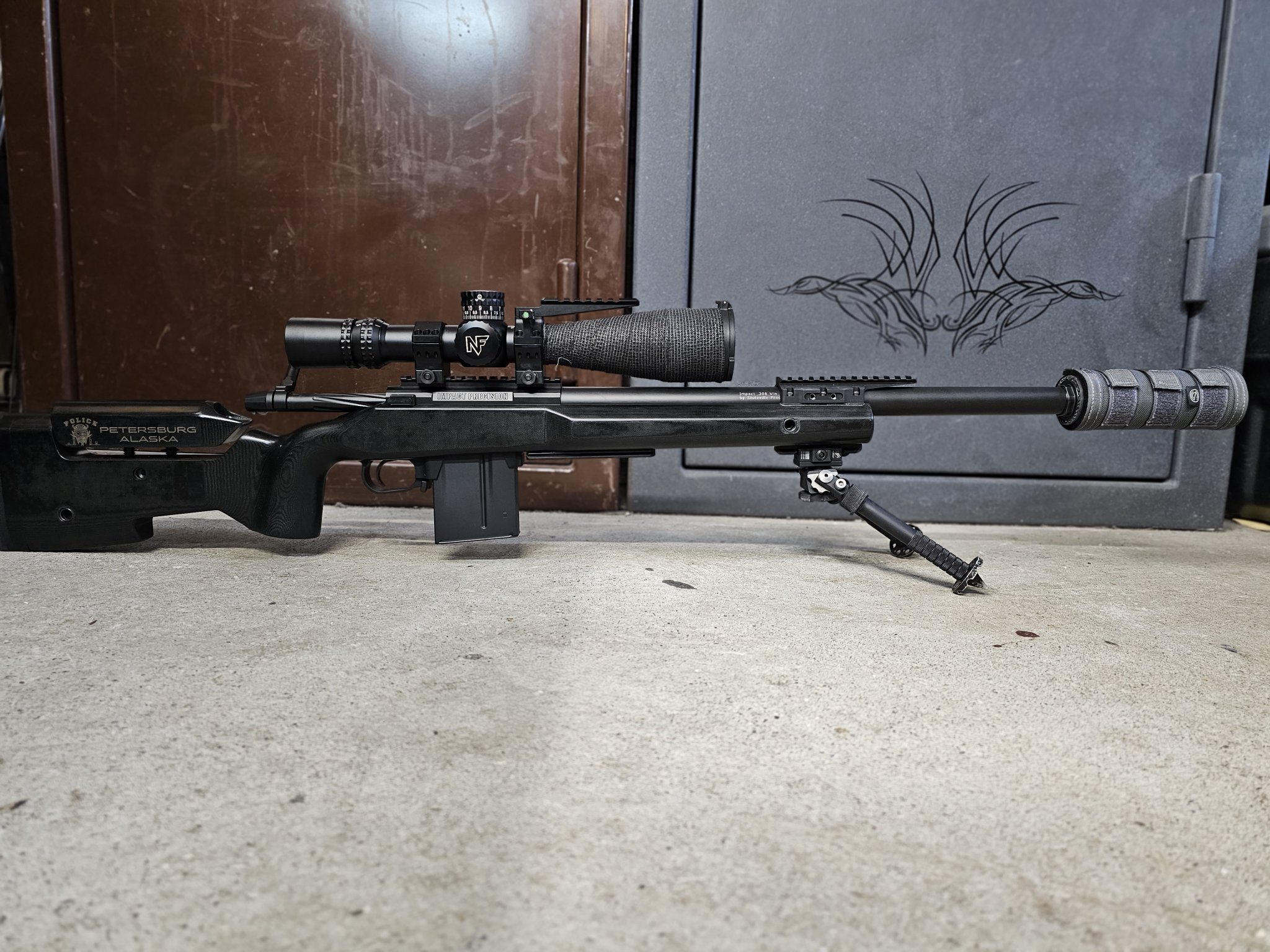

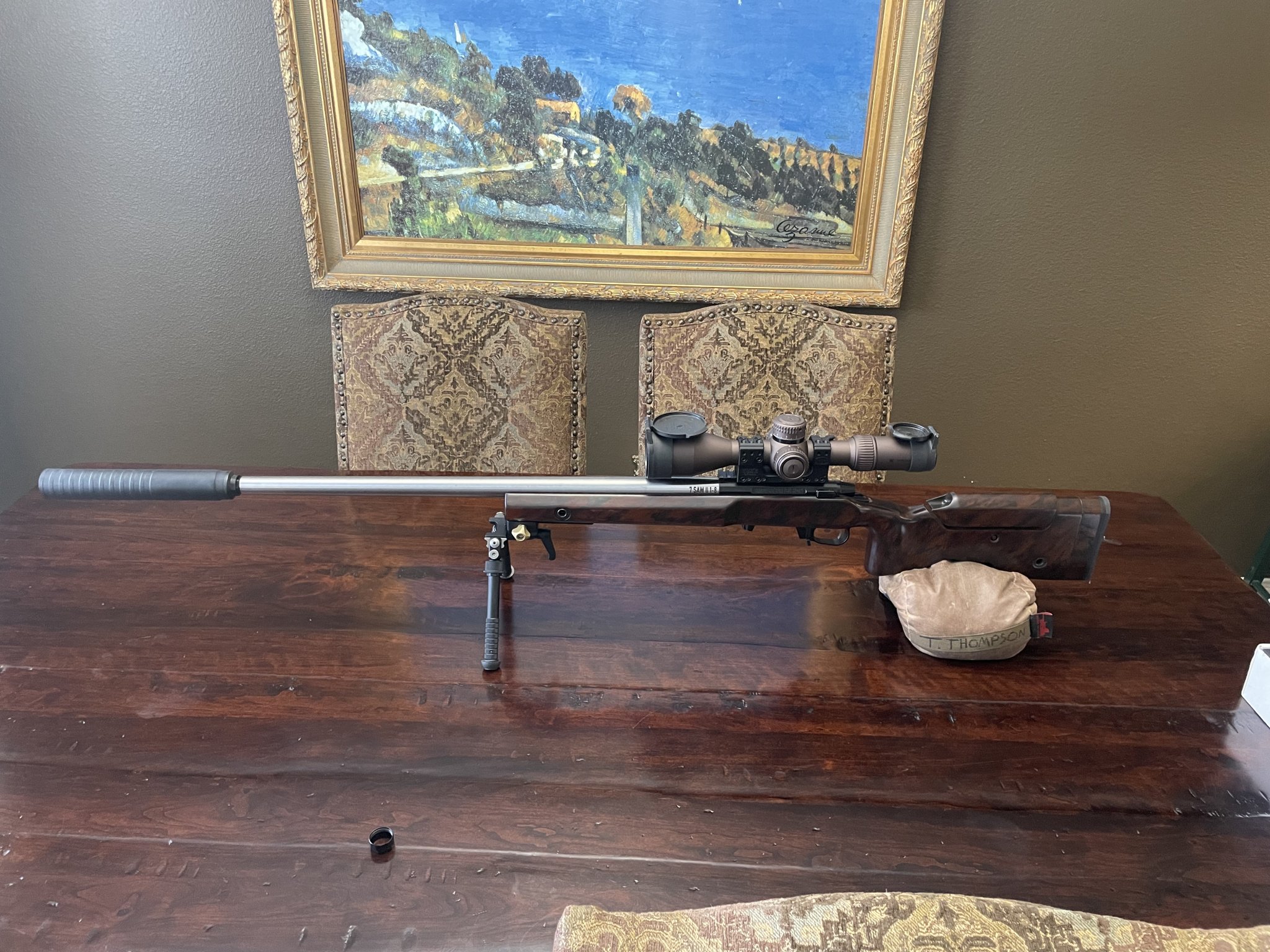

Front heavy with no weights! Straight tapper hawk hill barrel 26”
That makes no sense unless you have lw foundation which just hogs out cheekpiece
Iw foundation? It’s a geniuses stock with Sikes clutch milled in one side up front that probably added a little. I have no weights on the insides in fore end and it’s very front heavy. The stock is a special edition black. without the scope mounted it weighs 20lbs

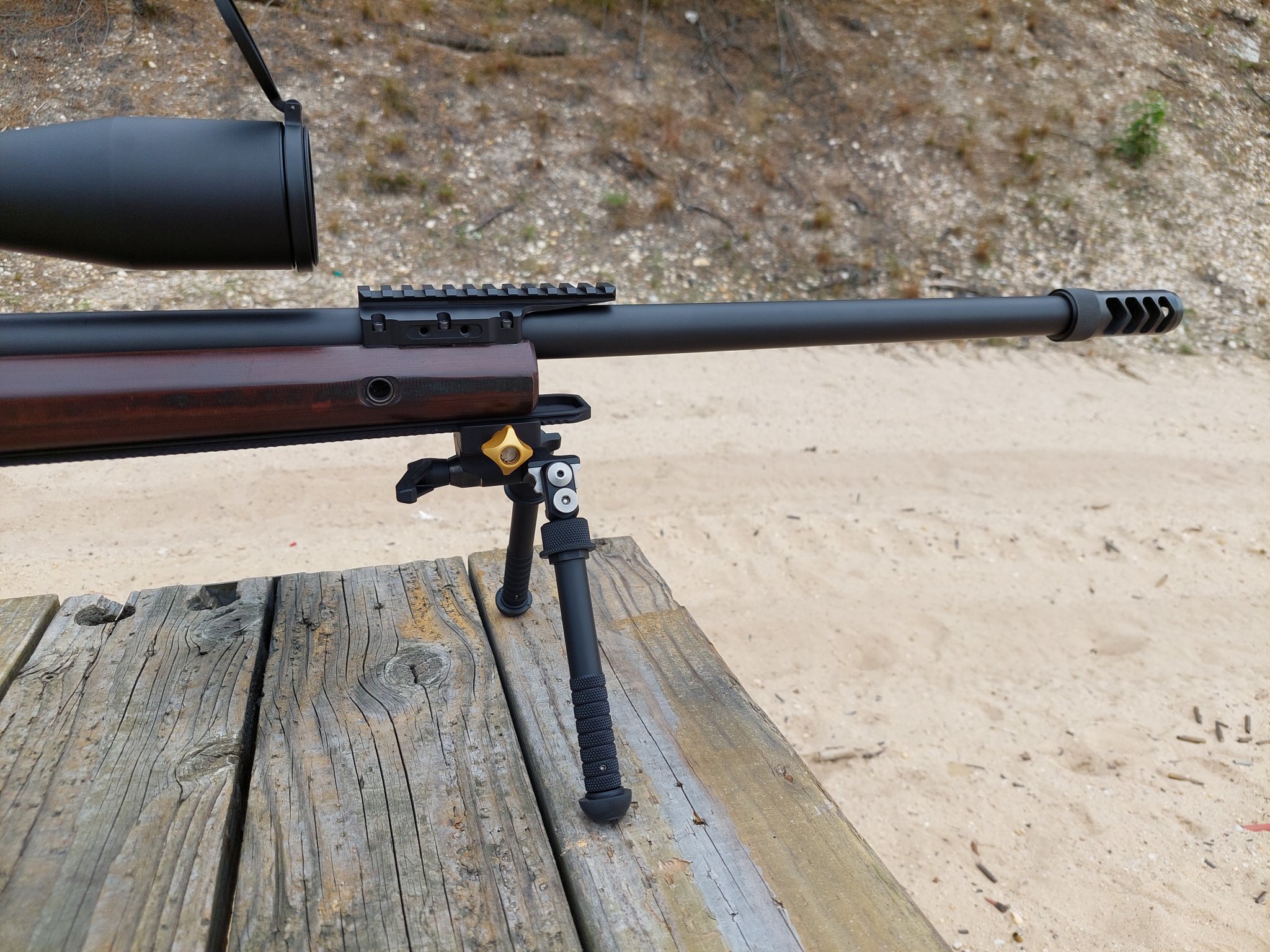

I have a 26” straight hawk hill. And my scope is mounted it’s a vortex. I have a Sikes clutch milled into one side and no weights up front right now. I mounted a Area419 barricade stop right infront the magazine on my arca rail. I figured the balance point needed to be right infront of that point. It’s abt 4”-5” infront of that

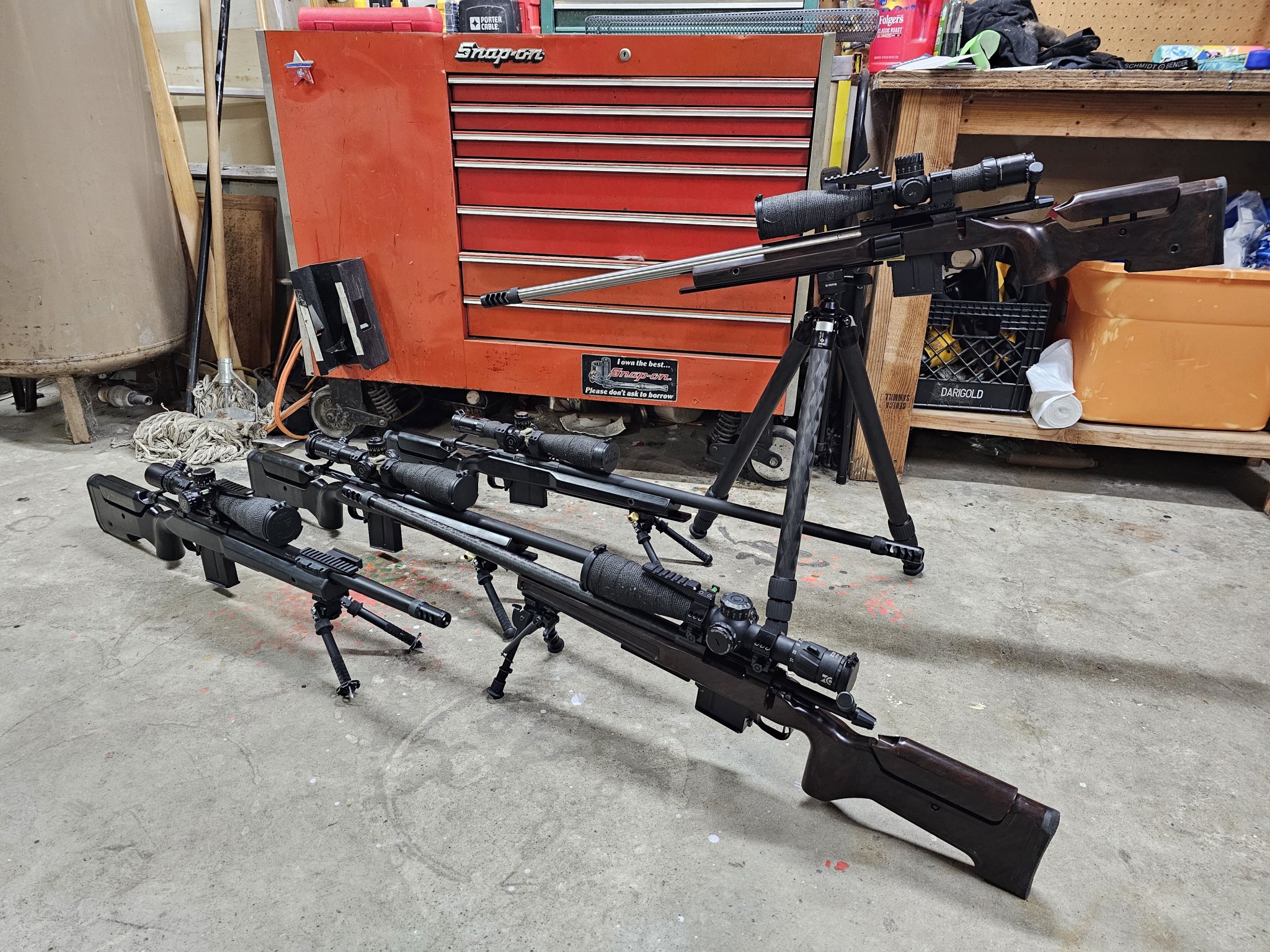

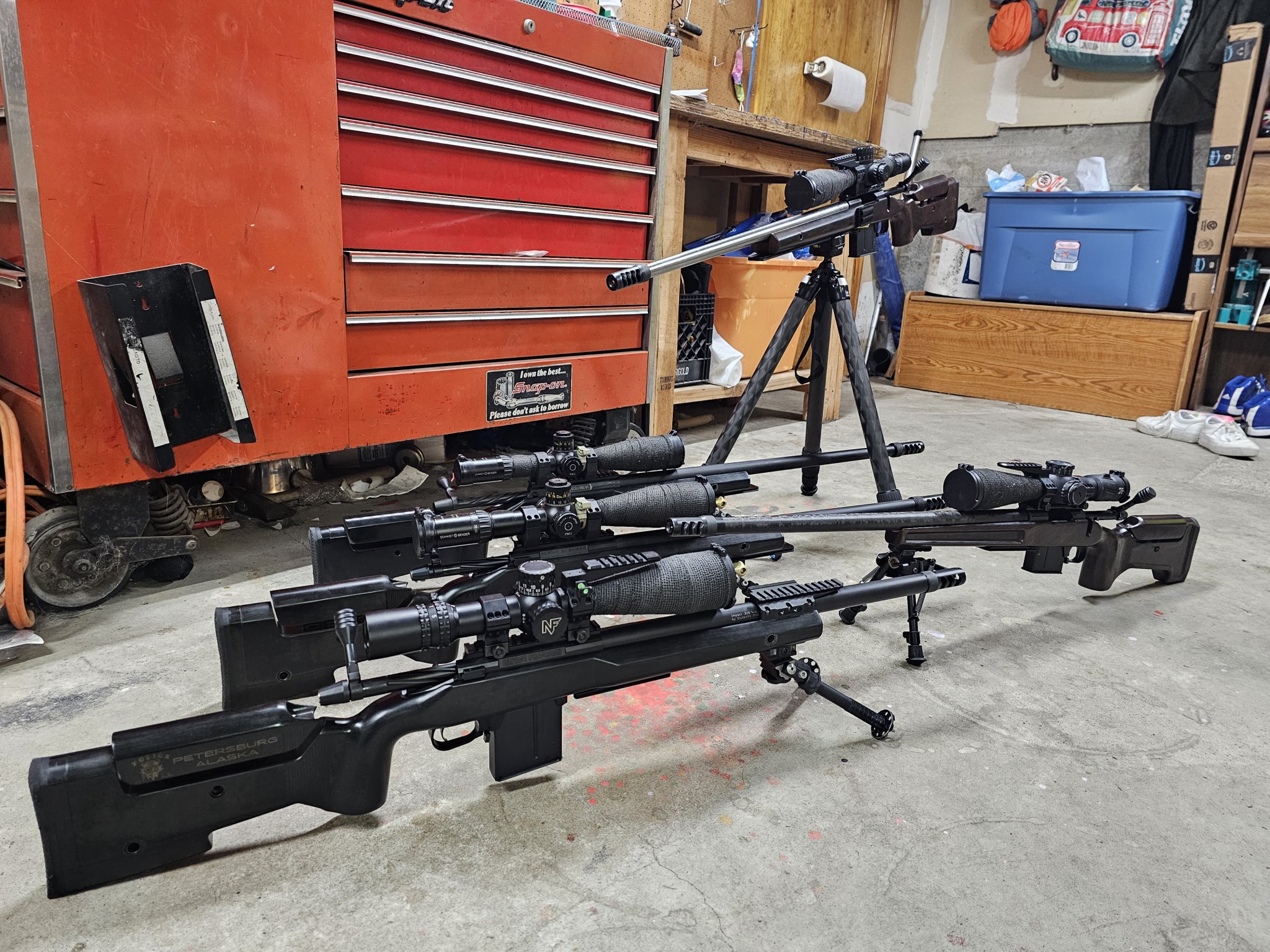

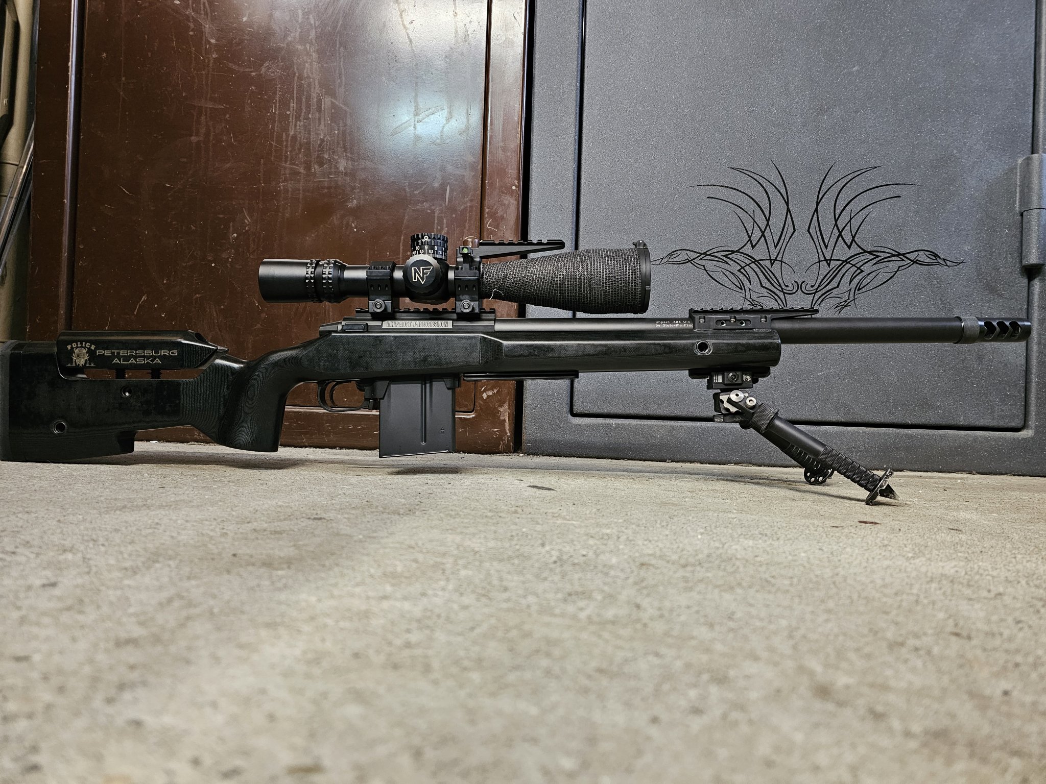

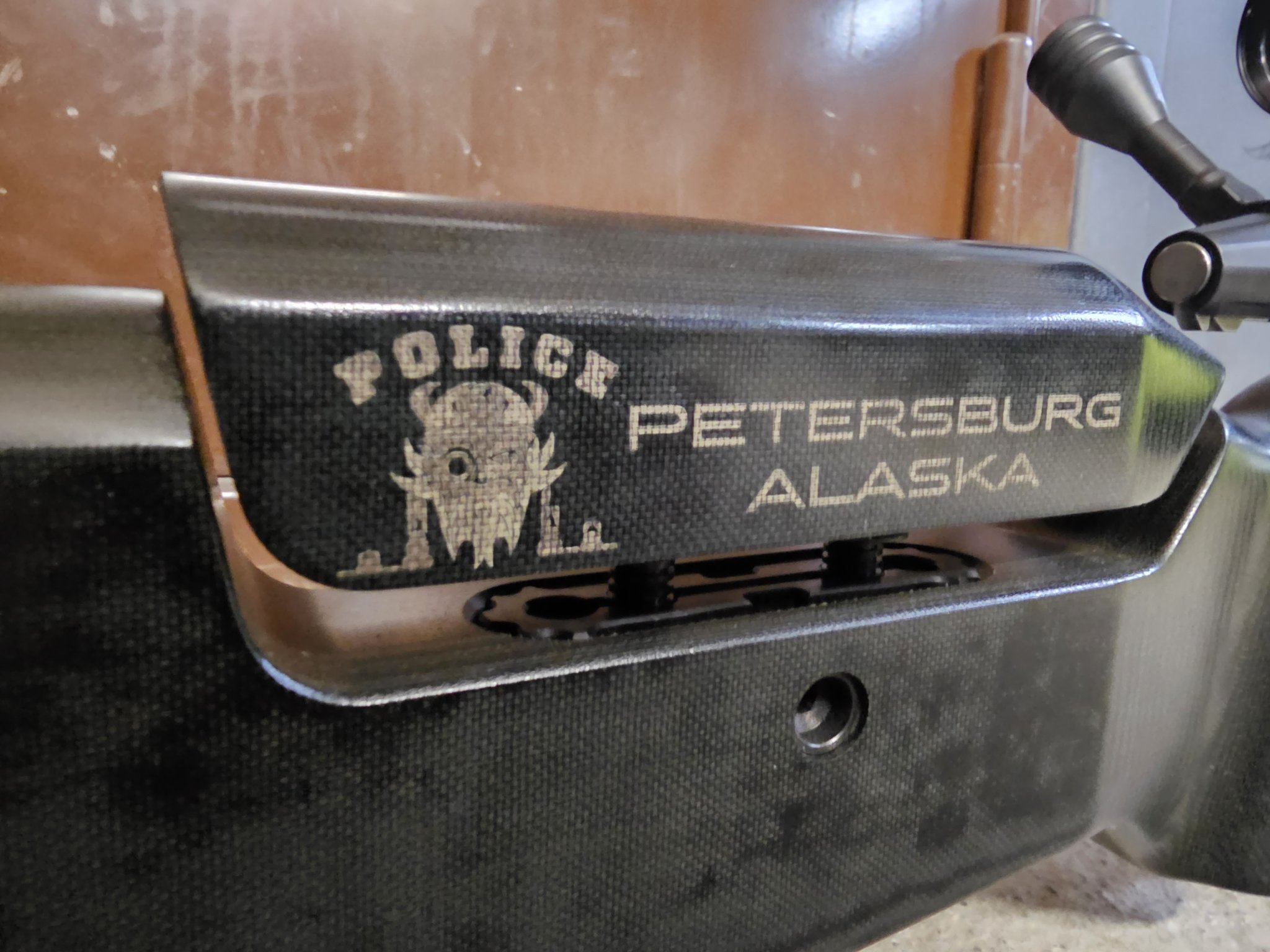

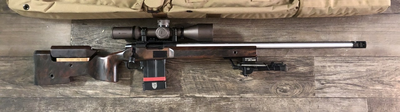

Well, I grabbed another MG2, for my work rifle build.... and JK and family knocked it out of the park. JK then recommended Sean Casey of DNA for a NV bridge install and it too came out flawlessly... his work is flat out impressive. You should really check out his laser etched stipple work he is doing now, it will be on my next one for sure... I will grab a few pics of this one with my other ones. I have whole stable of black ones now...
Well, I grabbed another MG2, for my work rifle build.... and JK and family knocked it out of the park. JK then recommended Sean Casey of DNA for a NV bridge install and it too came out flawlessly... his work is flat out impressive. You should really check out his laser etched stipple work he is doing now, it will be on my next one for sure... I will grab a few pics of this one with my other ones. I have whole stable of black ones now... View attachment 8113898View attachment 8113899View attachment 8113900View attachment 8113901View attachment 8113902

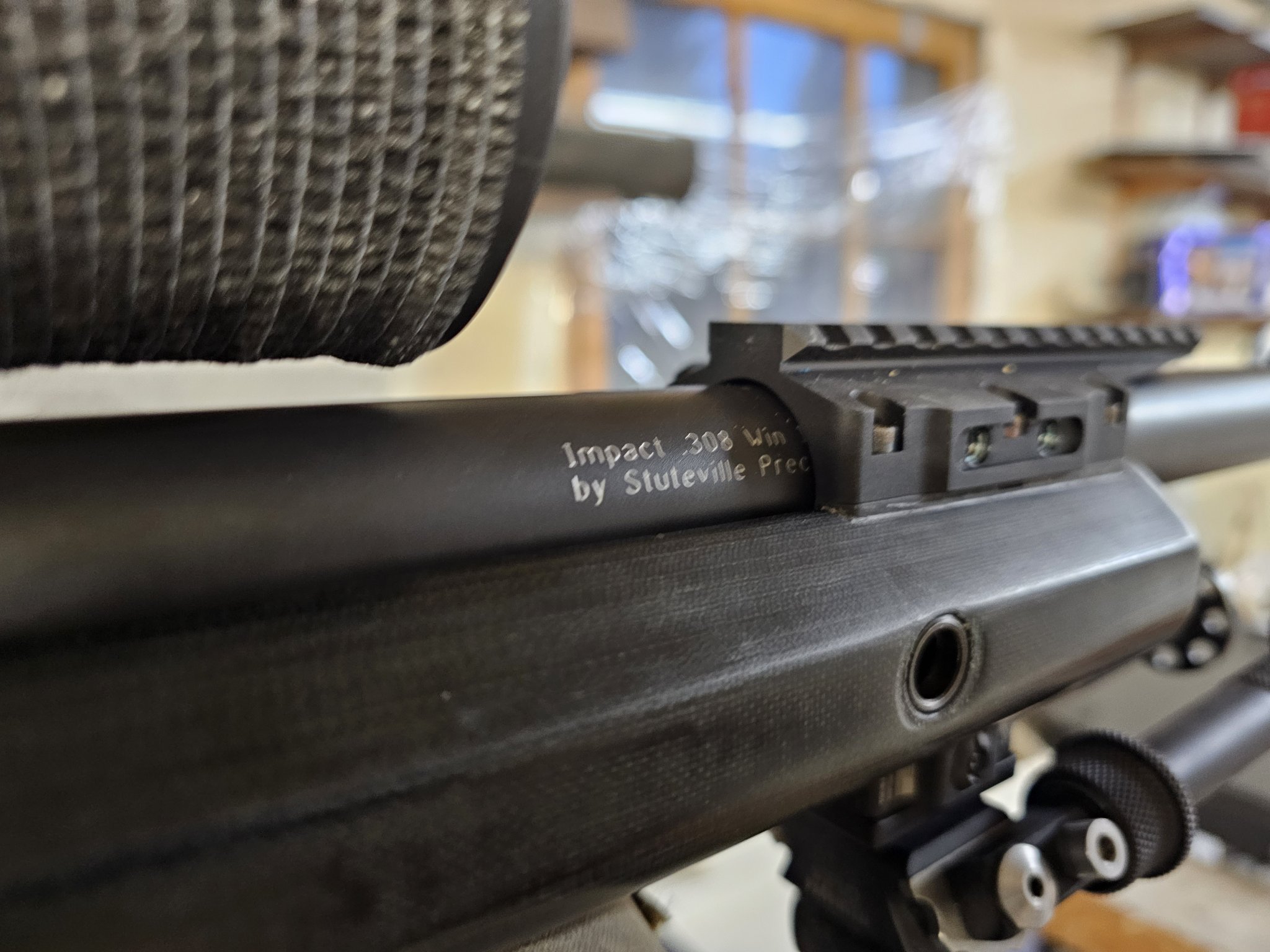

Who did the engraving?
I'll have to pull it out of the safe and measure it. I had gotten it from GAP as a used and re-barreled rifle. It was in some stupid caliber as I recall.
Originally built by SAC, and they added the rail.

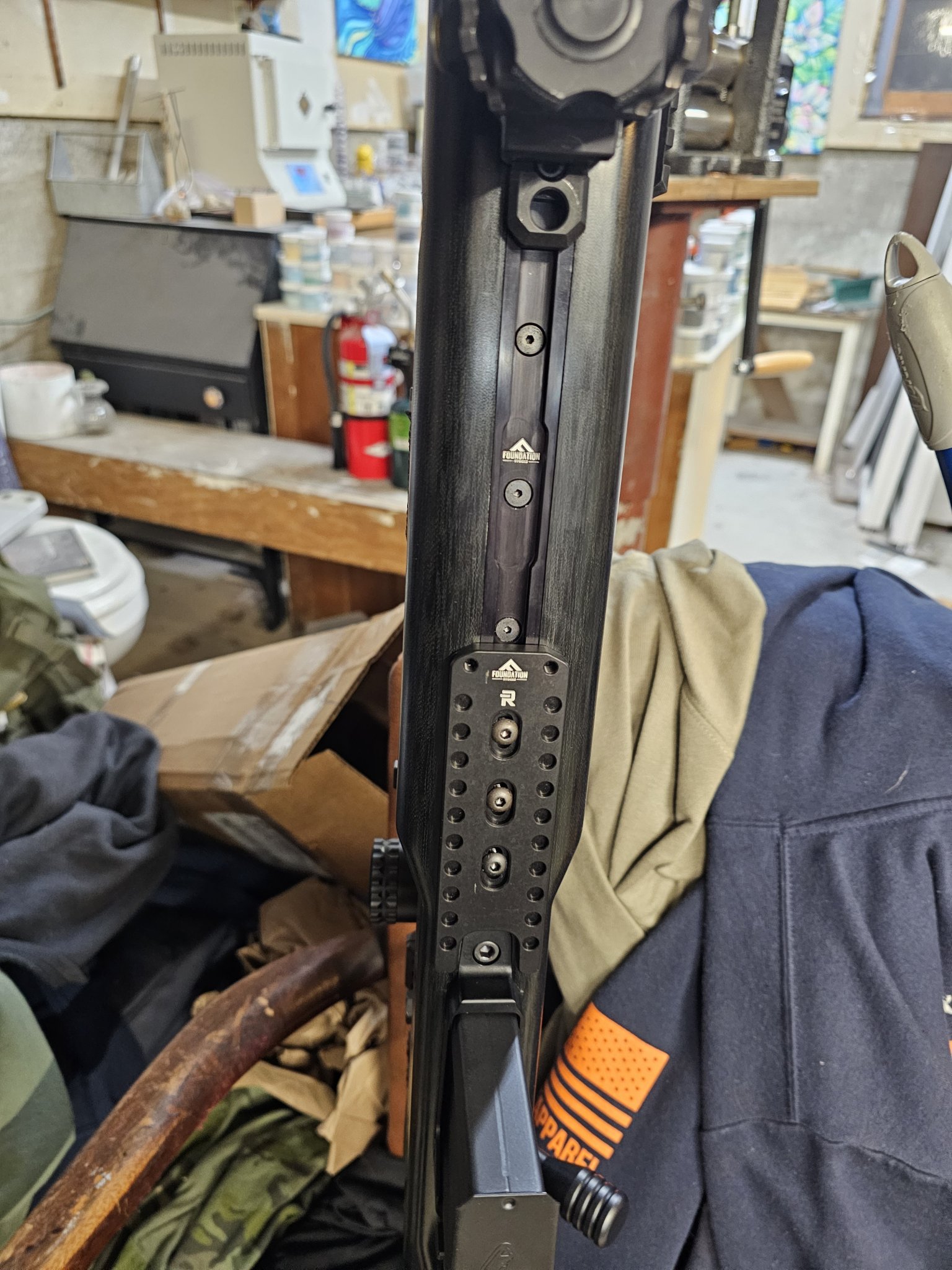

What length Area419 rail is that? And what hardware did you use to attach?

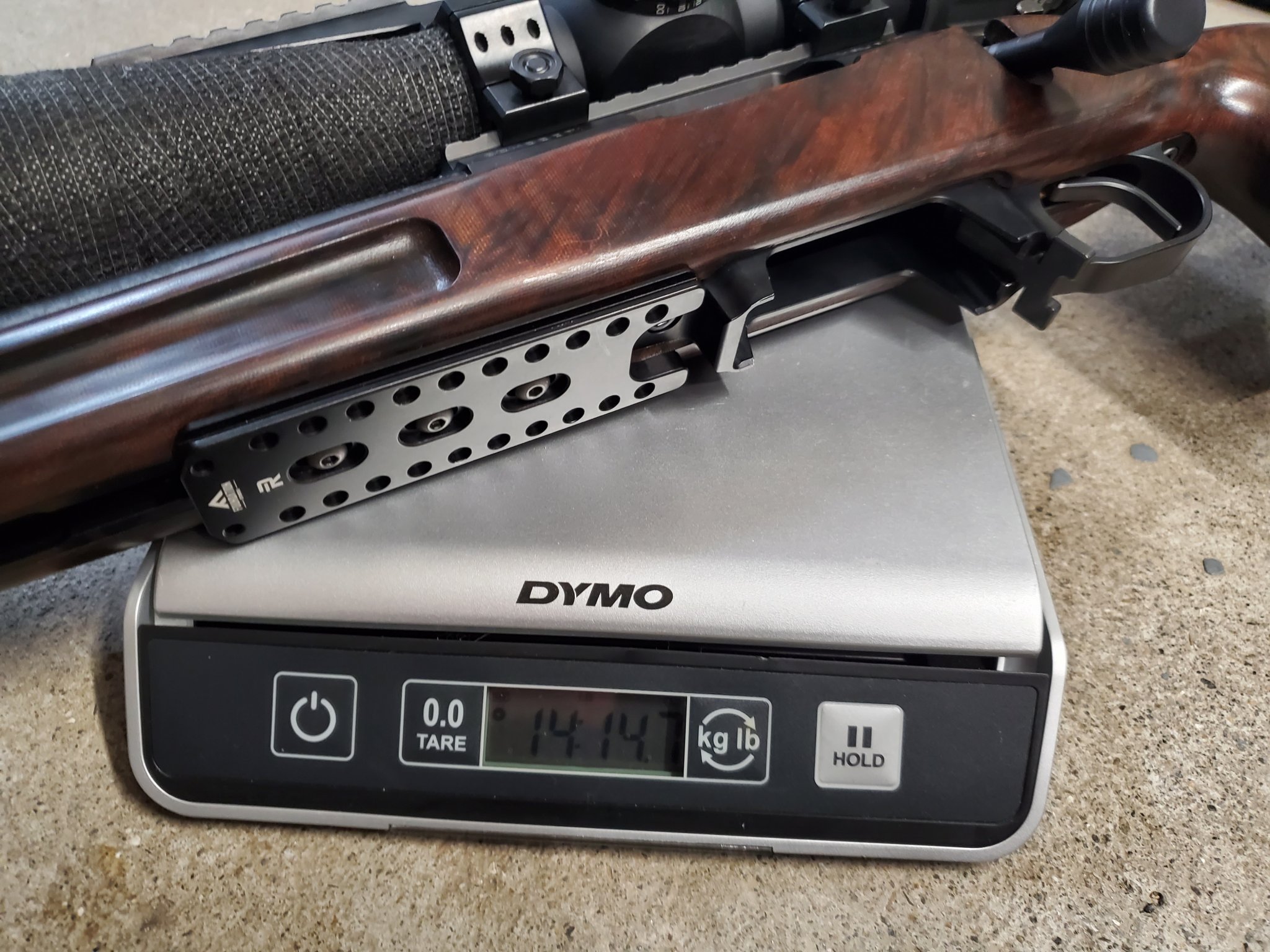

Assistance if someone could… what’s the thickness and weight of the Foundation made long arca rail. Trying to compare to the thickness and weight of the 360 Precision. Thanks!

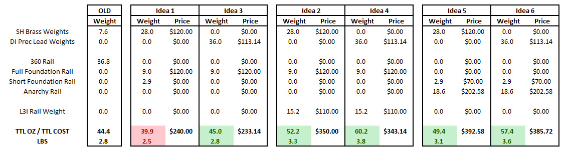

This may be crazy for some but this is how my mind works. I do accounting / excel for a living.

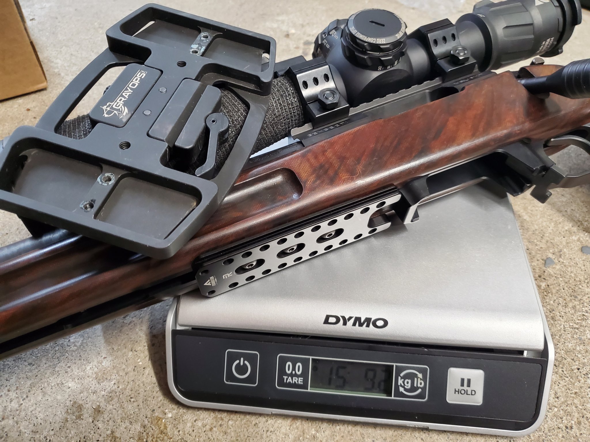

I had the same question and problem so I needed to compare. I think the weights are pretty accurate in oz.
I went with Idea 4.
