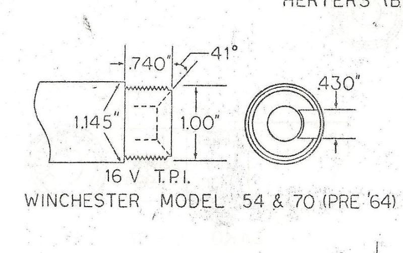

<div class="ubbcode-block"><div class="ubbcode-header">Originally Posted By: racesnake</div><div class="ubbcode-body">Is there a source for barrel stub data relating to chamber depth<span style="font-weight: bold"> 1 </span>, thread length<span style="font-weight: bold"> 2 </span>, diameter, pitch, etc. available? Would like to have them for Rem 700, Win m70, and Sav.
Dave </div></div>
<span style="font-weight: bold">1 & 2</span> will be receiver dependent depending on the case, receiver, bolt nose, etc.
General info on the R700 for Diam and pitch is 1.062x16 TPI
If I remember right the Savage is 1.06x18 TPI but that one I'm not as sure on, I haven't dealt with one for a while now.
