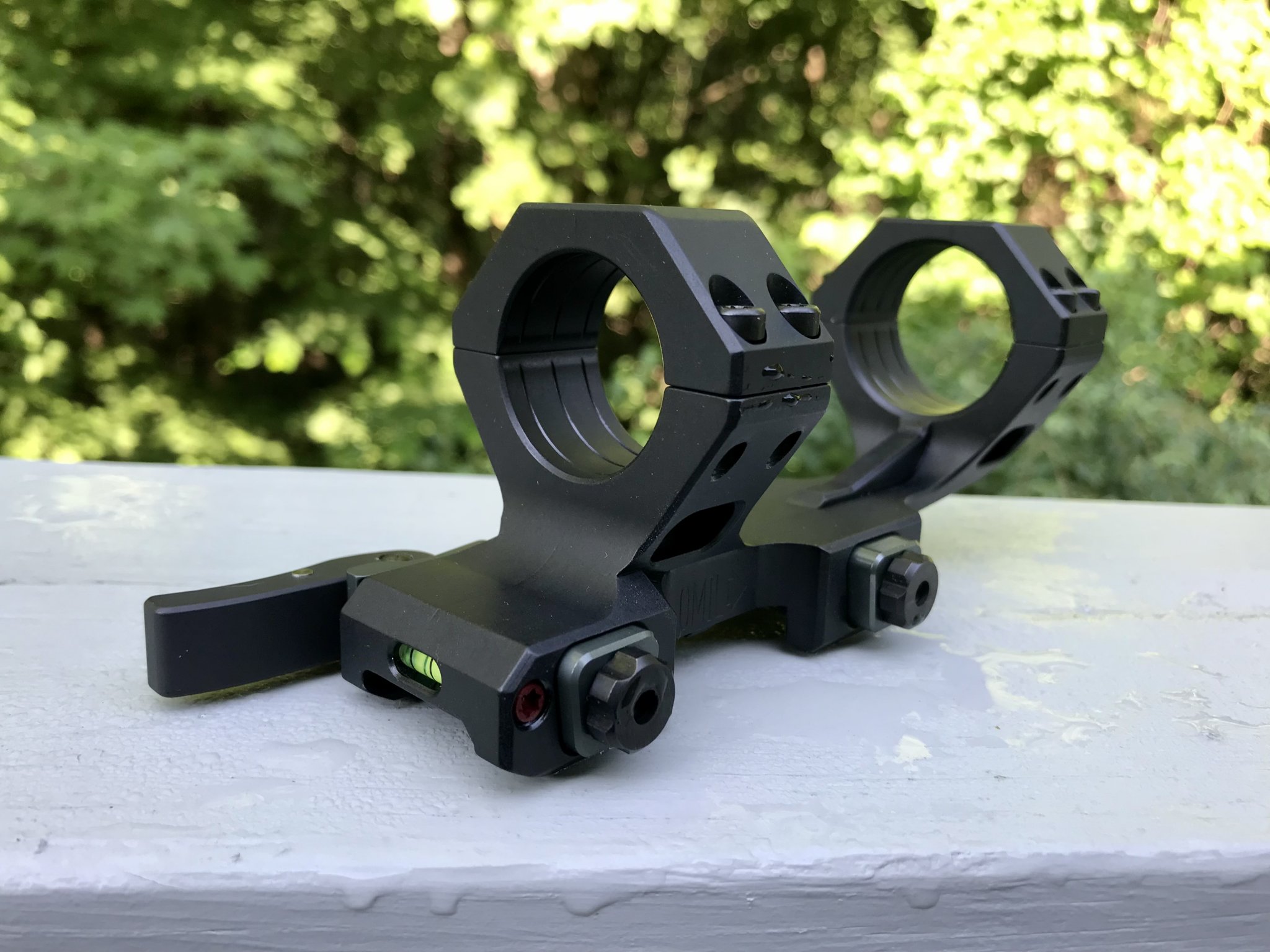

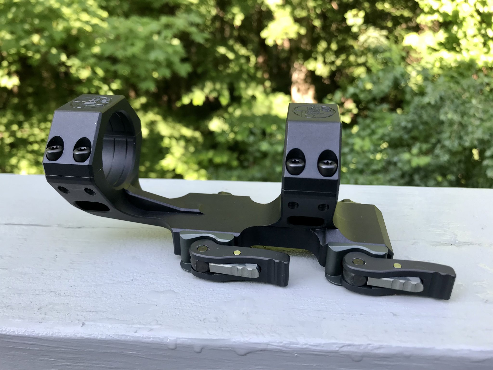

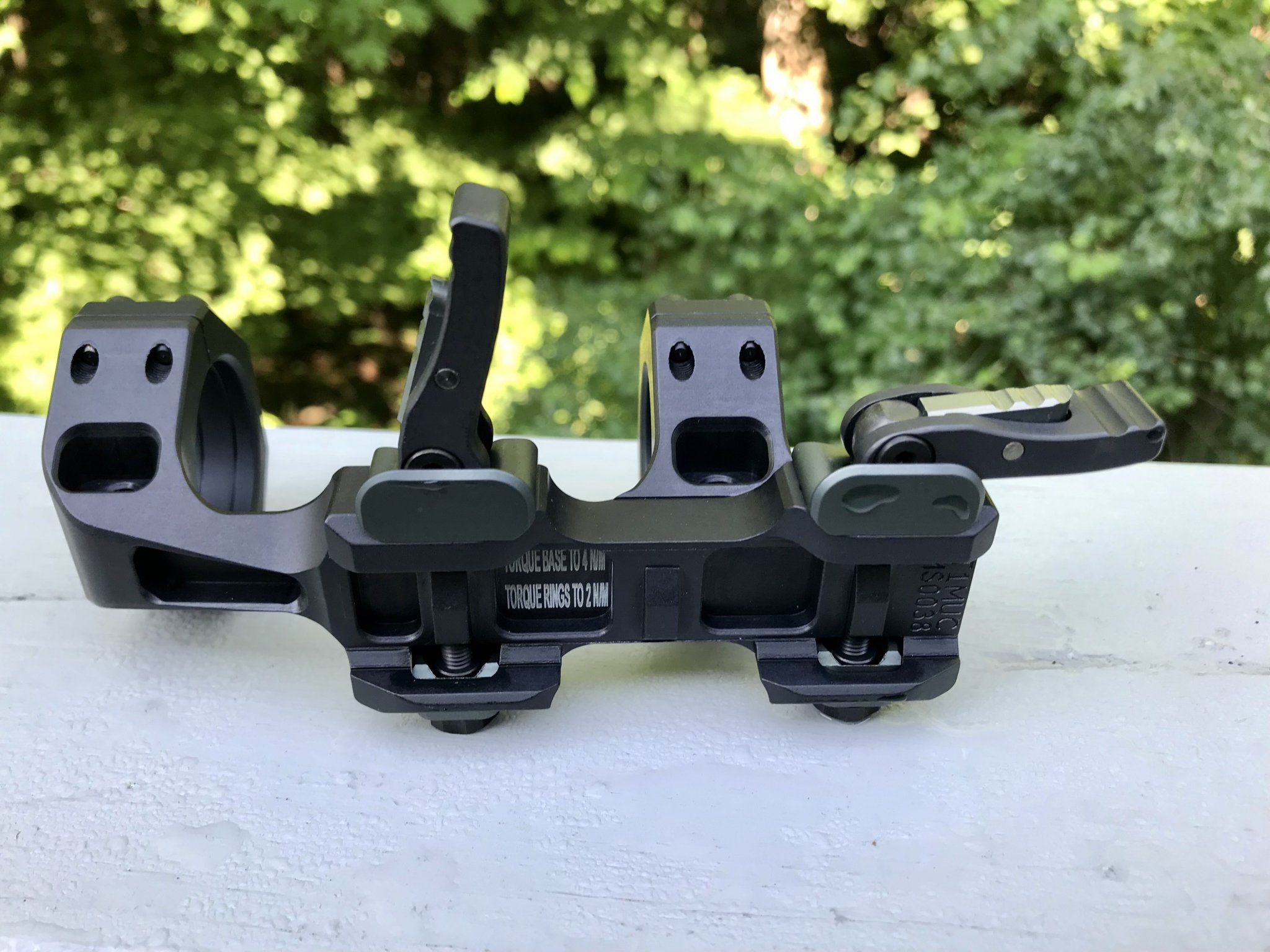

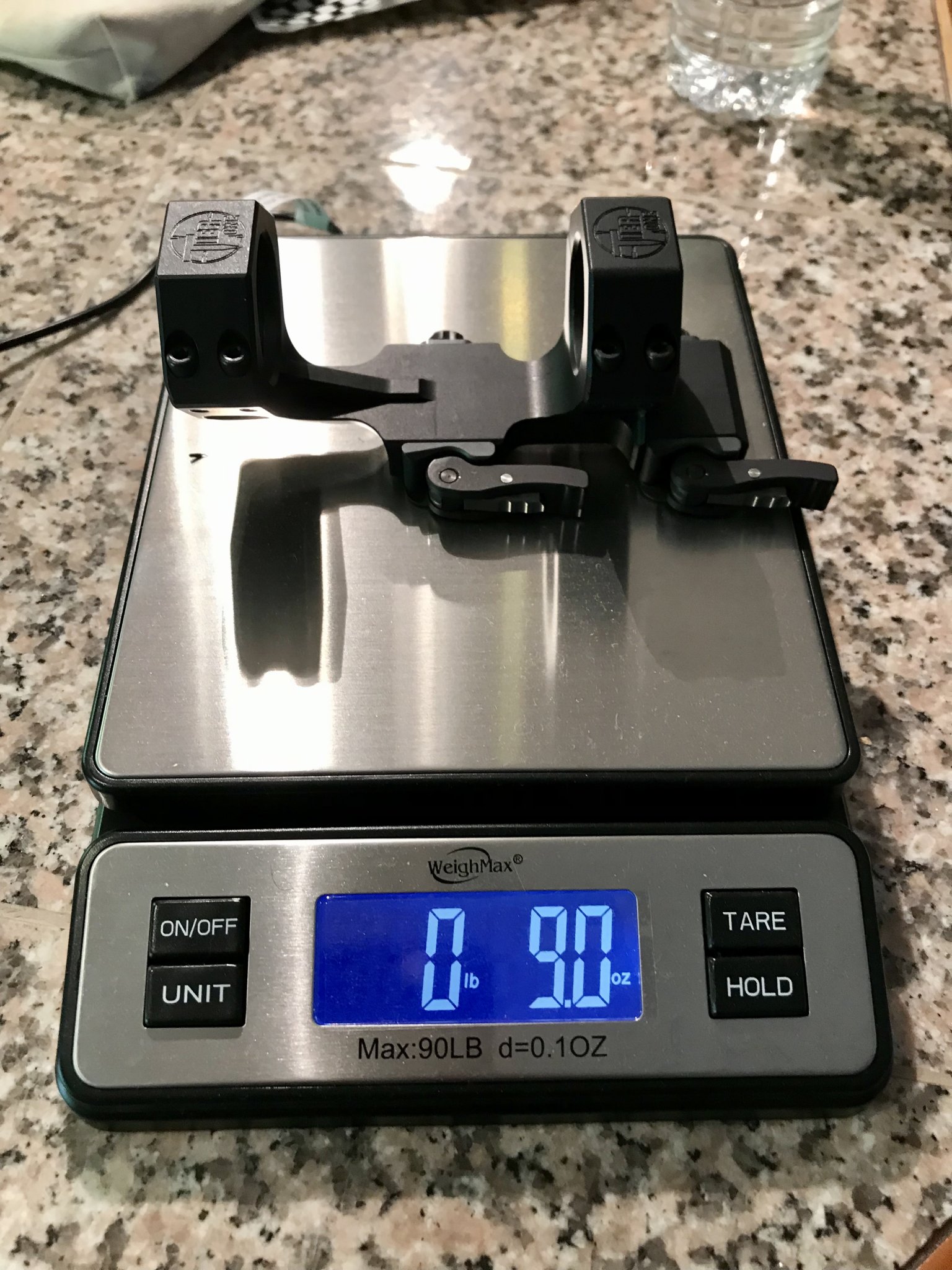

I received the mount yesterday. Tier One’s shipping though DHL is fantastic. The workmanship on the mount is outstanding but unfortunately it’s heavy. 9.0 ounces.
9oz is a deal breaker for me. Anyone know if they plan to make a non-QD version?

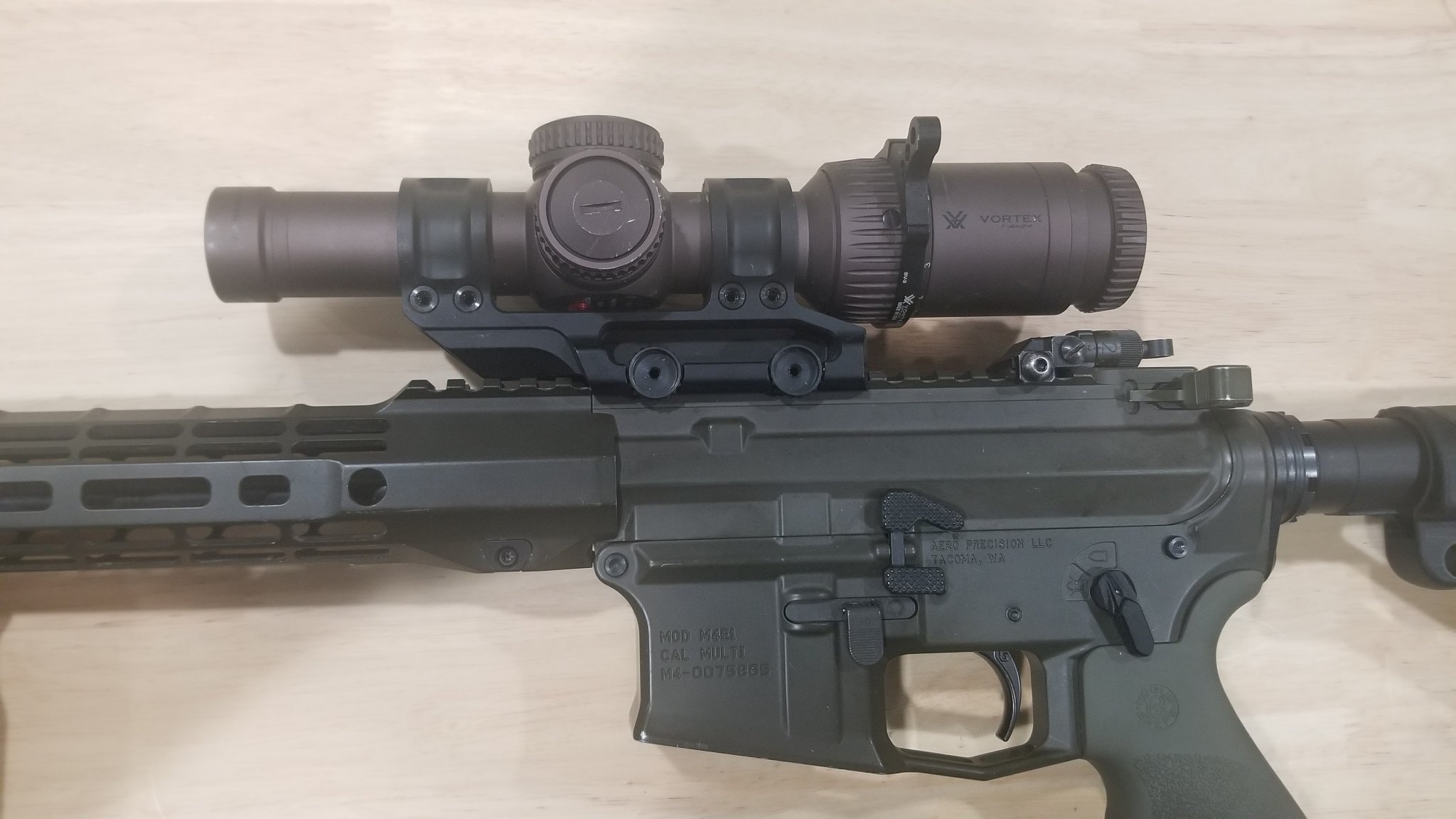

After looking at the March/Audere mount:
It isn't going to work for me, and I suspect others will have the same issue. For my particular combination of LOP and eyebox, it doesn't have enough cantilever to sit totally on the receiver of a flattop AR15. This is my current setup:
You can see that the Scalarworks mount is moved absolutely as far forward on the receiver as it will go, and the scope is only about 1/8" from as far forward as it will go in the clamps. And I could probably stand that additional 1/8" of eyebox. Note that almost half of the turret is in front of the forward-most point of the upper. The March/Audere mount would have the front clamp interfering significantly with the turrets to be in this position. And anyone else running a short LOP (2nd or 3rd click) like I do is going to have the same issues.
I am curious why March decided to make this clamp with so little cantilever. Considering that this scope is going to be mounted on ARs nearly exclusively, why would they not follow the industry standard for cantilever? It is the industry standard for a reason.
The Tier One has plenty of cantilever, hopefully they will sell a non-QD version.
If not, maybe Scalarworks will be interested in making a mount. That would be my first choice anyway.

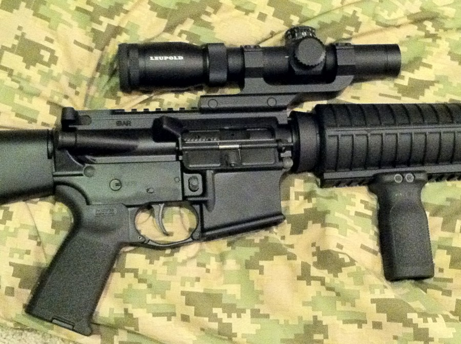

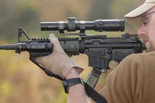

Wow, thats farther forward than any I've seen before. Usually the eyepiece is about even with the charging handle, so I wouldnt be calling it anything like "industry standard".
I image searched "scope mount ar 15" and two of the very first pictures to pop up:
The rear of the scopes in both of these are at least as far forward as mine, the first one is even farther. Where the scope needs to sit is heavily determined by the shooters LOP needs. Also note the amount of cantilever in the mounts they are using to achieve that position. The March mount will never be able to do this.
That being said, I didnt realize there was an industry standard for the length of cantilever. Seems many manufacturers are different and some even offer a choice of how far forward you want.
There is no standard set number for cantilever but companies designing AR scope mounts put much more cantilever than the March mount. That same above-mentioned Google search also reveals pages of AR-intended mounts, and almost every single one of them has at least double, some approaching triple the cantilever offset of the March. My above pictures demonstrate why.

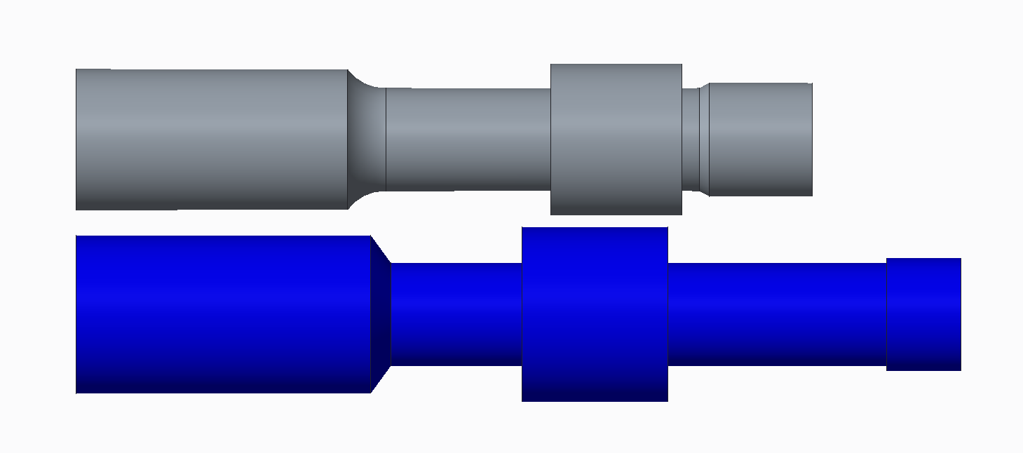

I had already done this before making my original post about cantilever, I am just now getting a chance to throw it up here.
I looked at the length dimensions of my Gen II-E, and the posted dimensions of the Shorty. I created a CAD model for comparison, and got this:
The gray is the Shorty, Blue is Vortex. By this drawing, there is virtually no difference (within a millimeter) between the two scopes as far as distance from the rear-most area of clamping section and the objective.
How far forward a scope can be moved in a clamp is limited by the point where the 30mm neckdown ends. Since this point is virtually exactly the same distance from the objective on both scopes, that means the Shorty objective can't be moved any farther forward than the Vortex, assuming the rear clamp is in the same location.

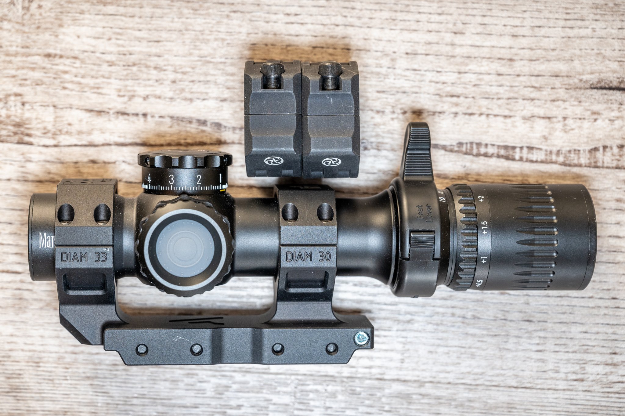

So I am still sticking with my assessment that this:
Can't be positioned as far forward as this:
It just simply can't be done. At least not without hanging past the front of the upper receiver.
If you doubt it, look how far past the front of the receiver the front of my turret housing is located. It is almost centered over the receiver front.
Now look at the March. With the March mount moved all the way forward on the receiver, the farthest forward the front of the turret housing could be located is roughly flush with the front of the receiver. All this results that, even with the scope moved absolutely as far as possible in the clamp, and the clamp moved all the way to the front of the receiver, the front of the Shorty turret housing is going to be barely flush with the front of the upper. That places the objective of the March around 20mm farther rearward than my current Vortex/Scalarworks setup.
I still stand by my statement. The Audere/March mount is never going to work on an AR with people that run a shorter LOP.
So I am still sticking with my assessment that this:View attachment 7707889
March has shorter eyerelief than Razor Gen2. Your eye ends up roughly in the same spot. At least for me it does. I have to mount the March a little further back than the Razor Gen3 I have and Gen2 has longer eye relief than Gen3 if memory serves me right.
I am not going to re-measure your drawings. All I can tell you is how it worked for me having spent several months with the scopes. I probably do not run as short of a length of pull as you do, so it is entirely possible it won't work for you. On my AR, the back of the Razor Gen3 is about half inch further back than the Gen2 in your picture and March is a touch further back yet.

Here is the Shorty 1-8x24 in the Audere mount, moved as far forward as possible without clamping onto the handguard. Both clamps are on the receiver. That's a little further forward than I like. The 1-8x24 March Shorty is almost identical to the 1-10x24 in terms of size.
The tail end of the eyepiece looks to be in more or less the same place as your Gen2 Razor in the Scalarworks mount.
Now, what's interesting is that the mount I have looks to have a slightly different clamp than the one in Bill's picture. I am not sure which is the newer version and why there are two different ones. I am supposed to have another mount heading my way, so we'll see what that one looks like.
With all that, if you want to move it further forward, you can using an extended riser and two Burris XTR Signature rings. Kinda like they describer here, but with lower rings:

A shorter eye relief would certainly help, but I don't see where that much difference can be made up in just eye relief. But until I get one in hand, I can't know. This is all speculation at some level until then.
This certainly appears to be closer to what I would need, but as mentioned this is a different scope and clamp from what is pictured above in my comparisons.
And this is probably the most important thing in the entire post. The particular clamp you have pictured here has a good bit more cantilever than the ones others have posted, as well as the pictures on the March website last time I looked. THIS clamp would work for me. Especially considering you still have a good bit farther the tube could be moved in the rings. The newer ones pictured elsewhere here are not capable of anywhere near this much forward placement of the scope.
This would all be an option, but not really one that interests me. All of that hardware would be heavy, and weight is a huge reason why I am looking at this scope in the first place. If I did not care about weight I would simply opt for the Tier 1 mount, which has plenty of cantilever.
