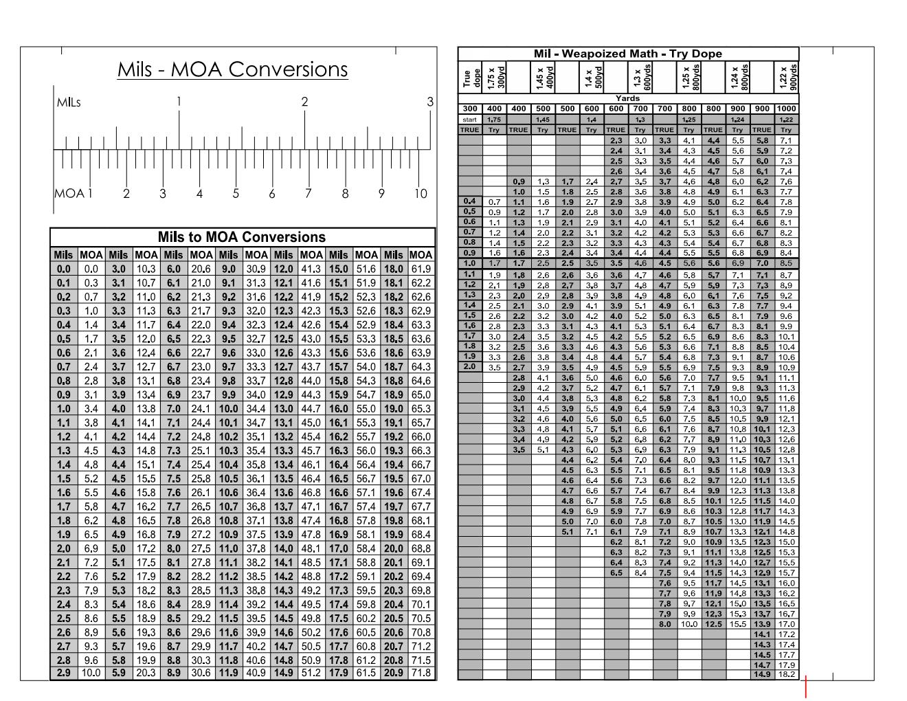

    Take my 6.5, for instance, at my home range: 8.7 at 1,000 minus 5.8 at 800 equals 2.9 Mils of drop in that 200-yard gap. If I take that 2.9 and multiply it by .45, it gives me 1.3 Mils. Add that to my 800-yard data of 5.8 and it gives me... guess what...? What my TRASOL spits out for my 900-yard data!
    8.7-5.8 = 2.9.
    2.9 x .45 = 1.3
    5.8 + 1.3 = 7.1 Mils
    7.1 Mils to a water-line hit
    This was great. Problem solved at 900 from now on, and it saved student ammo and instructor aggravation. I could now concentrate on the student’s wind call knowing that the data I gave him was elevation-correct, minus his input and windage. And it works in MOA or Mil, of course. I had created voodoo.

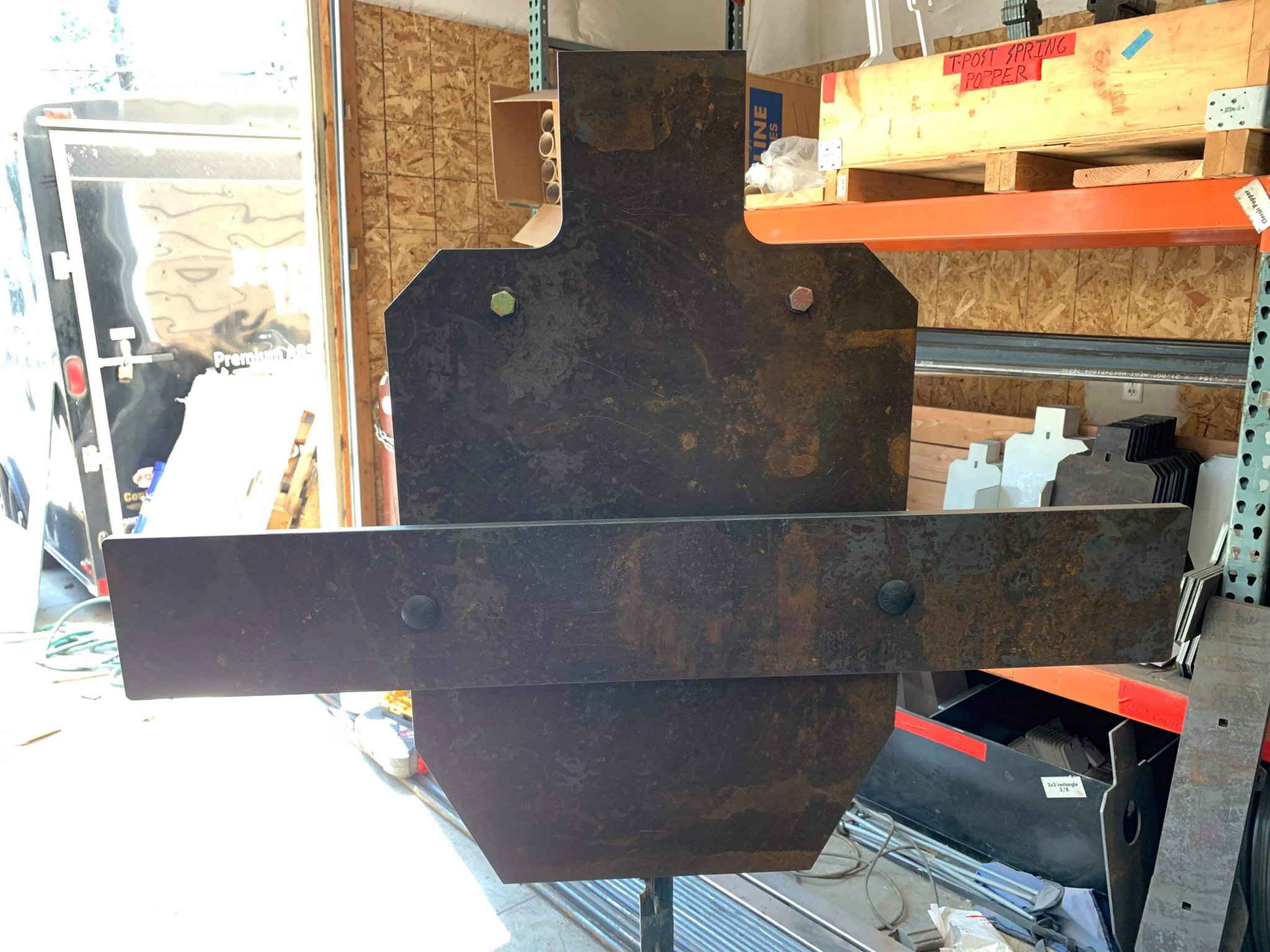

    Have a buddy coming out to shoot this week. He just a hunter with no real “math” experience when it comes to shooting.
    I had @JC Steel build a truing target like the one Frank has posted.
    Gonna start at 300 and work back in 100yd increments and use this method to get his dope for his 6.5.

    • Weaponized Math and MOA to Mils.pdf

    For us simpletons, I'm guessing this would also work in MOA? If so, I created the attached table to convert everything over, if someone wants to check my work. Each cell won't match exactly to the Mil table, but I used a middle benchmark row and worked back from there.
    • Weaponized Math - MOA.pdf
    Reactions: Enough Said
    Correct,
    Mils or MOA does not matter, both can be interchanged using 3.43
    Cool, I'll put this table to work then (instead of carrying the mil table and needing to convert each one on the fly). Hope this helps anyone that's using MOA instead of mils.

    I would love for someone to break this down with crayons for me because I keep getting questions about this.
    There really is no "math" you can just read the chart Ted created
    if you use 1.0 Mils to hit 300 yards, Point of Aim, Point of Impact,
    moving to 400 you start with 1.7 Mils, after shooting and determining point of aim, point of impact at 400, you use that number to give you the 500 yard starting point.
    it's trued and verified data, that fills in the blanks for you, it's gravity, not bullet weight, BC, muzzle velocity, sight height, twist rate, bullet length, azimuth to target, it's just gravity, that is it, you use the confirmed data from the previous yard line to line up the next 100 yard target.
