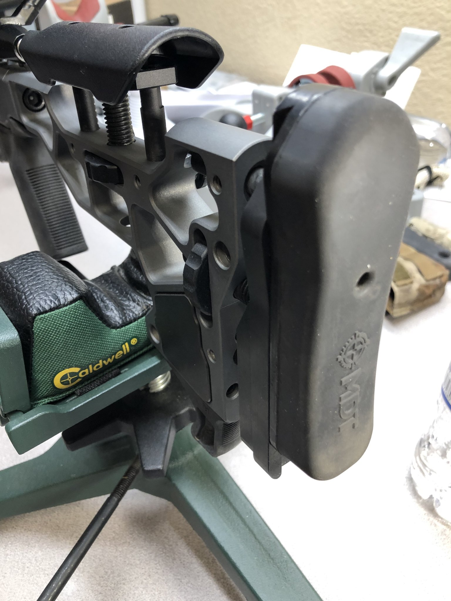

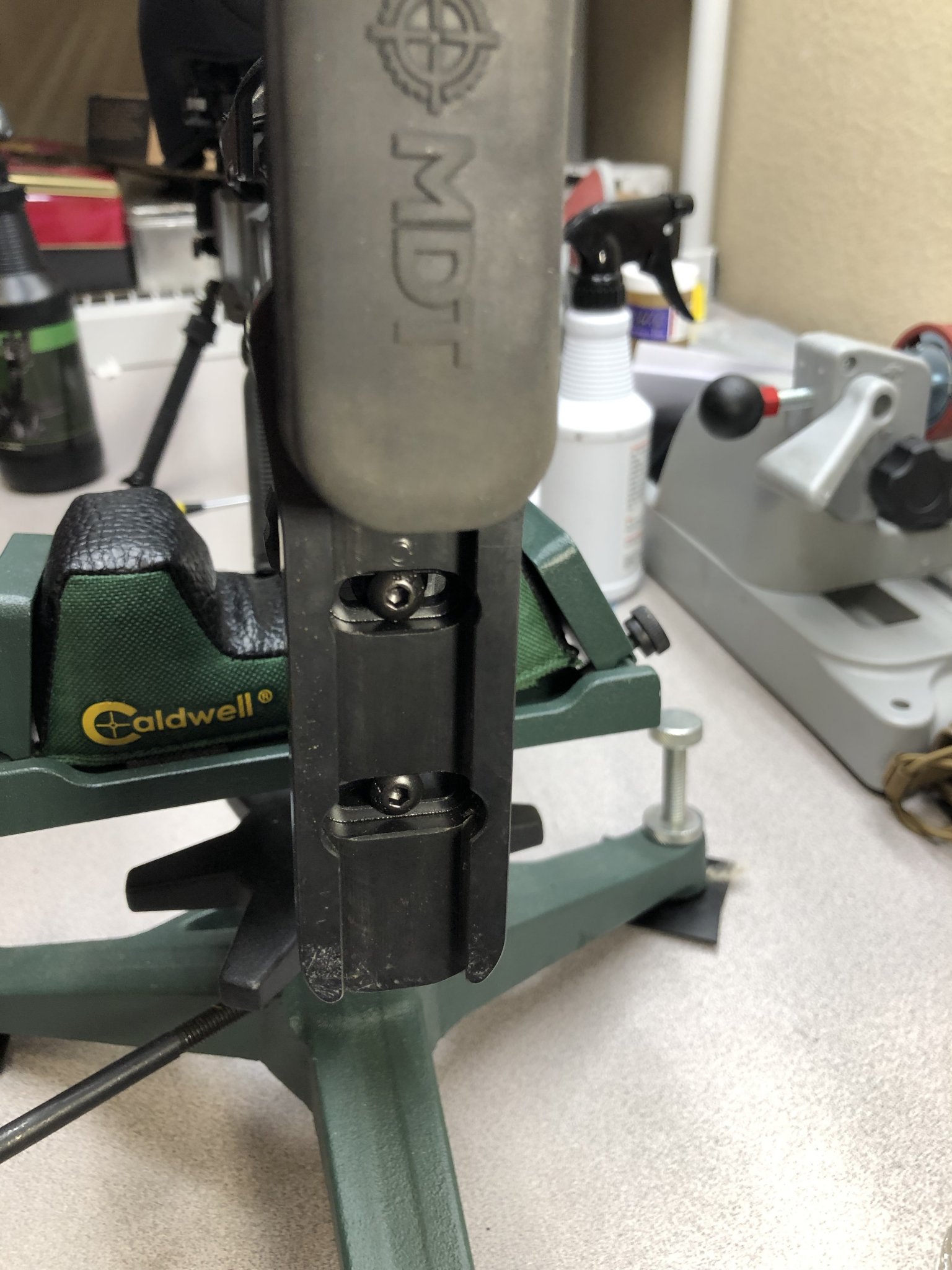

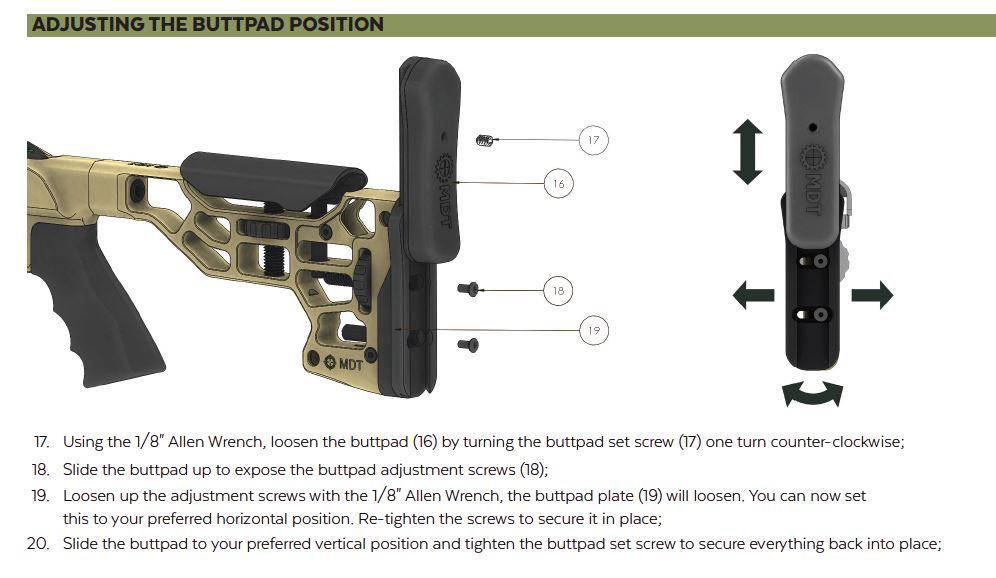

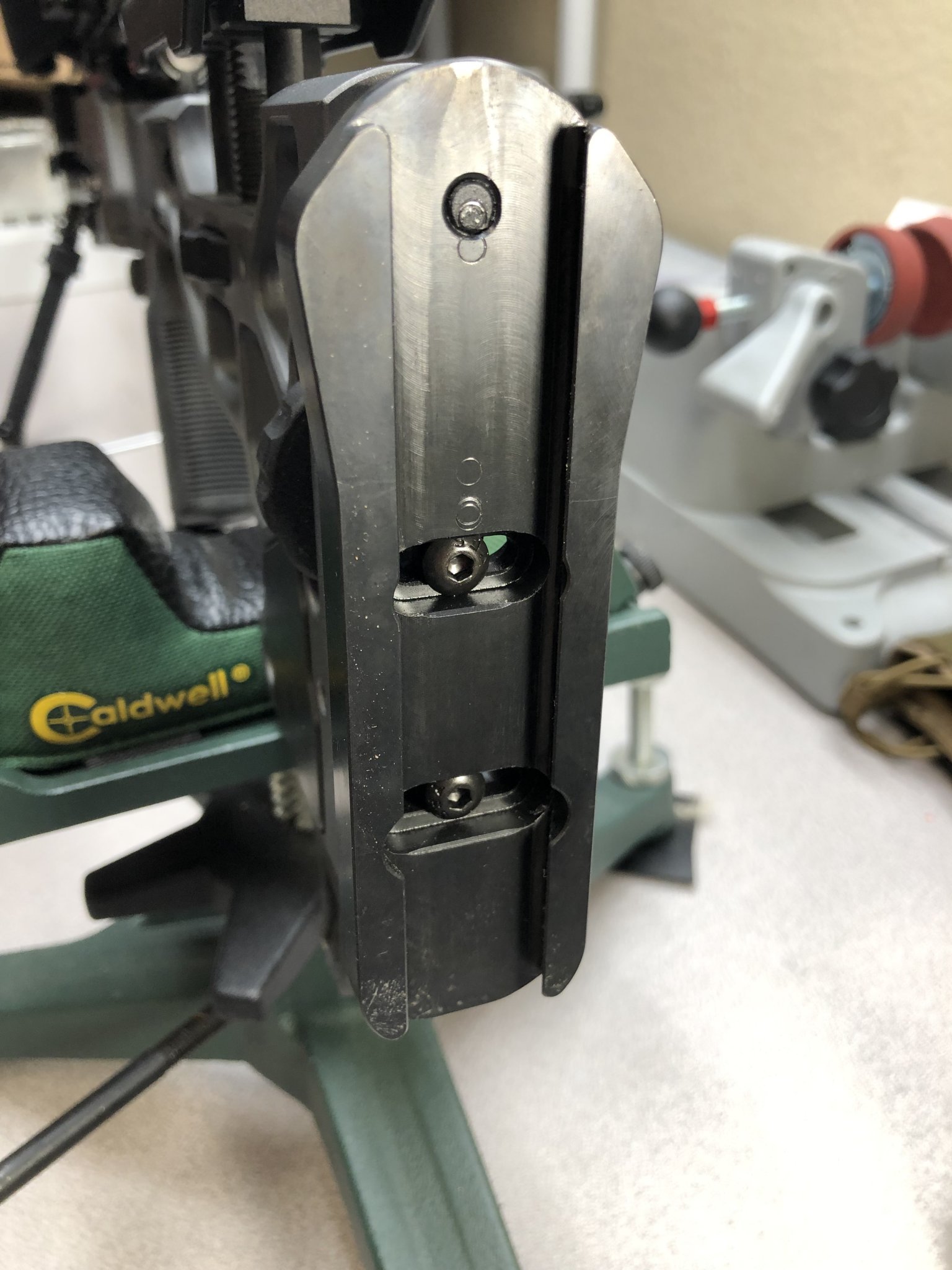

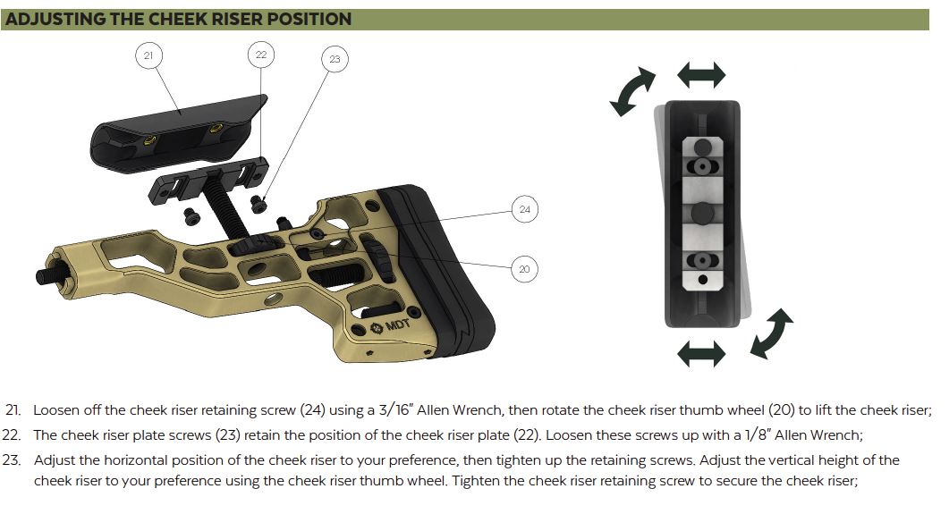

Got mine today. Impact dropped right in
@JGR1953 is right and you should have all that adjustment! The only thing you lose out on a little is the buttpad cant adjustment a little as we went to the second guide rod for more rigidity!
Ok. It’s a semi permanent change sort of speak. I can’t see myself changing it often like I can on my AIAX. Thanks I had missed it.

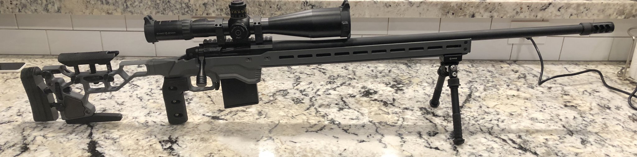

Having some fit issues with my Ultimatum Deadline dropping in that @MDT_Josh is helping me sort out.
Cadex sheepdog action drops in perfectly though. I’m very happy with the chassis so far.

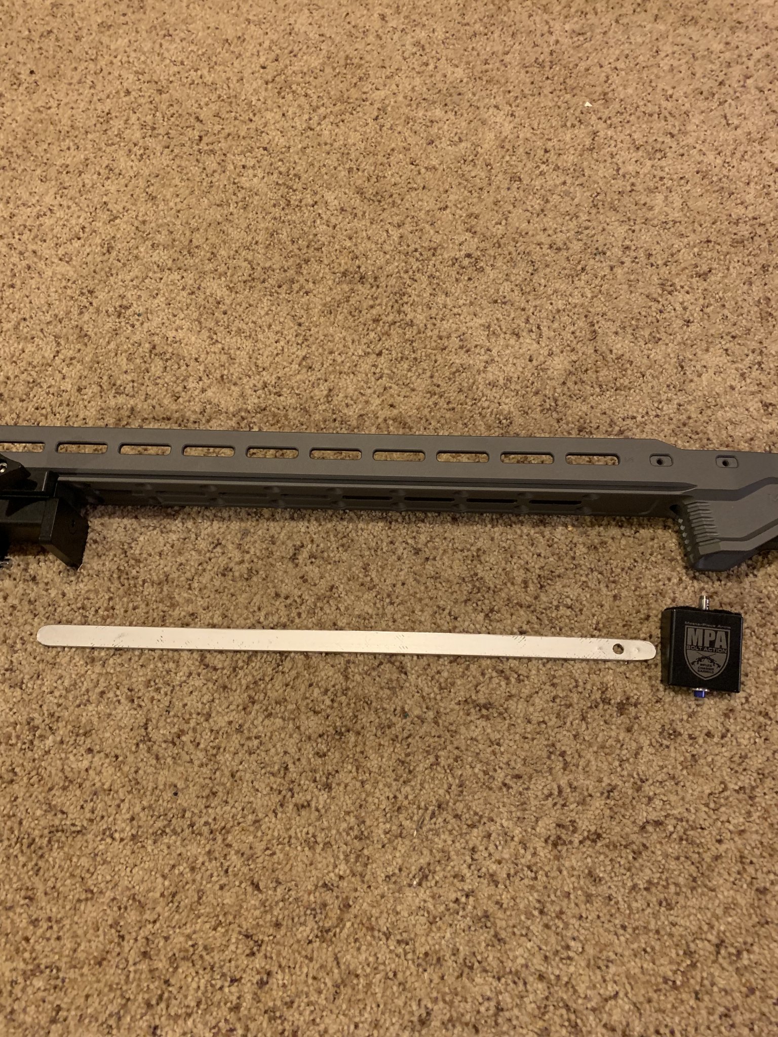

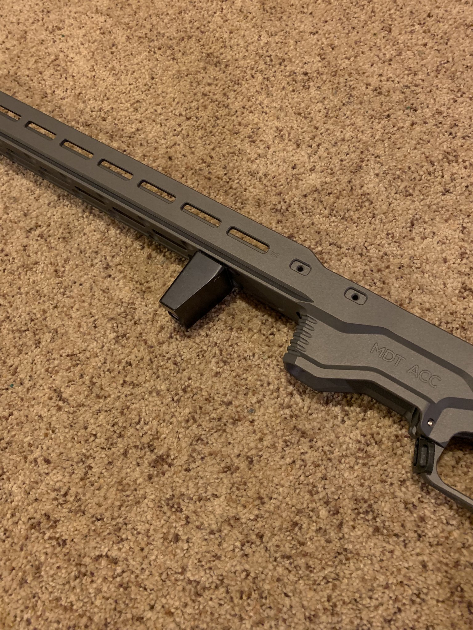

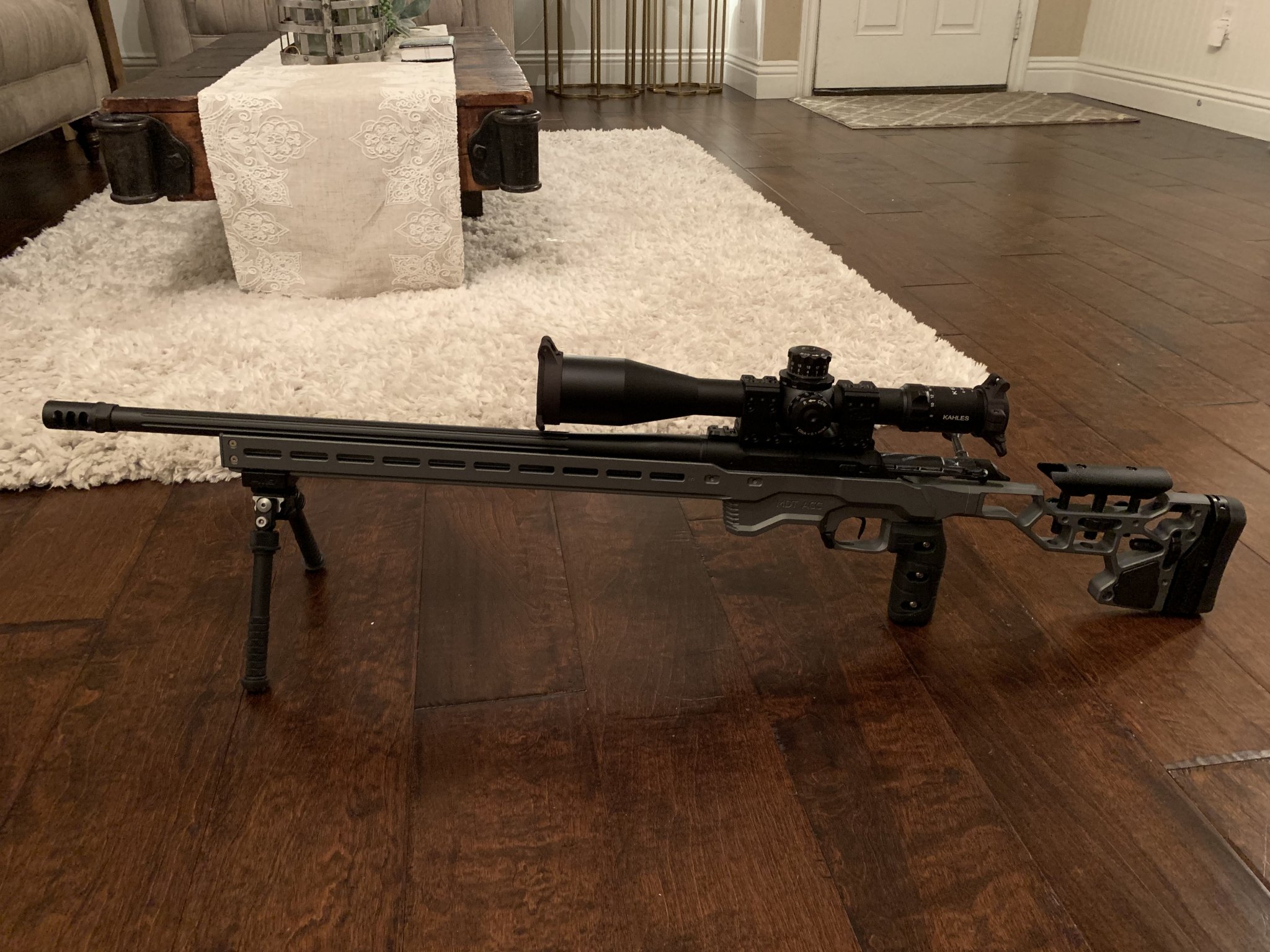

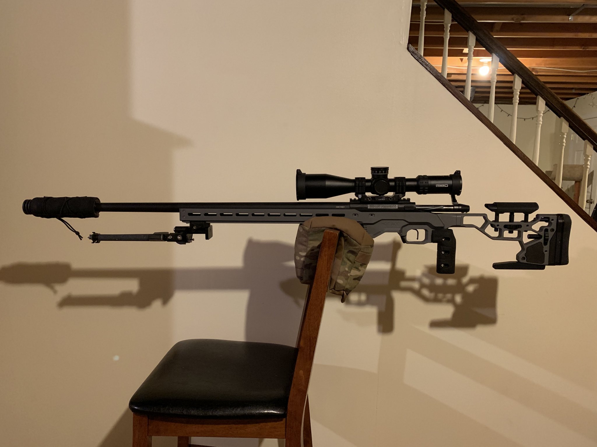

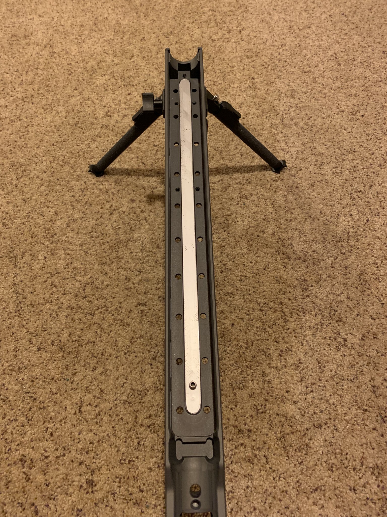

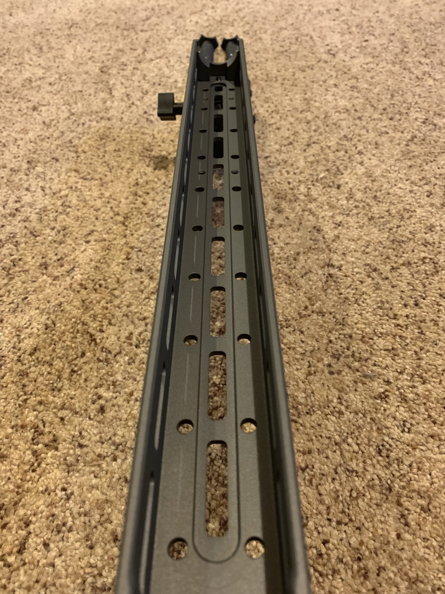

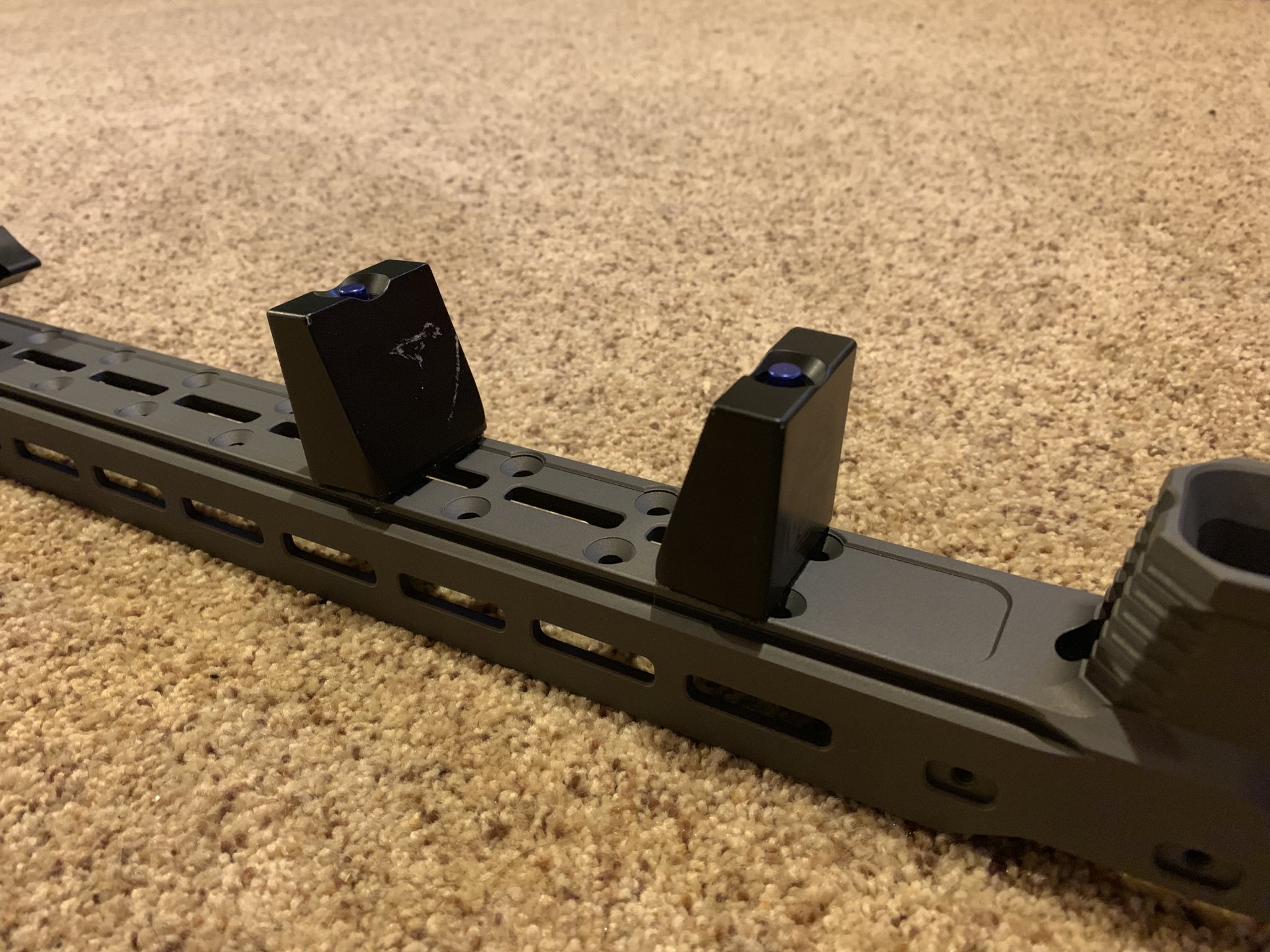

Well, thought I had a really good idea to incorporate the “cowgate” style barricade stops into the ACC, unfortunately there are just some minor things that are going to make it a little more difficult than planned.
I originally wanted to create a sort of “insert” that would fit snugly inside the M-Lok relief cut in the barrel channel. I was then going to drill 1/4” holes in the insert that would basically give the barricade stop poles/detents something to lock onto, similar to the RAT system.
That all went as planned - the insert and drilling holes is the easy part. However, the barricade stops, when inserted and locked into place, are allowed to move freely due to the M-Lok slots on the bottom side of the chassis. The stops lock into place on the insert as I wanted, but the cut-outs allow too much play in the stop itself. I could probably use it as it is, but as I told Josh... this was always going to be the solution to a problem that never existed with this chassis.
The thought is there, the execution of it is just more hassle than it’s worth when I can use a good bag and get the same results. I did want to post my findings in case someone had a similar idea or could think of a better way to make this happen. A vertical mill would make this job quite simple I have a feeling, but with limited tools to work with and for something that already has a pretty good alternate solution, I conceded on this project, LOL.
