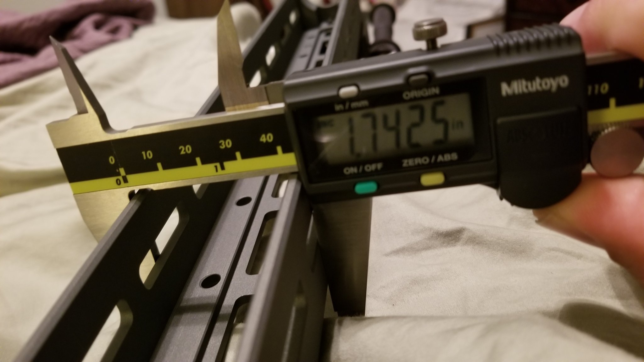

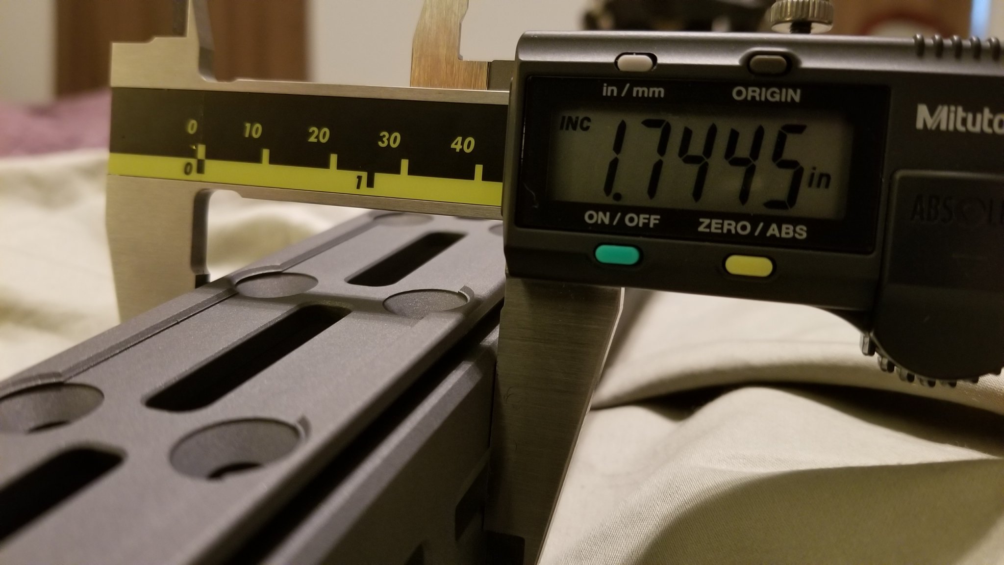

Sorry if I missed it in this thread, but can anyone tell me the width of the forend? I see that the internal weights are 1.44”, but I can’t find how wide it is from the two outside faces of the forend. Thanks!

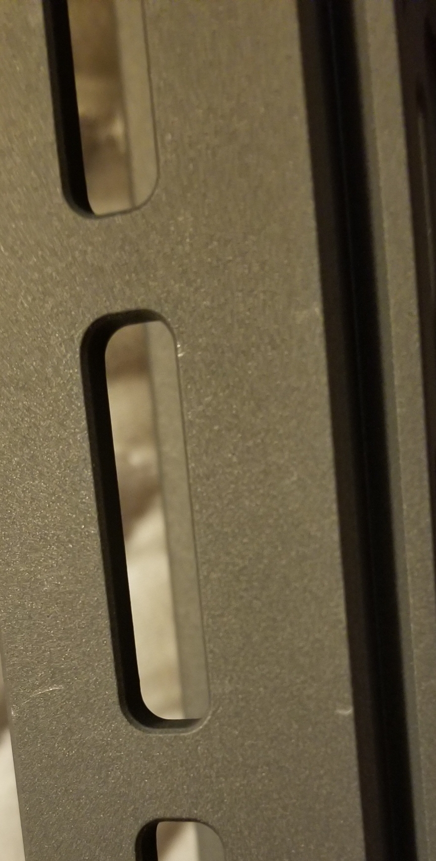

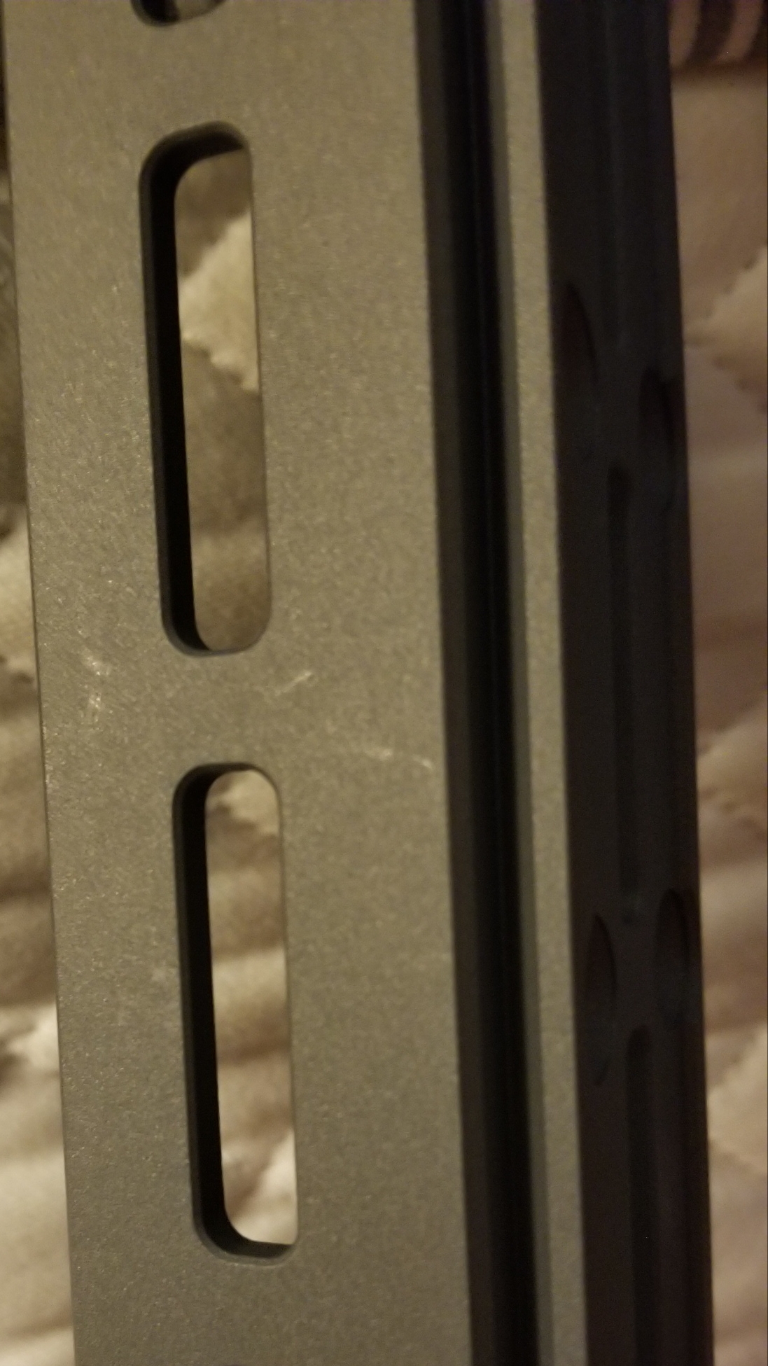

Side note: finish is not durable at all. My calipers easily rubbed it off.

Some spots appear to be shiny metal
Others just look like rub Mark's
Hmm ?. Very interesting. Maybe your calipers are extremely sharp.. on another note you can hardly tell those marks are there. I’ve scratched cerekote up before with a sharp nail sticking slightly out of a baracade. No biggie, it’s aluminum

It will only rub off if you catch it with the sharper end of the calipers. If you just go flat-to-flat then you are right, it should hold up just fine :)

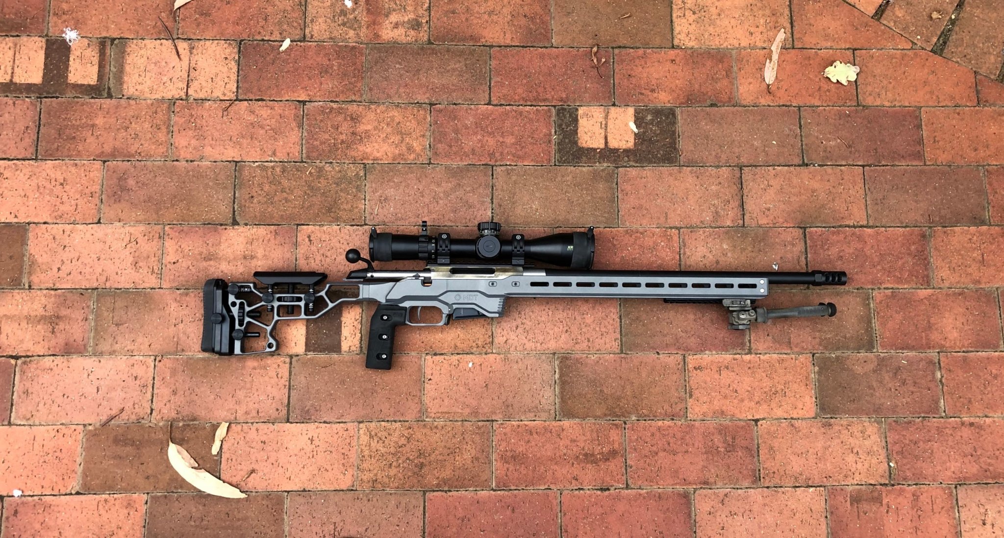

All my other precision rifles are in the 11lb - 14lb weight range, that's fully setup for matches or hunting. It's not difficult to get there with some minor compromises: Carbon Manners, 20-23' tubes, XLR Cheek riser, Varmint/Med Palma contours etc. I've always frowned upon the uber heavy gamer-guns that are all the range. Something about anchor setups seems outside the ethos of practical rifle shooting, so I've always kept an eye on weight when speccing a build.
That said I'm keen to see what life is like on the dark side of gravity, and since I love numbers and tinkering I did some educated guesses as to the weight range I'll be playing with using the MDT ACC.
Previous setup - Tikka 6BR in Manners T5: 5.9kg/13lb (includes atlas bipod)
6BR Weight with ACC Chassis:
Barreld Action + Brake/Scope/Rail/Rings: 3.9kg
Bare ACC Chassis: 2.7kg
Internal Weight System x 5 weights: 1.2kg
Accu-Tac SR-5 Bipod: 0.56kg
10rd AICS Mag: 0.24kg
Chasis Grip + Pic Rail: 0.1kg
Weight Less Backordered Items: 8.7kg/19.2lb
+ Backordered Items:
External Weight System x 3 Pairs: 1.1kg
Chassis buttstocks Weight: 0.29kg
Chassis Bag Rider: 0.06kg
Total weight with ordered items: 10.2kg/22.5lb
Lightest ACC Configuration:
Atlas Bipod: 0.37kg
Total Weight 7.3kg/16.1lb
Highest Possible weight with additional items:
Extra x2 pair external weights: .7kg
26' .243 Shilen Barrel: + 0.3kg
Total possible weight with options: 11.2kg/24.7lb
I can go from 16.1lb - 24.7lb, which is a massive difference. When there's Lots of moving around/carrying the rifle in a field style match, or lots of sling shooting I can chuck all the weight off. Mostly prone/barricades with a minimal sling/legging the rifle, I can load it up. I just hope I can get happy setup behind the rifle - that's always been an issue with the chassis I've played with, so the jury is still out. Should be interesting all the same.
