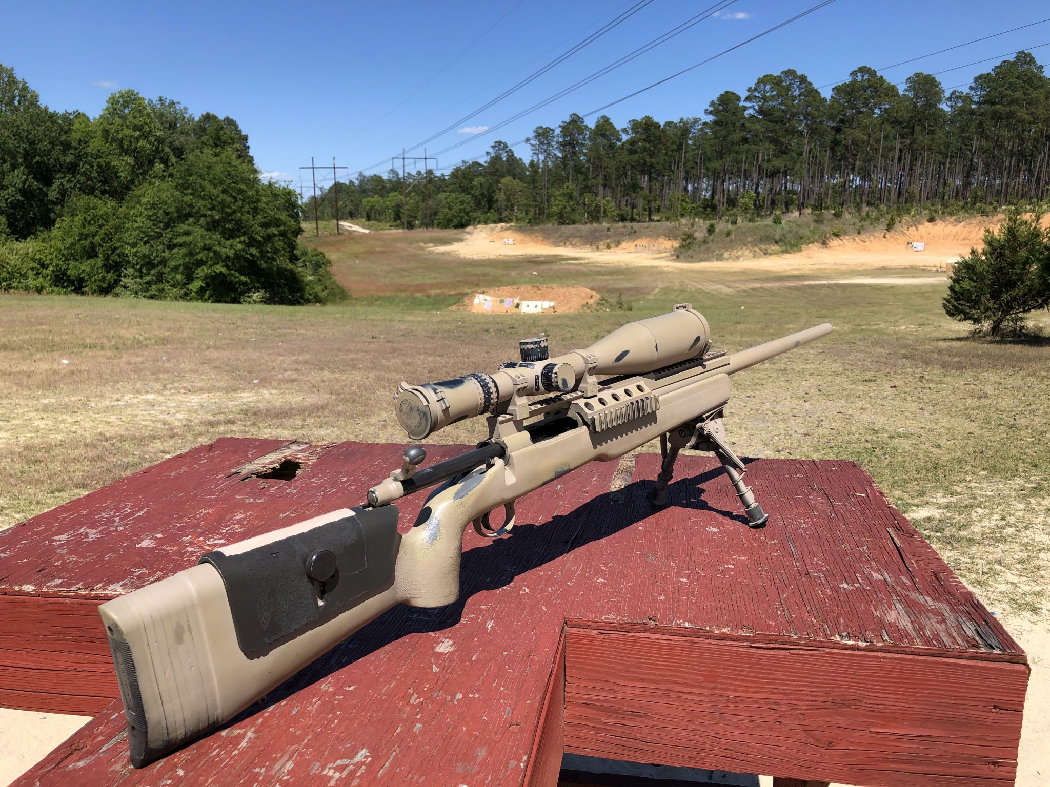

Finally took my mk13 mod 0 built by RWS out for sight in and mild stretch. Rifle shot beautifully out to 1000 yards. Looking forward to taking it further.
Beautiful rifle. I think these hold up well to modern tech after all these years. Any specific changes? Extractor? Chamber reamer?
I can let RWS comment one exact details as he built it. He is in this thread. I kept the stock extractor instead of going the sako extractor. I just was suprised at how much more comfortable the gun is than the mk13 mod 5 is.

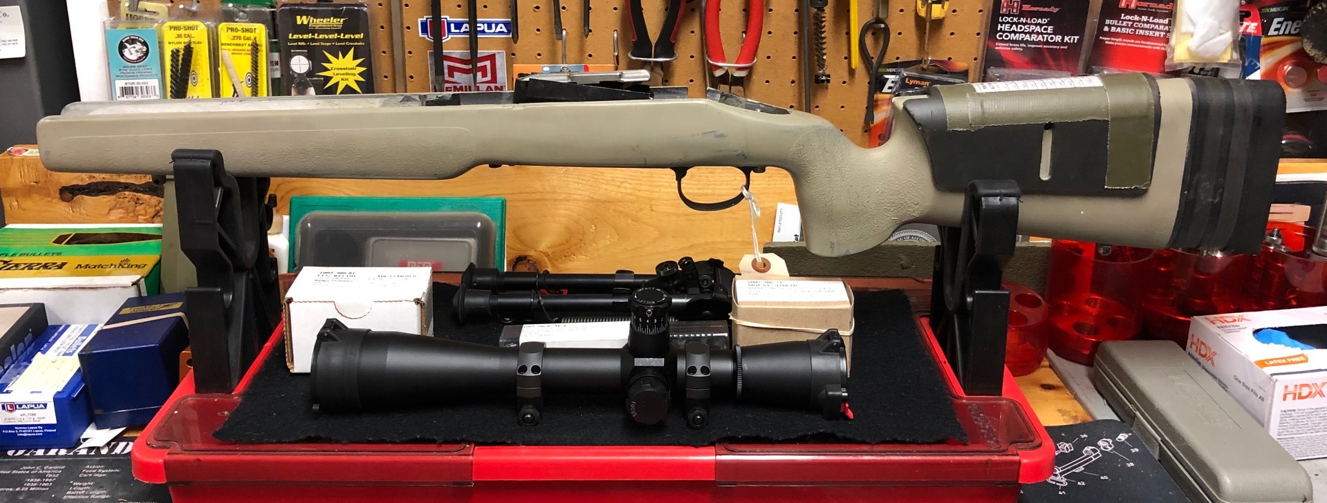

I’ve got a stock, bipod, MIRS & lug coming in on Monday. Just secured an E6 prefix rifle today for $400 on GB. Cannot wait!
Damn you came out better than me on the receiver. I had to fork over $550. Nice find!

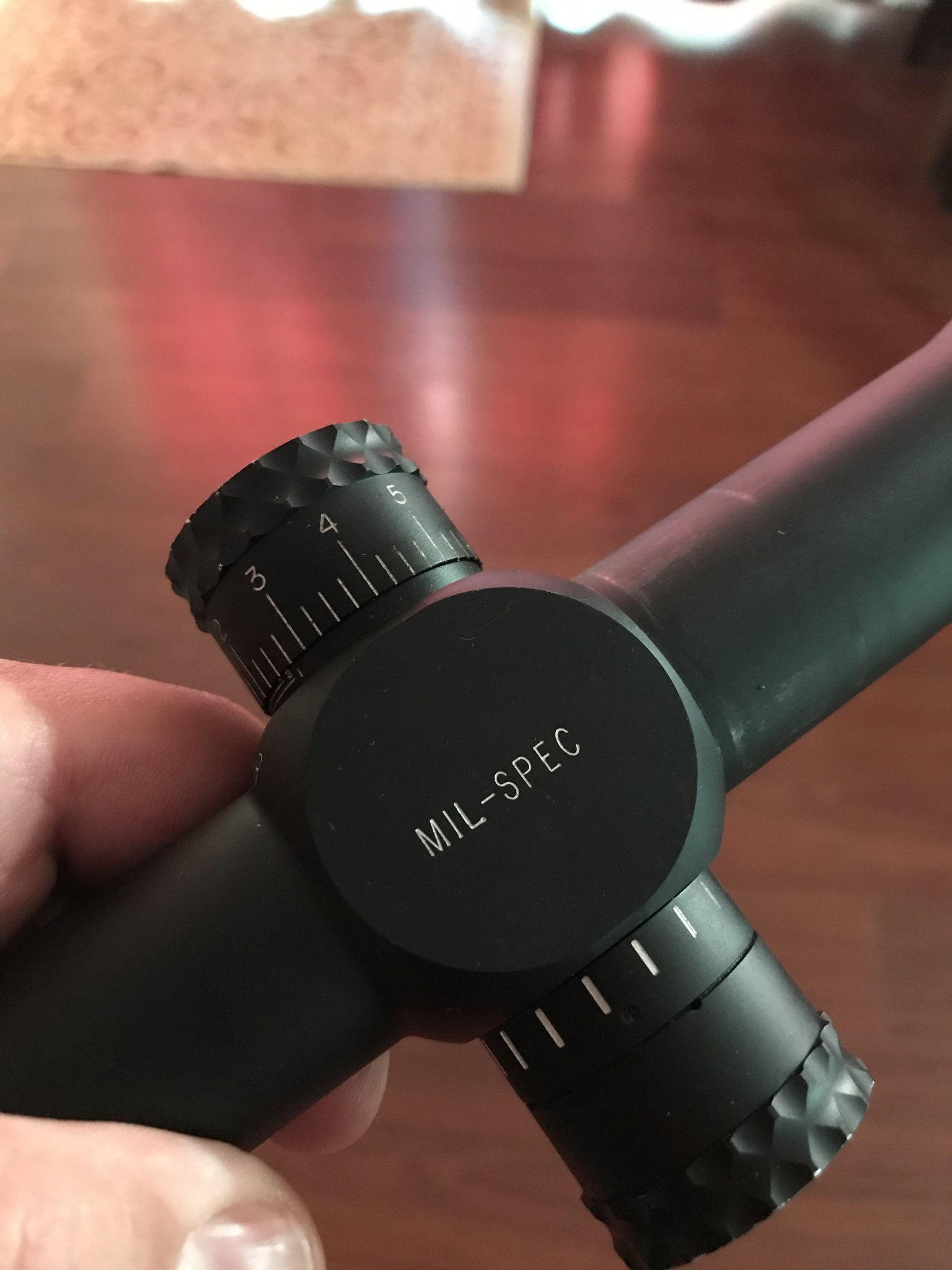

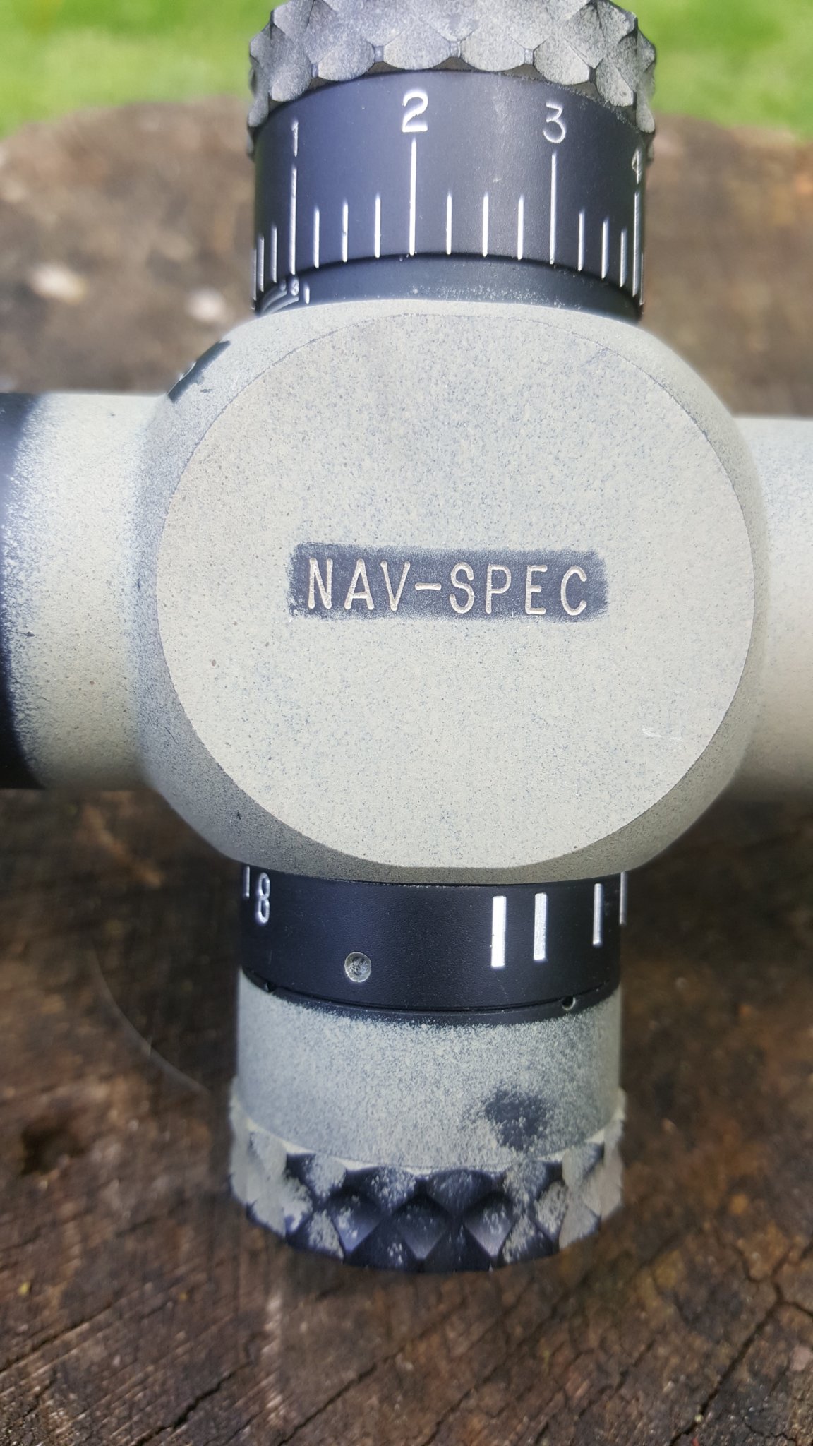

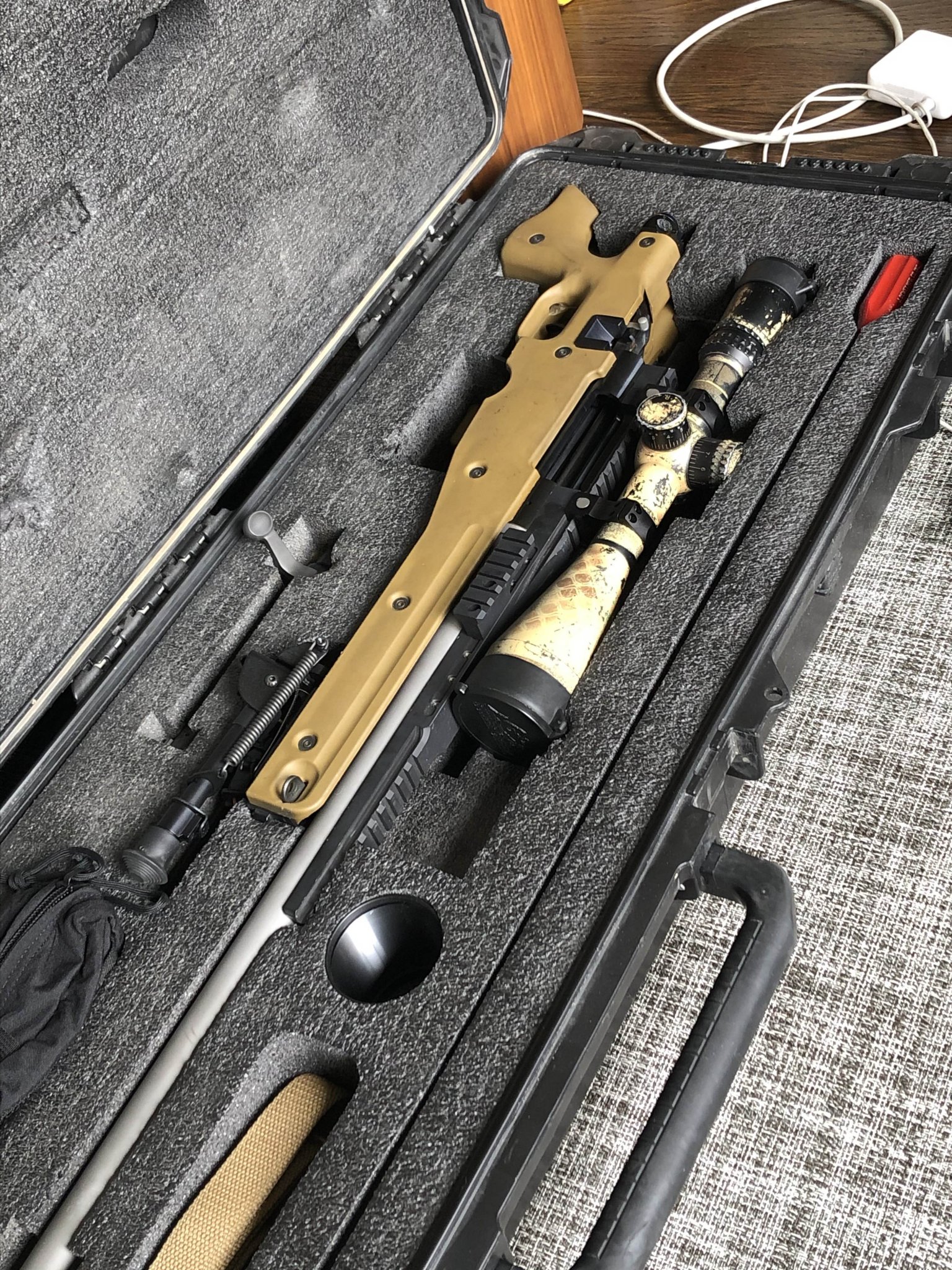

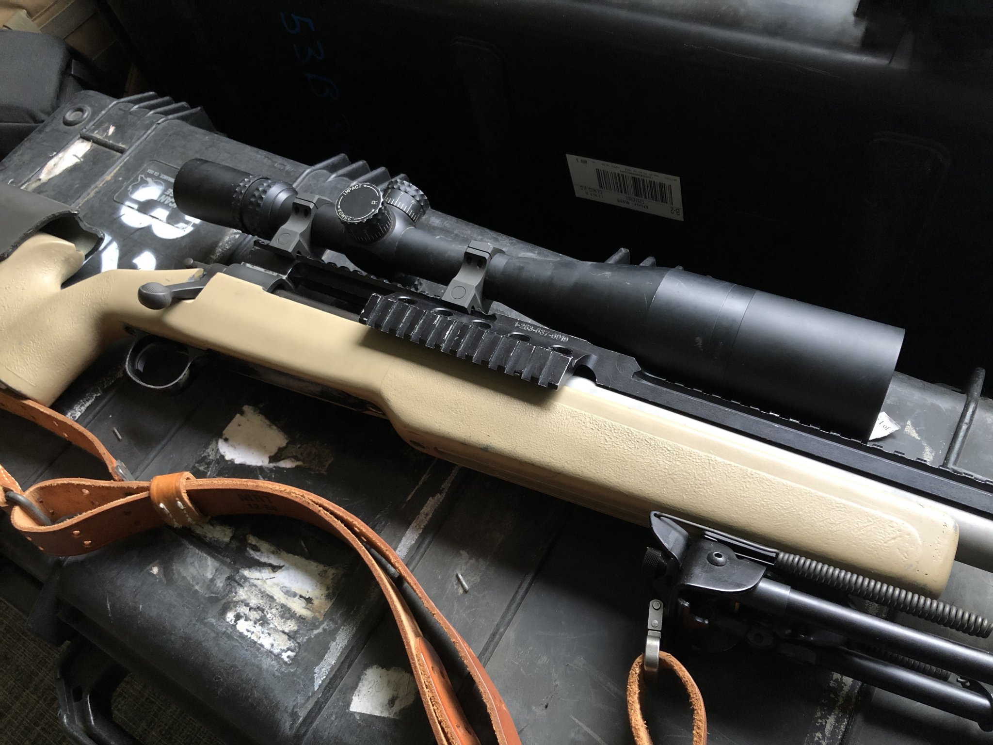

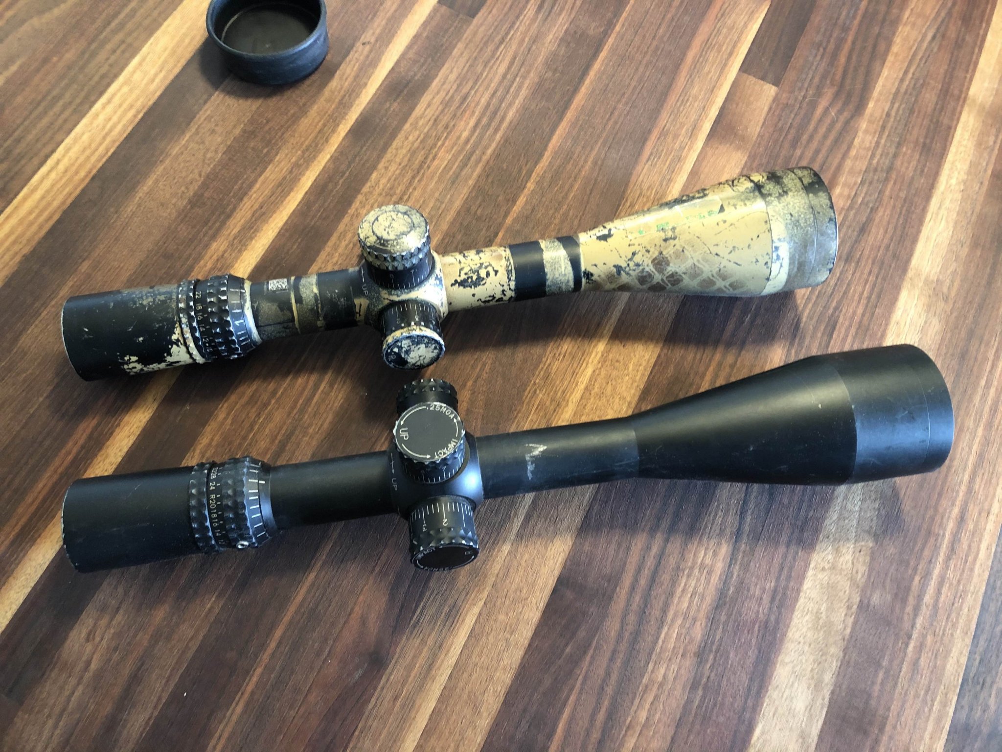

Just want to shout out another forum member on here, who i wont name without their permission, but they helped me correct my MK13 optics. Nav-Spec 5.5-22x56 for the mod 5, and a 8-32x for my first mod 0 w/ rev b mirs.
Oooo NAV-SPEC, Nice!
The 8-32 were issued on the Mod 0's? I was told that all the Mod 0's left the Crane with Mk4 10x's on top and anything else was added after it left the shop.
Chris Kyle is seen with an 8-32 non ZS nxs sitting on a MIRS rev b.
This was likely not an issue optic, but something drafted off of another rifle or a trials optic. The mk13 mod 0 Technical Repair Standard (2005) has the 5.5-22x56 as the supplied optic.

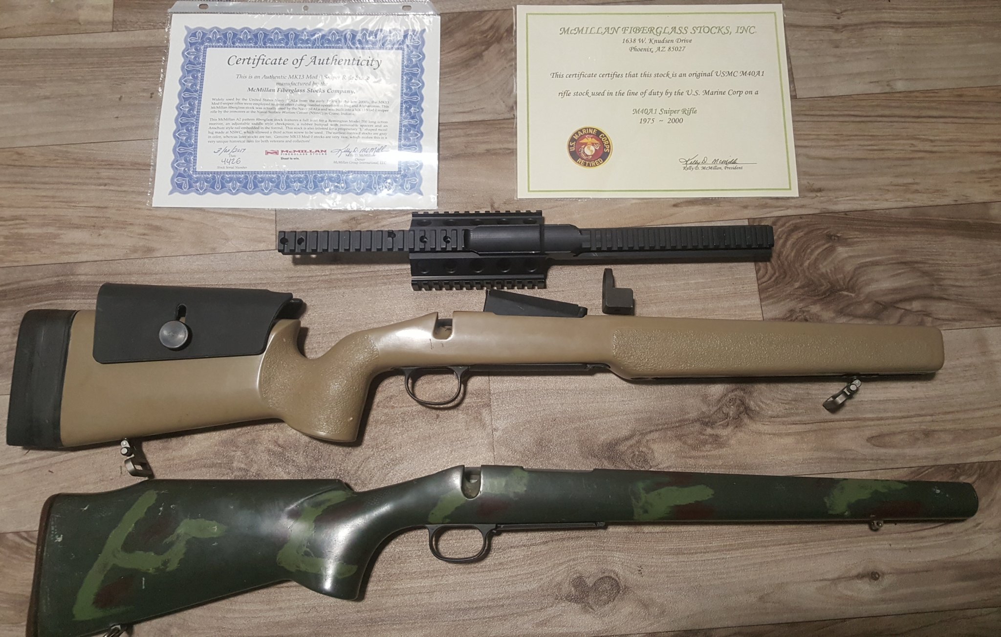

Wow, I wish I had friends like that. A NAV-SPEC scope is a unicorn(!), thanks for sharing that pic...(my Mk 13 gray turned tan stock is a project still in pieces)
They are out there. Got mine last week
Very nice(!), but I have not spotted any such unicorns, and not sure I could afford one at the moment - but I sure do like it(!)

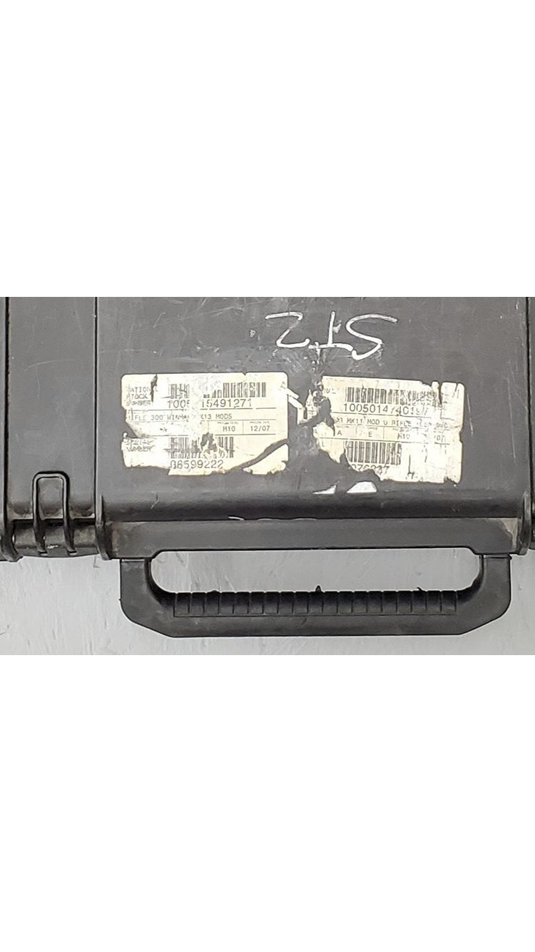

I’m going to be breaking tradition gents. I have collected two 5-25’s that were supposedly issued/overrun from ST-2.
I’m looking for consistency when running between the Mod 3 & Mod 5. Cant wait!
ETA: (The first one I bought was definitely issued but, the paint was apparently removed. The ARD still has original paint. The second one did not appear painted. It is currently back with Jerry at S&B getting a thorough maintenance check and install for a missing objective bezel ring so an ARD or sunshade can be installed.)
