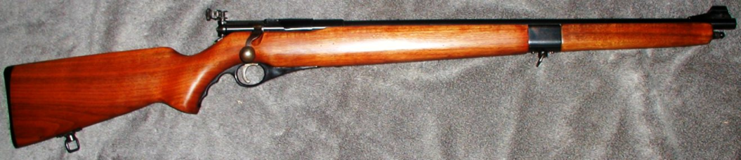

    I have a Mossberg 46M(b) old 22 target rifle. There is a current produtction option for mounting picattiny rails to this rifle using the old scope mount holes in the reciever. A vudoo or something like that is not in my budget this year. Do you guys think that this thing could be used for rimfire comps? I know it won't win any accuracy prizes against vudoo rifles but would it work? These old mossberg target riles are supposed to be fairly accurate.

    The Mossberg 46M is one of my all time favorite rifles, however not really suited for shooting in competitions. It is a classic sporter, especially with a factory Mossberg scope mounted. Your rifle is a really nice looking example. The current Weaver style scope mount sold by the Mossberg Collector Society interferes with the action dust cover so that would need to be removed. The triggers in the old Mossbergs are marginal at best. They can be tuned but will never be as good as a true target rifle.
    I have several of the old mossberg’s, this one included. They are some of my favorite rifles. They are very accurate once you get used to them. I’ve hit a penny at 80 yards with the S-130 peep. If you remove the trigger guard there’s a screw to adjust the trigger pull. You can find parts and scope mounts at havlin sales. There’s also a really nice site for history on the diffrent models and sights
