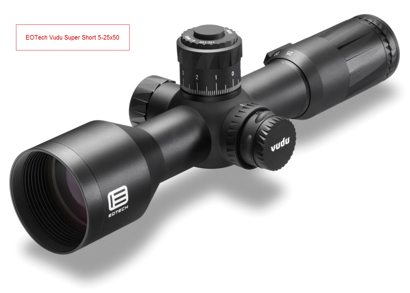

    PSA: Just saw this on CS Tactical's FB feed. That's a lot of scope packed into 11.2".
    Is this a relatively new brand??? Never heard of it...
    Yea it’s very new, it will be shown off at SHOT. Strait from the horses mouth, EOTech claims glass and clarity to rival or be better then the Vortex Gen II’s. Two reticles will be offered initially. One is their MD3 Mil and the other is the H59. The elevation turret locks and wind age is capped. It’s still in proto type status and I was told production is likely slated for July. That’s all the details I know right now.

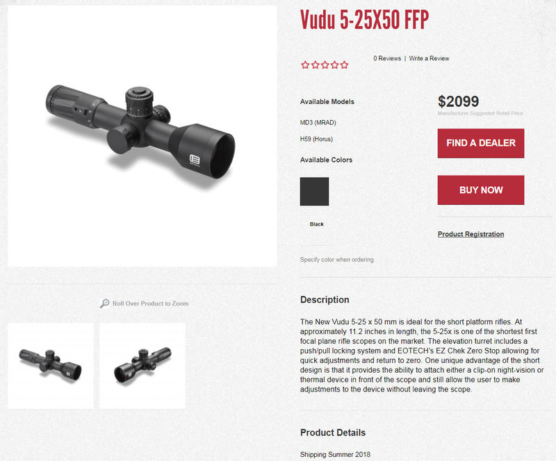

    EOtech has it up on their website now, MSRP is $2099 fulfilling my first hope for this scope - that they would keep the price within reason. Not a Horus fan so hoping the MD3 is something nice and that the glass lives up to the claims Pusher mentions above, that it would rival the Vortex Gen II, if they can do that and the MD3 reticle is usable and the mechanics hold up, then this scope may find it's way onto many covert shorties and large frame AR's in the near future!

    Here's info from their website - http://www.eotechinc.com/precision-r...du-5-25x50-ffp
    The New Vudu 5-25 x 50 mm is ideal for the short platform rifles. At approximately 11.2 inches in length, the 5-25x is one of the shortest first focal plane rifle scopes on the market. The elevation turret includes a push/pull locking system and EOTECH’s EZ Chek Zero Stop allowing for quick adjustments and return to zero. One unique advantage of the short design is that it provides the ability to attach either a clip-on night-vision or thermal device in front of the scope and still allow the user to make adjustments to the device without leaving the scope.

    Was looking at the scope again and couldn't help but notice that while the scope is only 11.2" long, the front objective is set rather far back from the front housing reminiscent of the Minox ZP5 5-25x56 design, almost looks like EOTech could have shaved another .5 - .75" off and made it even shorter, but part of what I like about this design is it acts as a mini sunshade. I wonder if the scope is prone to issues with flare which is why they designed it this way?
