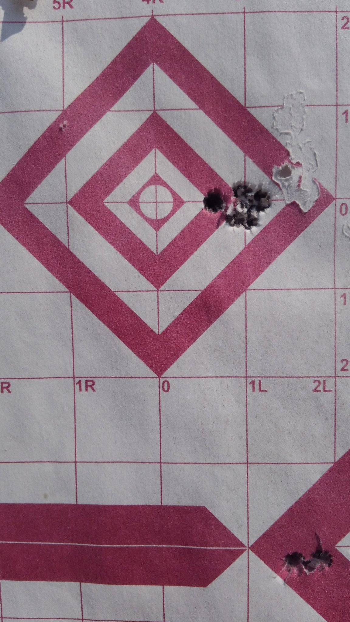

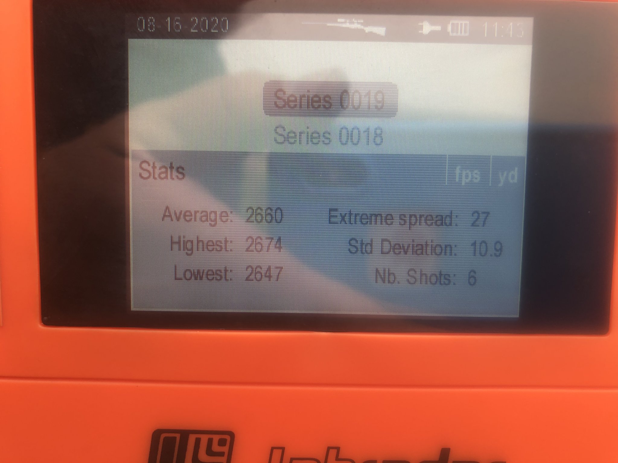

Lab radar with factory 108 to follow (next week at the earliest)View attachment 7397203
Just put the first 20 rnds down the same barrel with factory 108’s . It held 1/2 to 3/4 MOA at 300. I was pleasantly surprised with the speed but am also running a ultra 7 on it.

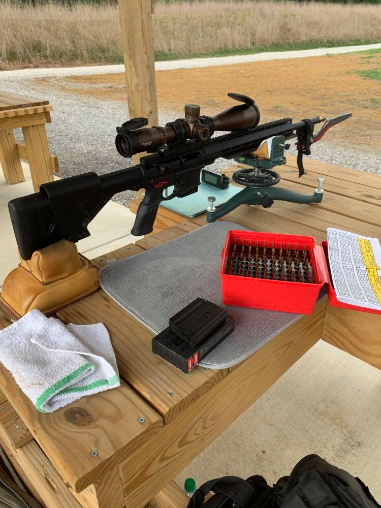

Have been reading @Ledzep and other's posts on this thread. Just put together my own 6mm ARC AR-15 and am beginning load development. Nice looking group you shot up there. Was that 100 yards with an AR or a bolt gun?
My goal is to find a 1/2 MOA or better load that feeds out of the magazine in my AR-15 platform. I'd like to be able to reach out to 1000 yards with that platform. This is for shooting steel and as I plan on using 108 ELD-Ms or 105 Berger Hybrid Targets, 2550 FPS will achieve the distance part of the goal.

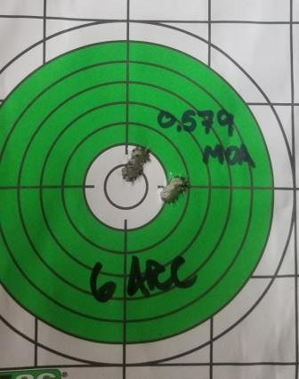

I have only broken in my new 21 & 3/4" barrel. It is a 7.7 twist Wilson. I used Varget and 108 ELD-Ms to do that. After the 20 or so break-in rounds I did shoot three 5-shot groups with with a charge of 27 grains of Varget. Speed was in the 2626 FPS range as measured by Labradar but the barrel is still new and will likely speed up a little. SDs were in the high single digits with this charge. Group size of the 3 groups were .9, .7 and .3 MOA at 100 yards.
Just for comparison, I did shoot two 5-round groups with Hornady Black 105g factory ammo. I shot groups in the 1.4 and 1.1 MOA range at 100 yards with them. Speed was 2700 and 2705 FPS with SDs of 21.8 and 17.3. This ammo shot 2 MOA groups in the previous barrel.

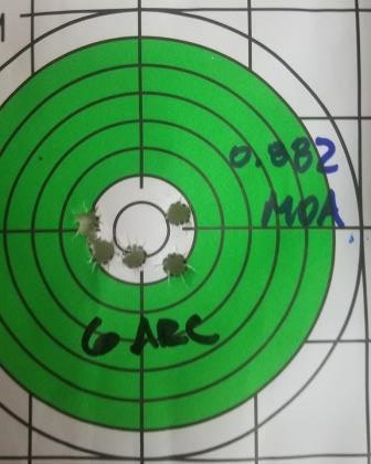

My group above is out of my 18" AR-15. I have only really broken the barrel in, about 80 rounds of various stuff I've thrown together with CFE223, AA2520, and LeverEvolution. LeverEvolution and AA2520 seem to be decent for me so far in the AR, and LeverEvolution is what I also use in my bolt action.

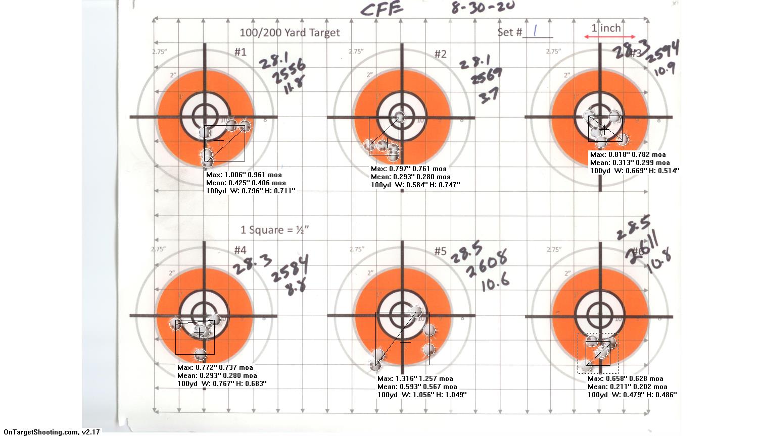

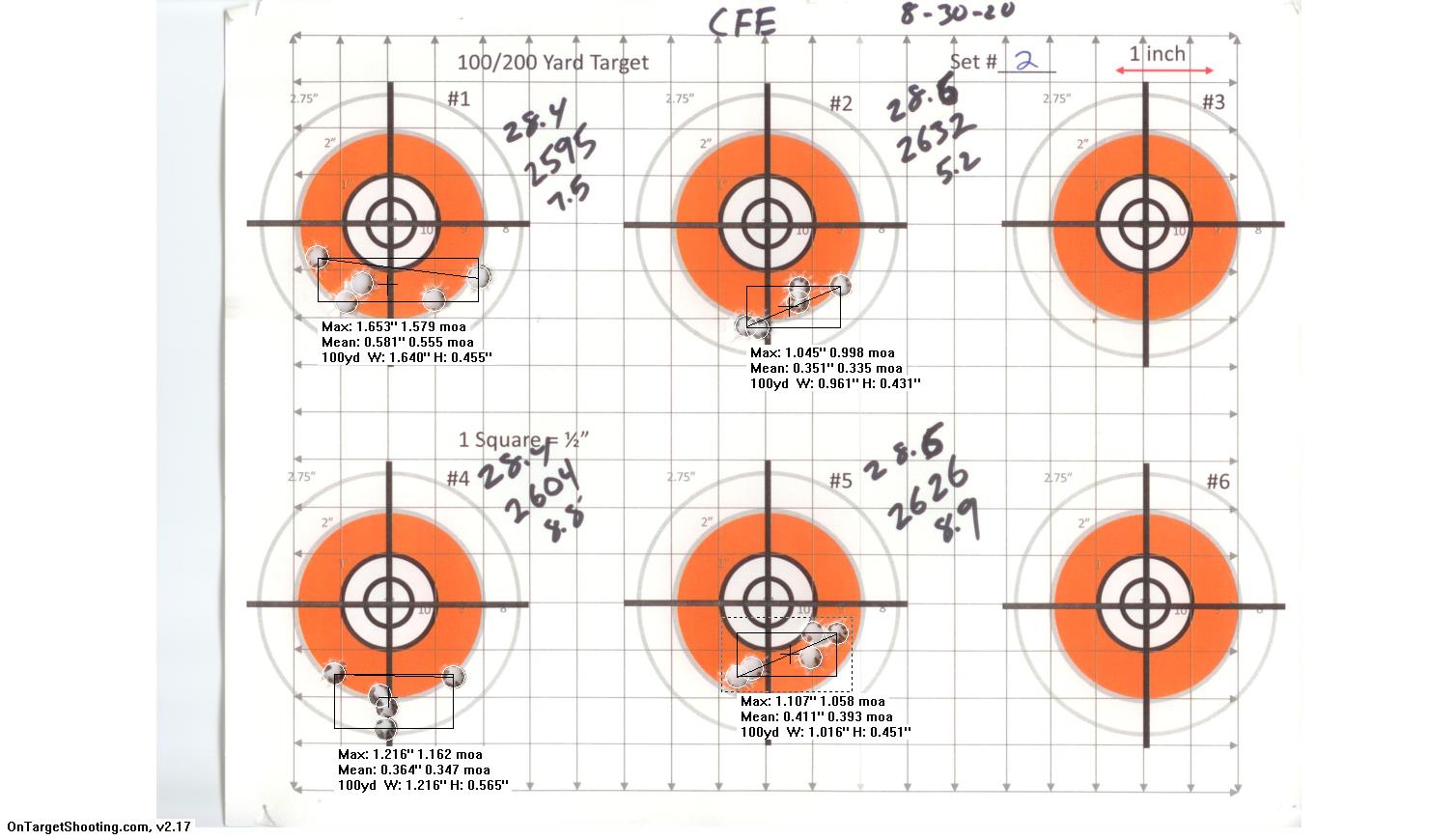

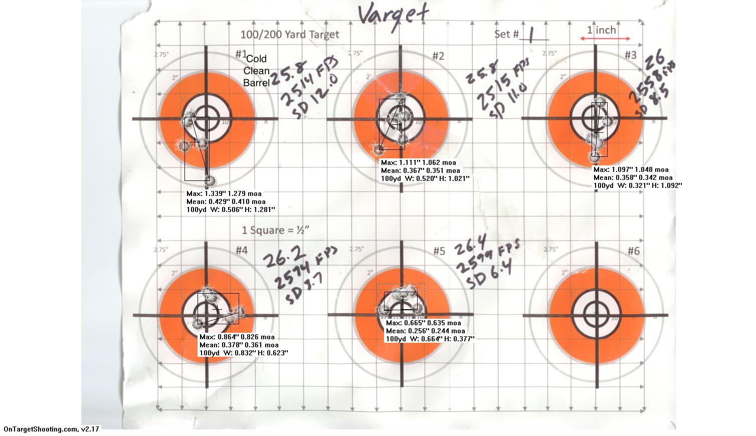

Alright. I am getting a little happier. Shot some tests today with Varget and CFE223, results above. Need to test a few increments more with Varget as it looks like the group was just starting to tighten.
CFE223 did okay today too. I need to test both a little less powder and a little more powder.
All of these groups were shot with Hornady 108 ELD-Ms loaded to a COAL of 2.260". I shot from prone with a Nightforce 5.5-22X50 scope using an F-Class bipod and rear bag and an Accu-Wedge!

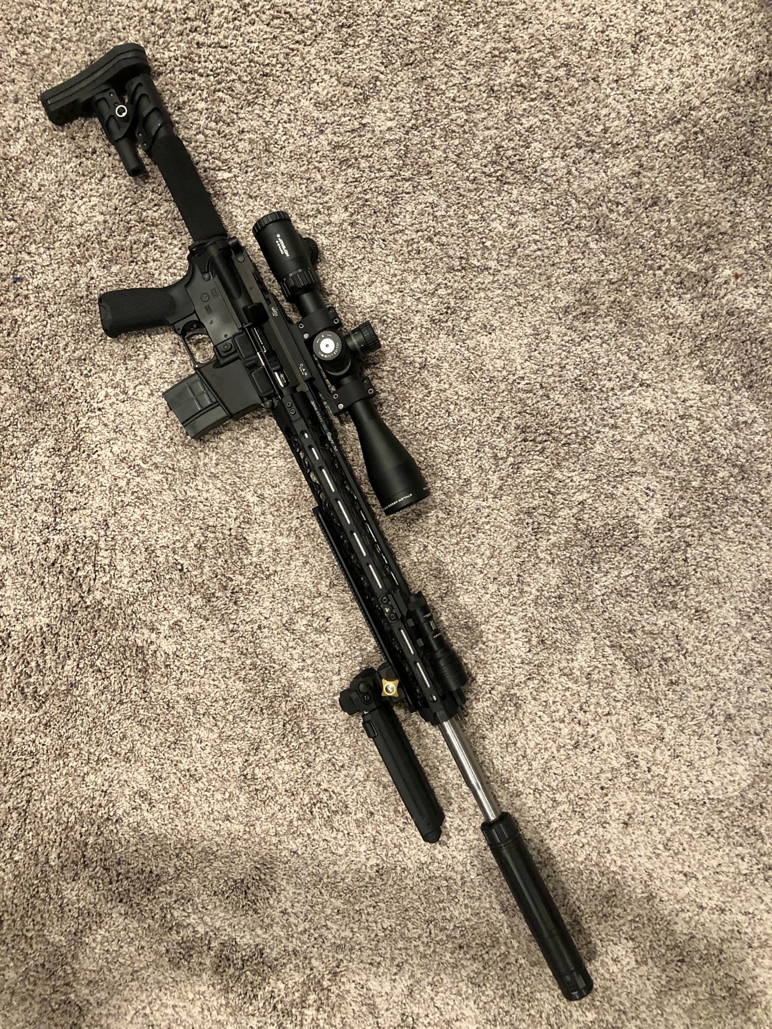

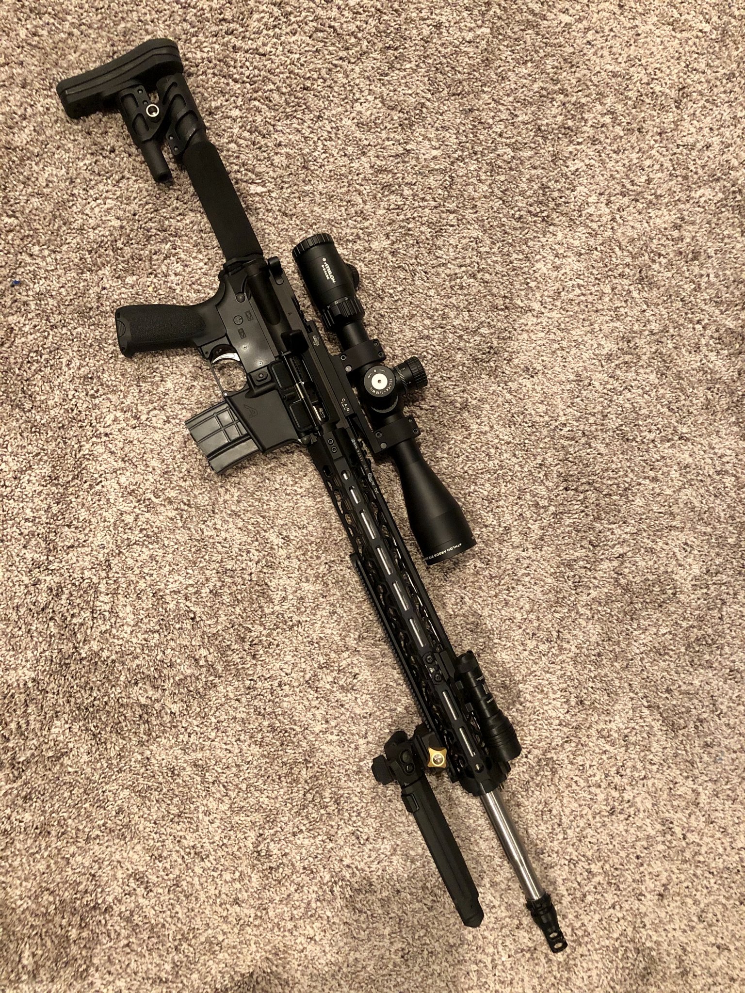

I wouldn't say there is anything special about the build.
The lower: YHM lower, ergo grip, luth AR MB1 stock, a triggertech independence special trigger, and Cproducts defense 10 round magazine. The trigger is actually incredible for the $150 I paid for it, very consistent feel.
The upper: AR Stoner upper, midwest industries 18" suppressor ready handguard, 21" odinworks barrel, odinworks adjustable gas block and tube, brownells 6.5 grendel type II BCG, ASR brake, Vortex Strike Eagle 5-25 in MOA, and a Leapers UTG 34mm scope mount.
I got the longest handguard I could find as I didn't want a lot of the barrel showing and I wanted the gas block covered. The 0.875 odinworks adjustable gas block doesn't fit under many handgards.
I was just shooting it with a LRA bipod on the front, a silencer-co omega mounted to it, and a rear bag in the back.

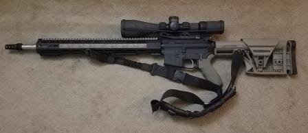

I just took the plunge. Ordered a BCM upper and an Odin 18” barrel w/ BCG and gas system. The Odin is out of stock, but it’ll get here when it gets here. Deer season is close, so I’ll be playing with the 350 Legend for a while anyway.
I might add a carbon fiber hand guard, but I have a 12.5” Odin that I’m not using right now.

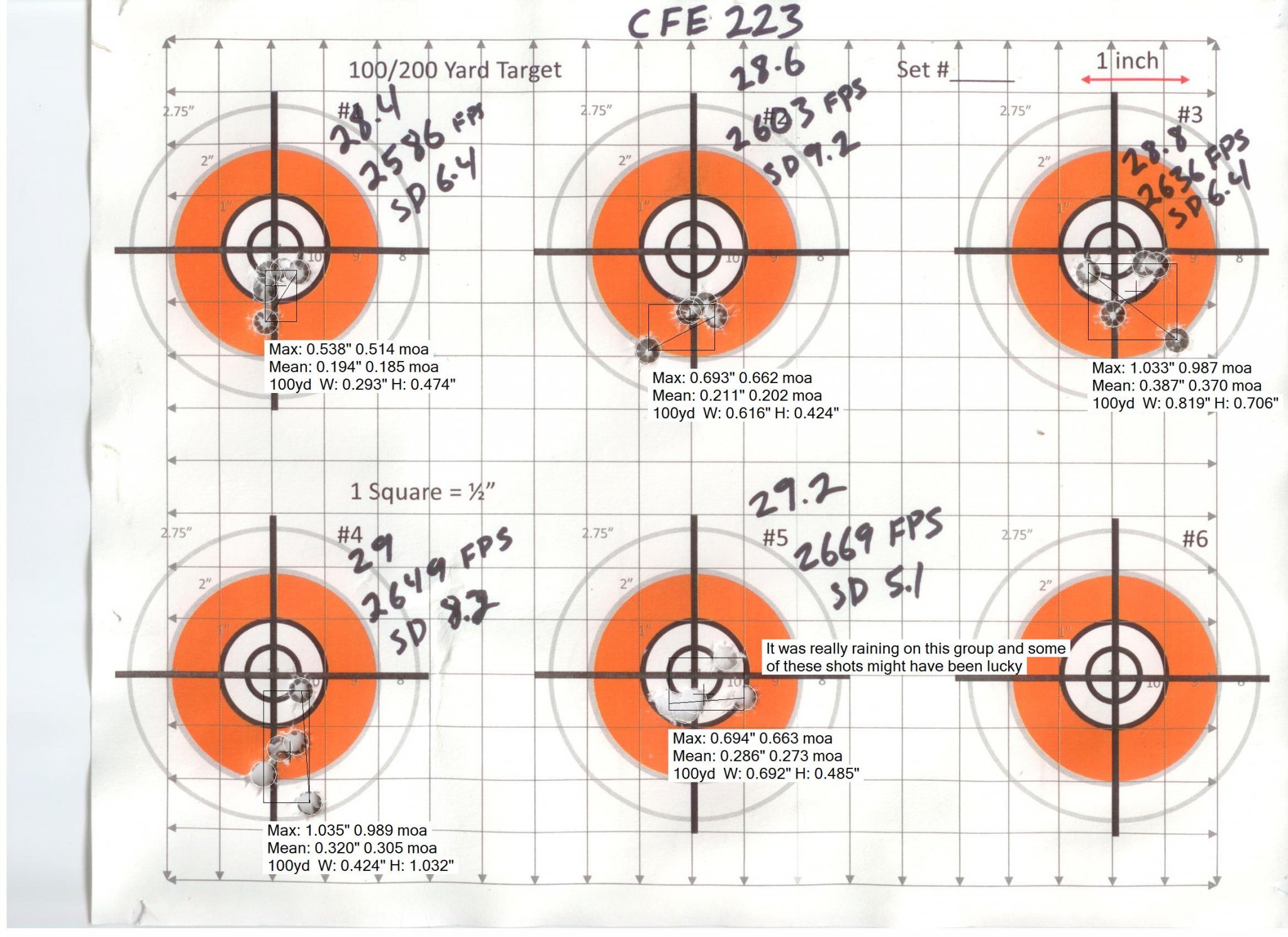

Spent some time at the range today and based on results from Friday, I thought I had a good idea of a good load. I was looking forward to posting up some pics of target pages filled with .4s and .5s.
It didn't turn out that way.
From all the data I have collected, 28.1 to 28.3 grains of CFE 223 behind the 108 ELD-M produce the most consistent groups--not the most accurate but almost always less than 1 MOA. The average, so far is .81 MOA.
In all honesty, I am struggling with consistently holding the rifle the same way from group to group. Shooting a bolt gun is much easier. I tried a few different things today and some clearly didn't work. I changed my hold to a more aggressive front bipod load on the second sheet to ill-effect. Not a smart thing do while looking for a load so, I'll have to retest some of that...
