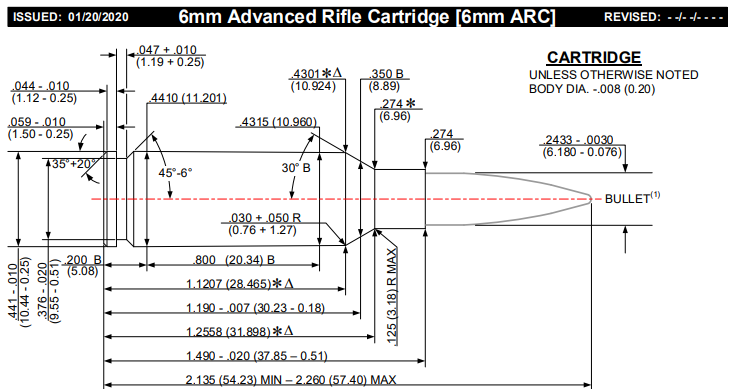

Minimum SAAMI spec is 2.135 to a max of 2.260, but you do not want to load the Hornady 105's past 2.200. The profile of the bullet will push it into the lands and jam it in their. Any of the other heavies can be loaded all the way to 2.260. I load the Nossler 105 RDF's to 2.215, they are a different profile than the Hornady's, they are a little longer but skinnier so they don,t contact the lands. Here is some load data for you. Hornady's site has the 108 data on it, I don,t have it on this computer but it is the same as the 105 data except the OAL is 2.245, found it and added.
Guys, if you want the OAL to be "in that sweet spot" you really need to test groups at different OAL in your rifle. Don't make the mistake of assuming the factory stuff is at an optimum OAL.
Also, learning how to find the max OAL for your chamber is important and is the first step before you ever charge a case with powder. Don't just go by the numbers in the manual or whatever factory ammo is.

Good info, but I may be missing how you meant it to relate to my comment (asking since you quoted it)?
My point is, if you're looking for best performance, test different OAL in your rifle, don't just go by what the factory stuff is or what the manual says. The "spec" doesn't mean anything in relation to what OAL your rifle will shoot best with, and each rifle barrel is it's own beast. On top of that, you may want to adjust OAL as the throat wears, so knowing how to measure your max OAL with a particular bullet can tell you that info.
Figuring out your max OAL is the starting point (sounds like you know how to do this I think but this is really aimed at MTxTwelve) then test loads in a range of ~.100-.150" leading up to that depending how thorough you want to be, and how much magazine constraints affect things. I've found that's actually more effective than searching for a powder charge node; often I've found the accuracy I'm looking for at a workable max load (meaning just enough under max to be useable long term for many reloads). If not, you've still found the best OAL, and can adjust powder charges from there.
For example, in my 24" 243 LBC the max OAL for the 105gr BTHP is 2.260, so I ran an OAL test between 2.255" and 2.155" in .020" increments to start, then fine tuned from there. That test showed me the best accuracy was at 2.235" with a max charge of Lever. More importantly though, that OAL gave me good accuracy with mixed charges varying between 30.0gr and 31.4gr. I'm using 31.0gr for that load for best velocity and best accuracy but still retain good performance even if velocity drops a bit in cold weather, because that OAL shot well across that whole range of charge weights. (although fwiw I didn't lose as much velocity in the cold as I expected, but it doesn't get much below about 20° F here.) Charge weights for the 6 ARC are a grain or more lower of course, depending on the throat geometry, and your OAL will be different, but the same principle applies.

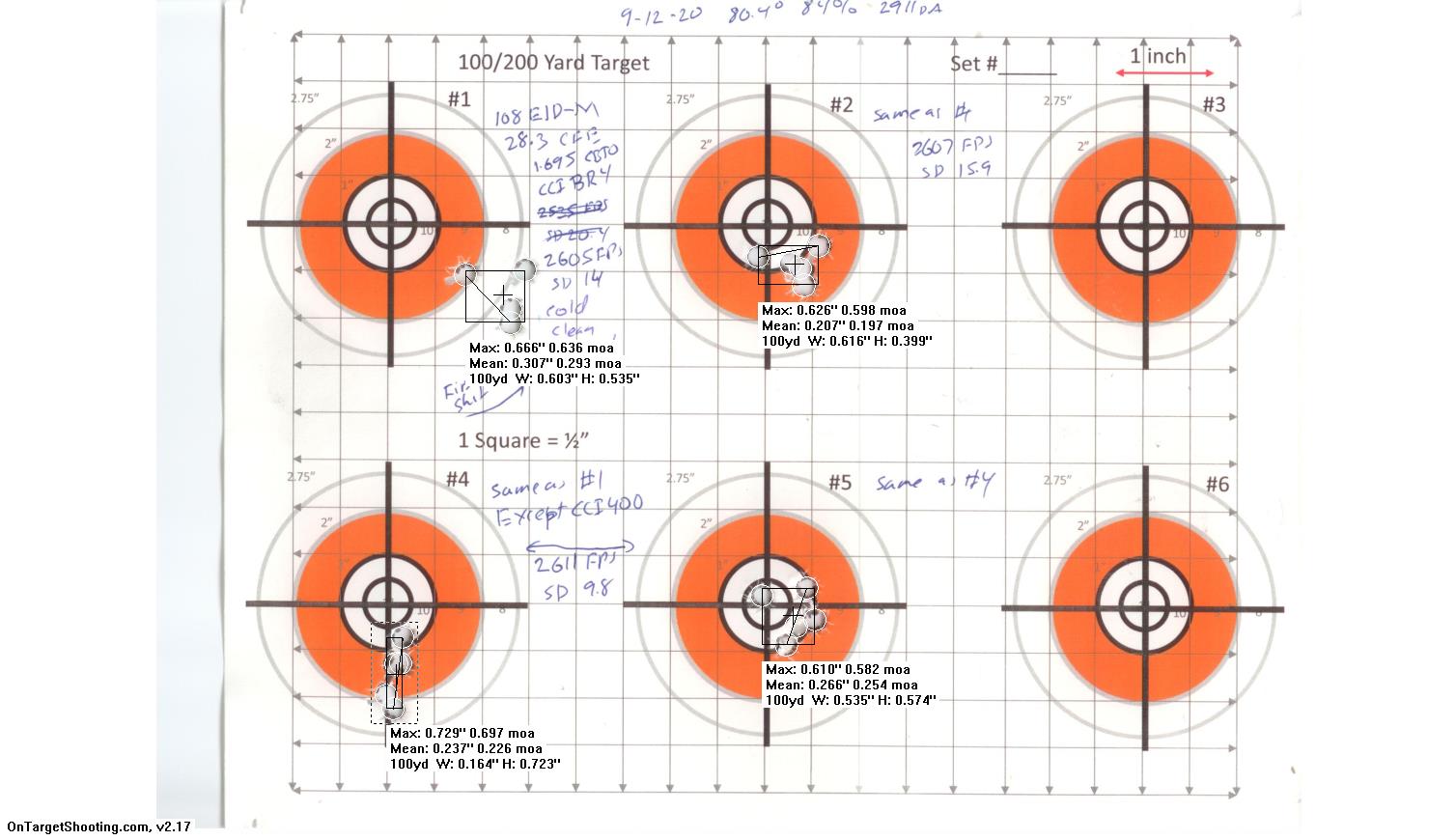

I tested CCI 400 primers today VS the CCI BR4s I've been using and @ormandj and @Constructor were right! The primers worked fine and there was no real change in velocity. The CCI 400s were a little flatter but not pierced or even close. No hang fires or any other unexpected behavior. The MV was 4-5 FPS faster and SDs were actually better with the 400s.
Target was shot prone at 100 yards using Harris bipod and rear squeeze bag. All groups were fired by single loading except the bottom right group which was magazine fed.
A little more load development is necessary but this is a load that I can play with while continuing the less fun work. Barrel has 270 rounds through it as of today and there is some noticeable gas port erosion on the forward edge of the hole.
Henryrifle
Reactions: ormandj
