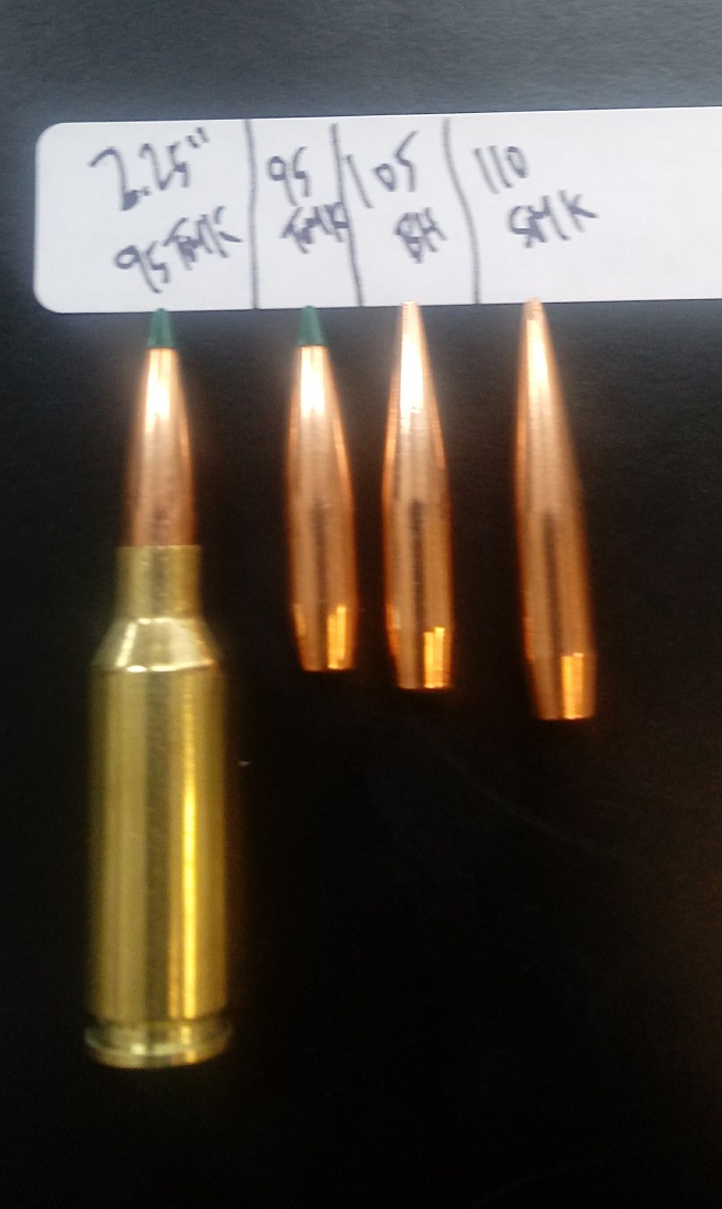

So I couldn't get N540 and either a 105gr Berger Hybrid or 95gr TMK going without pressure signs. I was so excited with the potential for the 95gr TMK, thinking 2800fps was possible from my 20" Craddock.
Loaded to 2.25" and at 40*F, here are my results:
105gr Berger Hybrid and N540:
  • 28.0grs - 2603fps AVG, 9 STD. Slight pressure sign. Outstanding precision, 0.5" at 100
  • 28.5gr - 2656fps AVG, 12 STD. Pressure signs. Outstanding precision, also 0.5"
95gr Sierra TMK and N540:
  • 28.5gr - 2685fps AVG, 21 STD. Pressure signs. Outstanding precision, 0.75"
  • 29.0gr - 2723 fps AVG, 15 STD. Pressure signs. Don't know on precision, as I was shooting steel at 400yds.
So 2000MR, RL15, and N540 are all producing pressure signs at MVs >2600 for both the 105gr and the 95gr. Terrible. Precision is great, everything is under 1.0".
To illustrate this, I'm attaching a loaded 95gr TMK at 2.25", next to the 95gr TMK, the 105gr Berger Hybrid and the 110gr SMK (these are all the 9mm bullets in my inventory.
If anyone has any reloading suggests, please post them up. Thanks

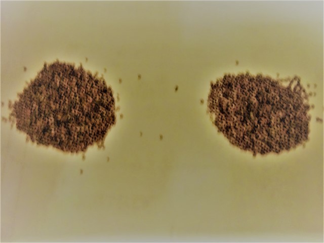

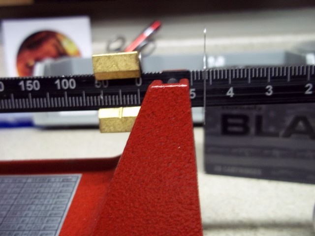

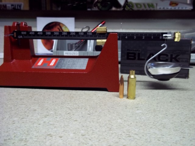

I tore down a Hornady 105 today and weighed it with my beam scale and I got 29.7gr of what looked like CFE22.
Hornady powder on left. CFE223 on the right
Interesting they are using CFE223 (or what looks like it) - picture is a little blurry but that looks like straight CFE223 and not a blend. Happen to pull a 108gr as well? I like the additive package in CFE223 and have 8lbs here to test. I just fired and cleaned a bunch of brass this weekend so will be loading soon. Still keeping my fingers crossed that I can get decent velocity our of AR-Comp and not worry about anything else, I just wish I had a pressure testing system to get 'real' numbers. I looked at the Pressure Trace II but it's hard to mount on an AR15 and the numbers may or may not be accurate in absolute terms, only relative.

I'll try to get a better picture of the powder.
If I was a betting man I would say they do... It just looks exactly like CFE223.
Yeah there's a family of non-cannister ball powders (Upwards of 5-10 different powders between CFE and StaBall) that are the same size/shape but different burn rates. It's not uncommon for ammo makers to mix them to tune the burn rate for a given cartridge.
Just got done annealing 100 cases; decided to quit being lazy. L.E. Wilson isn't making seating dies yet, so I'll have to get a blank and machine it later, I'll just use the Hornady dies in a Co-Ax for now.
I have a good source at Hornady. Just sharing what I was told.
I don't doubt it, I'm just saying it is pretty darn hard to tell much from a picture in terms of burn rate.
Lots of canister grade powders available to ammunition manufacturers that are not available to public.
