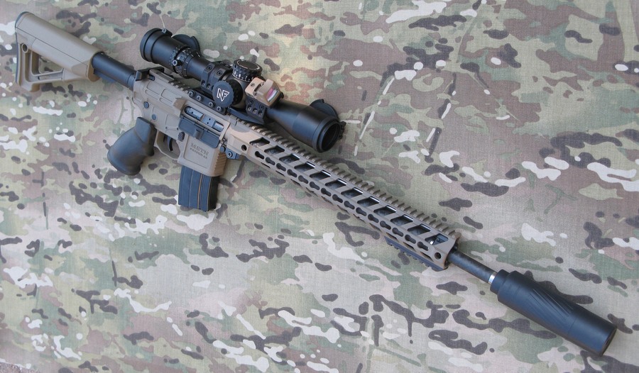

The setup below weighs 6.7 lbs without the scope and averaged 2618 fps over 5 shots (Labradar) from the 18" barrel with 105 Hornady Black.
First group was 6 shots after break in and cleaning. The cold bore shot was 1.5" or so low.
Second group is 5 shots immediately after the first group.
Third group was fired more quickly immediately after the first two groups.
I'm really interested to understand the vertical stringing of the third group as Carbon barrels have been great at mitigating that in the past. Certainly could be me, but I don't think so :)
So far really impressed by the cartridge - a 105 with .530 BC traveling at 2618 (over mach 2.25) literally demolishes a 123 with .493 traveling at 2380 (mach 2ish).

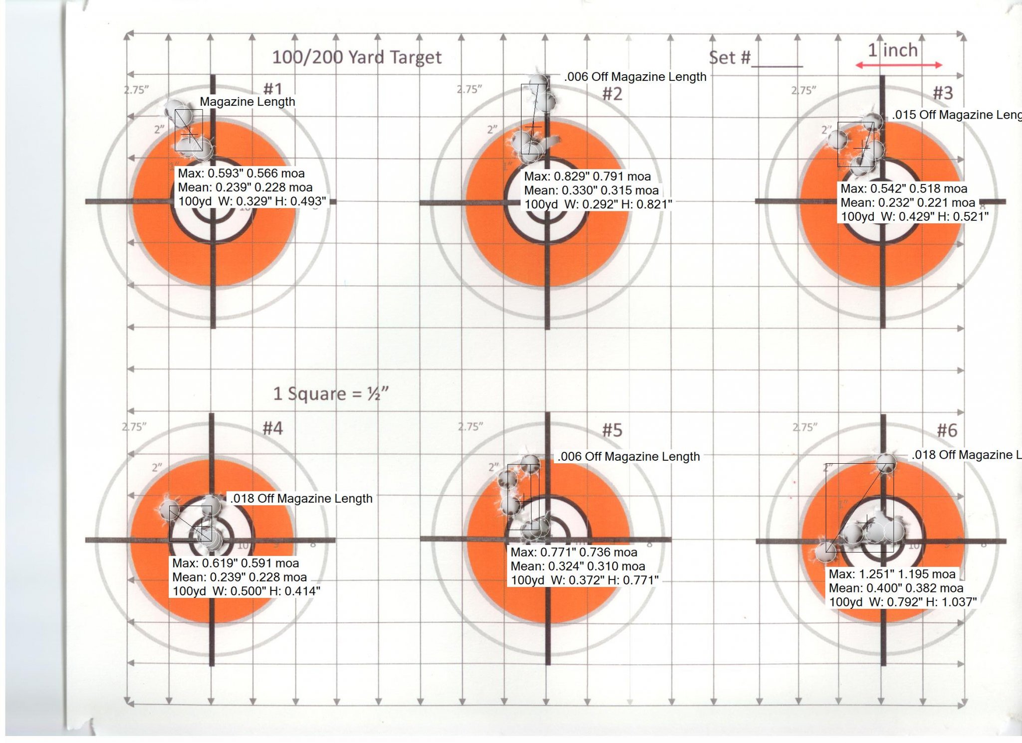

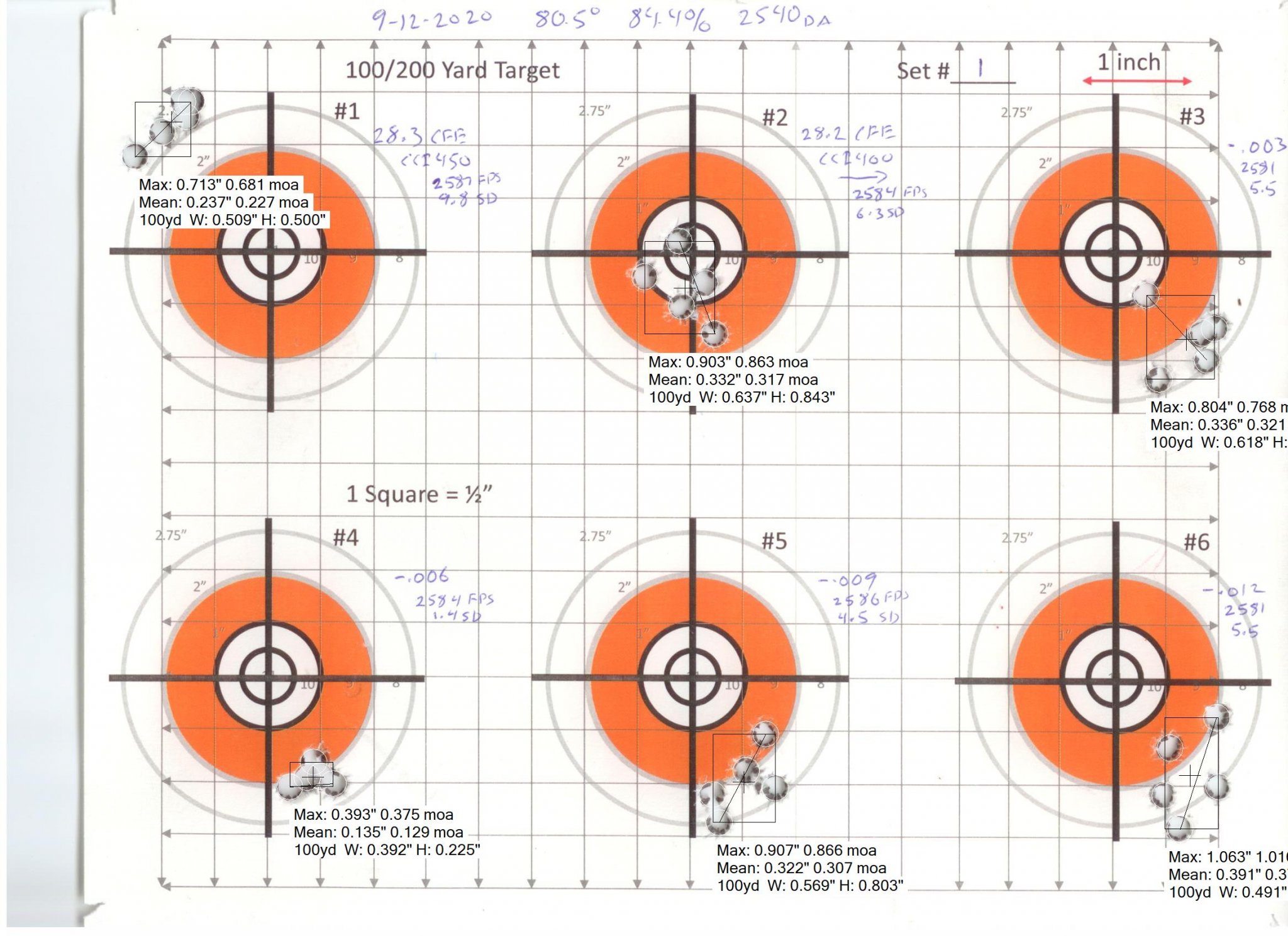

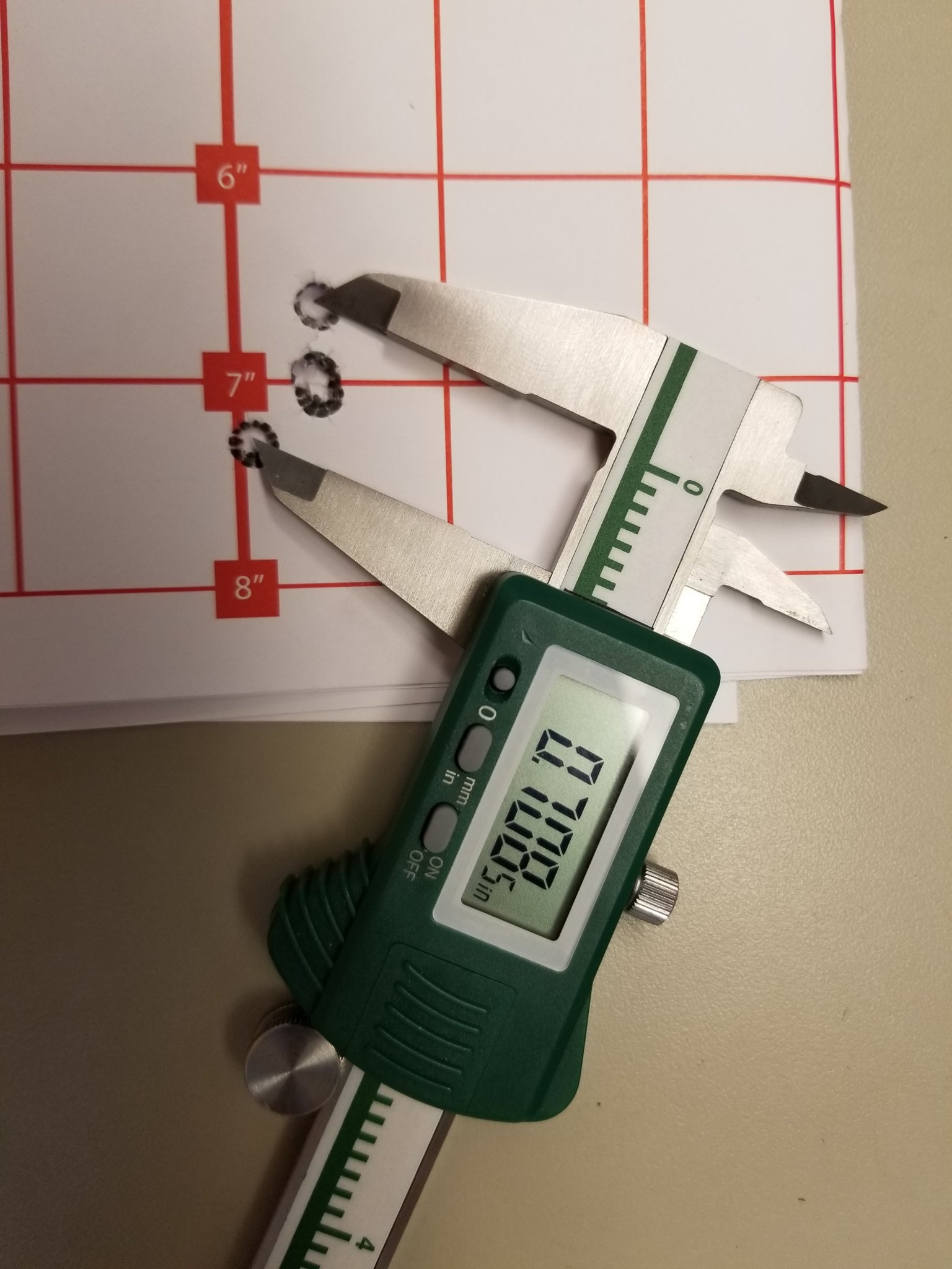

Spent some time at the range today testing two changes. Wanted to verify that changing from CCI BR4 primers that I want to conserve for competition to CCI 400s was as much of a non-event as initial testing indicated.
That remains true even in temperature that is 7 degrees cooler than the last test. I even reduced the charge weight by 1/10 of a grain as the CCI 400s create slightly more MV than do the BR4s. SDs with the 400s are also better even when comparing the worst of the SDs with the BR4s. Not what I would have expected.
The second part of the test was seating depth. I started at magazine length and shot seven 5-shot groups increasing (making OAL shorter) seating depth by .003" in each subsequent test.
All of this was shot at 100 yards from prone using Hornady brass, Hornady 108 ELD-M projectiles, CCI 400 primers, Harris bipod, Bigfoot rear rest, Nightforce 5.5-22 and TBAC Ultra 9 suppressor.
Results:
COAL—MV—SD—MOA
2.260—2584—6.3—.86
2.257—2581—4.8—.76
2.254—2584—1.4—.37
2.251—2586—4.5—.86
2.248—2581—5.5—1.01
2.245—2585—13.4—.5
2.242—2586—12.7—.44
All of the above were shot with 28.2 grains CFE223. If you graph the results there is a definitive repeating wave-like pattern of increasing and decreasing accuracy. Unfortunately, better accuracy correlates with increased SD for the shorter two nodes (2.245 & 2.242). Will retest the three best groups to see if any repeat.

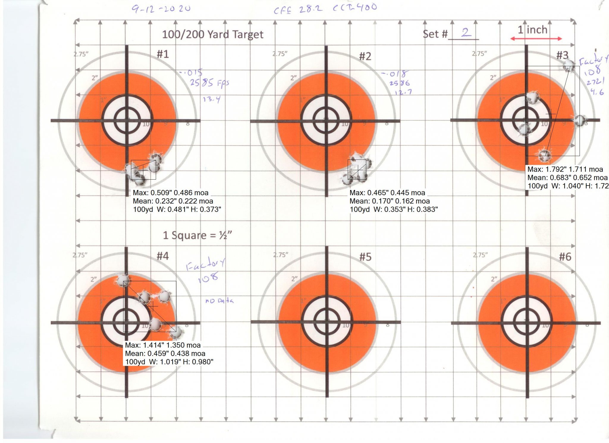

Attached are the targets from today but ignore the hand written date and temperature information on top of the target. It really was shot today, 9/26 and the temperature was 73.5 degrees with 80.3% humidity and a density altitude of 2322 feet.
Bonus info: I finally did receive some Hornady 108 ELD-M factory ammo. The speed is impressive out of my 21.75” barrel at 2721 FPS with an SD of 4.6 but the accuracy was disappointing at 1.7 MOA and 1.3 MOA. I shot the second group as carefully as I could. I may have been a little less precise on the first group.
Last note. That .86 I shot at a COAL of 2.260 is at the high end of the normal spectrum. The rifle and that load averages .68 MOA but it is what it is.

wow, what a stark difference between your reloads and factory. Nice tight groups vs disasters. thanks for posting.
Results:
COAL—MV—SD—MOA
2.260—2584—6.3—.86
2.257—2581—4.8—.76
2.254—2584—1.4—.37
2.251—2586—4.5—.86
2.248—2581—5.5—1.01
2.245—2585—13.4—.5
2.242—2586—12.7—.44

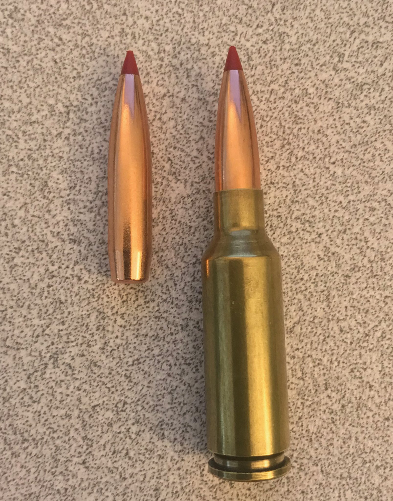

If you still have some 108 factory loads, would / could you post a picture of a 108 laying beside it? I'd like to see how much,if any, of the bearing surface of bullet is below the neck/ shoulder junction,if any.
So your velocity with factory ammo is almost the same as mine using a 21" barrel. It’s sad to see there isn’t a powder available that gives similar performance to the factory stuff without pushing pressures.
Attached photo is one of my reloads that measures 2.2540" OAL. At most it is .006" shorter than a factory loaded round. That's a lot of projectile below the neck!
@tomcatfan: the CFE223 load that I am working with at 28.2 to 28.3 grains is .9 grain lower than Hornady's published max. I think there is a good amount more velocity to be gained and I haven't tried LEVERevolution yet. There is nothing special about the load I am developing other than it meets my goal of staying supersonic [really close at 1260 fps] out to 1000 yards and shoots close to .5 MOA.

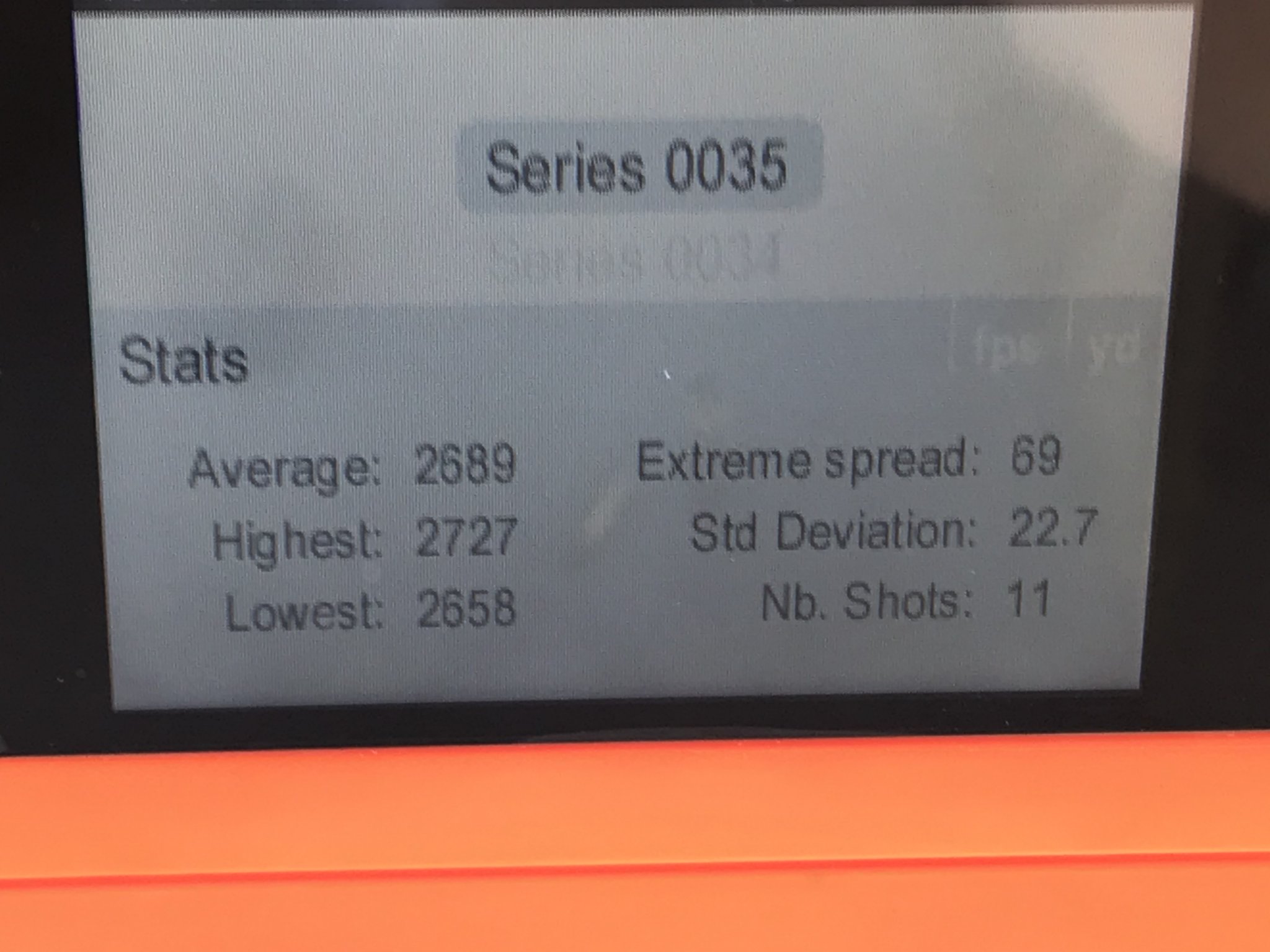

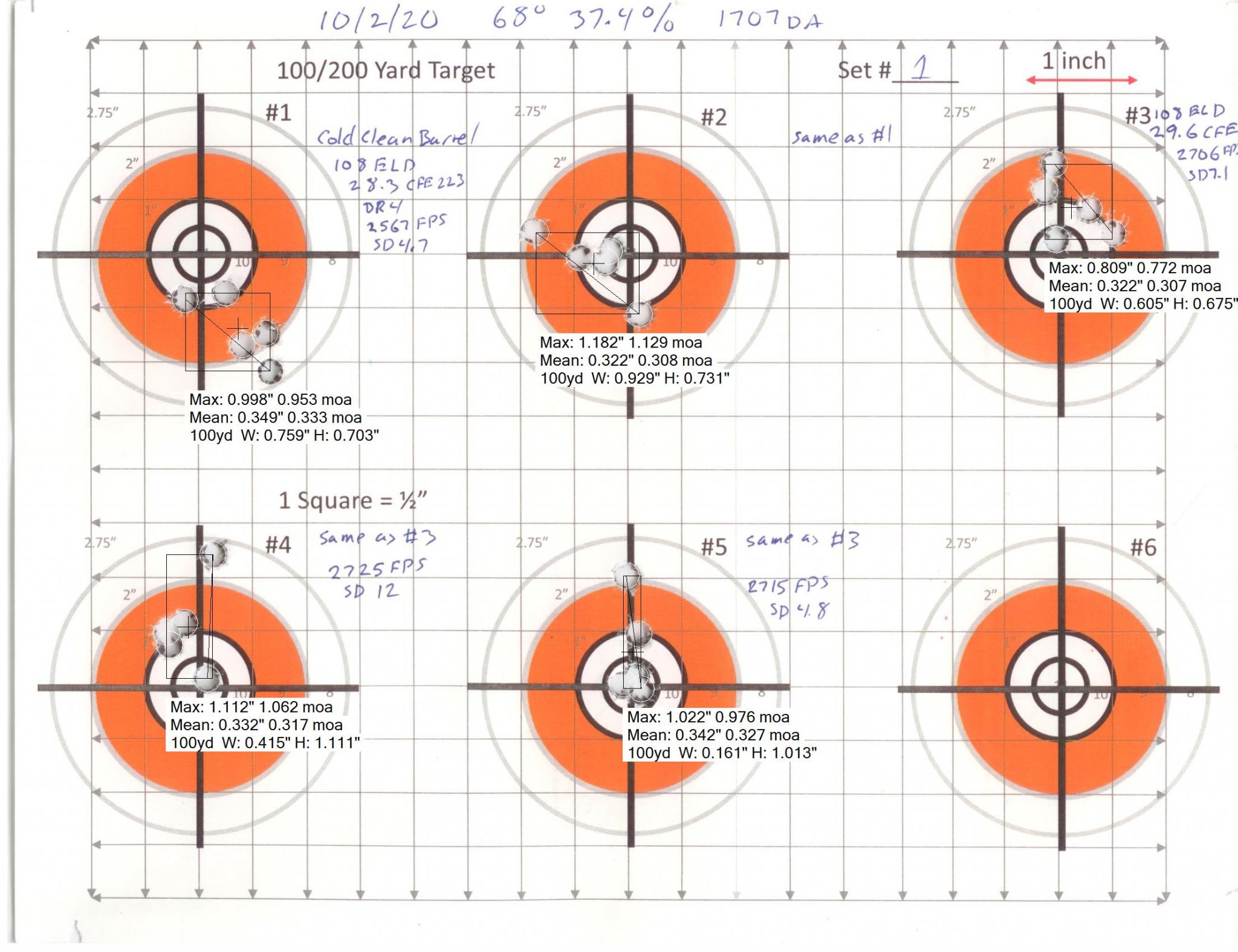

I got a hall pass and dashed out to the range to retest the seating depths that looked so promising from above. Some days I am just off and I knew right away today was one of those days. No excuses though. I know I pulled one shot in the 5th group but once I retrieved the target I realized that it didn't kill the group size. It was the highest shot. I can't explain target 6 but I know it was poor gun handling that spread it out.
One interesting observation. It was 4 degrees warmer today than the last outing and speeds were up about 16 FPS. I will have to look back at other data and I don't imagine that it is linear but does anyone have an estimated MV increase per degree of temperature for CFE223? These two days would indicate 4 FPS per degree but that seems high??
My conclusion from this testing is that this gun with this load and me as the shooter create average groups of .75 MOA and I know I can put together a box of 50 or so and have fun shooting steel out to 1000 yards. That also gives me freedom to try other powders and charge weights.
Lastly, CFE223 seems REALLY dirty. I know ARs get dirty fast suppressed but CFE223 seems especially dirty.
1.3-1.7 fps per degree with CFE 223.
MV avg. settles in after about 10-15 rounds in a string. By that I mean you get a large enough sample size to get past most of the noise. MV will also slowly walk up as the barrel fouls. I've seen 7-30fps per 50 rounds depending on caliber. Most are 7-15.
@Henryrifle ......thanks for the picture of bullet beside loaded round. Yes cfe 223 is on the dirty side , its all i use in 223 and 22 nosler.because it meters so well and the claimed copper eliminator......which seems to be some what true. Will be interesting to see the difference between it and leverlution in your tests.

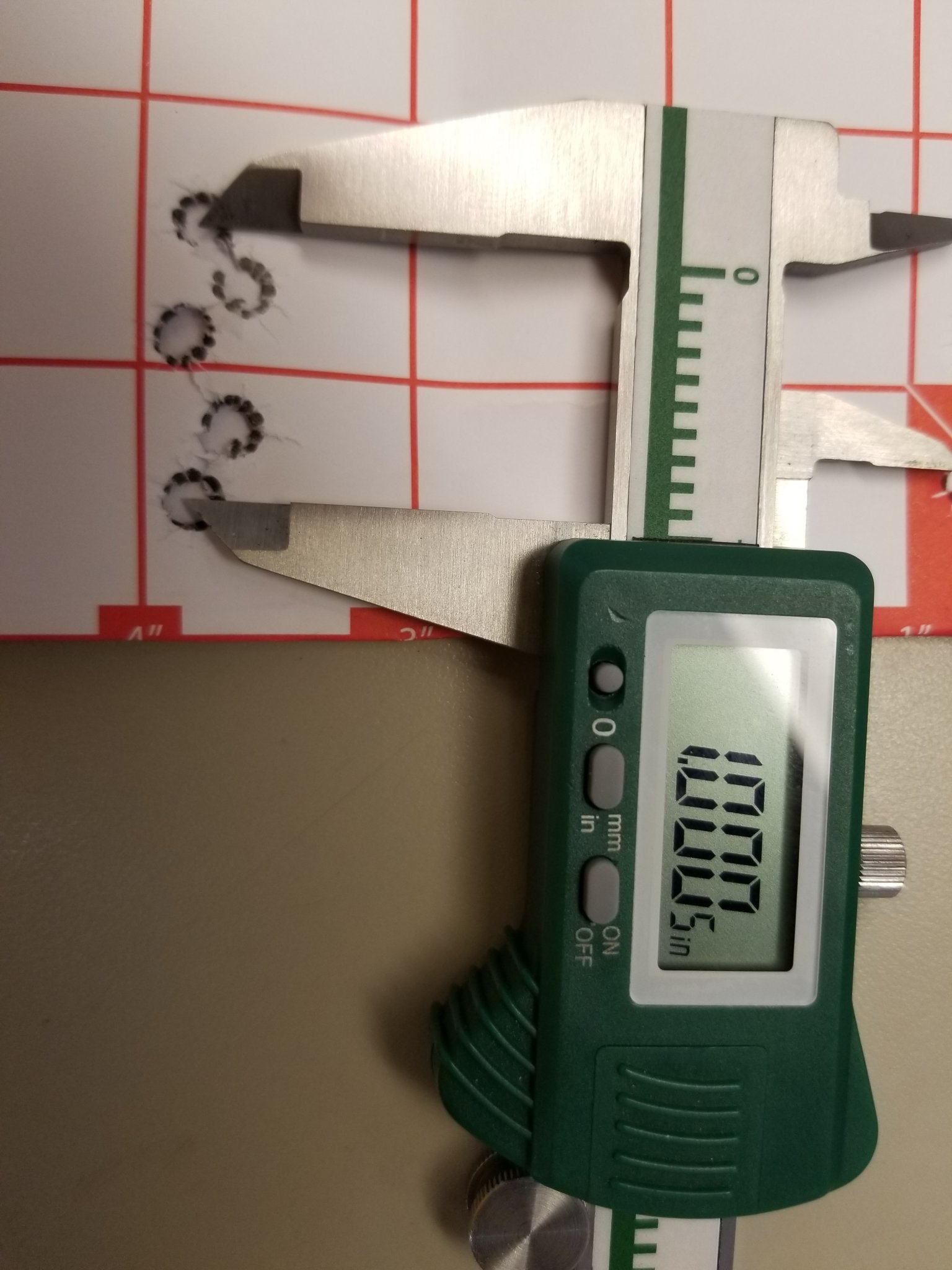

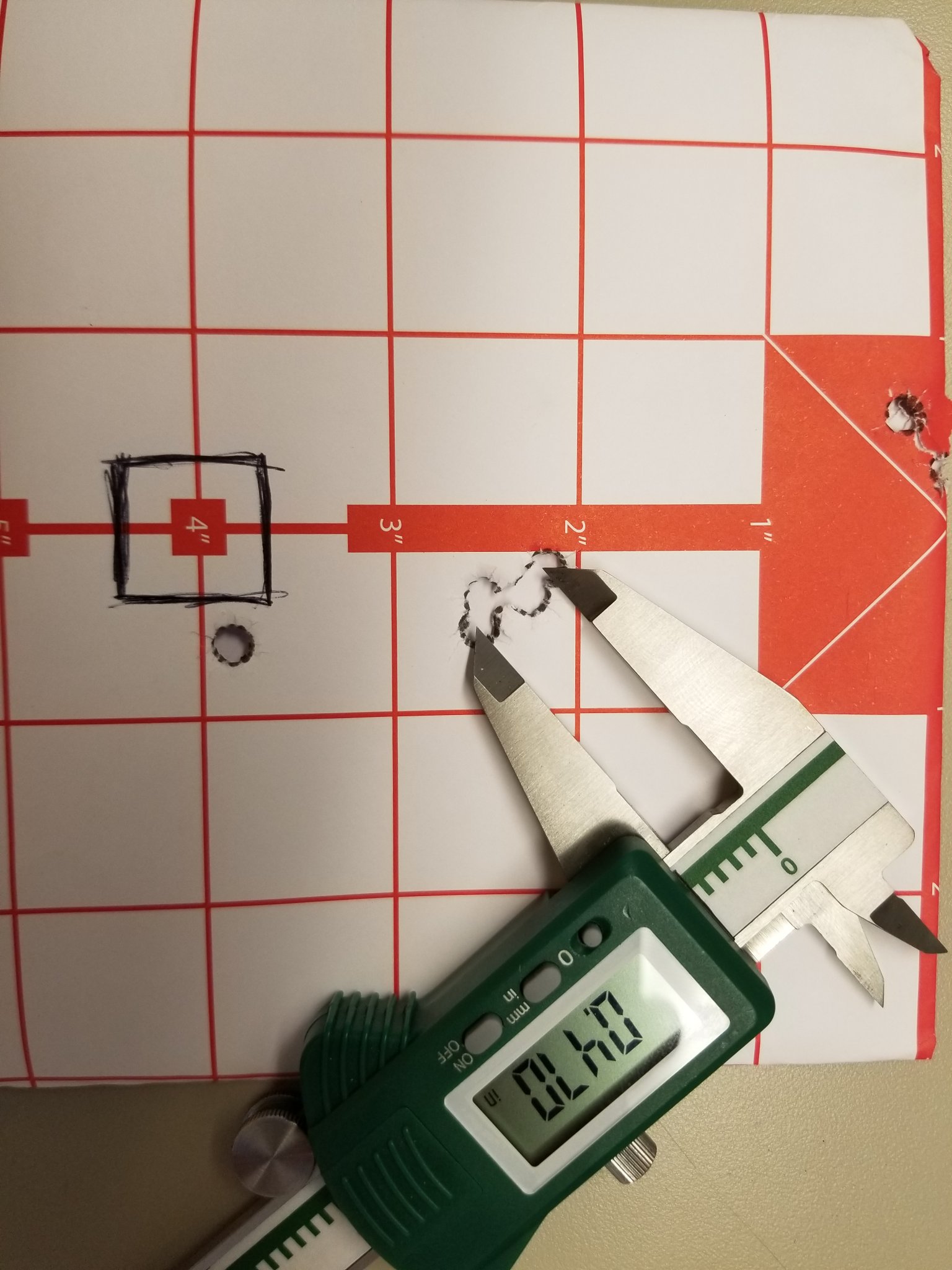

@ormandj: It looks like your gas port is half on a land and half on a groove but the pic is blurry. That is where mine ended up. I thought about trying to hit a groove but without a mill, it would have taken some luck. I know there are folks who insist one way is better than another but there has never been any conclusive consensus that that is true. I have an old school Hawkeye borescope and don't think I could take a picture but my gas port has some scary looking erosion after 400 rounds. Nothing unusual but still not fun to look at. Mine was a clean hole to start with no burr resulting from the drilling.
Please go shoot that thing. Now that I am interested in AR-Comp, of course, you can't find it ANYWHERE!!!

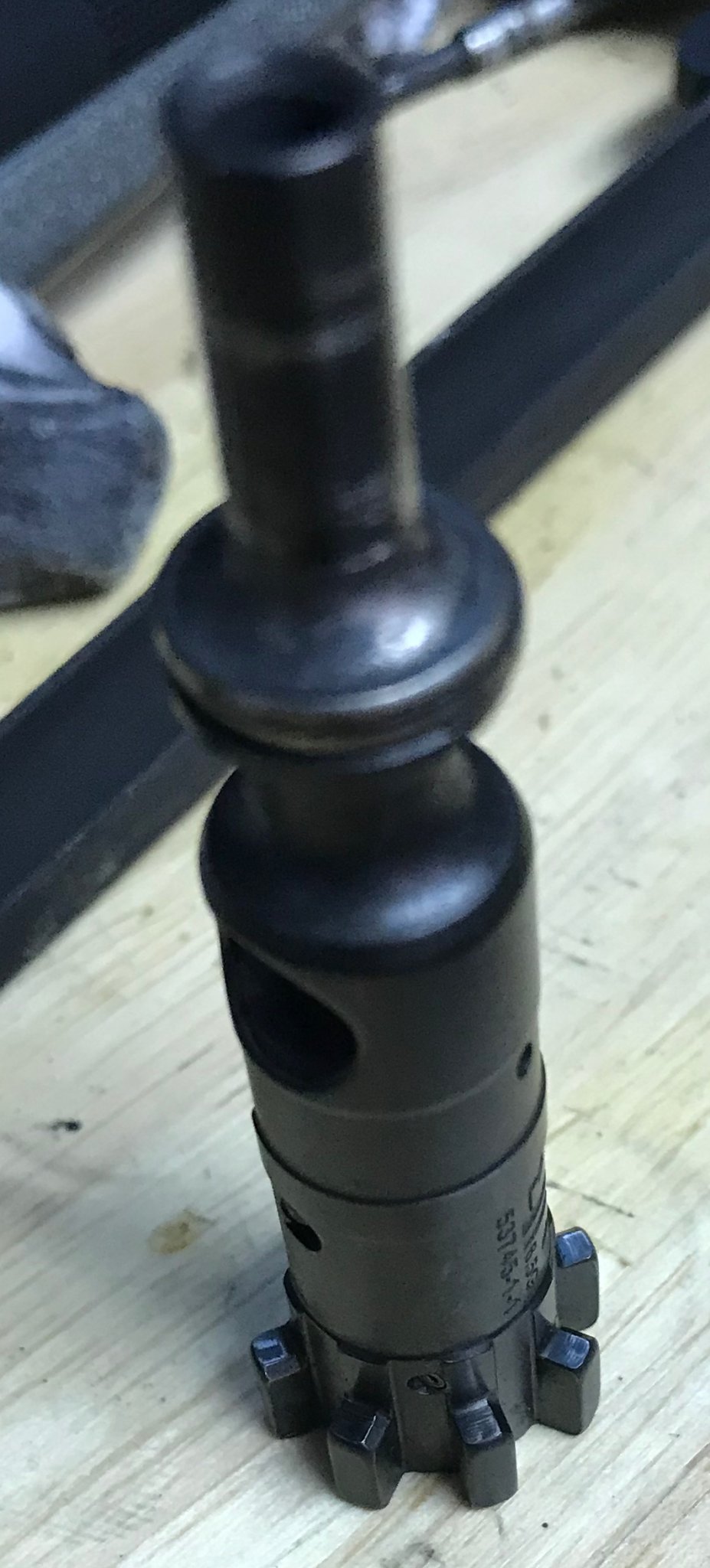

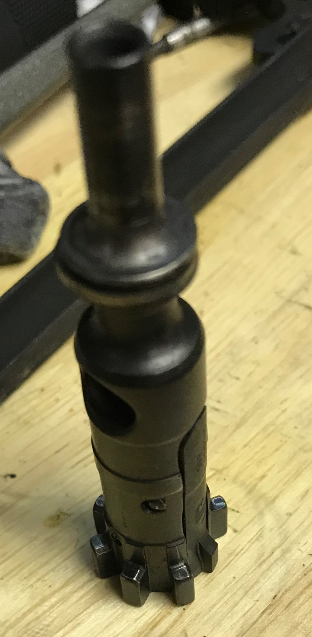

Cleaned the 6mm ARC this afternoon and thought I'd put up a pic of the bolt. A little over 400 rounds on it. CFE223 is dirty but pretty easy to clean. Also interesting that gas port erosion has not gotten any worse in the last 150 rounds. Was almost afraid to look.

Shot a few groups today to test increased charges of CFE223 and the effect of cooler weather on known charges .
The temperature was 68 degrees, 12 degrees cooler than I have previously shot with this rifle (80 degrees). My baseline charge is 28.3 grains which yields a consistent 2600 FPS +/- 10 FPS and .6 MOA groups +/- .15 MOA in 80 degree weather. Today that same load shot an average of 2568 FPS or 32 FPS slower. with an average group size of approximately 1 MOA. It is probably not a linear calculation but it looks like 2.6 FPS per degree between those two temperatures.
Before changing powders to AR-Comp, I wanted to see what a higher charge of CFE223 would give me. Using Quickload I settled on a 29.6 grain charge under the 108 ELD-M. Quickload estimated 2697 FPS making 50,914 PSI pressure and a barrel time that was very close to a predicted OBT node. I think the pressure may be a little more. All 15 of the rounds I shot at this charge weight had a shiny spot where the ejector was and 5 of them or 33% had slight brass flow around the ejector that I could feel. No primers were excessively flattened and all of them retained a normal-looking radius around the edge. Factory 108 ELD-Match ammo does the same thing in my rifle.
The good news is that the MV was an average of 2715 FPS. SDs were very acceptable for the three groups at 7.1, 12 and 4.8. This equals and slightly betters the MV of Hornady's factory 108 ELD-M Match ammo in my barrel. There was some vertical in all three groups indicating that this is probably not an accuracy node. Reducing the charge by .3 to .5 grains will hopefully fix both the brass flow and the accuracy. Even if that reduces the MV by 50 FPS, I'd be happy with 2660 FPS as that will keep the 108 supersonic out to 1000 with a little speed to spare.
As you'll see in the target below, I did not shoot well today at all. I only pulled one shot and that was the high left shot in the second group so, I am going to chock up the groups to MV being significantly off in the first two groups and not being on the node in groups #3 - #5. There was one scope change between group #1 and group #2.

18" Proof barrel with Hornady factory 105 BTHP:View attachment 7438788
An average of ~2690 fps is not bad at all for an 18". Consider for comparison - my 19" barrel in 243 LBC (just a hair more capacity, I'd guess ~30-40 fps worth at the most) with full tilt Leverevolution loads and the same bullet does 2740 fps at the chrono; only about 50 fps faster. That ES seems a little high, but maybe that's to be expected with some factory ammo? I don't spend much time with factory ammo for precision rifles so I don't really know about that.
Good velocity and a great looking rifle! My 21.75" Wilson barrel shoots that same ammo between 2700 and 2707 FPS with SDs between 17 and 21 FPS. How does it group? Mine shoots that between 1.1 MOA and 1.5 MOA at 100. Have not shot that ammo past 100.
