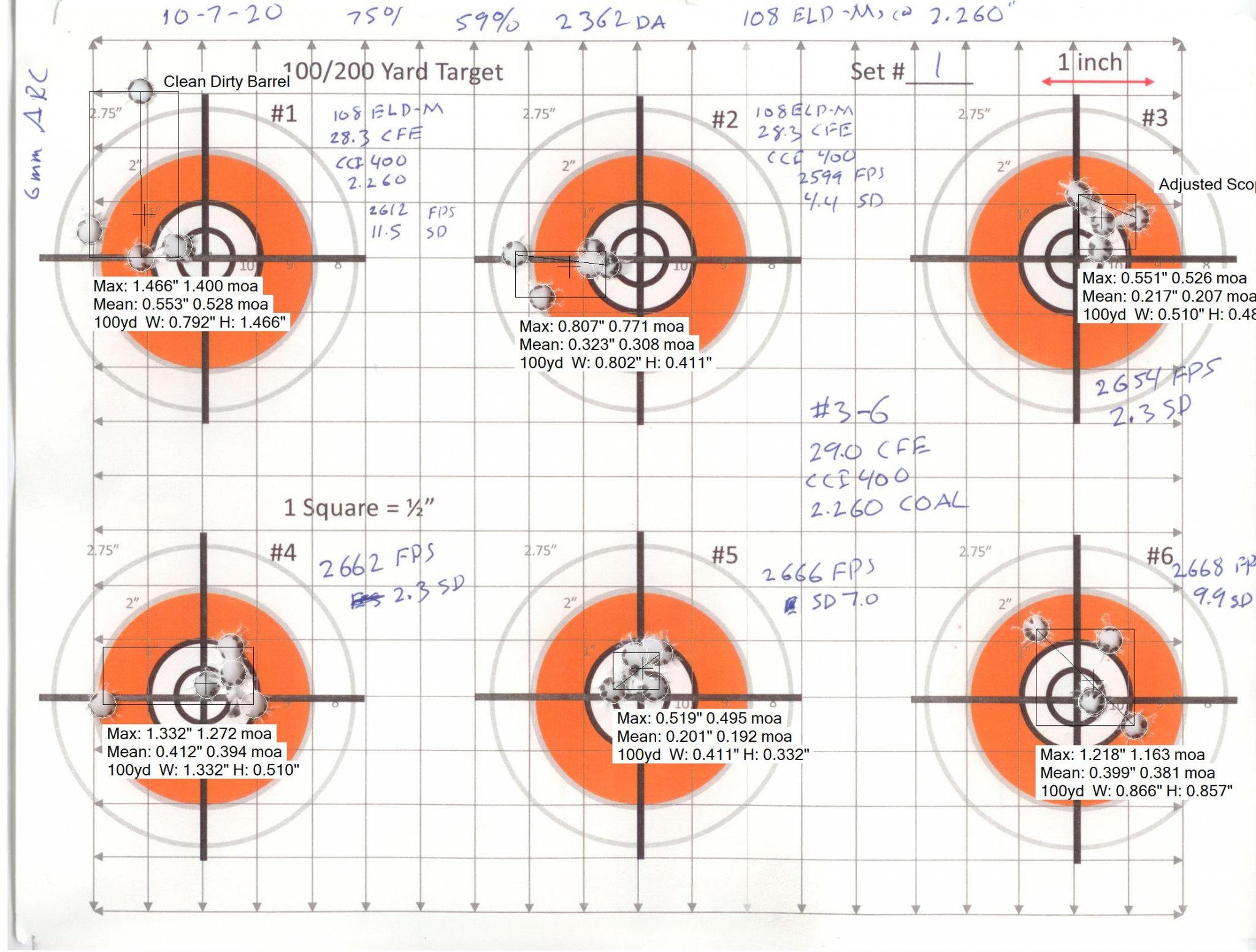

Was at the range today practicing for a match this weekend and decided to squeeze in a few groups of 6mm ARC. The temperature was 75 degrees, presenting a good opportunity to test 29.0 grains of CFE. I started off with the slower 28.3 grain load that has consistently shot in the .7s.
The first two groups were shot at this charge weight and in an attempt to explain the first group, the barrel was cold and I had just shot dozens of rounds using a trigger that breaks at less than 5 ounces. No excuse for poor shooting but I do acknowledge that my shooting was pretty sloppy.
The next four groups, 3 - 6, were the 29.0 load. The average MV of the four groups was 2662 FPS, good enough to remain supersonic in even at near-sea-level atmosphere we have here in Georgia. There were no pressure signs on the primers and no swipes or bright spots on the brass.
Going to continue testing with this charge weight as it meets the MV criteria and shows some promise of accuracy (maybe). The average group size of the 4 groups is .86 MOA. Nothing to write home about, but worth the investment in components and time if it can be improved.
Very impressed with the muzzle velocity CFE generates. I sure wish it was temperature stable but, I am building a spreadsheet that will greatly assist in matching appropriate loads to expected temperatures.

Target and data below:
CFE223 has let me down too many times, where it shoots nicely but groups go to crap when the weather changes (hotter or colder). Leverevolution hasn't done that for me. I don't know why, since they are supposedly similar powders, but they're definitely not the same.

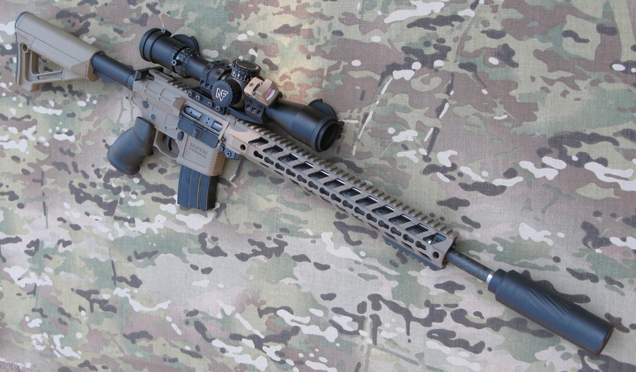

I managed to get out to the range, just using an LVPO for now, so no group to upload, as I was just sighting in the rifle. I did capture some velocity data for the 108 ELD-M factory ammunition though (keep in mind this is a brand new barrel, less than 10 rounds through when I shot these):
18" barrel (suppressed):
2641
2642
2642
2643
2652
2640
2640
2646
AVG: 2643.25
SD: 4.026696626
10.5" barrel (suppressed):
2343
2319
2313
2335
2312
2336
2287
2329
2301
2318
2322
2327
2318
AVG: 2320
SD: 15.0443788
This data was acquired using a LabRadar. I apologize in advance for the odd shot-string counts, I was in a hurry and just wanted to get some rounds downrange to start the break-in period and get some velocity data to work up some dope charts to start with until the barrel is fully broken in.
Groups were fine as you'd expect for a Bartlein barrel (inch or so 10 shot groups), but the LPVO (Razor G3 1-10x24) has a 0.2MRAD dot and the barrel wasn't broken in, so I wasn't shooting for groups. I'll dial down a mil and use the ranging reticle to shoot for groups when I get to my primary range and take them both out to 1000 yards and grab some pictures then. Being Craddock Bartlein barrels, and bedded using SS shim stock in my uppers, I fully anticipate these will be shooters.
I also expect both barrels to speed up a little. Hope this provides some useful data to those contemplating an SBR in this caliber. At the average velocity above for the 10.5" barrel, it's still moving at 1235fps @ 800 yards, 1129 fps @ 900, and is at 1063 fps @ 1000. I'm generally fine > 1100 fps and definitely fine above 1200. Depending on the bullet and how it handles the trans-sonic region, I bet 1000 is going to be doable with the SBR. The 18" is around 1236 fps @ 1000 yards, so no problem at all with the longer barrel. This at 70F @ sea level, the numbers will change slightly depending on environment.
@Henryrifle sorry on the delay, but I promised I'd deliver. :)

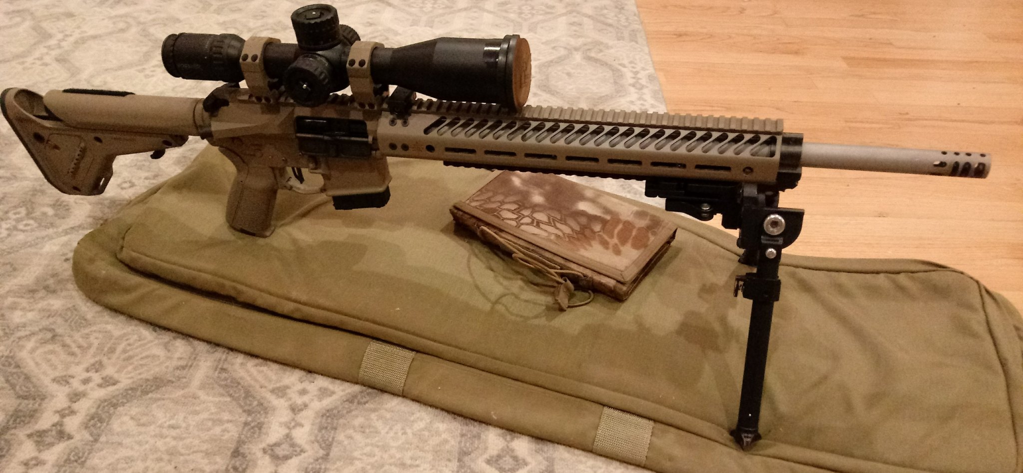

Pic for attention (waiting for the barrel):
Good looking stick! Which Nightforce is that?

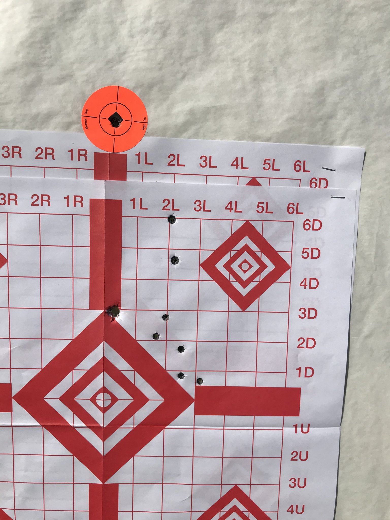

FWIW, I shot my first 6 ARC Saturday.
16” Faxon/Brownells barrel, Vortex Diamondback (I think 2.5-10).
Rifle belongs to a friend of mine. I shot a 5 round group at 200 yards (it’s the 5 holes to the NE side of the big diamond), Hornady Factory 108 ELD ammo, somewhere right at 2”.
Given the barrel only has somewhere less than 50 rounds on it, factory ammo, and me behind the buttplate, I was pretty impressed.
