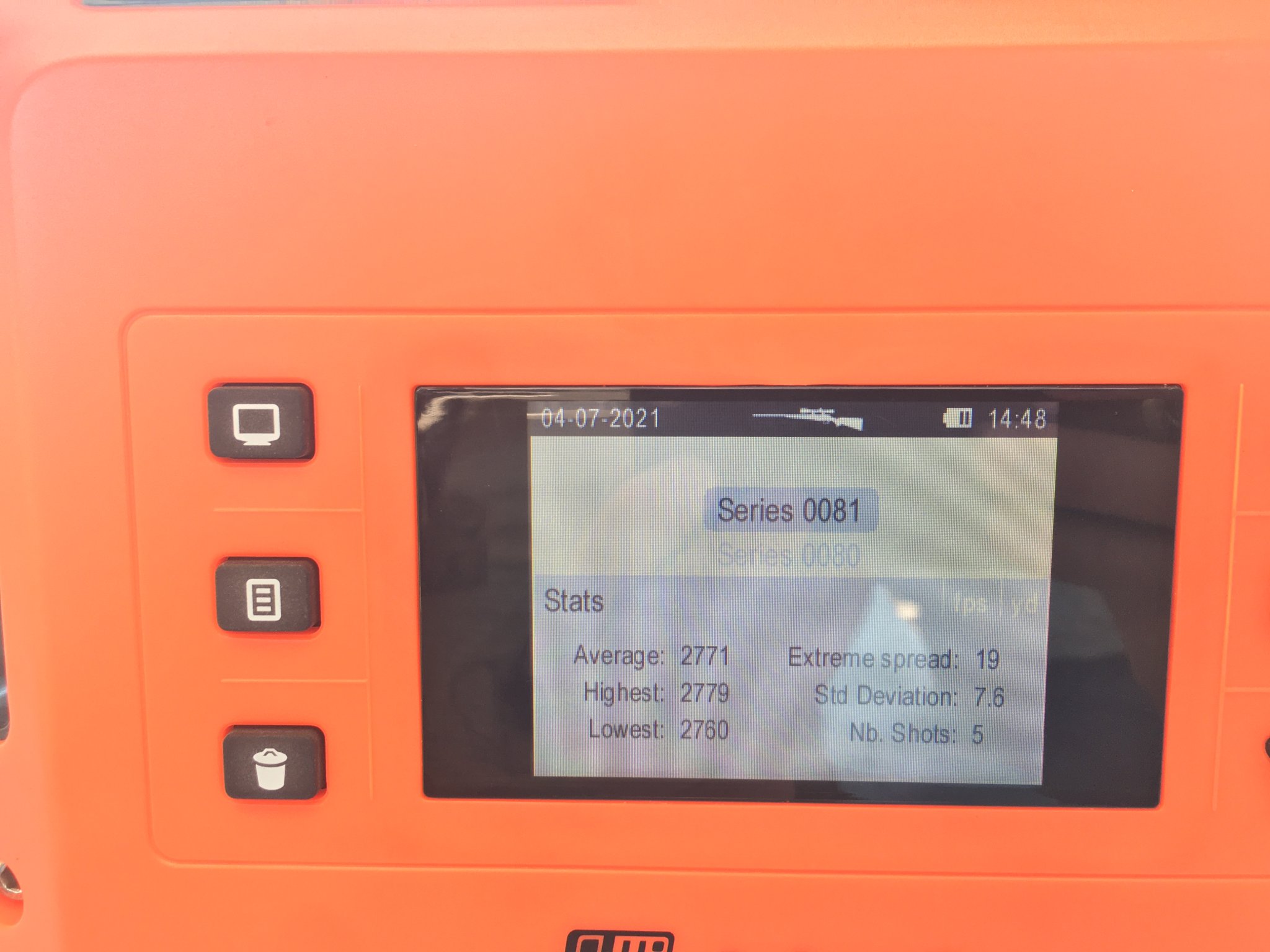

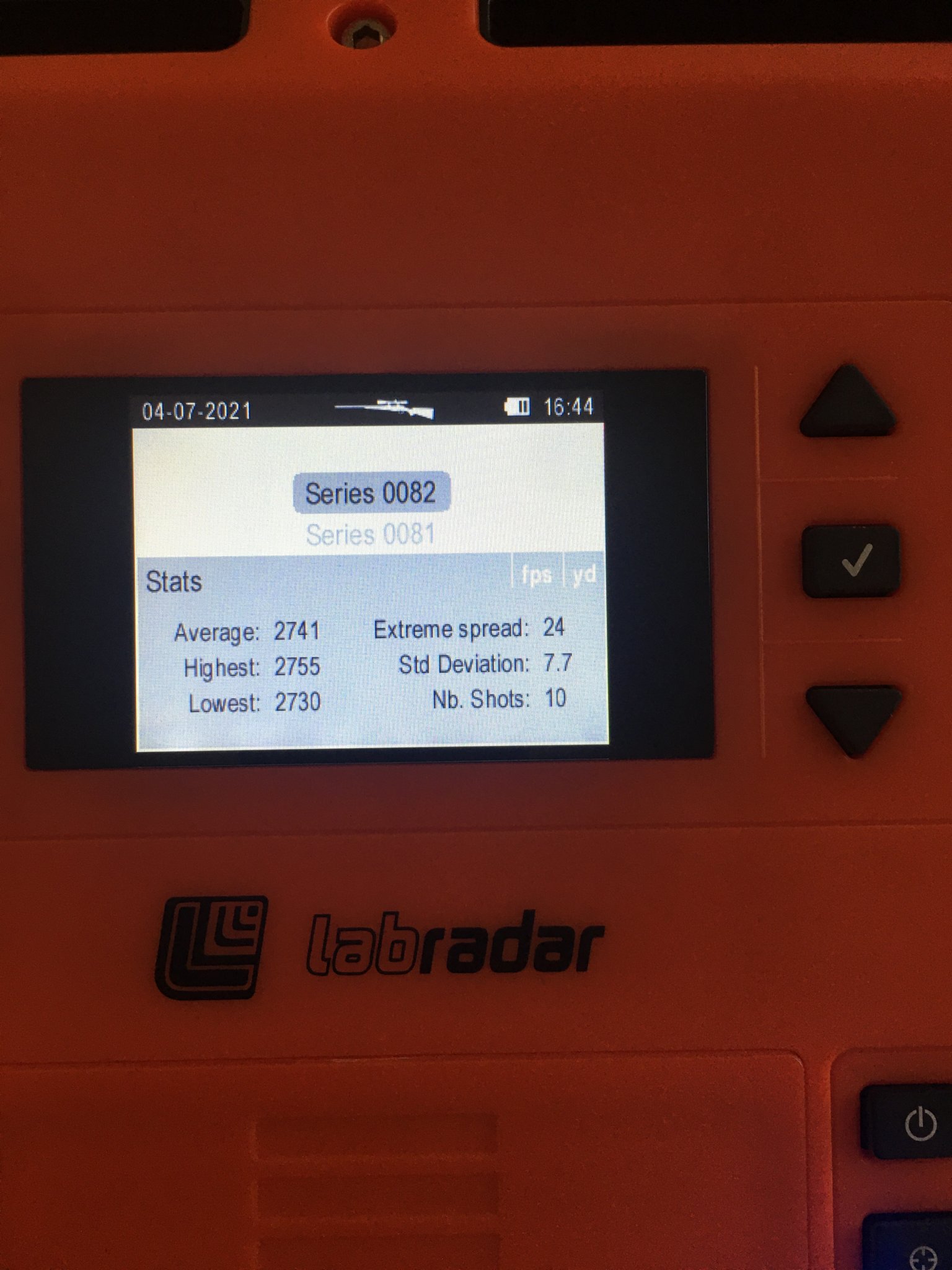

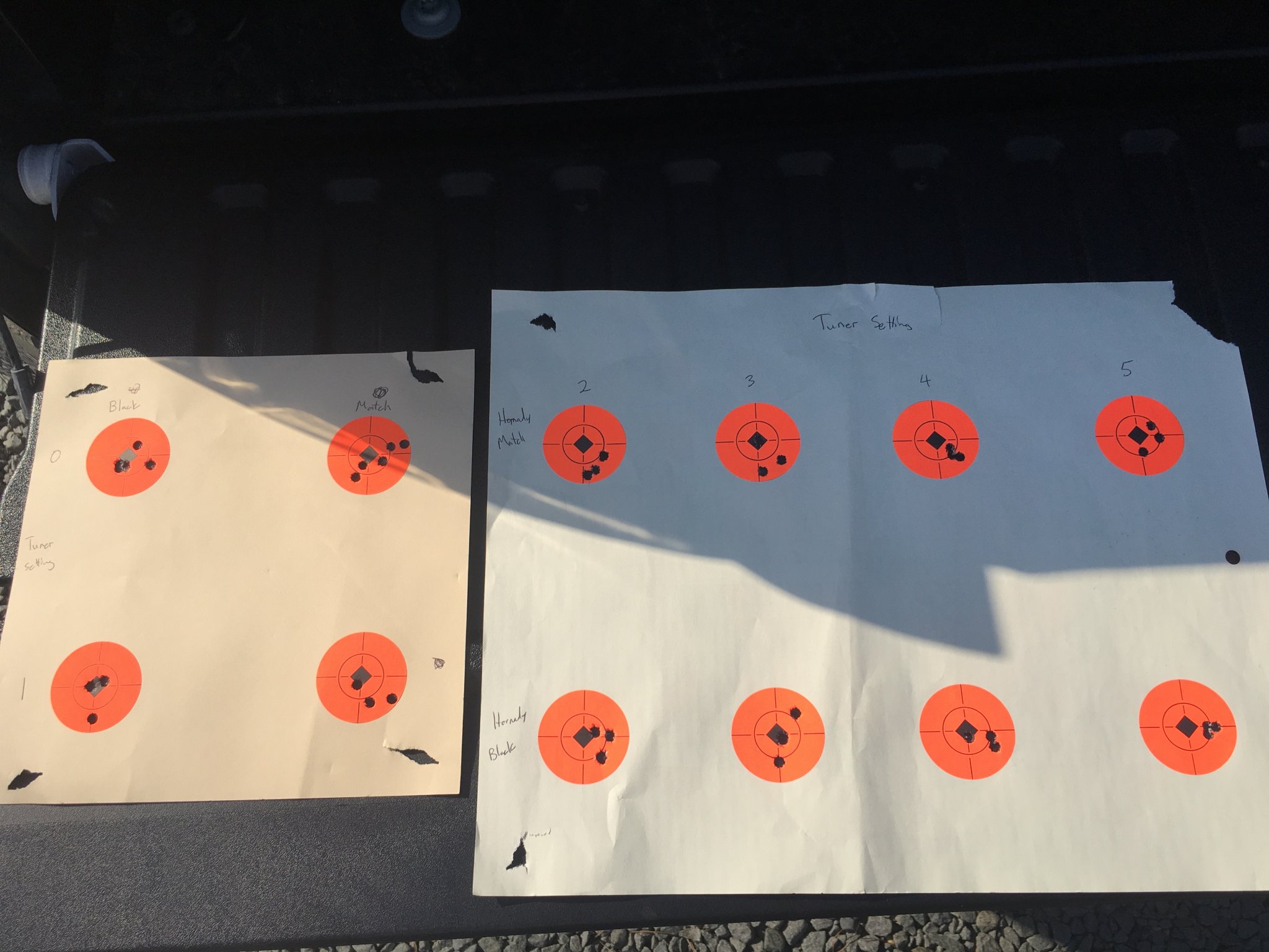

Finally had a chance to play with the 6 ARC a little. Today was messing with the EC Tuner Brake.
Hornady Black averaged 2771
Hornady Match averged 2741
I'm thinking the two hornady loads are exactly the same brass and powder charge, just different bullets. Velocity difference due to bullet weight. I saw similar differences in velocity in my dasher when I swapped Berger 105s for 109s and kept everything else the same.
I plan to load Berger 105s for this, but it does pretty well with factory.
Sorry for only 3 shot groups, just testing tuner brake today.

Right. What I'm getting at is unless QC slipped and they loaded hot ammo (not impossible, but fairly rare), something in your rifle is causing timing (gas system) or pressure (fouling) problems. I'd give the barrel a good scrub and try adjustable gas.
It has an adjustable gas block and was just cleaned. They were the first rounds down the barrel. l really hate it because brass is so damn hard to find!! I am thinking about pulling some bullets and checking weights.......

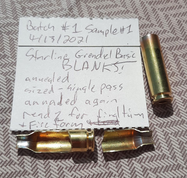

Anyways here is my process for making 6ARC brass during the AmmoPacalypse of 2021:
Advanced details and photos at this linky: http://brassbucket.net/6mmarc-brass-forming-from-straightwall-blanks/
ATN target vids on steel @ 1/2/3/500 will be posted there soon as I get the edit up - It's not spectacular, but seems to make the long drive worthwile somehow.
I wouldn't even attempt this without the annealer - I believe it is key.
Basic process
  • Use Pilot 01 for all annealing and RCBS #3 shell holder – the H45 was too tight and the other RCBS was too loose letting cases slip and fall in the annealer to be turned upside down and picked out. RCBS#3 just right.
  • Analyze to find annealing code #A
  • Anneal all brass using code #A
  • Lube
  • Size (single pass)
  • Analyze to fine annealing code #B
  • Anneal all brass using code #B
  • Trim
  • Champher/deburr
  • Clean (if needed – blow dry chips away)
  • Prime
  • Drop powder
  • Seat bullets (jammed)
  • Fire Form
  • Analyze to find final annealing code #C
  • Anneal all brass using code #C
  • Repeat rest of loading process as normal brass.
