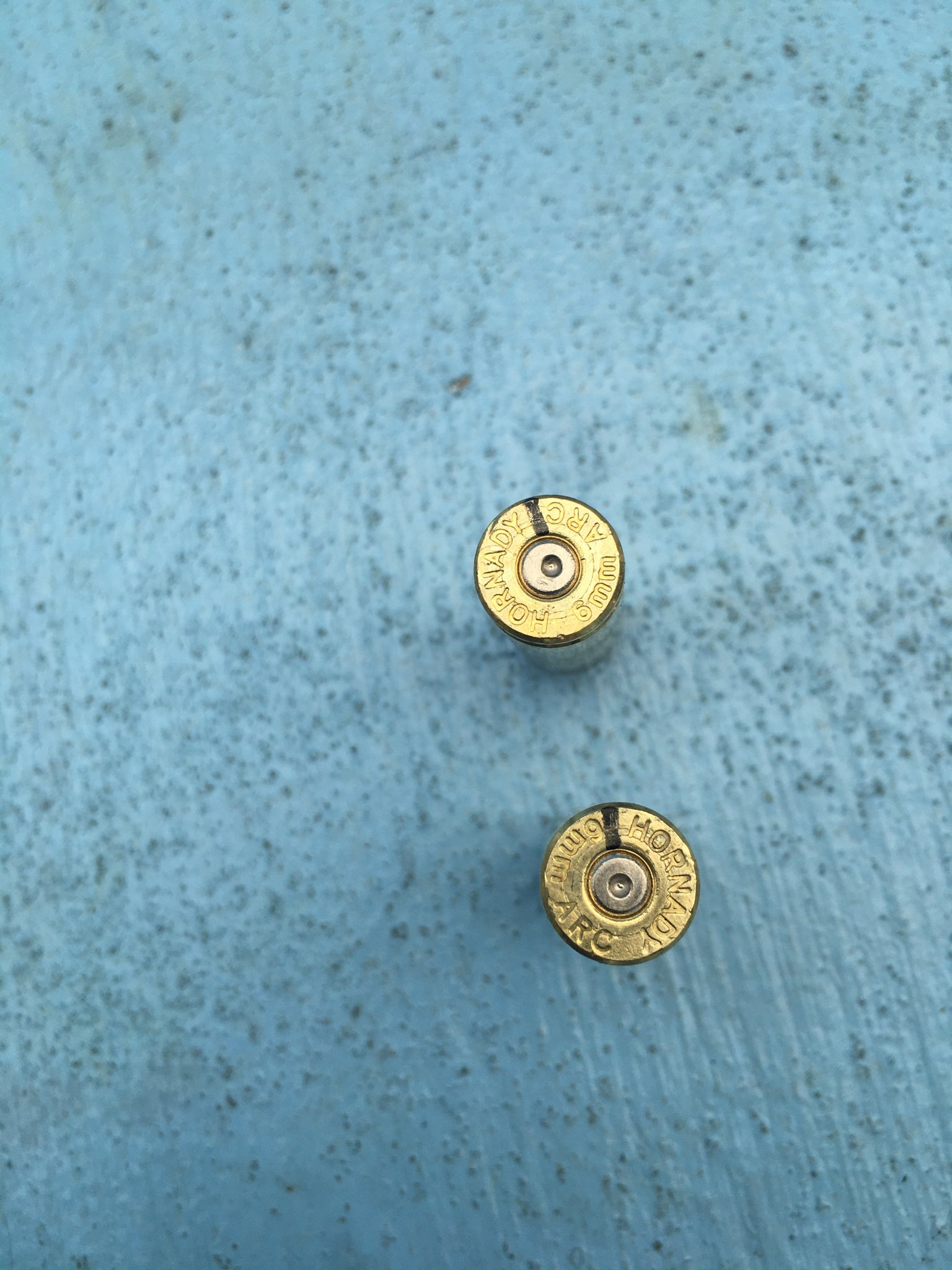

Brass from 29.4 load. I don’t see any pressure signs.

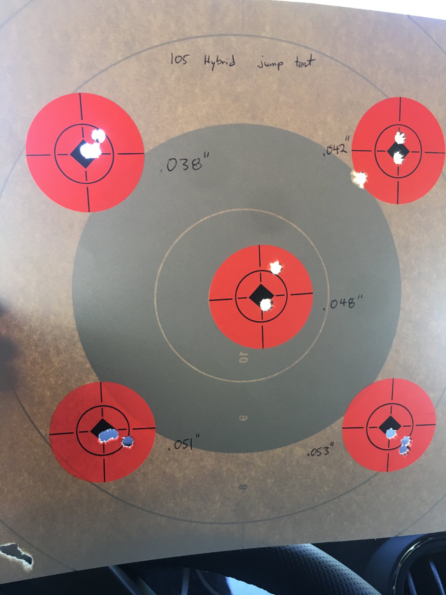

For those who have conducted seating depth testing with Berger 105s: where did you end up at?
Here is my target for today. Corresponding jump values next to target. I tried to go in .003” increments but the Hornady dies don’t have a micrometer.
Looks like it doesn’t like being between .040-.050 jump. I could maybe try a .035” jump but I’ll be pretty close to mag length. .052” or so may be the ticket. I’ll go back with 5 round groups at .052-.060 next.
Hornady sells a micrometer top for their seating dies. The great thing about them is you can buy 1 mic and use it on your other Hornady rifle dies. You just note down the mic readings for whatever bullets you're using on the other caliber dies.

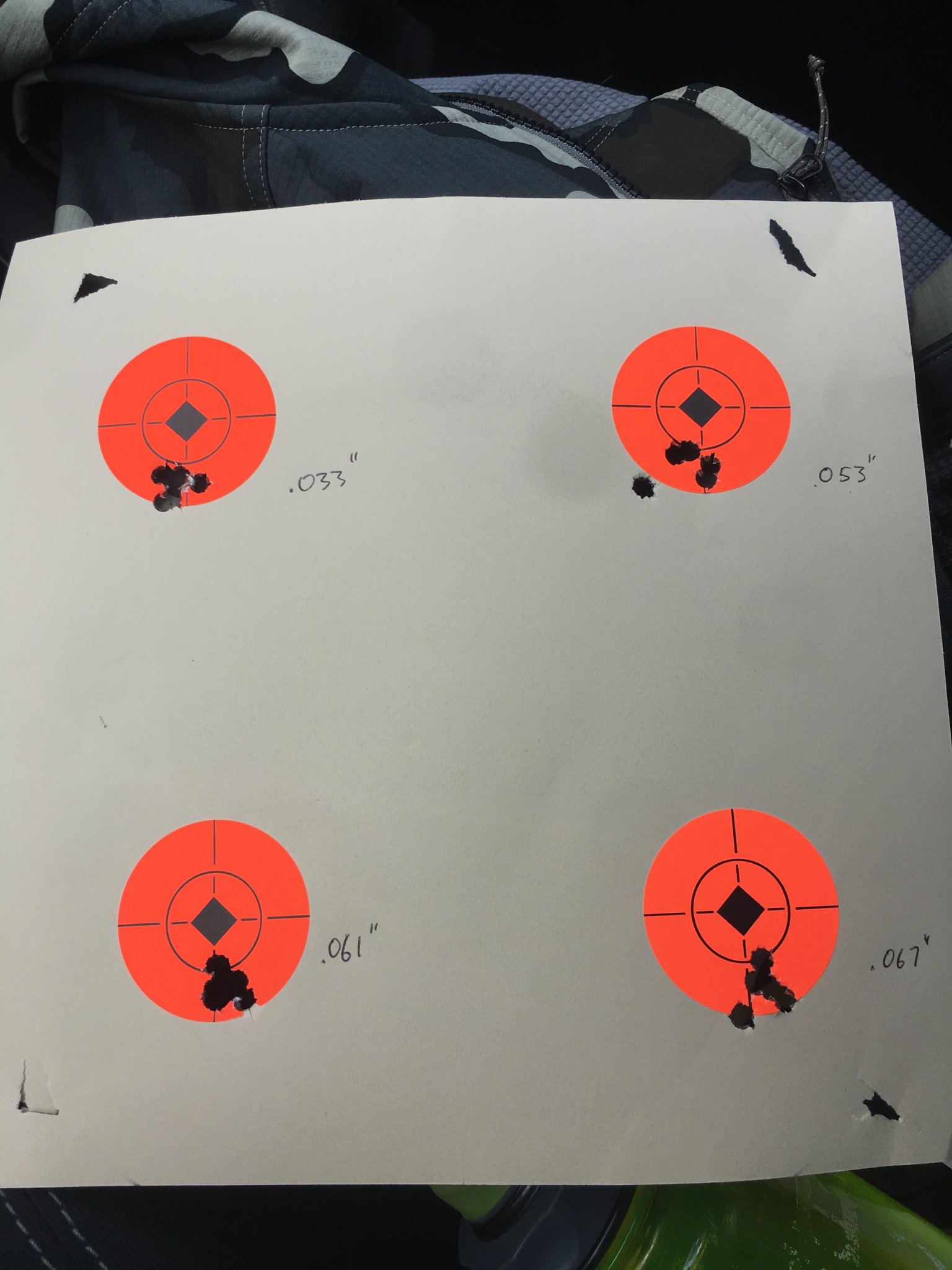

So I think I have to call my seating depth testing a fail. Doesn’t look like it matters how much I jump, I get the same accuracy results.
Bullet jump values next to respective targets below.

I find that the Berger bullets don't like a long jump. I am loading them to 2.950 to 2.300 OAL. But I am now shooting their 115 grain bullets in my bolt action and they do very well. The Nosler RDF's I load on the other hand love a longer jump, but do well with a short jump to. You usually find a couple nodes when testing. I change my jump in .030 increments and find the tighter groups and then fine tune from there.
Your groups look pretty good, but each barrel likes something different, I have four ARC's and each one likes a different load, would love to find a universal load for my gas guns though. I may work on that but one of them has a match grade barrel on it to compete in PRS gas gun, and my bolt gun is a totally different animal all together, I have to keep that brass segregated from the gas stuff.

You didn’t test across a very wide range so you might just be missing the best node. I try to cover a range spanning.100”-.150” for a good seating depth test, depending on the situation. If it were mine, I’d be testing both less jump and more. Maybe .010”-.110” etc.
The other part of a seating depth test is to find the depth that is most tolerant of variations in velocity or powder charge. To do that, I like to mix 5 different charge weights for each seating depth. For example maybe 30.0gr to 31.2gr in 0.3gr increments for each seating depth. This shows more dispersion at some depths and let’s you zero in better on the right jump.
Hope that makes sense. Might sound confusing at first but it’s actually fairly simple and works well.
(The powder charges I said above are not a recommendation for your load, just an examI used myself not long ago.)
I was being somewhat facetious with that last post. While it was true, getting consistent .3-.5 moa out of a gas gun is plenty good for me. The fact that I don’t have to worry about chasing lands is even better.
I tested between .030-.080 jump in .003” increments. Any less jump and I run into mag length issues. Deeper and I start compressing load and spiking SDs. These groups were where I suspected the best nodes may be.

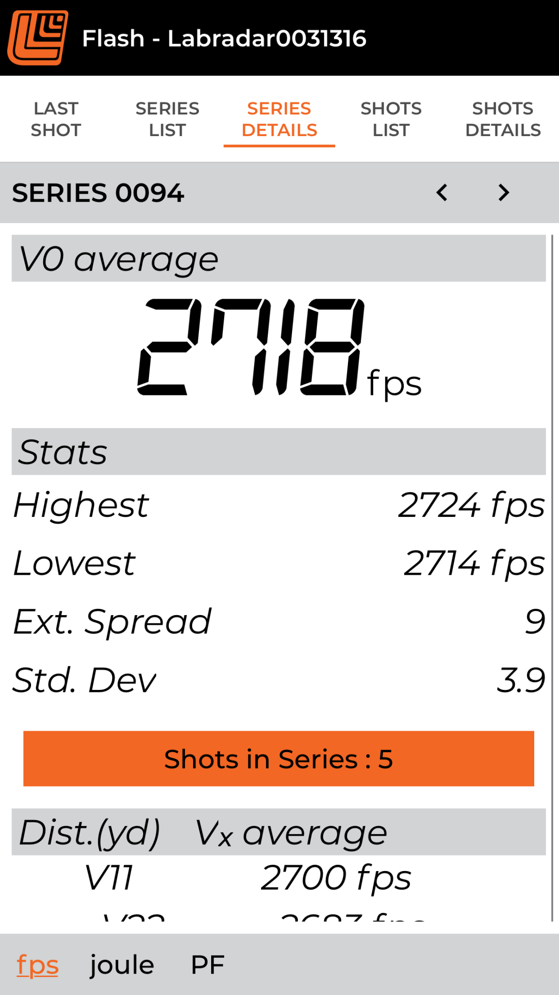

Below is chrono data. 105 berger jumped .061 29.0gr lever evolution. Can anyone with quick load run that and see what pressures I’m around? I could probably push higher but don’t see the need to yet.

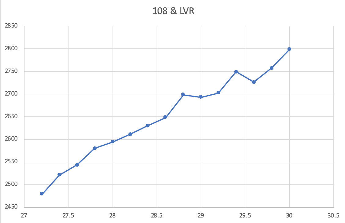

Did a ladder test with the ARC over the weekend.
Enviro:
-85 F
-70% RH
-600' Elev
Load:
-Starline 6.5 Grendel brass
-Berger 108 Elite Hunter
-Hodgdon Leverevolution 27.2 - 30.0grs in 0.2gr increments
-Federal AR Match primers
-CBTO 1.655" (0.060" off lands)
-COAL (E-Lander mag length) ~2.25"
Rifle:
-20" 1:7.5 +2 rifle Rock Creek by Craddock Precision
-AGB
-Silencerco Omega
27.2 - 2479
27.4 - 2521
27.6 - 2543 light ejector marks started
27.8 - 2580
28.0 - 2594
28.2 - 2611
28.4 - 2630
28.6 - 2648
28.8 - 2698
29.0 - 2693
29.2 - 2702
29.4 - 2749 heavy ejector marks started
29.6 - 2726
29.8 - 2757
30.0 - 2798

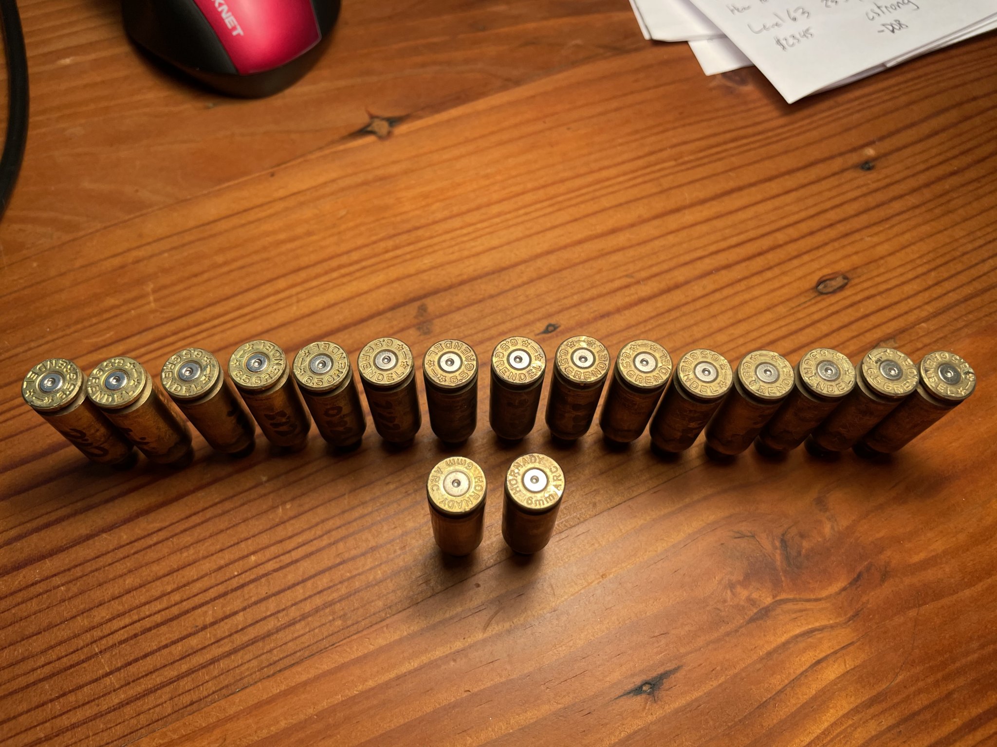

Had some light ejector marks on the factory 105s. Need to adjust my AGB as well.
I also loaded 5 rounds at 29.0grs but didn't have time to shoot them. It looks like that is going to be the sweet spot, the same as many of you on here found.
Brass pic starts at 27.2 on the left and ends at 30.0 on the right, as well as the two factory 105s on the bottom.
I'll report back when I shoot 5 round groups near the node.

Looks like you have the same node and same jump that I ended up with. Not surprising since mine is also from Craddock and likely same reamer dimensions if not same reamer itself.

Looks good. I’ve noticed that Starline brass is pretty tough in this cartridge and handles a lot of pressure and abuse. In my 4 rifles that use this brass, it can be pushed way over pressure without showing pressure signs.
All of those cases look ok except the last couple; those ejector hole imprints are concerning since it’s Starline. If you haven’t, it’d be worth making sure your shoulder bump is correct; too much bump (creating excess headspace) can cause those imprints at higher pressure. The danger is that it also resulted in impending case head separation for me after a few loads and the brass was junked. Reducing bump down to minimum with the same loads let this brass handle 12 loads without any pressure signs.
Hope that helps.

Thanks for the advice. Now that these are fire formed I will know exactly what to bump the Starline in the future. Hopefully the 29.0grs shoots well and I don't have to develop much after that.
The previous chrono data you posted of the OCW testing does not line up with the 2718 fps of this post, but calibrated to the 2718 fps, pressure is estimated over 57K. (Without calibrating to actual velocity, the estimated velocity was lower, and the pressure was just under 54K, so between 54K and 57K is mu best guess) The optimal barrel time for a 24" barrel at node 5 is 1.228 ms, so I highlighted the node. In an AR15, with the gas block changing harmonics slightly, I find that 10-20fps faster than the node will shoot the best with lowest ES and SD, so I would suggest targeting 2670 to 2690 fps and see if that has the lowest ES/SD and smallest group. And yes, I know everyone wants to go fast, but run a ballistic calculation and see how little impact 30 or so fps has on the solution. (spoiler alert, not much)
Seems to me you’ve made some assumptions and correlations that don’t actually carry over from one barrel to the next. Barrel harmonics for example are highly dependent on barrel profile, not just length. And the optimum accuracy node from harmonics does not necessarily correlate to lowest ES/SD; those are independent of each other. You might see both of these occurring simultaneously in your barrel with that load, but it’s a bad assumption to conclude it works that way in other examples too.
I know that people who’ve spent good money for a software program don’t like to hear this, but this is a good example of the fact that just because you can generate a bunch of data doesn’t mean it’s accurate or useful.
I don't think my comment was misleading as I referred to the numbers as "estimated", numerous details were not provided to make any sort of true analysis. Garbage in equals garbage out. Even noted the chrono data does not match up, and I selected only the last to use to this estimate. And based on the numerous calculations I have provided for AR clients seem to pan out that the effect on OBT times that gas blocks, muzzle devices, etc. tend to push the assumed node a few fps higher, based on ES/SD and group size. Suppressors in particular impact the estimates. Also, calibration to actual velocities will skew the pressure estimates, so I identified an estimated range as my "best guess". I remind my clients of this because so many are used to the bolt gun numbers being spot on when we do a full analysis. This however was a "quickie estimate" to answer the question, in which I used saved criteria from other 6mm ARC clients, so it is obviously "ballpark", not exact.
You're still assuming correlations that don't exist. One is your comment about optimum barrel time and harmonics leading to lowest ES/SD; those are independent things and one does not cause the other. Another one is your assumption that you can estimate optimum barrel time based on barrel length alone.
Good for you if it's worked for you and your "clients" but IMO you're promoting bad understanding of how this stuff works.
In my experience if you just start off with good load development practices (NOT things like the velocity "node" search someone used above) you often end up at a very different result than trying to follow these predictions, because they lack enough input data to be actually useful.

The first thing that I saw that caught my attention was the input data on case capacity in H2O, it was 34.8, that seems a bit high.
Bad data in...

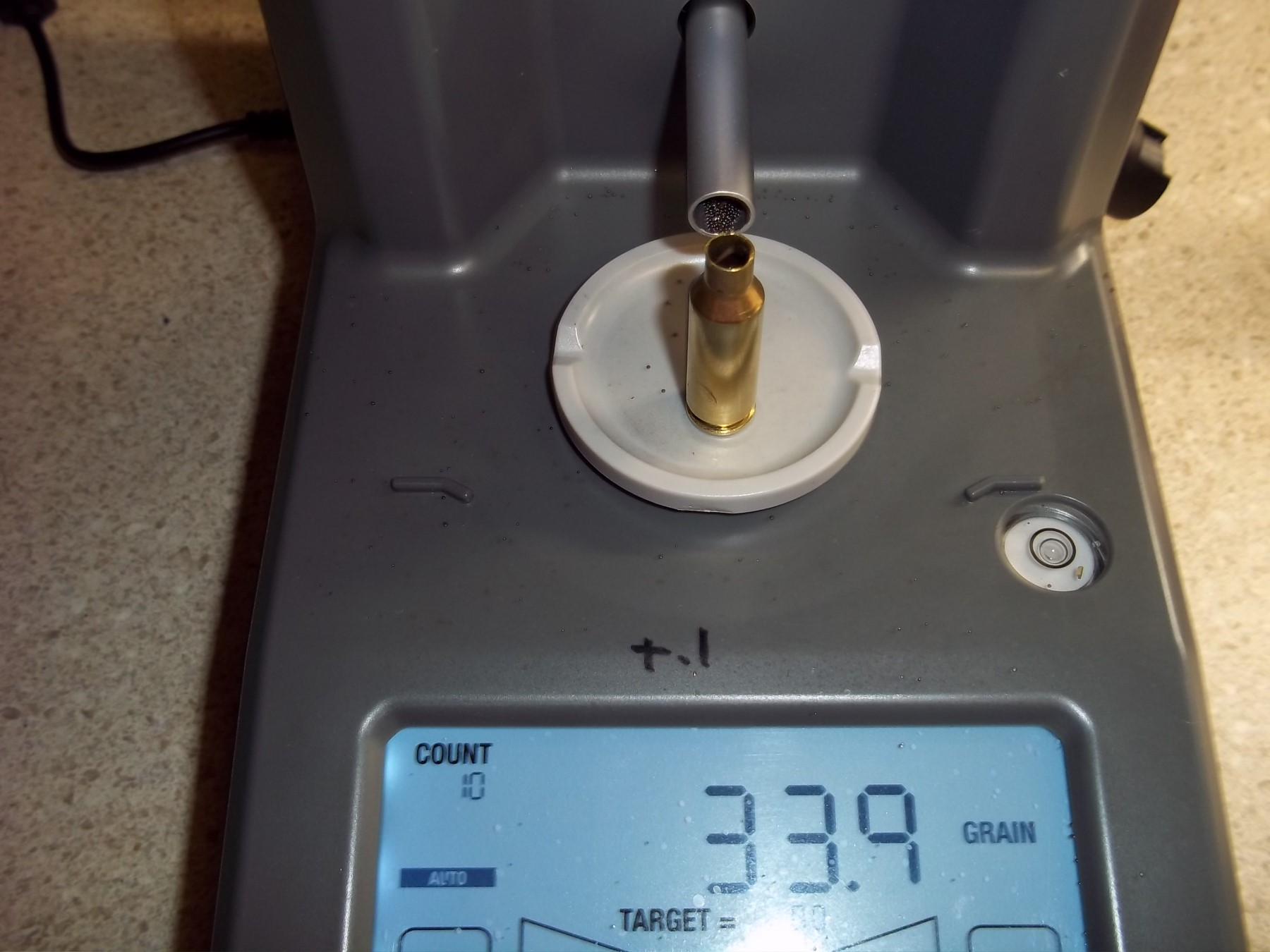

Pretty close, depends on chamber and brass brands. That was Hornady 6mm ARC stamped brass, using the actual average of measured fired cases where the length was close to the 1.48" trim length, average case weight 114.7, average water capacity 34.8 grains. Several cases were 1.49"+ after firing, the max water weight of the overlength cases was 35.04 grains. This is following the QL procedure for rifle cases, using an unresized fired case, using water at 75 degrees F. Using Lapua, Norma or Starline Grendel brass, the capacity will be over 35 grains. Using resized 7.62x39, the volume will vary depending on manufacturer, but most were less than Hornady. Oh, and anyone looking for real frustration, Federal Grendel brass resized to 6mmARC will also be less than Hornady.
Resized Hornady case trimmed to 1.480
33.9 grains of water, reason for the resized case is because your not going to fire one that is not the right size to fit the chamber.
Hornady brass is factory 1.183 to the datum line, this case was 1.185 to the datum line.
Hornady claims case volume to be 34 grains of water.
No, I think previous data had a lower velocity for the same powder charge. However that was with different seating depth and different ambient temperature. So far leverevolution seems to be sensitive to temps. I've gotten 30 fps variation on average velocities even though SDs were low. I'm not too concerned about it. I've never had to enter powder temp data into my kestrel but I will for this one.
But for Quickload calculations, you use a fired case, with the spent primer still in it. (Page 64 of the latest QL manual I have downloaded, which also states "cold water", which is why I noted the water temp I use, which actually understates the case volume. I allow the water from a tap to sit for a bit to ensure no air bubbles from aeration is present, as it is at room temp. A simple mathematical calculation of water density could be performed to adjust to "cold water", but since the exact temp of "cold water" is not defined, I use the number from my testing. This slight error is the same way every time, consistent processes can be key) Even a fired case pulls back from the chamber walls, so both a sized or unsized case are not the actual size of the case as fired and formed to the walls. There are numerous variables in the process, and some argue they can adjust case volume to align with field results, I prefer to not adjust something that can be measured with a reasonable accuracy. Garbage in equals garbage out, so accuracy of measurements, in the manner defined by the program are critical. Too many people grab a copy of Quickload and get frustrated when it doesn't magically spit out a world class load, it is just one tool to help get there.
No, SWFShooter is right about that part; the volume that actually matters under pressure is that of the case pressed against the chamber walls.
Here's an interesting and semi-related detail to think about (and try yourself) - with the same load, a FL sized case will usually show less pressure and velocity than the same case neck sized only. The reason is that it takes a small amount of energy and time to blow the case out to chamber dimensions. With some loads and cartridges the difference can be so small as to be insignificant, but with others it can make a noticeable difference. Just one of those little odd details that doesn't quite make sense at first until you dig into it.
Has QL come out with a 6 ARC program yet? I know most folks are using a modified Grendel program, and I have yet to see accurate data from the modified Grendel program.
Makes sense using a fired case now that I think about it, I will have to measure one and see what I come up with. I was going to get the QL software for my ARC, but as I stated the information it spits out for this cartridge does not match up to well with real world results that I have seen. I know that it is dependent on user input.
