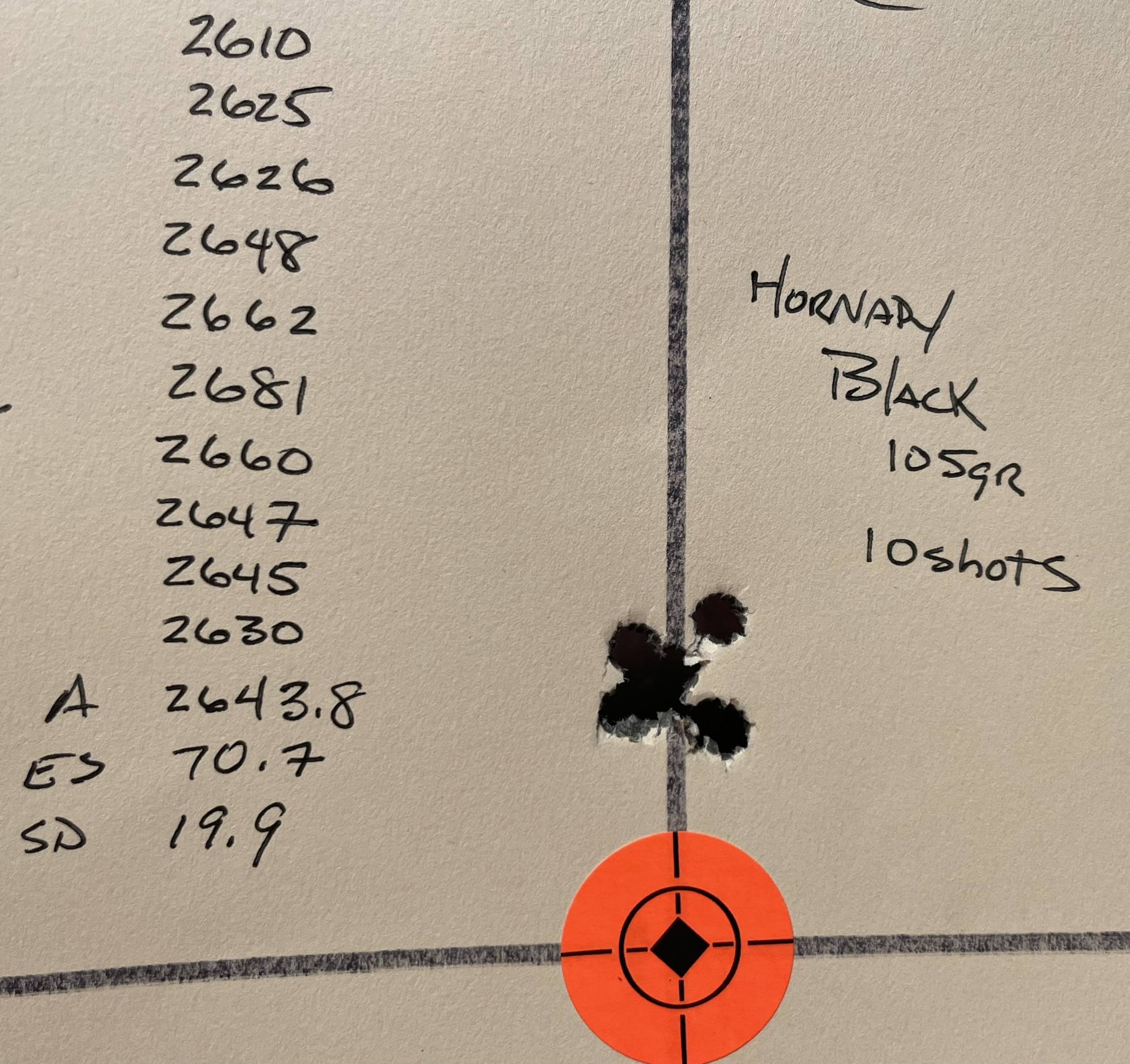

I can share some info about 6mm ARC and Staball Match. I was surprised no pressure signs on the brass, even at the higher charges.
The two groups below are from a ladder test, these are the nodes I found. Next node would be 28.8 which I need to reshoot, pulled a shot in that group but man it has some promise. Next time out I will revisit the 28.8 area. Just for reference the 28.8 charge yielded a AVG of 2600 FPS with the SMK 107s.
Gas Gun - 20" Proof Stainless & Garmin Xero Chrono
6mm ARC - New Starline 6.5 Grendel Brass (resized) - CCI 450 - 107 SMK - COL: 2.245" - 27.2gr StaBall Match - AVG 2420.5 FPS
6mm ARC - New Starline 6.5 Grendel Brass (resized) - CCI 450 - 107 SMK - COL: 2.245" - 28.0gr StaBall Match - AVG 2491.5 FPS
Also included a 10 shot group of Hornady Black, which has the 105gr bullet. That 10 shot group averaged 2643.8
Hope this helps!
All the best!
J

Looks like good results accuracy wise. How dirty is Staball? I'm having issues with Lvr clogging my gas tube and then short stroking after ~k rounds. I hear it is cleaner if it is near the top end, but I think that goes for most any powder. I'm @2550 with Berger 105s in a 20" barrel.
Thx for posting groups.
@newageroman
I've found Staball Match to be much cleaner than Lever, I'll agree Lever was really sooty, especially when suppressed. I don't go as long as you before cleaning, but Staball is definitely cleaner than Lever.
Remember my loads above are over book max so use with caution. I'll will revisit 28.8gr next time I go out, that charge (node) also really showed promise.

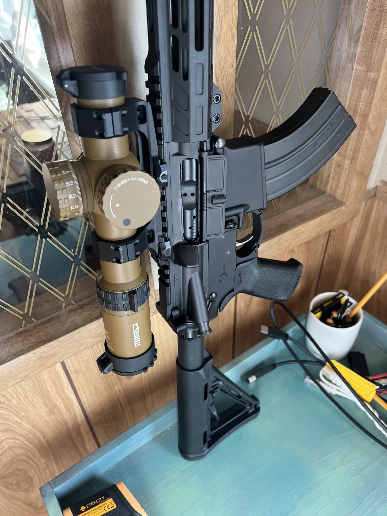

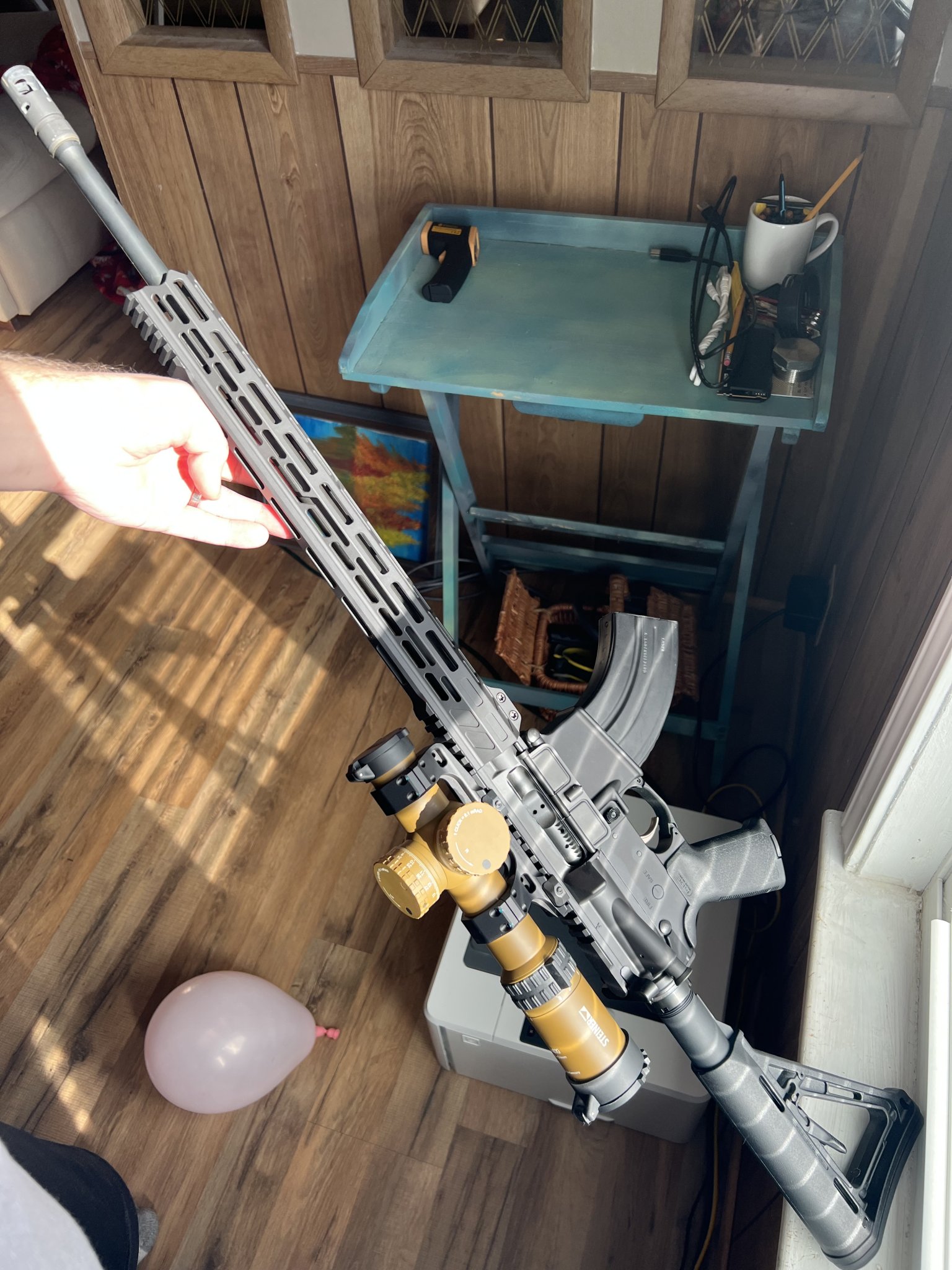

I finally found time this morning to get to the range and initially sight in the 6 ARC. I decided to start with the new Hornady VT 80 grain stuff since there's very little feedback on it at the moment. It's hard to say how it's grouping with this load since this was the initial sight-in trip where I was more or less worried about getting it on paper consistently. I did have two and three-round groups that were right at if not sub 1/2 moa. The two five-round groups I did shoot were in the 1.3-1.5 moa range but I know it's capable of better if you can keep a consistent shooting position without having to manually charge the gun each round. It was obviously hard to be consistent with the groupings due to the fact that the rifle had a FTE on every single round.
The barrel is a Proof Carbon 18", the gas system is a Rifle +1 and I am running a Carbine buffer, no adjustable gas block, JP bolt in a LMT SA bolt carrier, so I am not really sure where to go from here in regards to the gas system issue?! Thoughts?
I plan to run this rifle suppressed 100% of the time but I won't know how it functions with the can until it gets back from Echo Machine. I suspect it'll function better on ejection/extraction with the added back pressure of the can. That said, I do want the rifle to function properly both when suppressed and without the can so I need to get to the bottom of this FTE/short stroke issue. I plan to run the 108 ELD's once I burn through the VT's.
