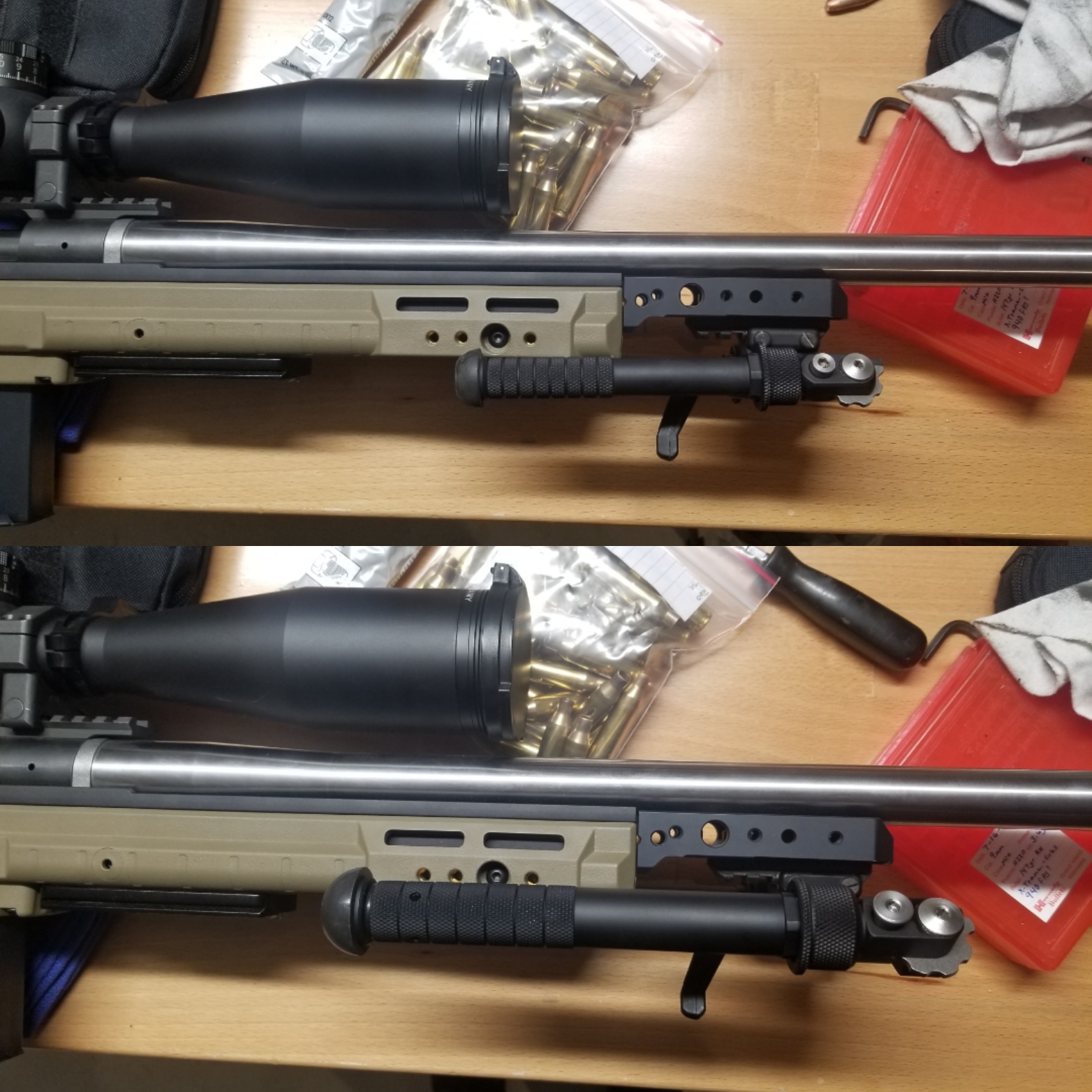

Is that sawtooth adapter This one for the 5H that extends it out for clearance? If not, I'd be curious if it works.Does anyone know of a narrow Atlas to ARCA/RRS clamp adapter?

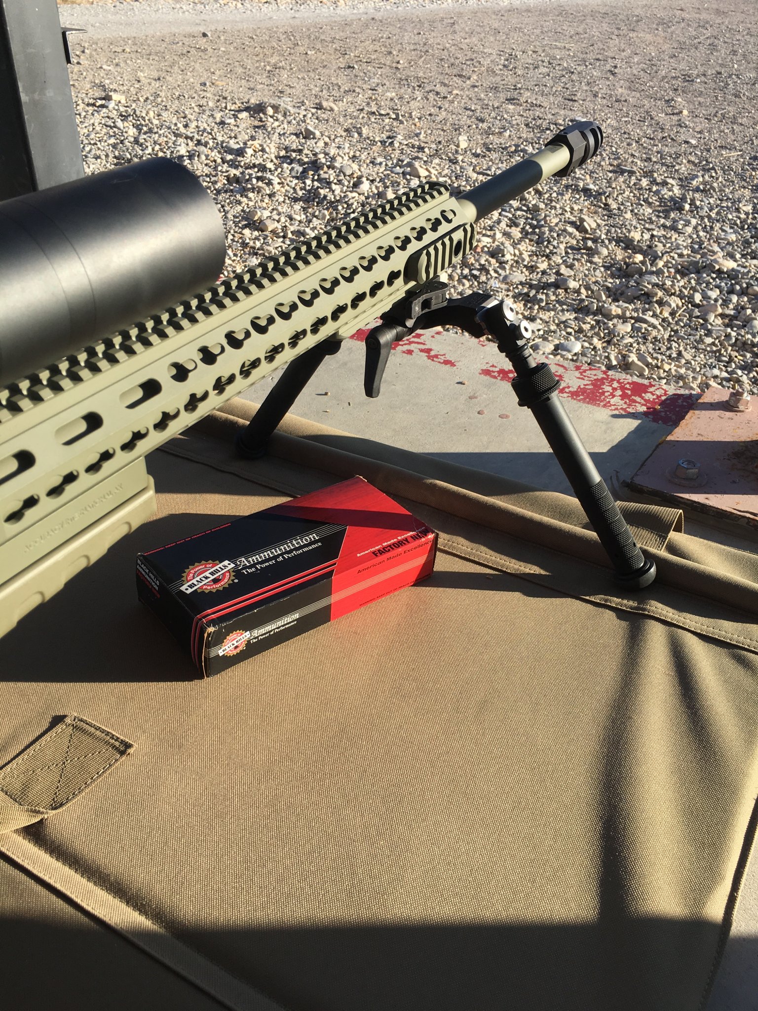

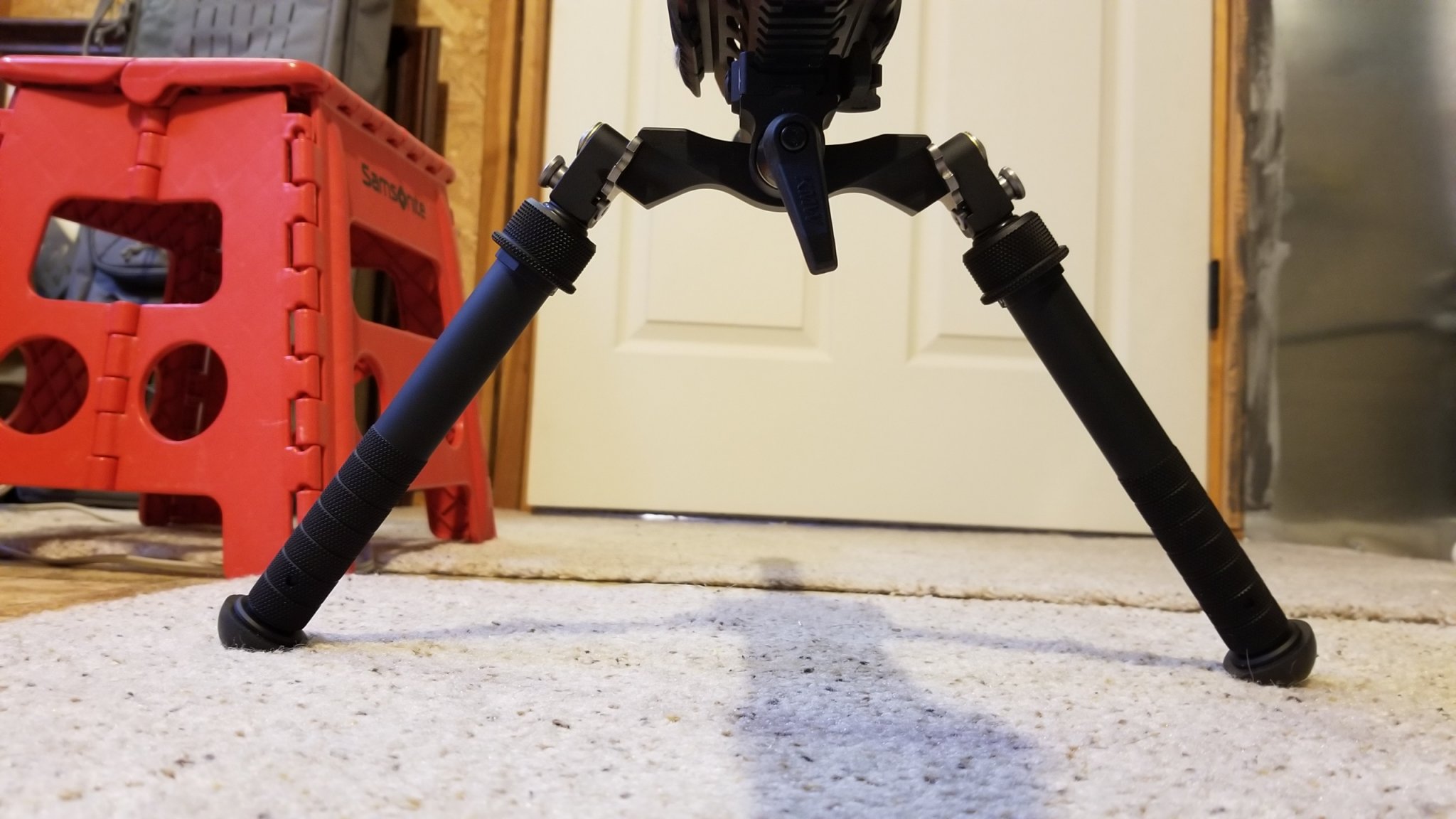

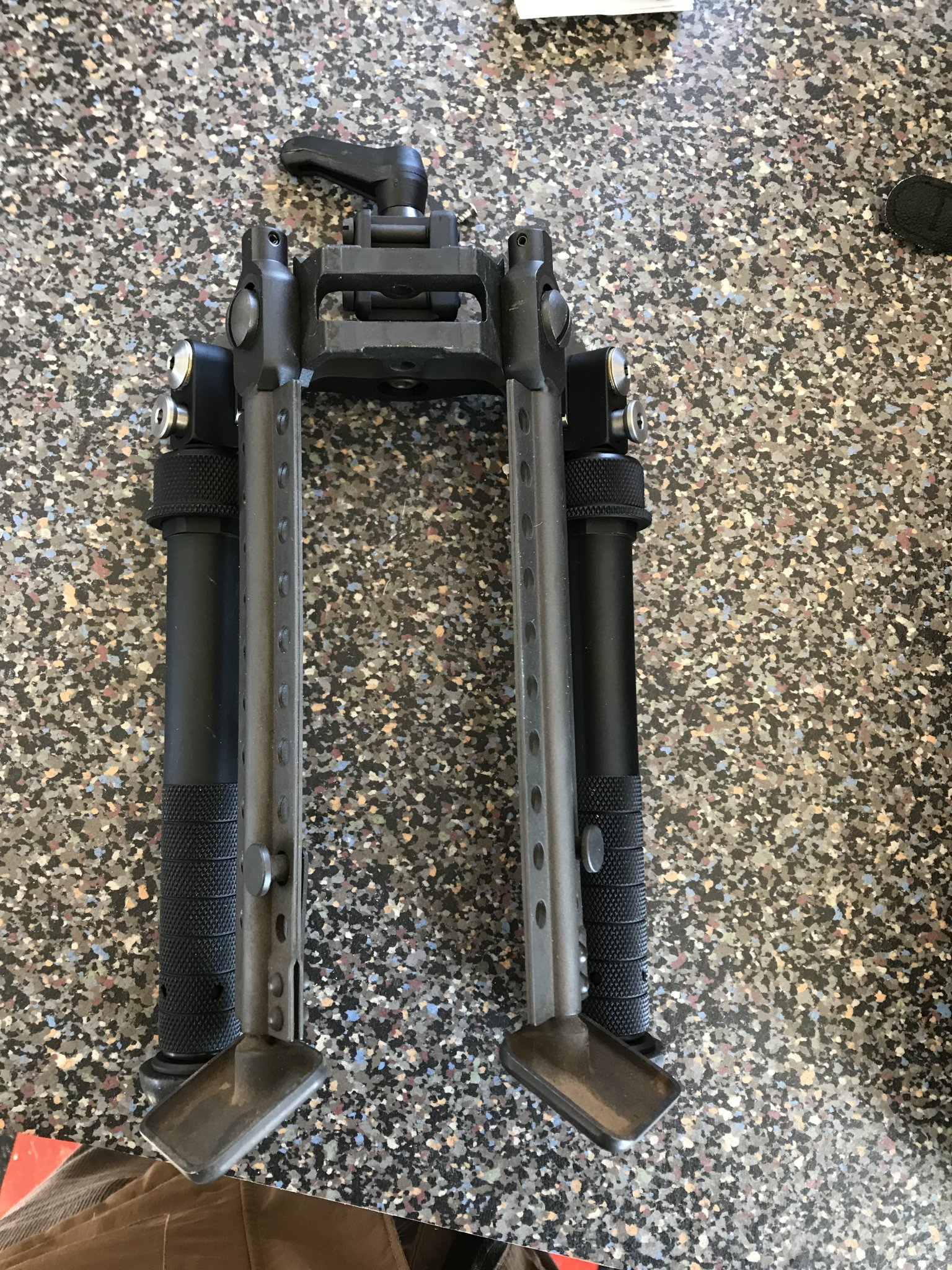

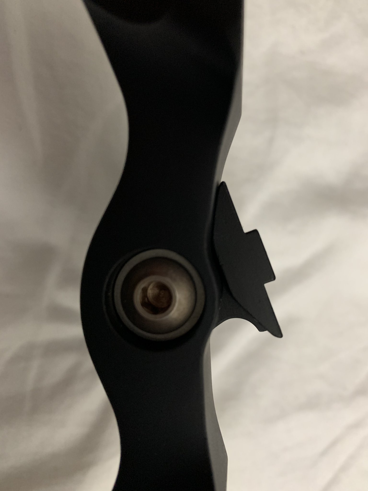

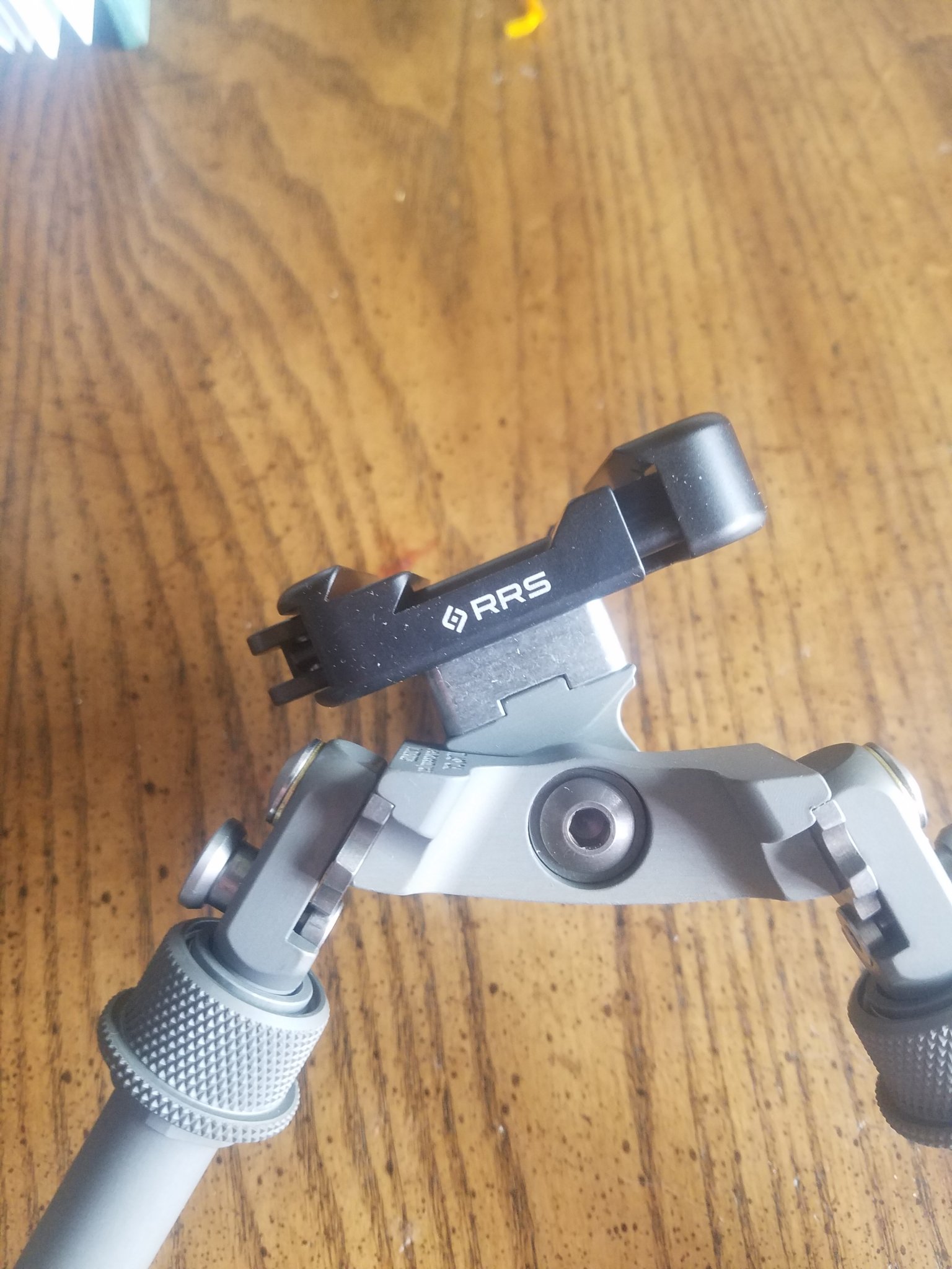

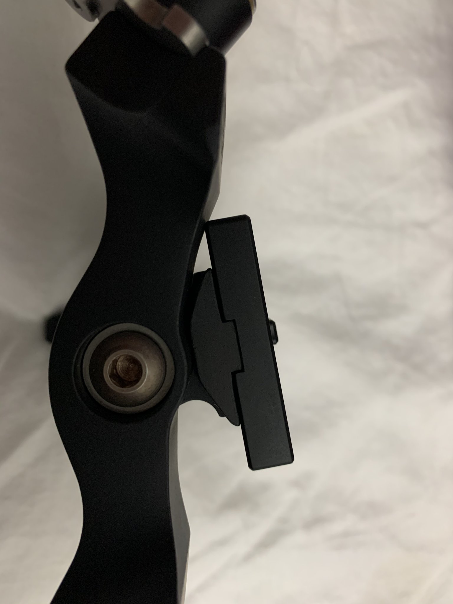

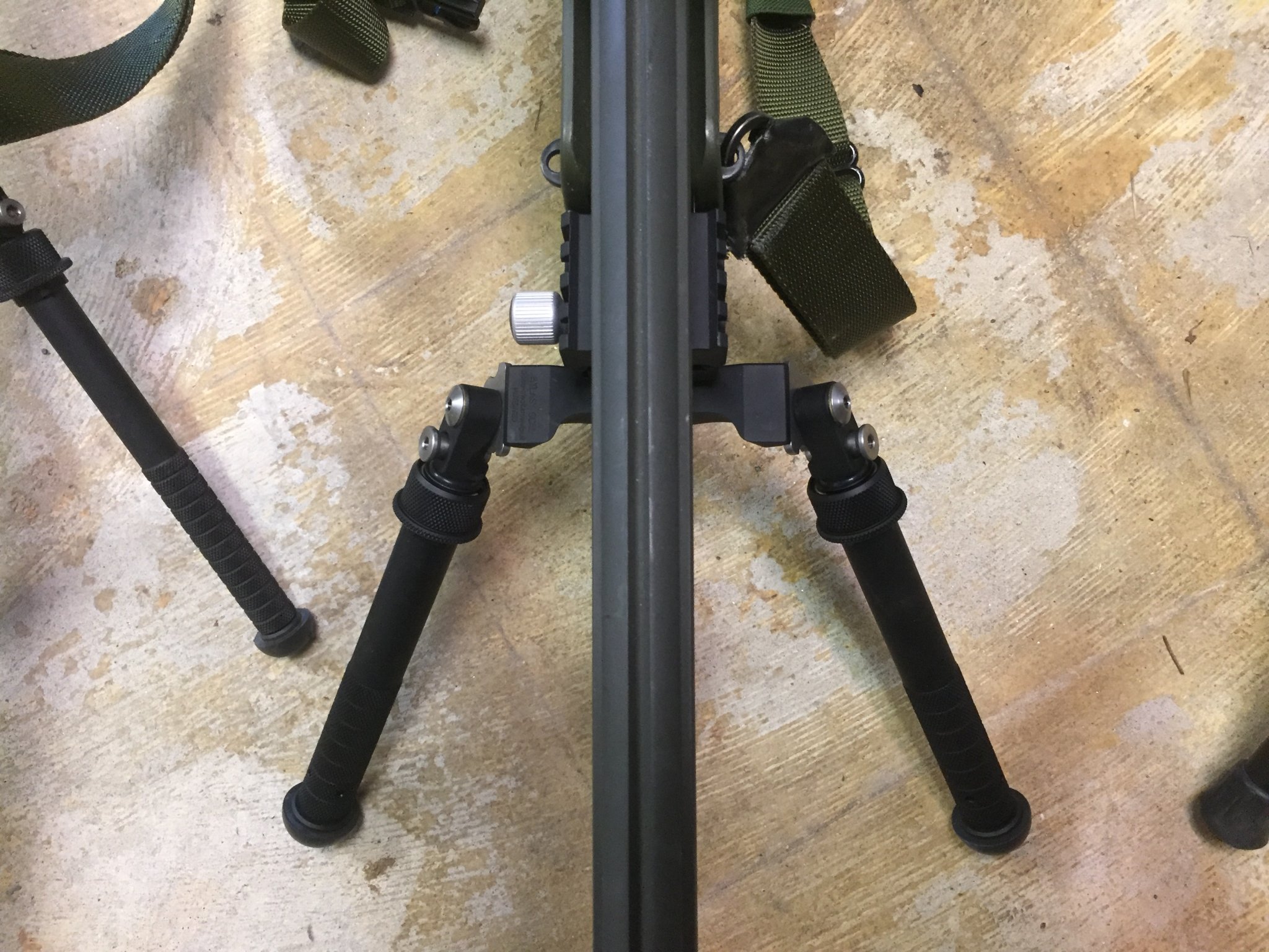

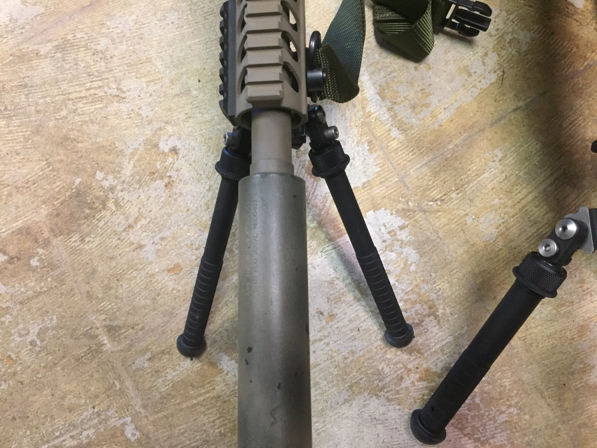

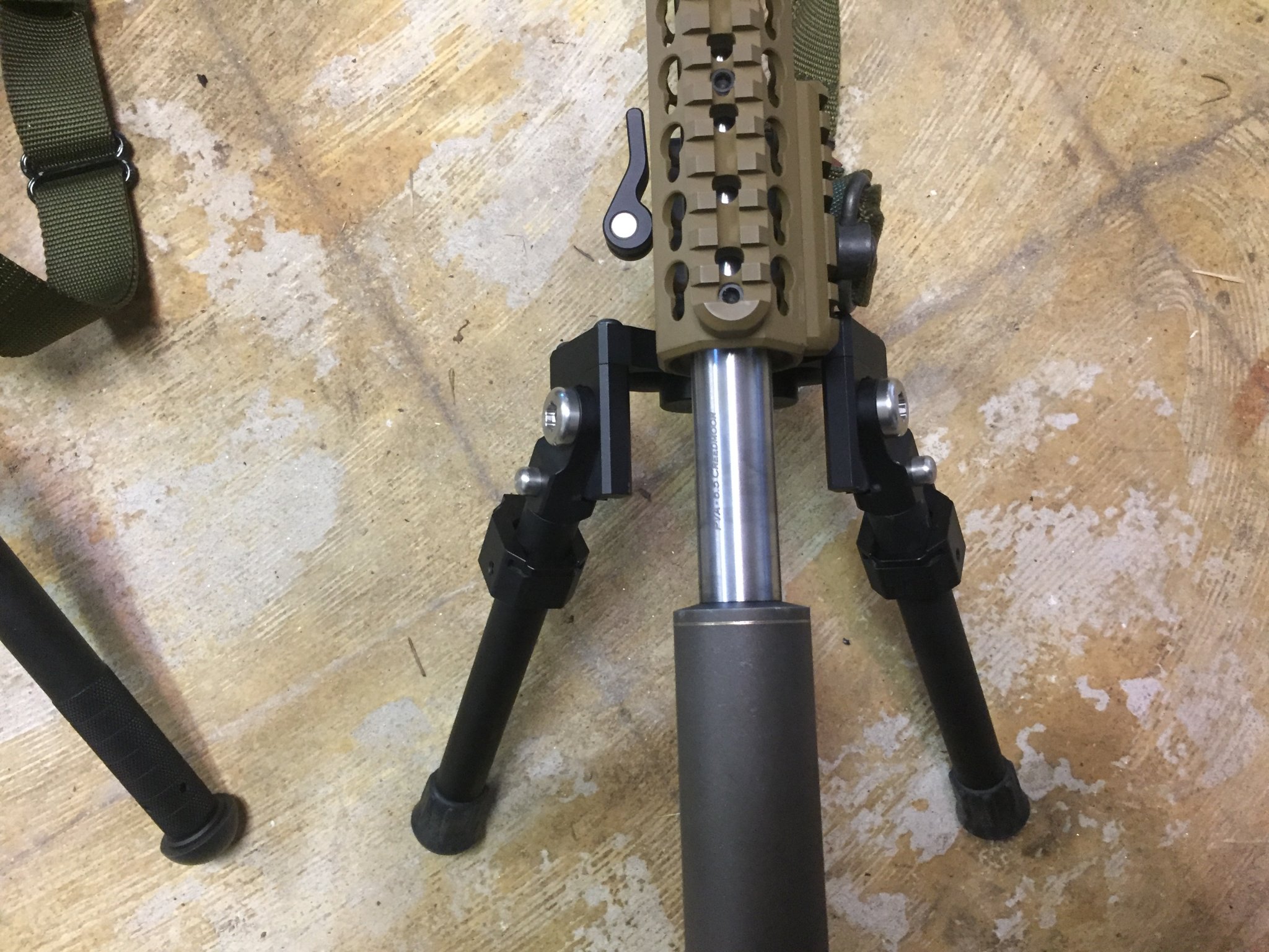

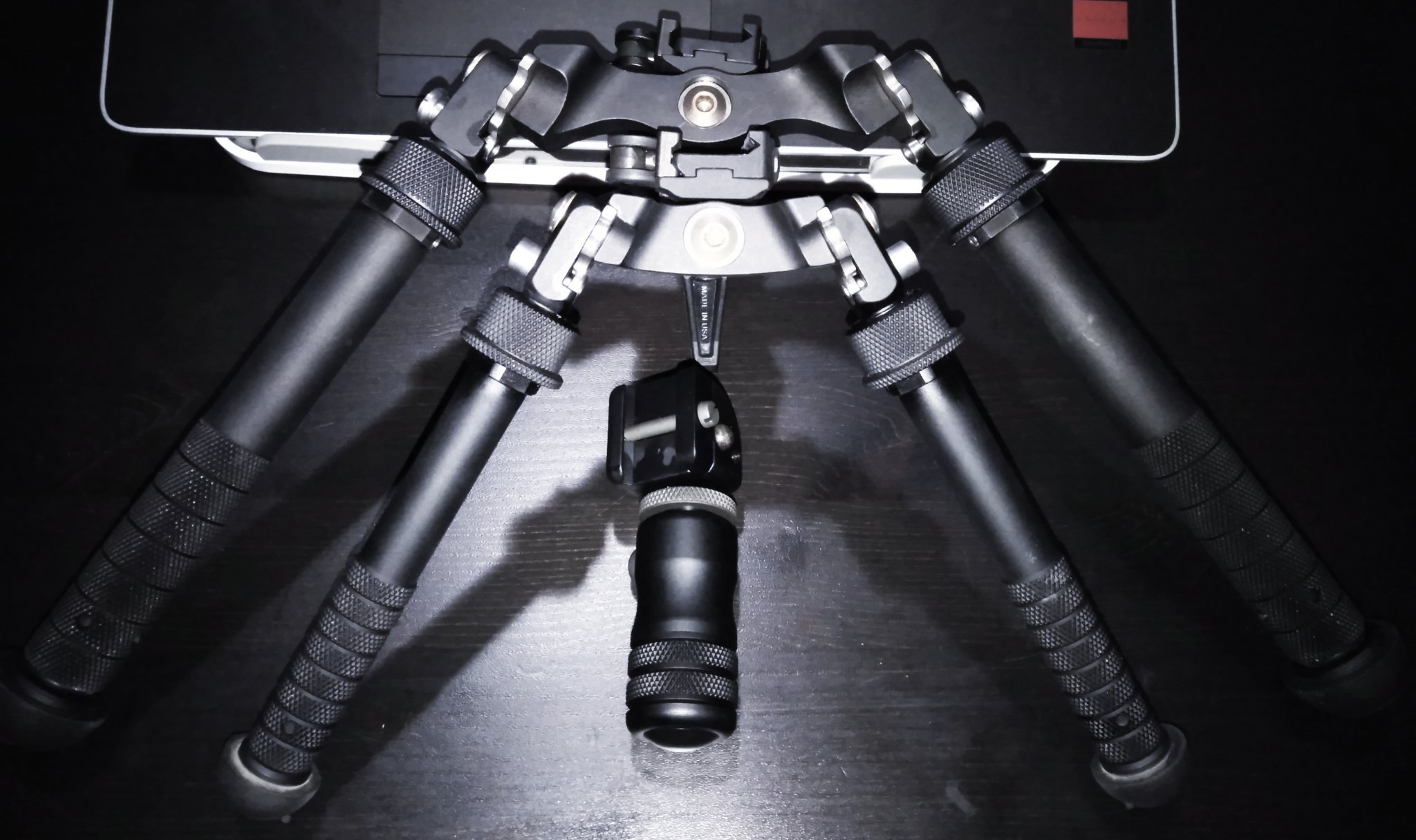

I tried my SCAL with both a RRS BTC Pro clamp and a Sawtooth Rifles adapter and found in both cases the clamp/adapter hit the bipod crosspiece before the bipod achieved full cant.
Try the rrs btca riser with the sc-lr clamp. Upgrades to a lever clamp. Works with the cal cause that's what I bought. Decided to go with the no dye cal instead of the super cal.Does anyone know of a narrow Atlas to ARCA/RRS clamp adapter?
BTC Pro:
Sawtooth Rifles adapter:
Full cant:

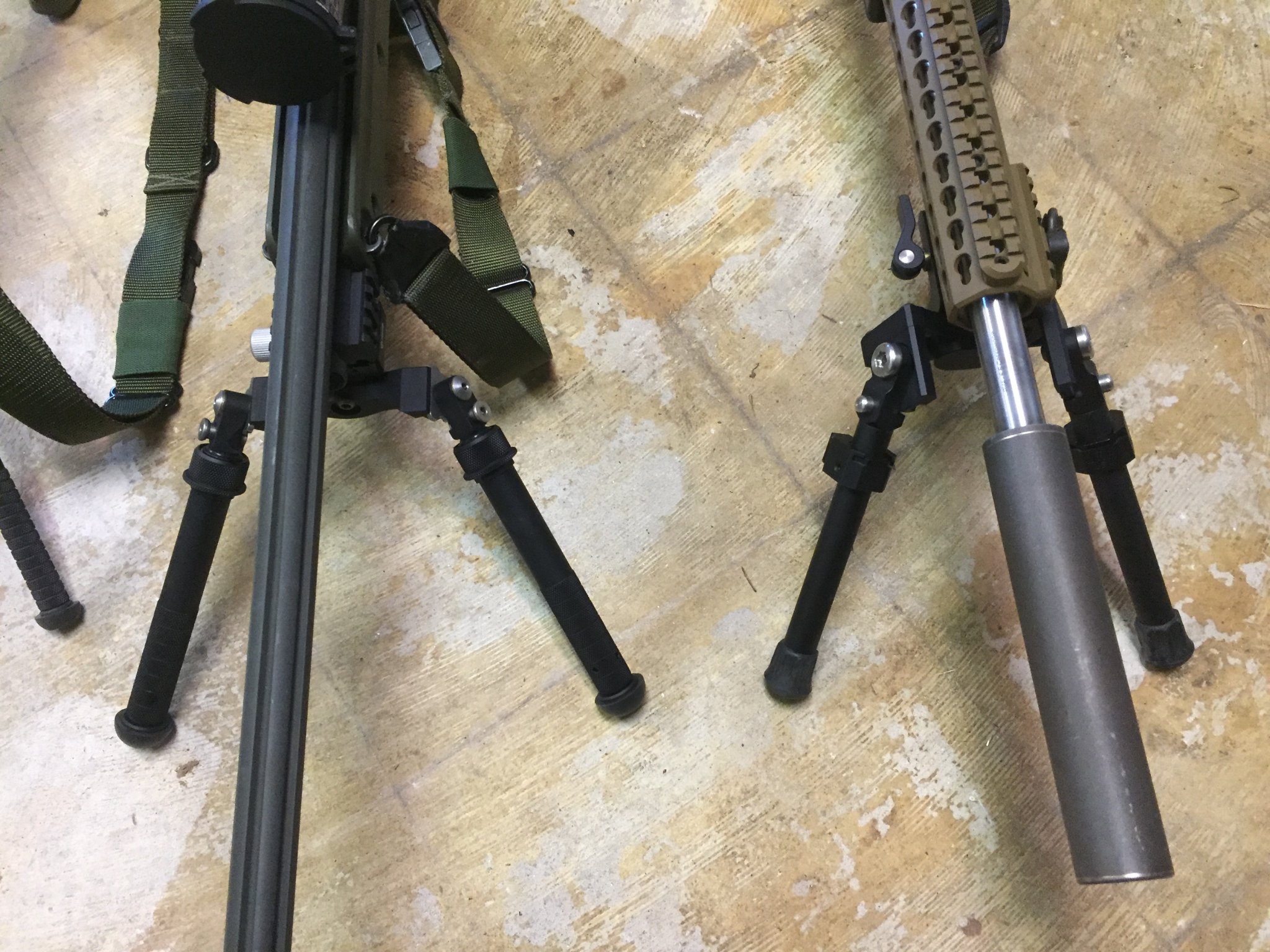

Regular CAL for comparison:

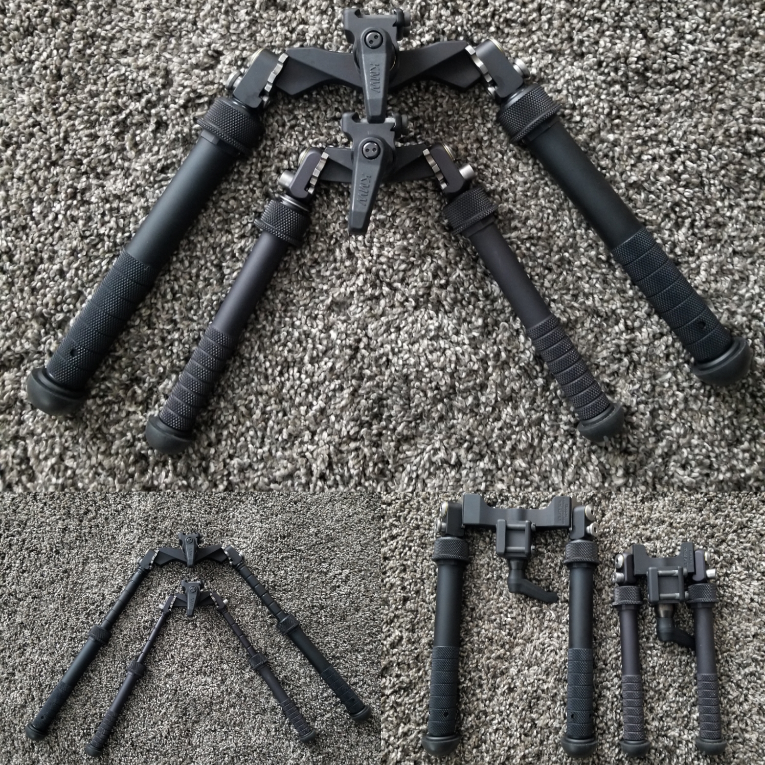

This thing is awesome! Fills the gap between the 5H and CAL perfectly. @Kasey, Thank you for such fine products and innovation! View attachment 7225384View attachment 7225385
The other one for the 5H might work then, it extends the clamp out away from the pivot point to allow full cant on the 5H. Plus it doubles getting your bipod out a little further.It's not the 5H one, it's this one: http://www.sawtoothrifles.com/store/p6/Sawtooth_Rifles_Bipod_Adapter:_Atlas_.html
get the Area419 SpigotDoes anyone know of a narrow Atlas to ARCA/RRS clamp adapter?
BTC Pro:
Full cant:

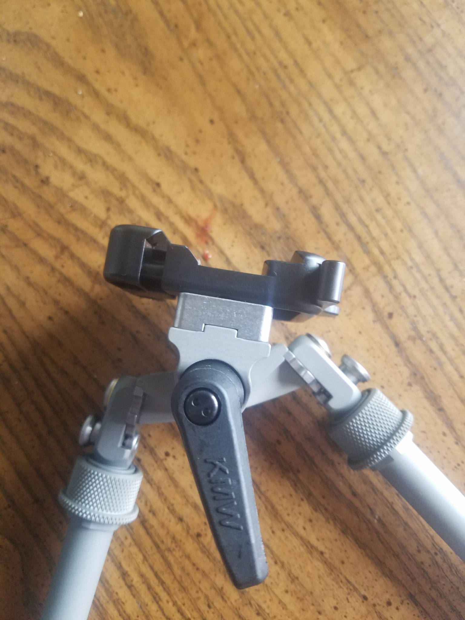

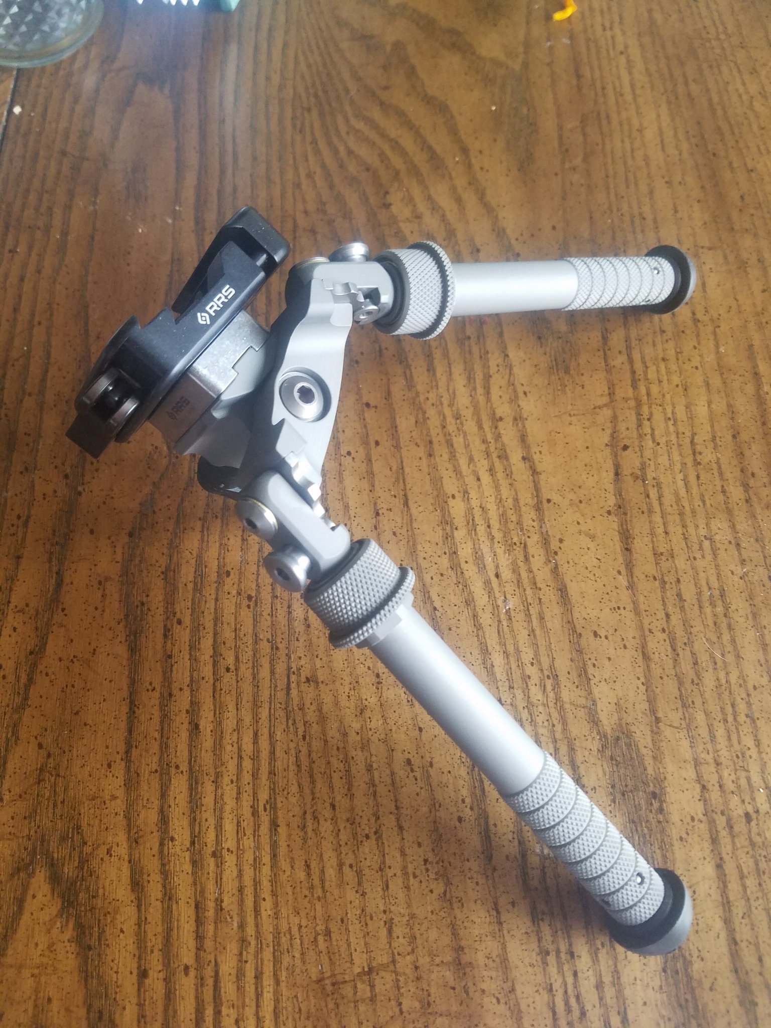

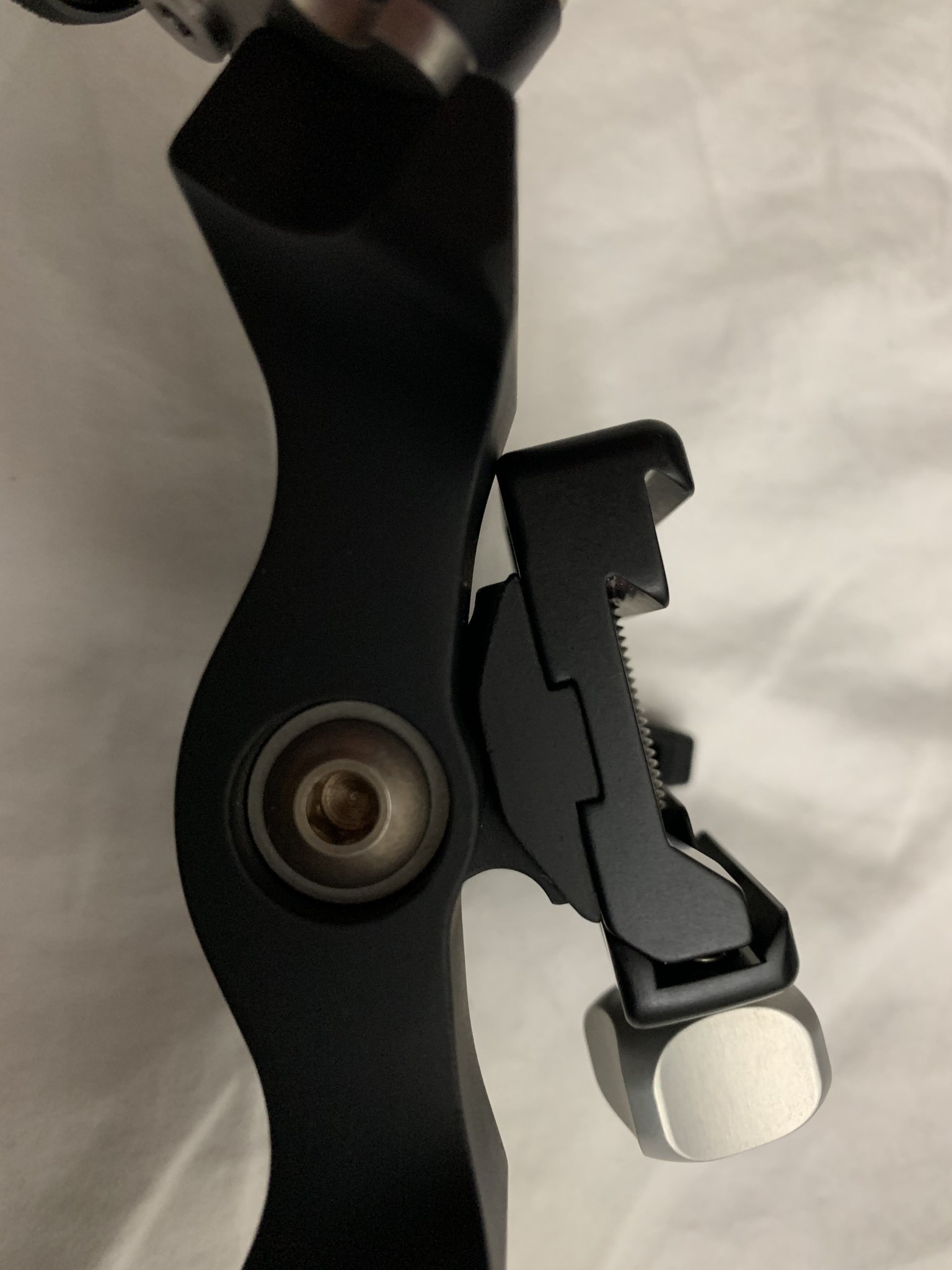

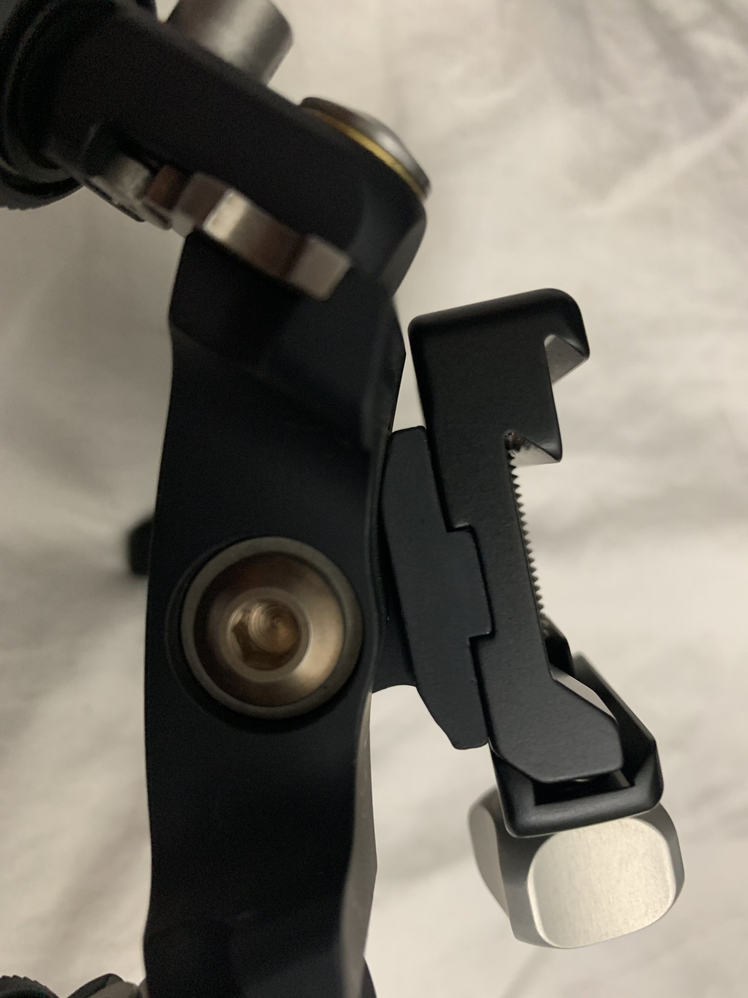

Does anyone know if this https://soar.reallyrightstuff.com/btca will work with the SCAL or Gen 2 CAL and https://soar.reallyrightstuff.com/BTC-Pro-Clamp-for-Atlas-Bipod to get full pan out of the bipod? I would rather not use a spigot like what Area 419 makes if possible. I don't really want it pushed out any farther past the rail.
Thanks. I tried calling RRS but they are at SHOT this week. The spigot just pushed the bipod so far out on my AR-10 that I can't reach it when shooting prone.I've got the btca adapter plate (no clamp) on order to try out. I can give you an update once it arrives.
Btca and SC-LR clamp work great with the cal2. Mine is the no dye.Does anyone know if this https://soar.reallyrightstuff.com/btca will work with the SCAL or Gen 2 CAL and https://soar.reallyrightstuff.com/BTC-Pro-Clamp-for-Atlas-Bipod to get full pan out of the bipod? I would rather not use a spigot like what Area 419 makes if possible. I don't really want it pushed out any farther past the rail.
the adapter is required for full cant. or the a419 spigotBtca and SC-LR clamp work great with the cal2. Mine is the no dye.
If you are going to go with the Btca you might as well go with the sclr. Sclr doesn't work with the atlas unless you have the Btca (unavoidable design constraints per @MPHReallyRightStuff)

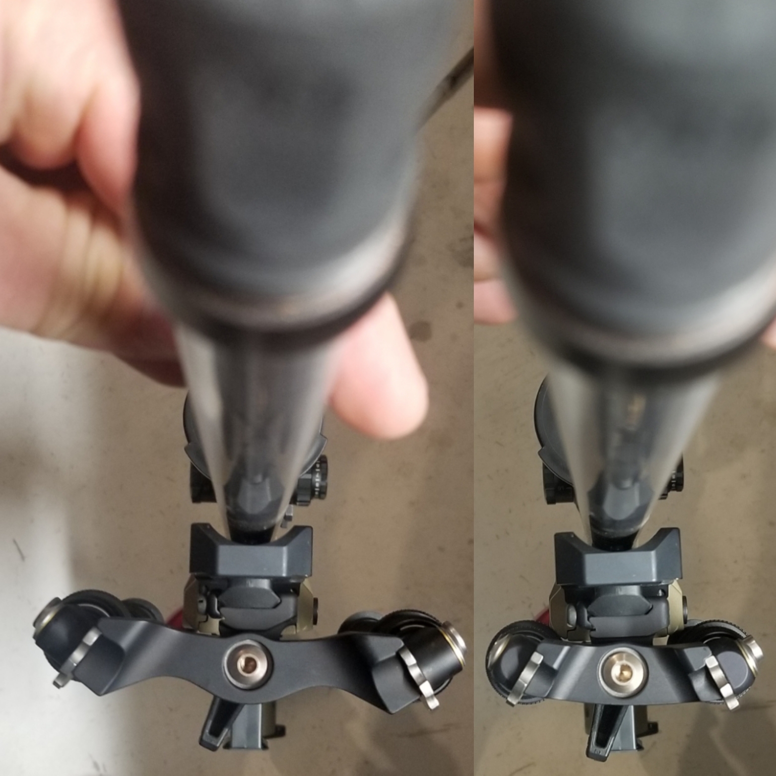

All pictures taken at full can't.
View attachment 7231484View attachment 7231485View attachment 7231486
Also no the Btca and the pro will not work together. The Btca has 2 screws to go into the atlas. You then screw the plate into that with 1 screw with the raised area providing rotational stability.Does anyone know if this https://soar.reallyrightstuff.com/btca will work with the SCAL or Gen 2 CAL and https://soar.reallyrightstuff.com/BTC-Pro-Clamp-for-Atlas-Bipod to get full pan out of the bipod? I would rather not use a spigot like what Area 419 makes if possible. I don't really want it pushed out any farther past the rail.
I already have the BTC-Pro and just wanted to find something other than a spigot mount for it.Also no the Btca and the pro will not work together. The Btca has 2 screws to go into the atlas. You then screw the plate into that with 1 screw with the raised area providing rotational stability.
The pro has 2 screws in it which are the same location as the Btca. Also the pro has no cut out for the raised area.

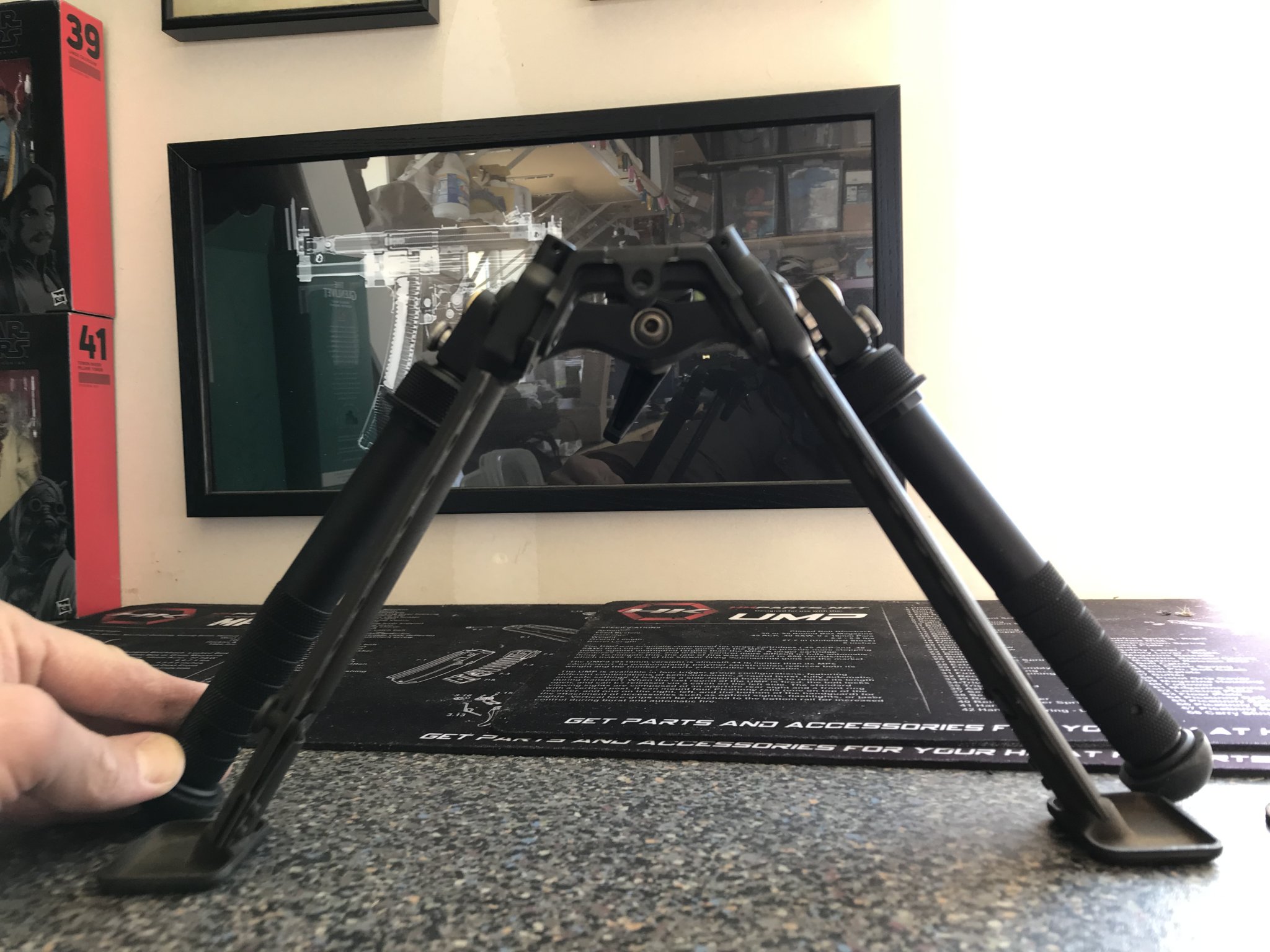

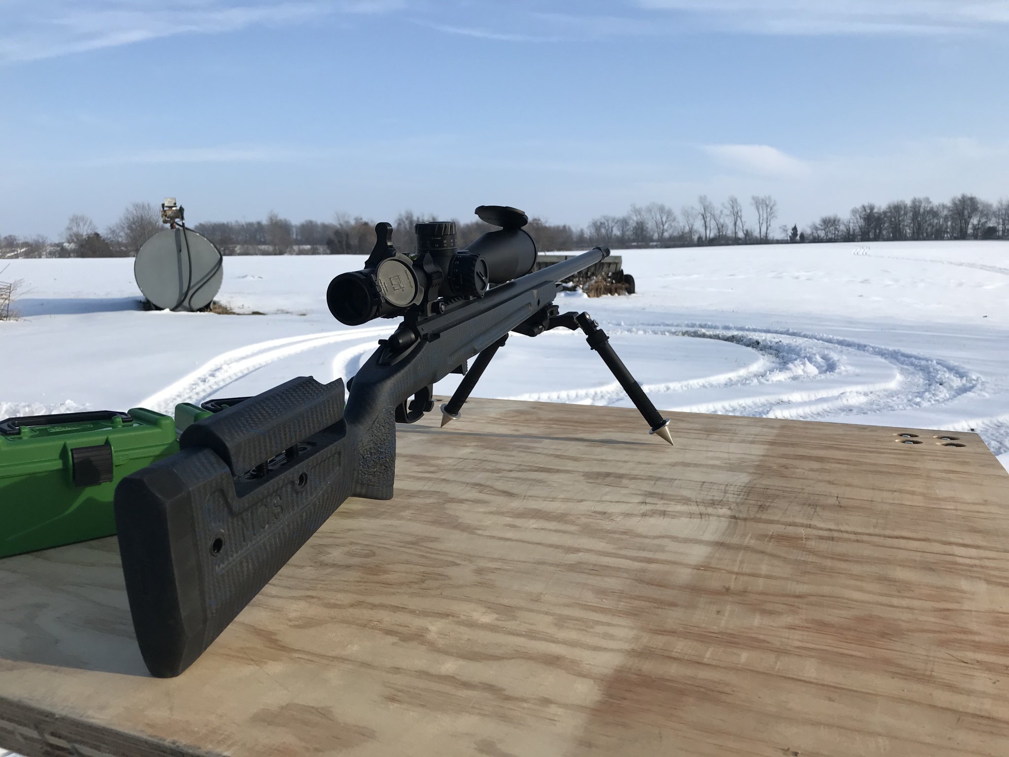

What feet are on your CAL?
Those are Boscabel bel-lok titatium spiked feets.
Made in Australia.
Boscabel | Necessity Redefined
www.boscabel.com
How do you like the ball joint vs fixed angle like the other feet?
Shot the SCAL today. Great bipod. Really stable. Love it!

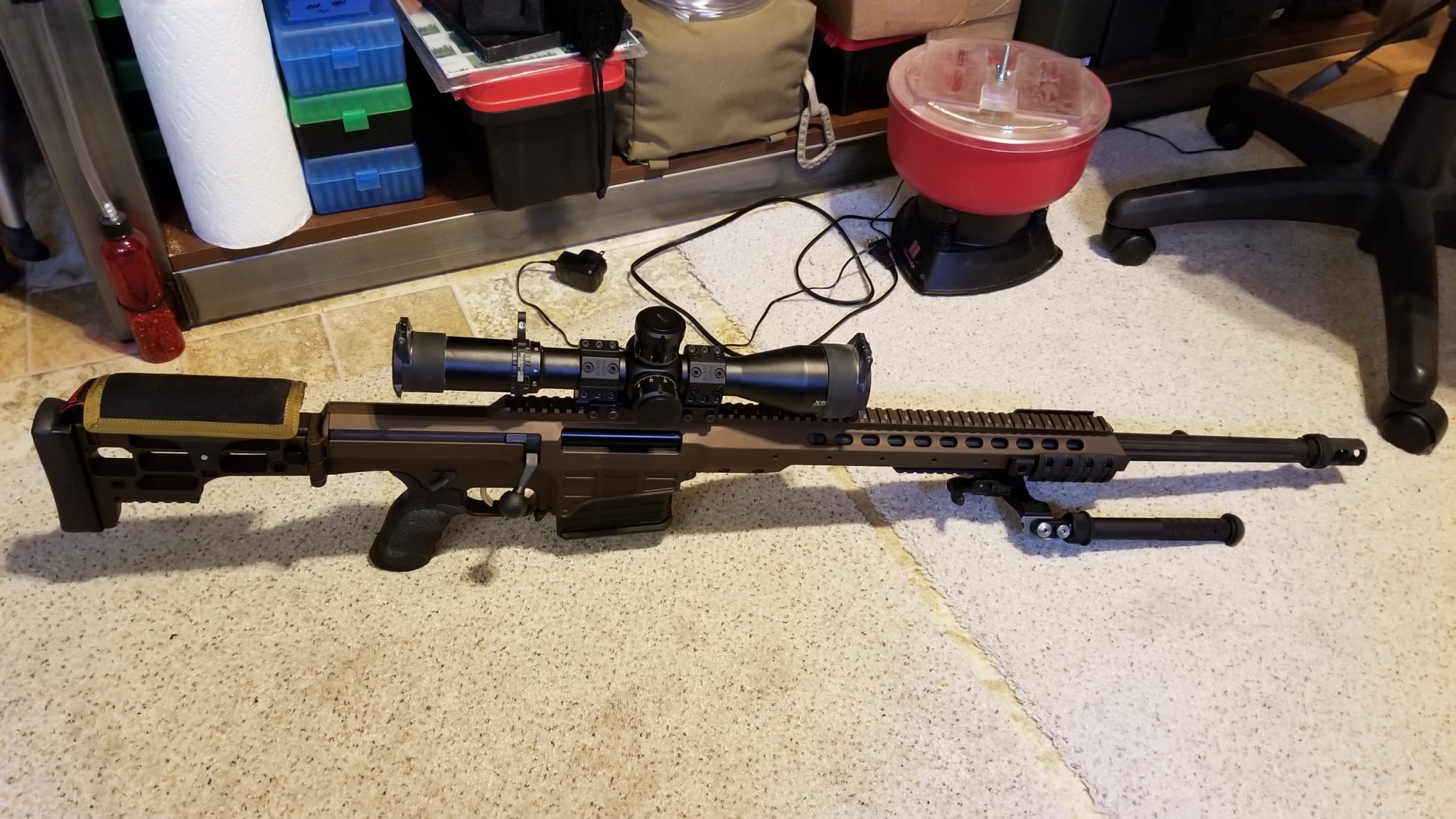

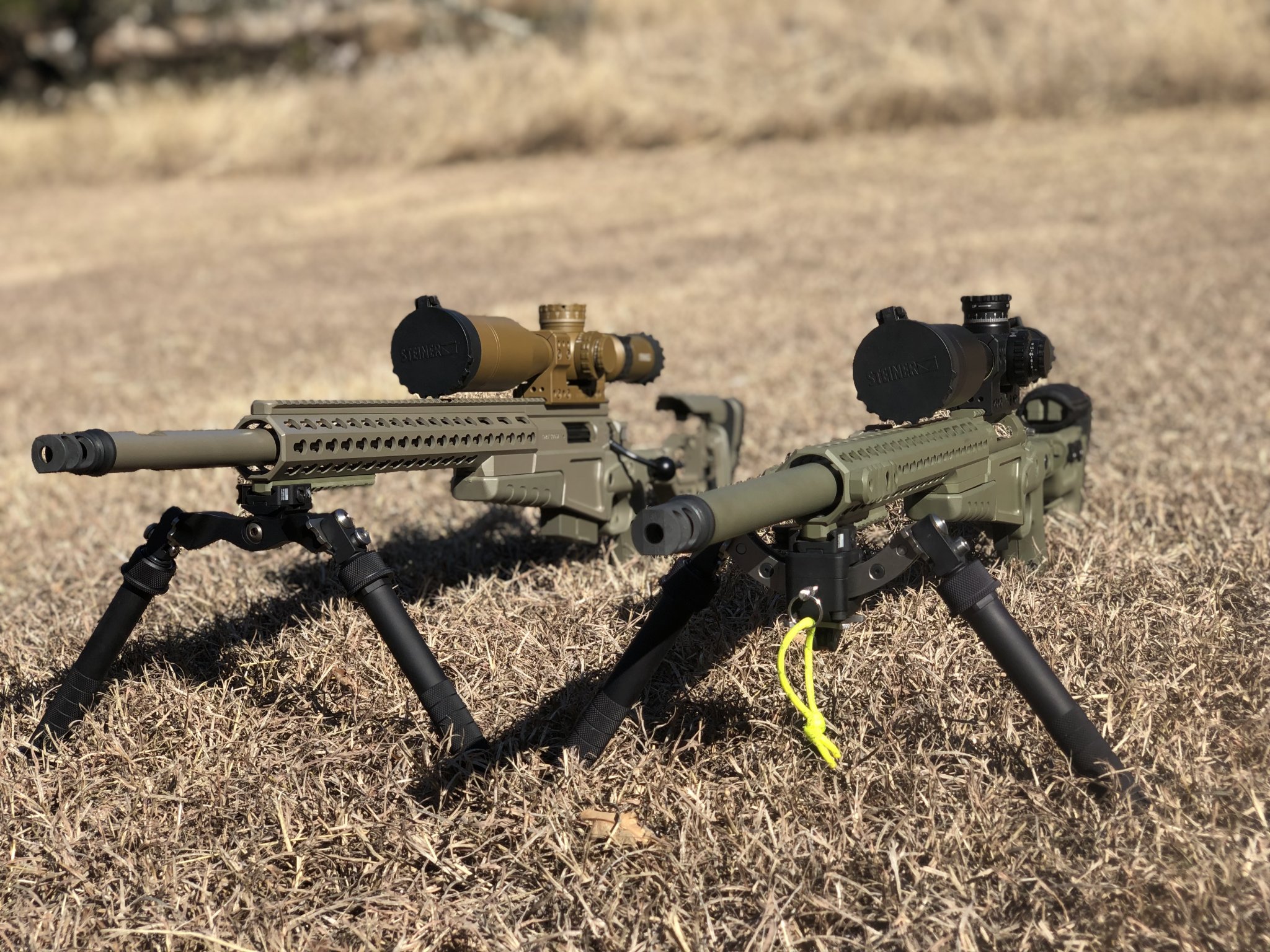

FSD - who makes the short arca-rail on the chassis in this photo?
I now know who to call if I want glamour shots of my rifles.
What chassis is that?Nice, you got the Atlas spikes on the SCAL.
I should buy those too, in winter time those spikes are the one and only right feet on bipod.
It's a krg whiskey 3 that he painted. @viking78 shows lots of pretty pictures of his Tikkas in the tikka thread.What chassis is that?
Really Right Stuff, here is the product link to the W3 plate.FSD - who makes the short arca-rail on the chassis in this photo?
