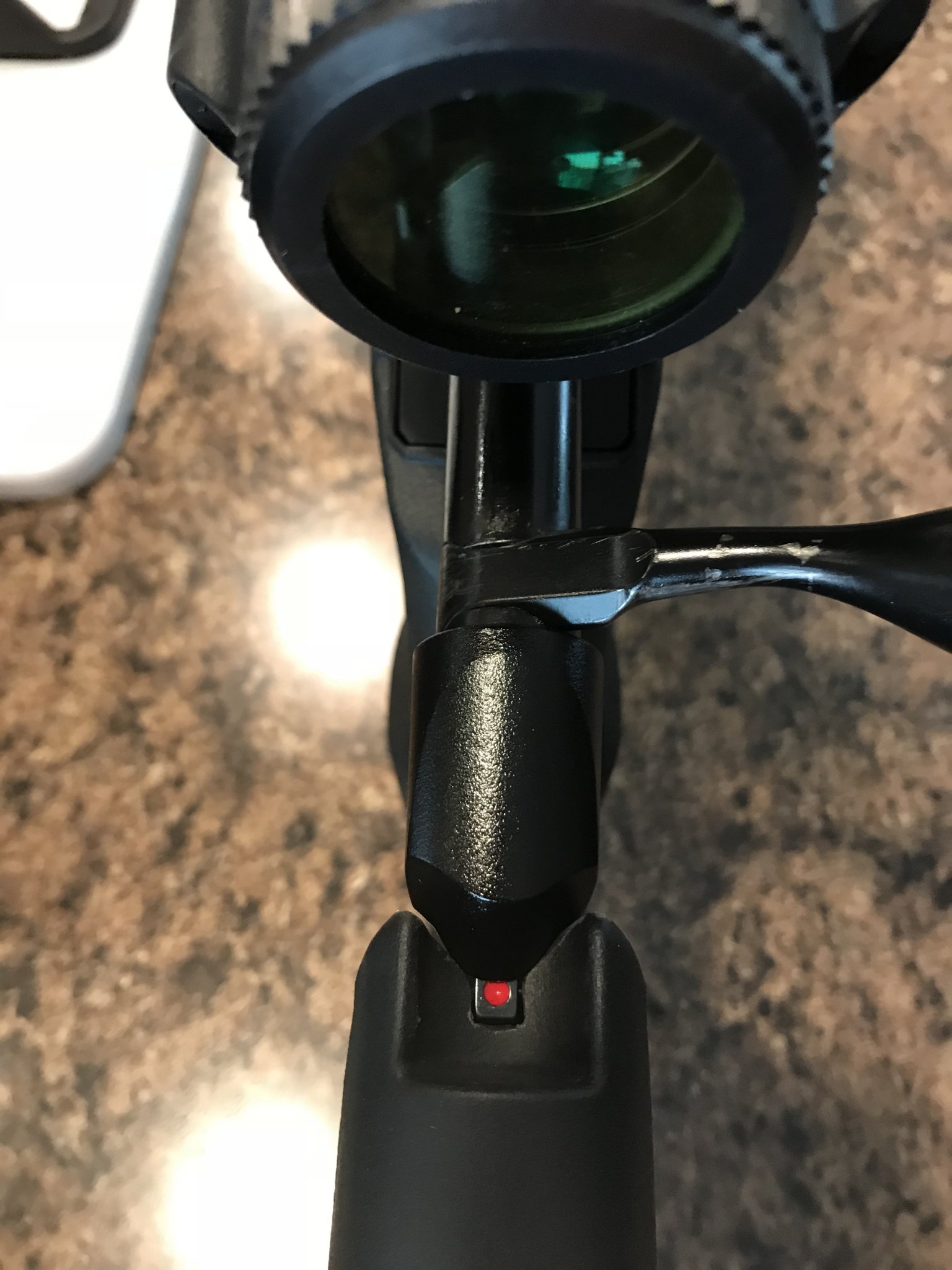

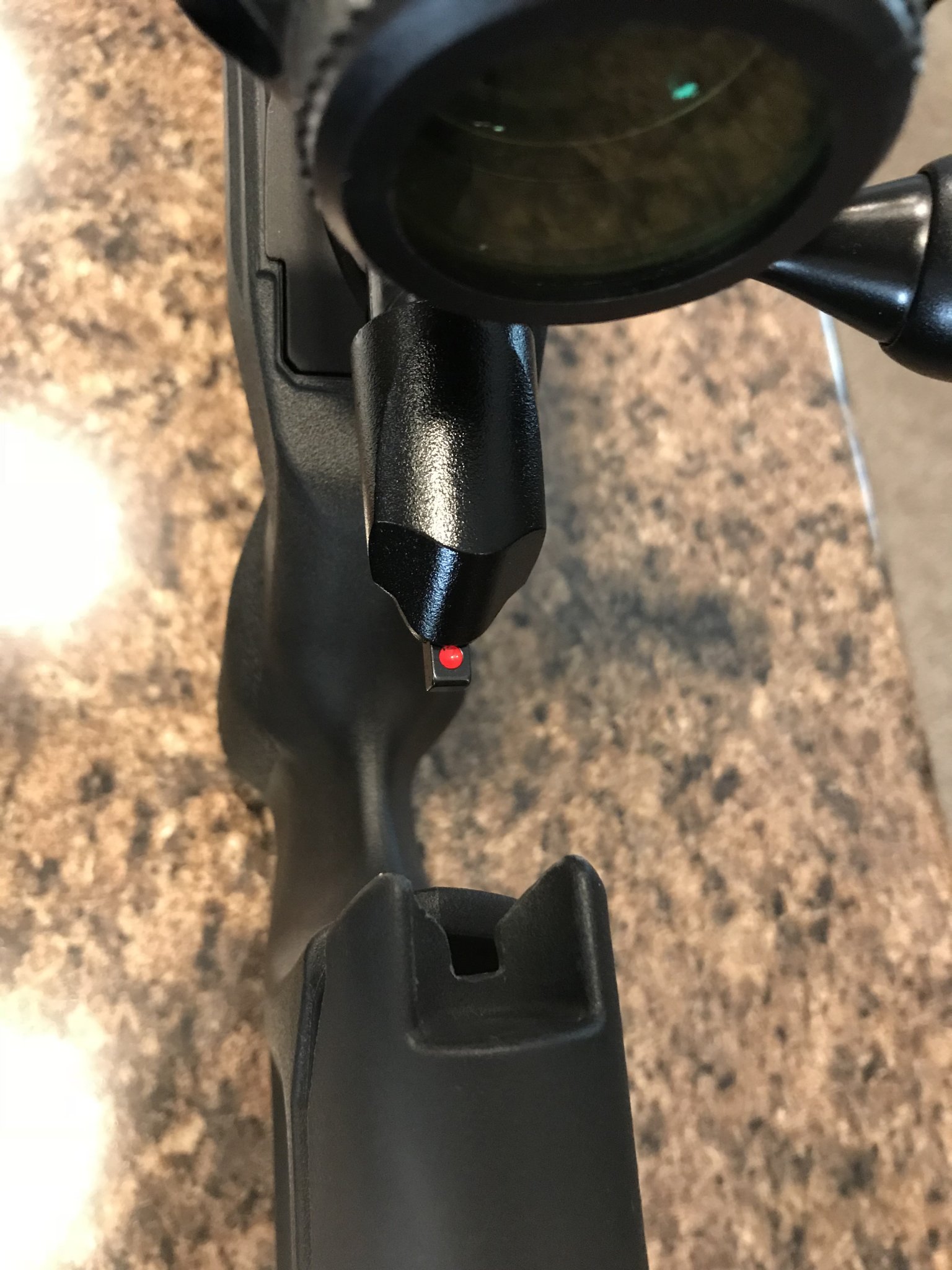

I just received a Bravo and installed it on a Tikka .223 Varmint action. A couple of observations.
1. The stock is solid, no flex at all
2. The adjustable Cheek Rest gets in the way of the bolt on full extension. In other words, when set to the correct height for me, the bolt slams into the check rest before coming to a full stop.
3. The cheek rest has a little wobble to it once installed and cinched down. This is from the flex of the polymer.
4. This is a bit nit picky, but the rear half of the stock does not mate up to the front half cleanly. The rear section is slightly wider, and the lines do not match up cleanly.

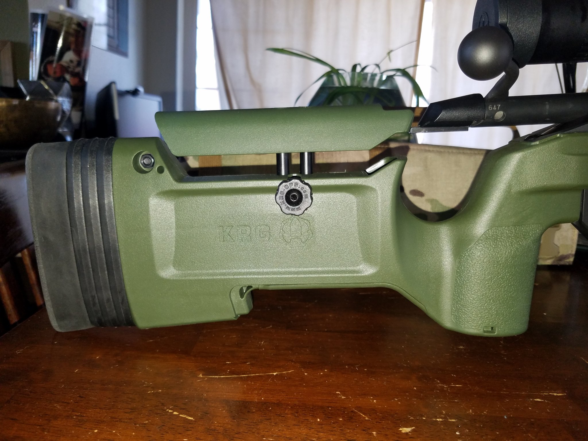

I had the same issue with my Bravo long action. I spoke to KRG several times on the issue thinking they might have a solution, but they did not.
In the end, what I did was build up the rest with several layers of dense cell sheet hobby foam. These were cut to shape to fit over the riser, then glued together (and to the riser) with contact cement. I ended up with about 3 layers. Looks fine and allows the riser to accomodate my face while still sitting low enough to allow the bolt to cycle. As it stands now, I set it up so the rear of the bolt rests in the notch of the riser when fully aft. Pics if you wish...

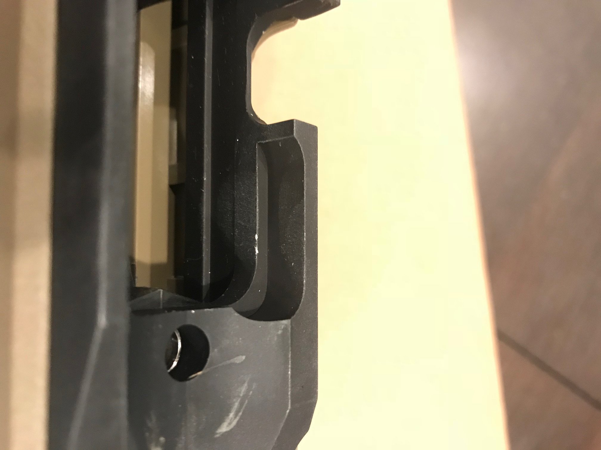

Here is a picture where you can see the spine along the side has two marks where it appers that the safety was binding:
My bolt lever was also hitting one of the sides of the opening:
The former is a function/safety issue. I could have used a Dremel, but that should not be the answer for getting a standard action and after market trigger to mate up properly. I ended up sending it back, but I may try one again when I get my Nucleus built up later this year. Hopefully, by then they'll adjust their machining tolerances to be a little more forgiving.

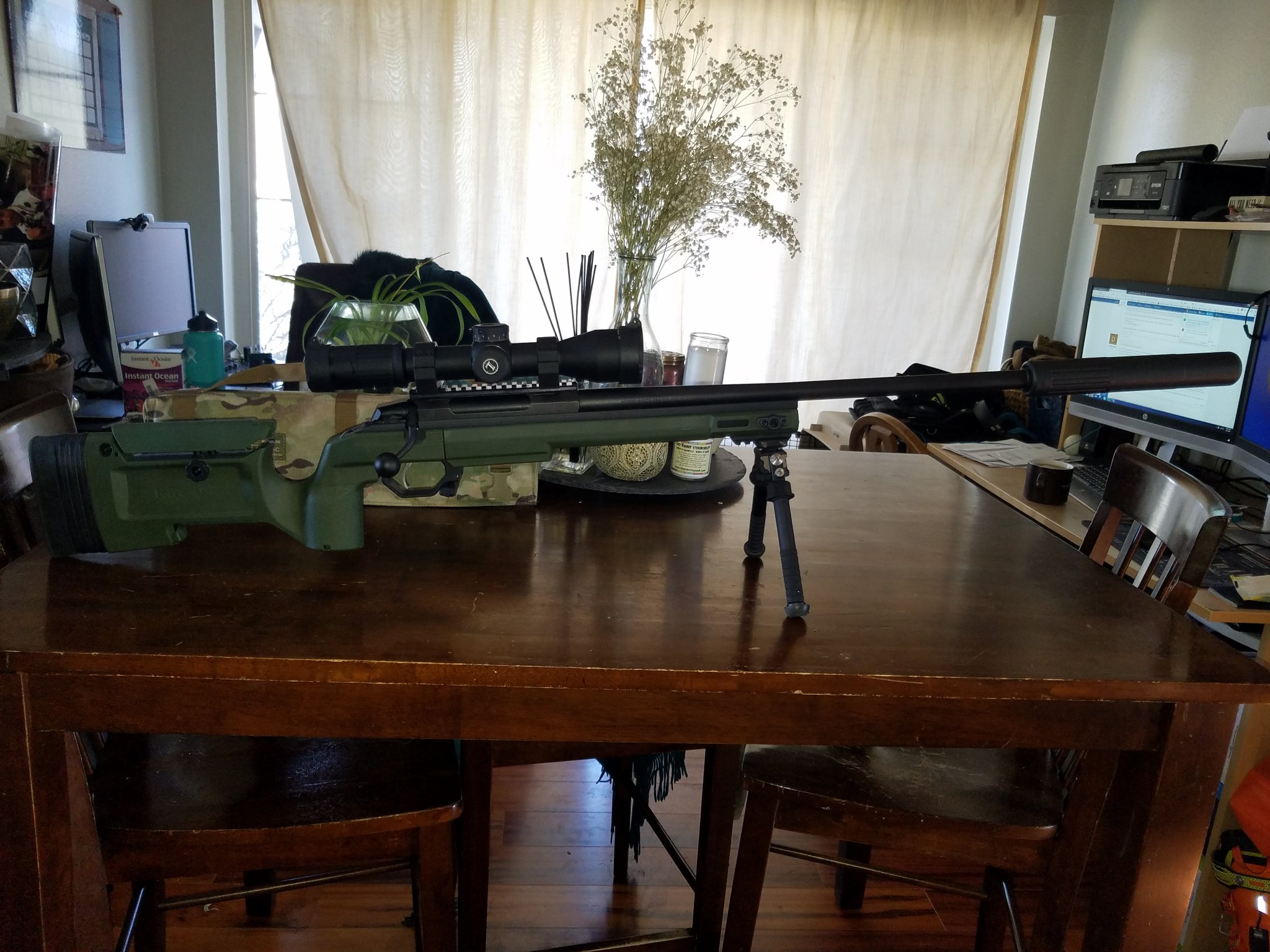

Finally got my tikka mounted up:

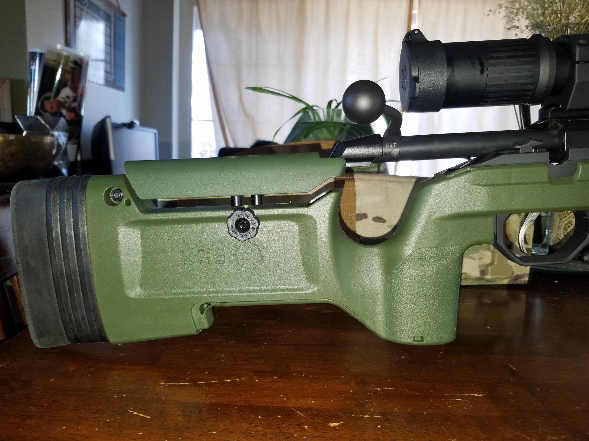

one issue me and my buddy found was the bolt hits the cheek piece depending on how high it is, kinda a bummer but can be fixed with lower rings and a pad on the cheek piece.
all in all for a $400 chassis i am super stoked it feels and looks great.
specs are:
20" .308 t3X CTR
Sako Green Bravo
Leupold Mark 6 3-18 h59
MT 20moa base and seekins precision rings
currently wearing a AAC 762SD will one day be an AE30
12.5lbs with the supressor, ~11lbs w/o

-The T3 cocking indicator does interfere with the Bravo cheekpiece in some positions as seen in the pics. The Bravo was designed for the Rem 700 first as opposed to the W-3 which was Tikka first. The current solution is to clearance the cheekpiece a little. In the future we'll have a fully relieved cheekpiece that will come with the T3 Bravos
