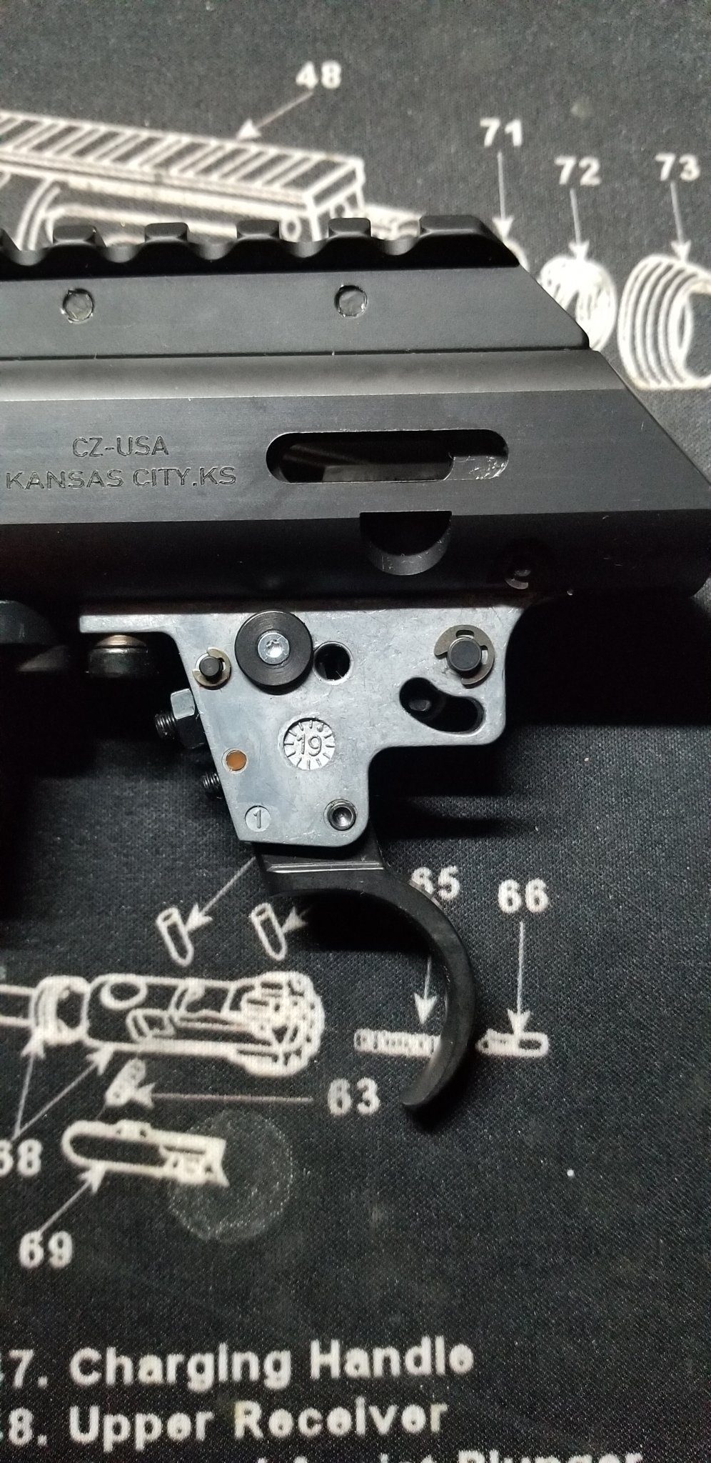

Can someone tell me if this looks right ? Is the pin holding the bolt release in place suppose to be all the way in, or is it just held in place by pressure from the spring.. TIA
I'm pretty sure that is correct. I have mine boxed up ready to be sent to MPA or I would look at mine. I take it you found the bolt release lever?
Yup..found the lever, pin and spring floating around in the bottom of the box and in the packing paper.. I emailed Carson about it and he never got back to me.. Freaking outstanding customer service..
I'm still wondering why they had to take it out. Also, why they didn't put it back in before shipping the rifle. I truly hope you are happy with it. As I've said before, my 17 HM2 barrel shoots pretty good on my Sako Finnfire but it loads rough and carson is crabby. Therefore I can't buy anything else from them.
