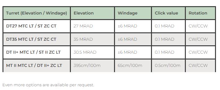

Lol you said 35 mils at 1774 yards above. Yea I'm not aware of to many scops with over 35 mils of internal you will need a eratac or a Charlie once you start needing much more than 35
Reactions: deersniper
Sorry my go to 338 LM load is only 18-18.2 up at 1774 depending on temps.. My 338 LM AI runs flatter w Warner 256 FL. AI AXSR 33XC barrel will be here next week.. should gain 75-100 fps. 40 mil of elevation would be nice just incase 😉
The new Zeiss and SB 6-36 offers 40 mil turrets I believe. Maybe March also?
S&B 39.5 mil looks like
Idk I don’t own one yet. Just going off factory specs. Should be internal travel?
Reactions: Huskydriver
Just a heads up most the sbs I have used have 35-37 mils internal but the turret will be the limiting factor depending on configuration chosen. I only have ultra shorts these days ymmv
Have you used the 395cm turret?
The 395s rock. It’s obvious which click you’re on (even with my aging near vision).
They work great, and the extra “ok, so it’s 0.05 per…that means… 19 clicks gets me to 0.95” stuff was second nature pretty quickly.
(with 3-27) And the usable elev is stupid. 20MOA rail + 20 MOA mount and 100y zero leaves me 33.25mil.

I'm probably just dumb but is the only difference between the MT II MTC LT turrets and the DT II + MTC LT (besides the amount of turns obviusly) the way it distinguishes how many full rotations you've gone? I've had a couple S&Bs in the past with the DT II+ and they're really nice but never the MT II turrets. Are they essentially the same? The DT II+ are some of the best turrets I've felt, right behind the TT.
The mtii+ feel the same but obviously twice as many clicks per mil
