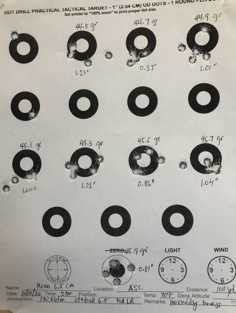

Did some testing on this over the last two days. Was looking for a 6.5 cm load that I could shoot out of multiple rifles. Tested on two so far and with 142 SMK at 2.78 oal, 44.3 gn gave me no pressure and really good results. On a 26" barrel I got 2905 with an SD of 10 and under .5 inch. On a 20" barrel I got 2765, SD of 14 and still under half inch. Shooting at 120 meters, FWIW. These are loaded on a 550, so 44.3 is what I set, but there will be a little variation. With that in mind, these are really good results for me. No pressure signs at all. The 142s are so easy going, that I am not sure it actually says much about the powder.
Loaded 5 rds each from 44.5 to 45.9 with .2 increments. Projectile is 130 eld blems from Midway. Looking for a good practice ammo at 200yards using my RCBS uniflow. Will update you guys with the results.

Shot the 130 eldm blems loaded with 44.5 to 45.9 Staball. Magneto battery died so no velocity data. No pressure signs on all rounds. Will load 10 each of 44.7, 45.7 and 44.9 to confirm and whichever groups the smallest at 200 yards will be my practice load.
