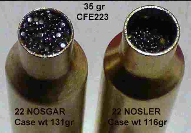

With my 22N I've found pretty good results with CFE223 for bullets up to 75Amax (have a couple thousand for plinking) and IMR4350 (which I have) instead of H4350 (don't got) for 80/88ELD, 85RDF, and 90gr pointed Sierra's.
Just looking at the data, velocity at published max seems higher.

Moving about in bullet weight StaBall 6.5 seems more predictable in cartridges the size of the 6.5C,
than say the 223, or even the 224V. The 22N data seems to flow smoother from weight to weight of projectile. At least they have some Min/Max values that seem to make sense.

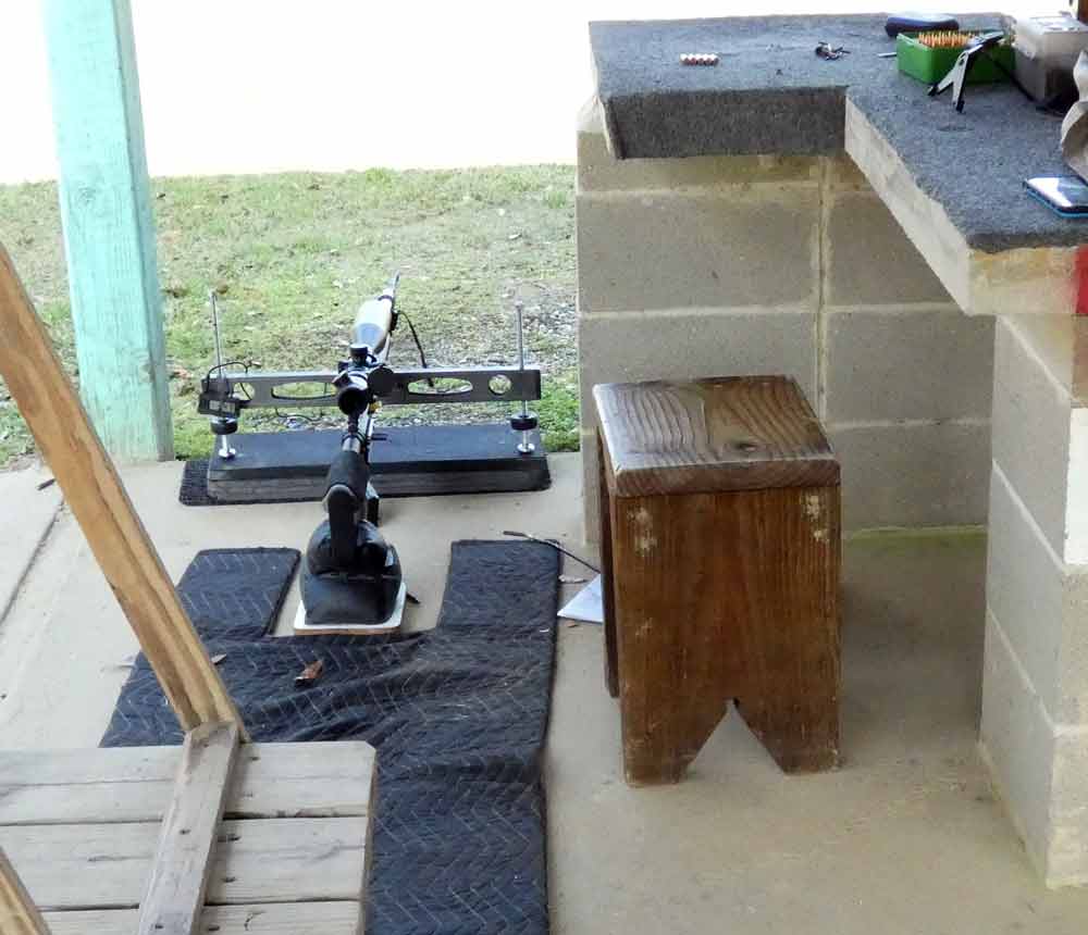

I also bought a Magnetospeed sporter (the cheap one) so I don't have to set up the Optical on a tripod.
(too cheap to buy the radar).

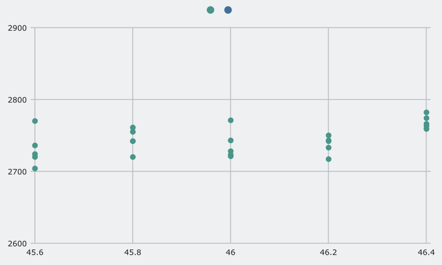

Ran some load development today. Was very impressed by this new powder. Ran it in my RPR 6 creed. I used Peterson virgin brass with CCI magnum primers starting at 43.0, 43.5, 44.0, 44.5, 45.0, 45.5, 45.8, 46.1, 46.3 and 46.5 grains of 6.5 staball powder.
This was shot out of my RPR in 6 creed. Stock barrel and Vortex PST 6-24. Magpul Bipod and homemade rear bag. AAC 51T Brakeout muzzle device.
I started seeing heavy lift at 46.1 and stopped shooting at 46.3 due to pressure. My best load was at 45.5. I am attaching a picture, the top left grouping was the 45.5gr load. All bullet seating depths were at 2.750 COAL. I will measure tomorrow both target papers and list the size of groupings.
I wasn’t able to get chronograph readings for most of the groups due to not having the right spacer for my MagnetoSpeed. I put the can on at the 46.1gr and was reading 3350fps average. The 44.0 grain load I used for fouling and sighting in was at 3140fps average.
Dont mind the bottom left and right targets. I was messing around.

An example of case brand is the 22 Nolser brass I have and resized 6mm Hagar (22 Nosgar).
The Hagar brass is way heavier. Loading the 75Amax/ELD long, 2.445" I get 'about' 95% with 29.9 grains in the Nosler case and drop a grain or so in the Hagar case.
I don't think I could load 93% of the 35 gr shown in the pic.

Back from the range with results with my 22 Nosler, 88 ELD, 90 SMK, and SB6.5.
I'll post a couple pics, toss the brass in the tumpler, and take a nap.
I have the order of load to dot in my logbook, and velocities taken with my Second hand MagnetoSpeed Sporter. It worked every shot. What's odd is I expected POI to be just a little lower but was a little higher.
Took it off, made some shots to see just how much I needed to adjust, and nothing.
Same zero as before.
The loads I used got the 88's up really close to a 3000fps average, and the 90's just over 2900fps.
No signs of any pressure.
Here's the setup
Everything @ 100 yds.
10 shots with 77 grain Factory
Then the end of the day.
Some of the 5 shot groups were smaller than a quarter, some not :(
Added Group sizes and matched up loads to dots
