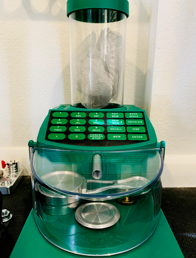

    A buddy told me to do this, and it works great. Just grab a few (2 or 3) used dryer sheets from finished dryer loads (Bounce, for instance) ... crumple them up and loosely store them in your powder hopper like I do in my Chargemaster below. It fights static electricity and makes the powder fall easily and cleanly when you clear the bin. Maybe everyone but me already knew this trick, but since it was an epiphany for me ... I figured I'd share it.
    Good tip and as a bonus the powder dispenser will smell outdoor fresh!
    Not much smell ... since it's already depleted with a load of laundry. But "just enough" left to kill the static. If you want your Chargemaster to have that refreshing spring meadow smell ... use a virgin dryer sheet (but I don't recommend that). LOL

    I keep a dryer sheet under my charge master lite. It seems to work well, no drifting. Seen that somewhere and just wiping down the out side with it also.
    Or just wipe down the inside of the hopper with a dryer sheet and you’re done, for years. No need to store them in there.
