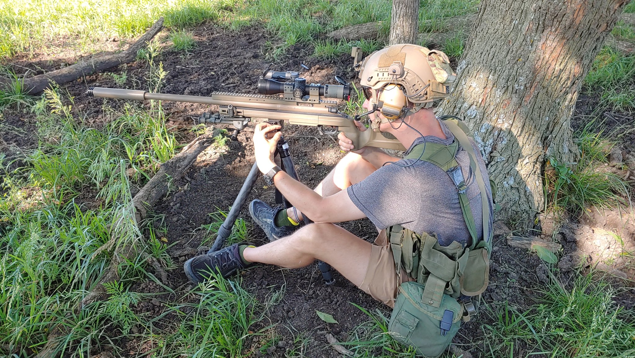

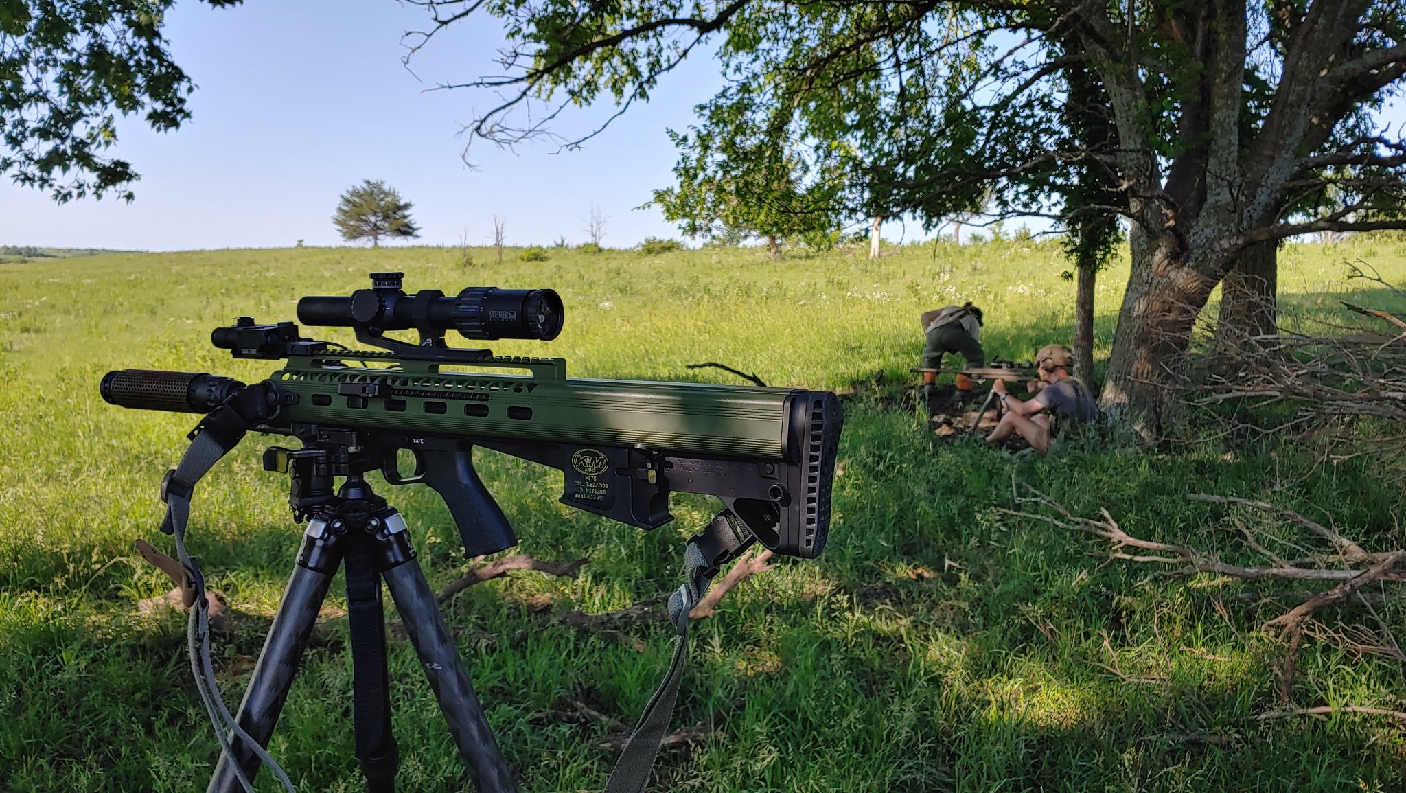

Firing point during the day:
Stagg had to get up higher to get over the grass after all, but this position looked good and is the photo I have:

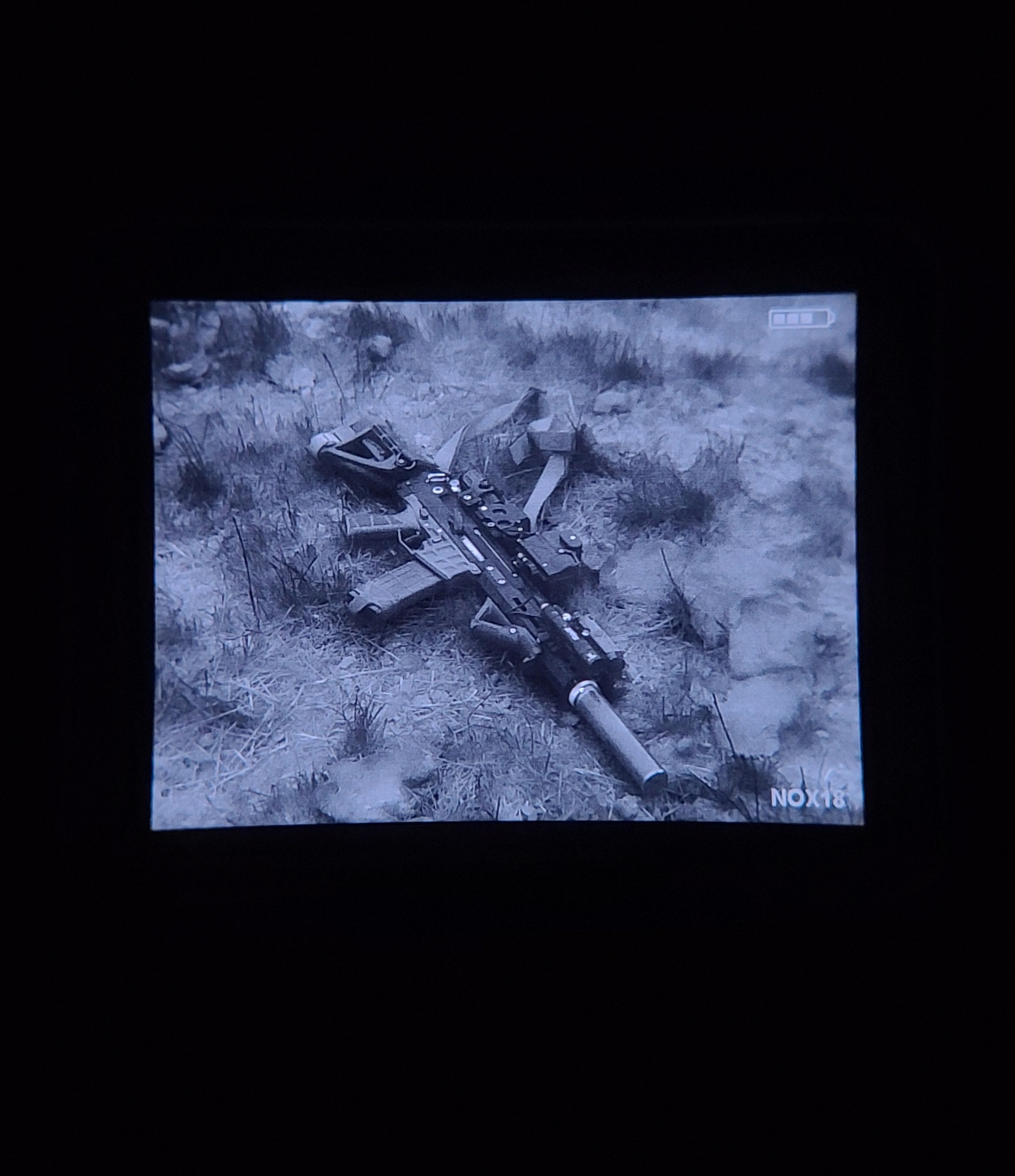

Ready for the night march:
Thermal is in the SORD hard LRF pouch on the LBE right front. Clipped it on once outside, later. Pack is a Crossfire DG-3, tripod is in a SORD tripod pouch on the back of that. Terrific packs.

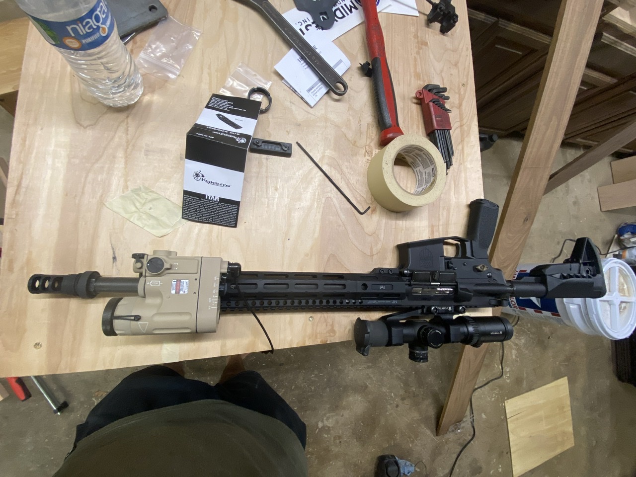

Zeroed the iron sites last week and the day scope today, then tonight co-witnessed the CQBL laser to the reticle at 150yds.
There's also an olde armasight LED illum on the 3'oclock ... it has a nice wide and clean beam out to 200yds, so plenty for my current purposes.
And the UTC-x out front gives a distance punch off the tripod. So, I can walk and stalk with the laser and then setup and shoot off the tripod. The "do everything" gun !! :D

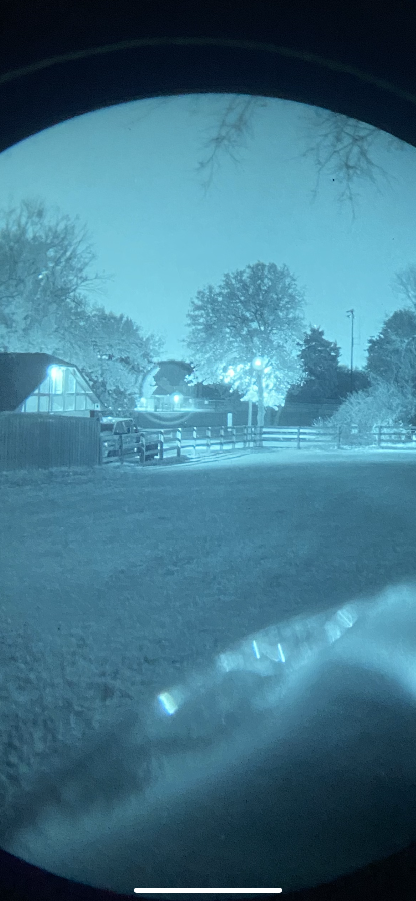

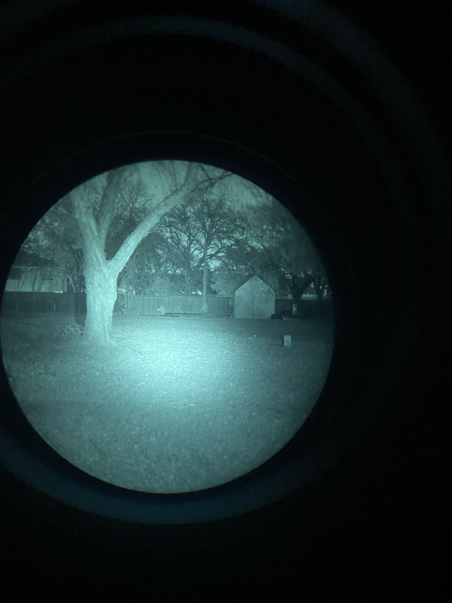

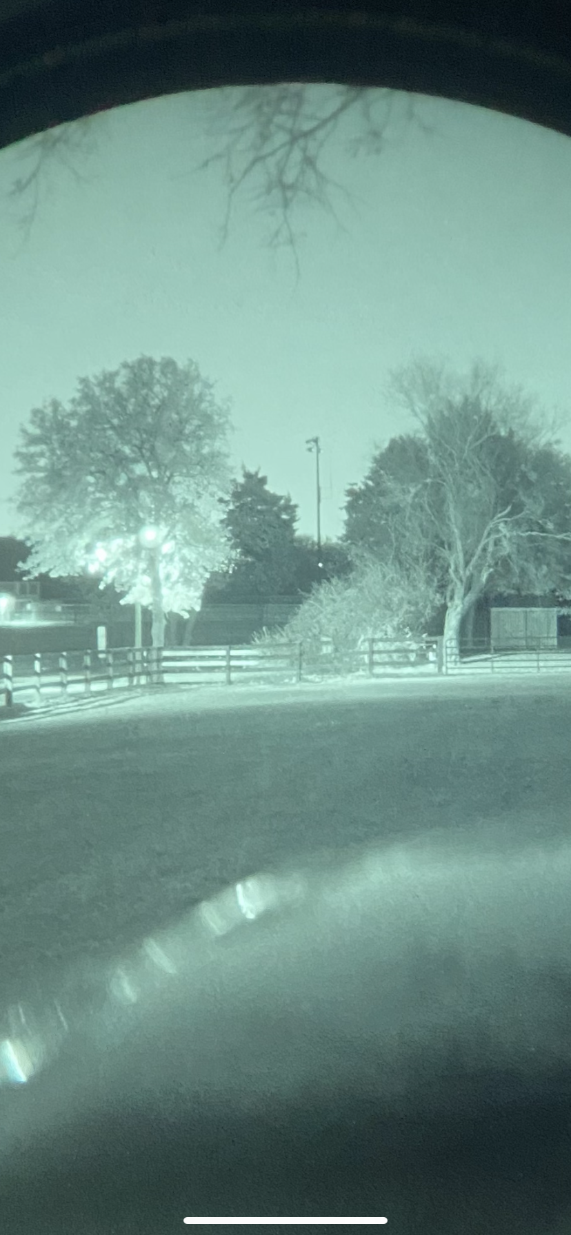

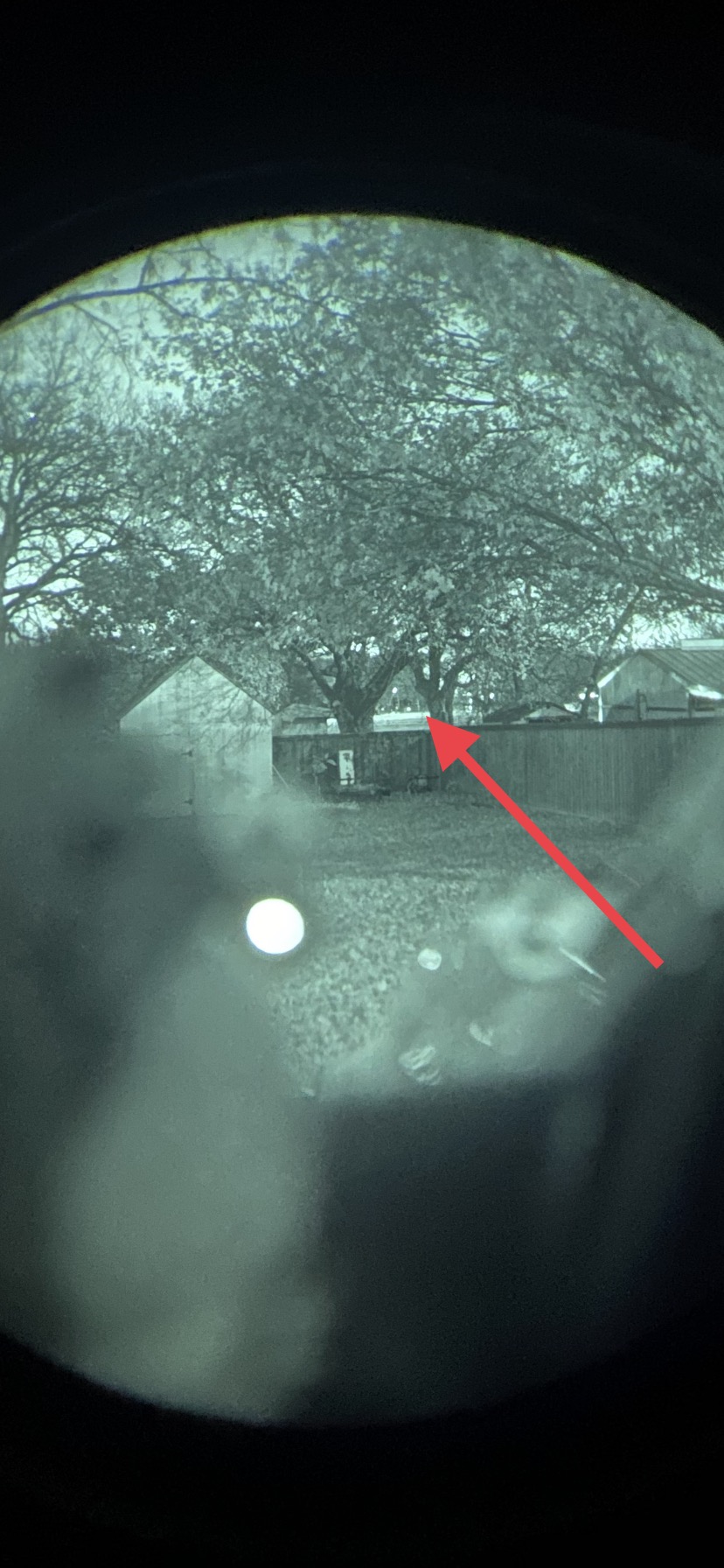

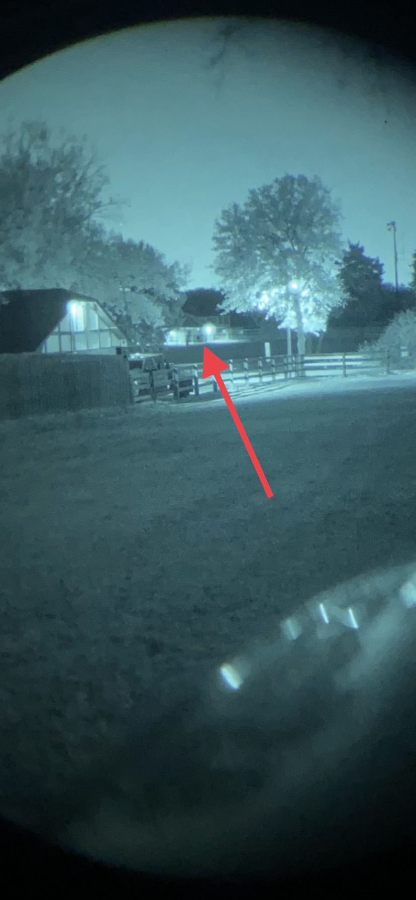

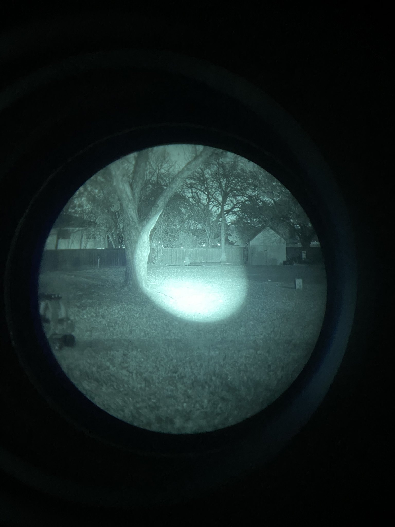

Summary: Breach was fairly washed out as far as seeing the terrain, due to we had rain on and off all day and it was light rain during the outing. But had no problem detecting the critters inside 800yds. Could not detect critters farther out.
14 actually could see very well. I tested the illum and laser before I headed out, but did not use during the outing.
This phone camera is the worst I've ever had, its in a class by itself. But it looks like I get a slightly better image by zooming in with the camera.
As always, the real image was much better. The day scope was on 8x for these images. Though I was using scanning on 2.5x, I switched to 8x for these pics.

Per request from @wigwamitus wanting to see the dbal d2 in action.
2021-12-03
2000-2100
67f
4mph north wind
Goal: equipment testing
Environment
Clear sky, star light, 1/4-1/2 moon visible high, plenty of in town ambient lighting, lots of street lights
Equipment
AR with the new Midwest industries night fighter handguard, KAC pic mlok Mount, dbal d2, Fortune cookie laid up on the truck. Pics through iPhone 11 and a milspec L3 UWP pvs14 FOM 2400ish. The d2 does have a high/low setting for the LED IR Illuminator, all pics here are with it set to high.
First pic IR laser in tree line, 350 yards
Next is the IR laser next to a light it’s just to the left of that light, this light is not dim
Next up is the LED IR Illuminator tightened down to a spot. Trees are roughly 100 yards away, far tree line is 350
Baseball field buildings lit up by lights 250 yards, IR laser just to the left of the light again
Next up for some closer in pics, fence is 50 yards away. Pics in order are with the Illuminator in spot, then full flood, then full flood with a flood diffuser lens in front, then no Illuminator. Pics may make it look the IR washes out the laser but in person you can see the laser well even with it tightened down to spot at 50 yards.
Last image is just the IR laser, on a tree line 450 yards away,
