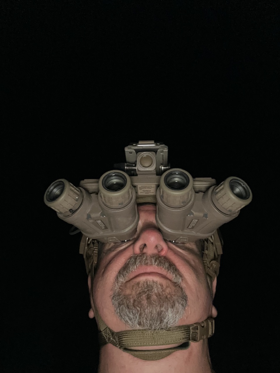

For head use, I hardily recommend gen3, well these days, the only cases where gen2 makes sense to me is in ganglands with restrictions. With gen2 you are gonna have to run an illuminator unless you've got a decent moon. And that's the same with all the digital stuff I've tried. The bushy equinox stuff (I have 2) is pretty dang good for what it is - in day mode - I can literally read a book from across the room o_O and at night at 600yds on like 11x digital with a good moon over head I can see really well. But note those caveats !

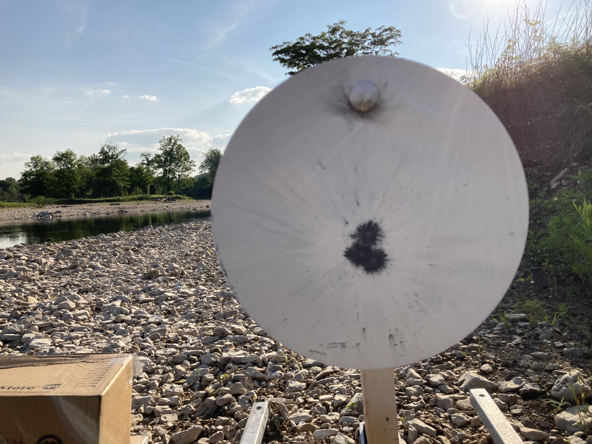

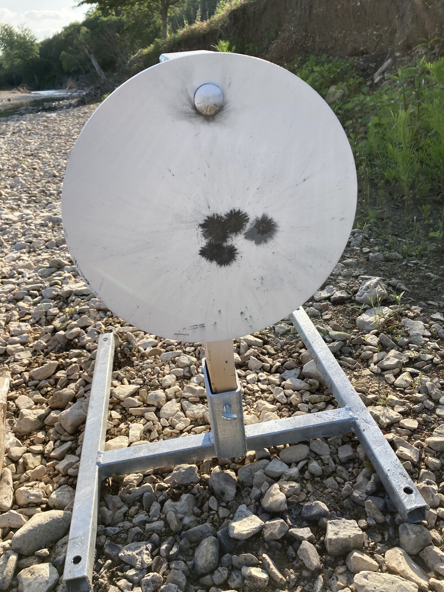

Next Evo shot several rds in the day without the "S" they all hit the white board, but were about 6 inches low, so we dialed up 4 clicks (0.4 mils) assuming his zero wasn't perfect. We actually fired 2 groups in the day and went on foot to and fro the targets in between. A 400yd walk to/fro targets soundds like a lark, but in this case, it was probably closer to 500yds on the ground with all the steep down and up required to navigate thru this area. EVO had to have a little elevation (couldn't see the target from prone) so we had him kneel on ground and lean gun across the 4-wheeler seat wih the 4-wheeler sideway vis-a-vis the target.
I'd shot like that a lot in KS and knew it was a decent position. If you zoom in, you can just make out the white board target to the left of center thru holes in the vegetation.
The variation in the windage dimension for the day shots was tiny, less than 4 inches, so I thought his windage was good. We didn't measure or detect any wind. I think we went back to get some paint, and then returned, used the 4 wheeler for that. On the return the 4-wheeler was over heating (haha) so we left it at the target area and walked out to the firing point.

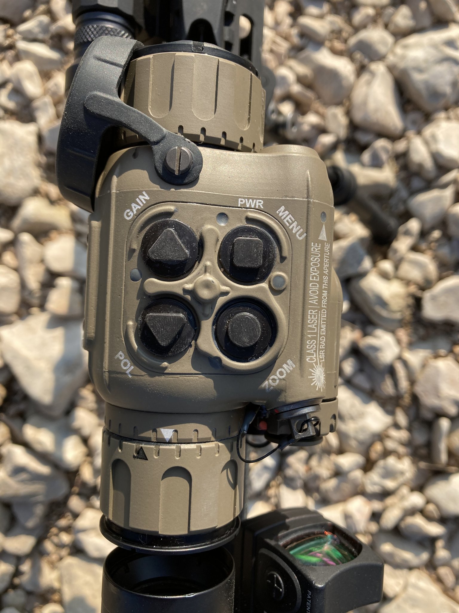

Before firing at night, we had to set the collimation back to the factory marked posn. Unfortunately there is no way to do this by "feel". So I decided I had to use the little illum on the 14 to do it and that worked. We will consider using 2 tiny strips of tape added to the "triangles" on the housing and diopter inorder to give us a passive way to set the collimation by feel.
"S" with diopter set for human viewing.
DIopter set for factory collimation. The black triangle on the diopter is matched to the white triangle on the housing.
Results: The collimation looks very solid, I was impressed. When selecting a clipon, this is my personal #1 most important aspect. Every utc/x/xii I've owned or tested was "dead on" on collimation, so I guess I'm spoiled. This means, I can move the clipon around between any rifles and be dead on with no adjustments needed (or even possible.
Group center was a little low. And there was some horizontal spread, but a little wind had picked up and was blowing East to West thru the 2 gullies between the FP and the targets. So net/net the group size was ~4" or 1xIPHY.

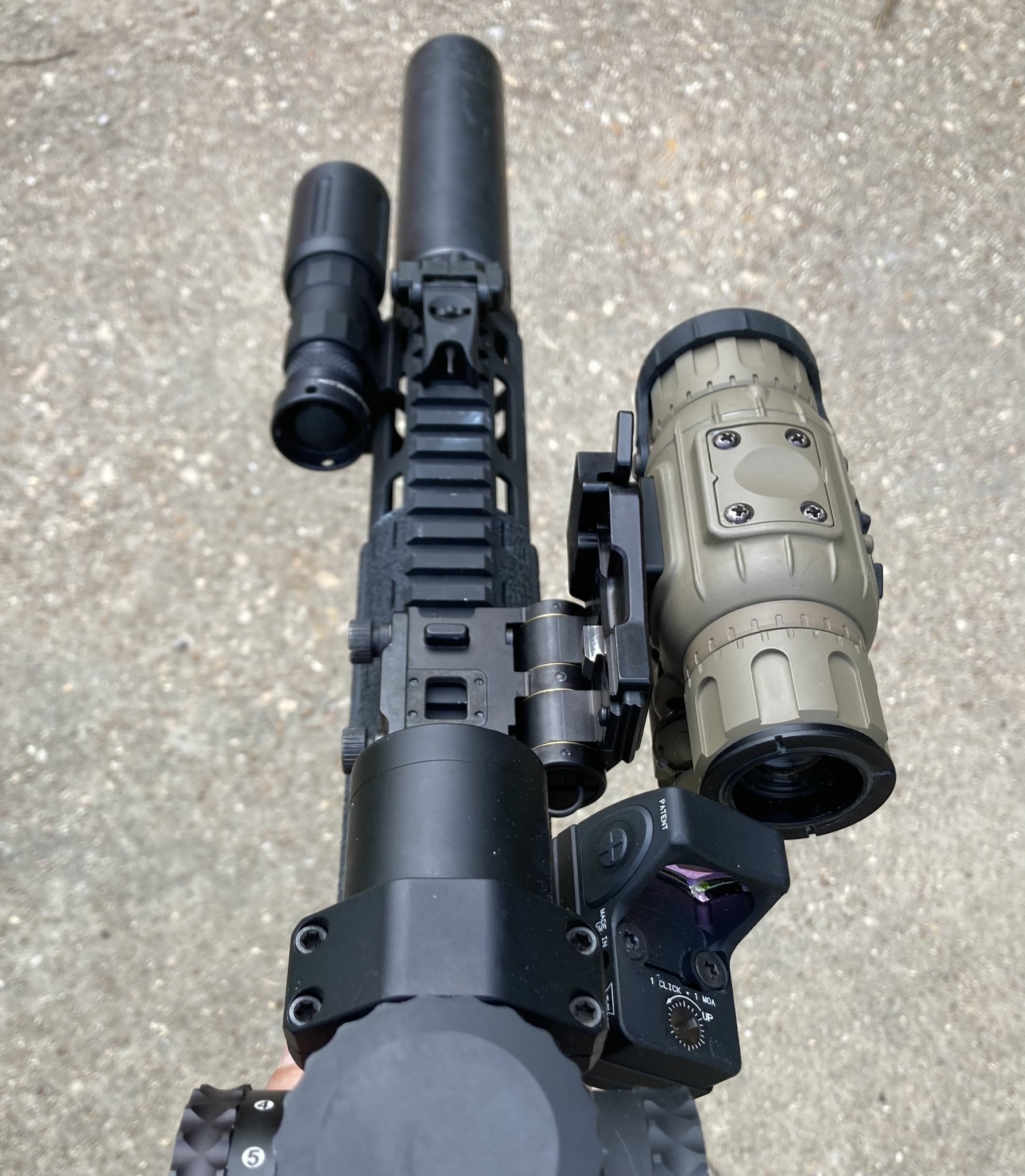

I agree with Wig that real collimation is the most important criteria for a clip on. I don’t give a hoot about a pretty image if I can’t trust it to make hits. I’ve done 3 other tests so far and collimation has been spot on each time!
Hand held, for scanning, the S is excellent. There is some demagnification so the image doesn’t immediately fill your brain like a Skeetir, but after a couple seconds you forget about that and enjoy the image.
Helmet mounting wasn’t high on my priorities list, but Voodoo-S performed this role well, partly because it’s small and partly because its image is fantastic. The Skeetir-X will be better due to increased field of view without demagnification, but I was able to navigate reasonably well and even sprint on uneven ground with the Voodoo-S on a helmet.
But back to clip on stuff…
I love the size. Concealed carry guys learned long ago that the best handgun is the one you’ll actually carry. A snub nose air weight revolver beats a full size gun if its size and weight allow you to actually keep it with you. The S is so small it can stow in almost any pocket or pouch, so there’s no reason for it not to tag along any time the AR is going somewhere.
It’s light enough that I hardly notice it when mounted, so my support arm doesn’t hate me for loving clip ons.
I really like its ability to flip 90 degrees out of the way. This has “tactical” benefits to those of us with delusions of grandeur. As the situation changes, you can easily go from day scope to thermal and back simply by shoving the S in the direction it needs to go (the latch on the flip mount can be fixed in the unlocked position with the included screw if you don’t want to press it with your thumb each time). Not only can you get it out of the way quickly, but you don’t have to find somewhere to safely stow it. It can just hang out until you are ready to put it somewhere. For a hog or coyote hunter this can be really helpful. Shoot the critter with the thermal, then as you walk up to it, flip the thermal out of the way for access to day scope/white light use in case it’s not as dead as you thought.

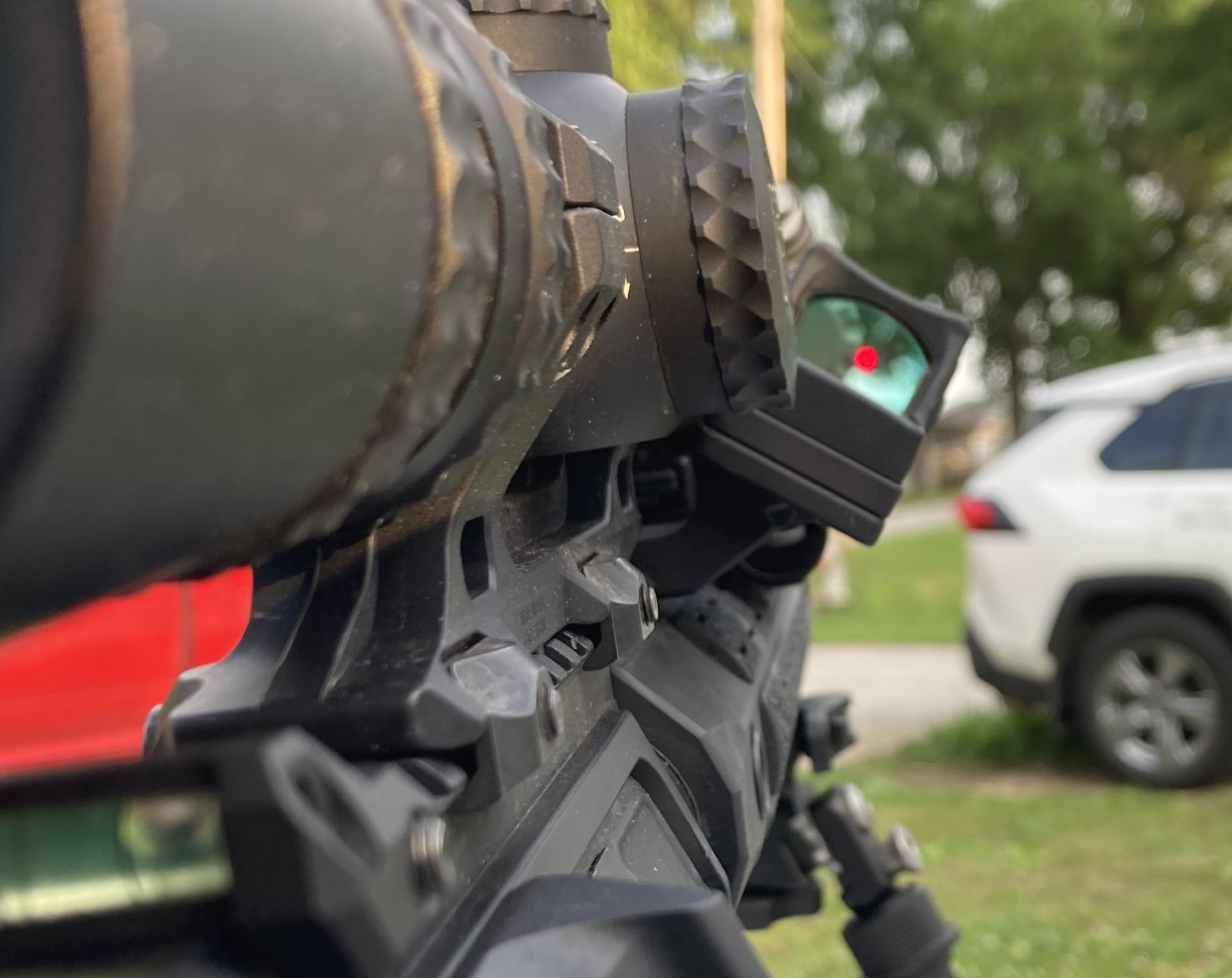

The size also allows for use of an offset red dot like an RMR with white light if something pops up close and fast. You will see the S in part of your sight’s FOV but it’s still very useable.

Possible fix for alignment of the collimation marks in the dark: Two 3D printed rings, each with a step, could be attached. One to the focus ring and one to the housing. Just clamp them on when the collimation is right. The step will allow turning one way (to focus for the eye) but will stop when turned back to the collimation setting.
I do appreciate that the adjustment is pretty stiff. Once set, I’m not concerned that it will easily move.

This evening I tested the Voodoo-S a little more. All testing was at 100 yards.
My first shots with the S were good but a little low. I pushed it out of the way and shot with the day scope (1-8 ATACR). My shots were equally low 🤦‍♂️. My 100 yard zero is low, which means my previous 400 yard adjustments were affected (as seen on the target).
I didn’t want to add variables that weren’t related to my testing so I left the zero low.
Next I intentionally set the collimation marks wrong to simulate adjusting fast in an emergency or having the setting changed through rough handling. There’s a narrow range where the image looks focused, so I could only go so far and still see well enough to shoot. This is what I got.
I fired with my head improperly centered behind my scope which should theoretically maximize error (and may affect my ability to shoot well regardless of the thermal). It made a difference, but I’m pleased with how reasonable the “worst case” result was.
Additionally, between each shot this evening, I flipped the S out of the way and then back. That shouldn’t matter but I figured I’d cause as much trouble as reasonably possible.
Keep in mind that these results (and the previous 400 yard results) are from an 11.5” AR, so your results may be slightly better.

I did some collimation testing with the ELR (Theon thermal clipon) .... and did not detect any POI shift on either the bolt gun on the AP stoner.
Bolt gun 3 rd group at 150yds ... .75" group or .75/1.5 = 0.5 iphy
Left side is the bolt gun group with the ELR and right side is the 762 AP stoner group with the ELR, aiming point was center of handwarmer from 150yds.
This is with some new (to me) Hornady Black AMAX 155 I am testing. This is the MSV3 read out on with the above mentioned bolt gun. mv 2869 with no pressure signs ! This beats 175gr on danger space, lag time and energy out past transonic, yes even energy ! I just can't find a powder that will generate these results. The best I can do with no pressure signs is 2804 MV with RAM tac and Sierra 155 ( #2156 ). Also tried cfe223 but it has a lot of seasonal variation (temp). Haven't tried good ole varget yet. Or 8208 though I have some of both.

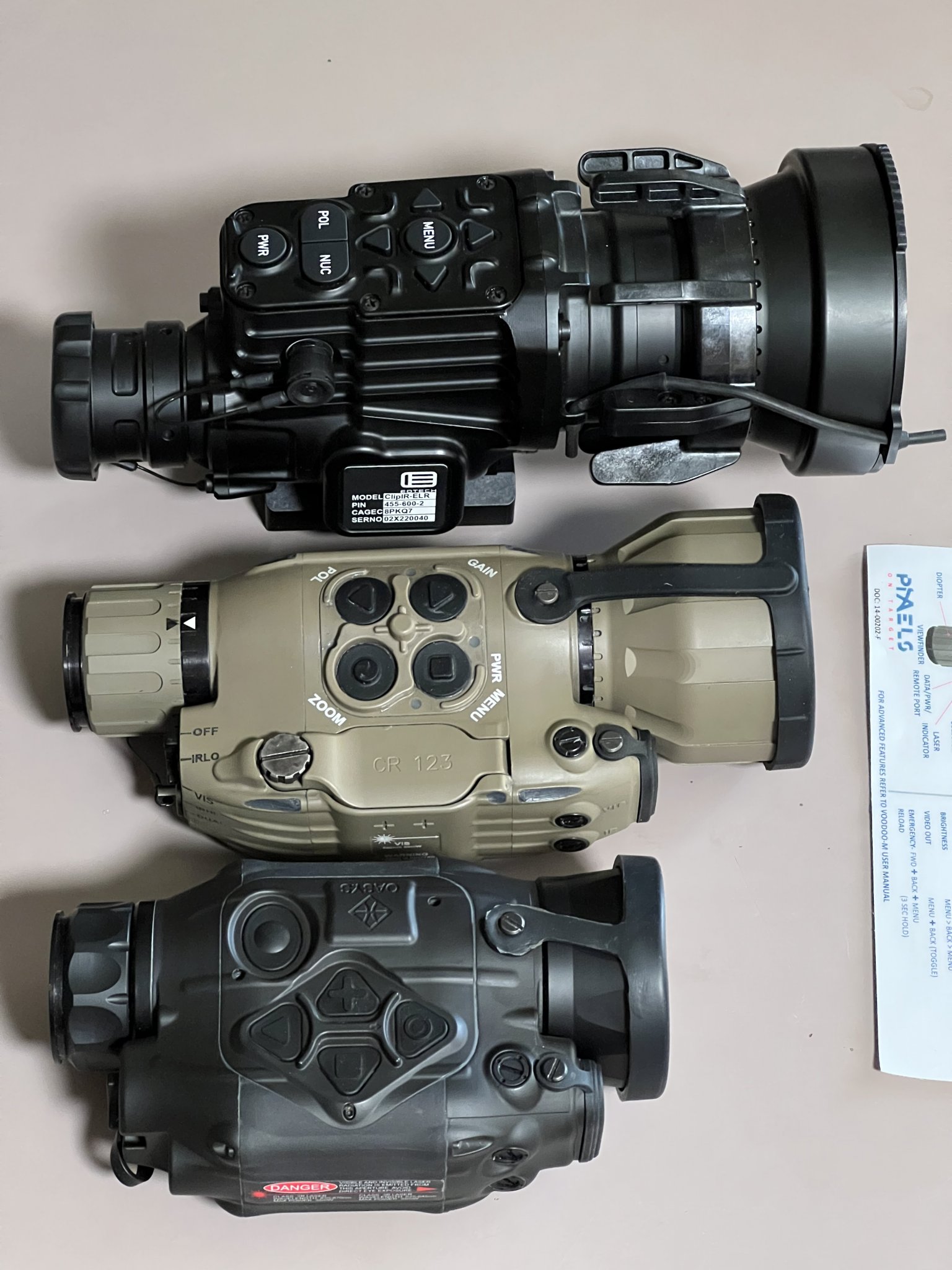

Here's my new voodoo-ML ... traded some "FRN" to evo9 for it ... the M is sort of a gen2 UTC/UTM hybrid ... oasys core etc. Good for 15x ish on the day scope, but has a diopter AND and software adjustable collimation, though we haven't had a need to use it yet. So far, on the guns we're run it on, its been DOBA.
More to come ...
Note the ML is heavier than the M. And the above weight is with the skeet mount and 2xc123.
Hopefully you can get the the max range of that 22lr now
Yeah its definitely overkill on the 22. The buttons are the same as the utc and skeet BUT the functions are different, like now we double tap the menu button to NUC. So I put it on the 22 since I take the 22 out several times per night on barnyard defense and it let's me practice with the buttons.
The Armasight apollo42, shown at the top of the first pic above, is normally on the 22 and for barnyard defense its better as it has more FOV, so soon, the ML will be redeployed and the apollo42 will go back on the 22.

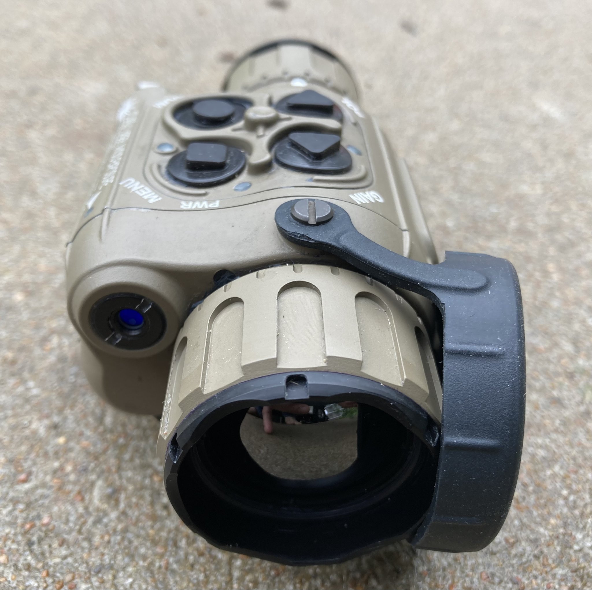

Depending on where you measure to, from 42-46 mm. The smaller is the part of the lens inside the black lens ring and the 46mm is the whole lens.
The utc xii did not exploit the 12um pitch to make the unit much smaller than the utc x. The M does.
Also remember focal length != lens diameter.

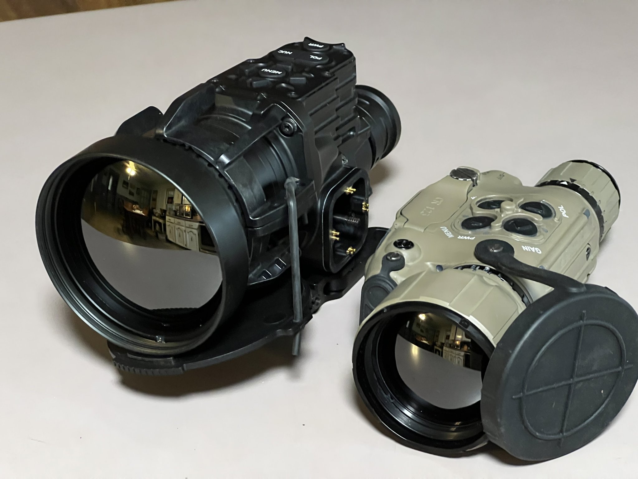

Interestingly, though much larger, the Theon ELR actually fits on this mk18ish ...
Whereas the Voodoo-ML does not.
Part of that has to do with the folded design of the ELR, vs the inline design of the ML.

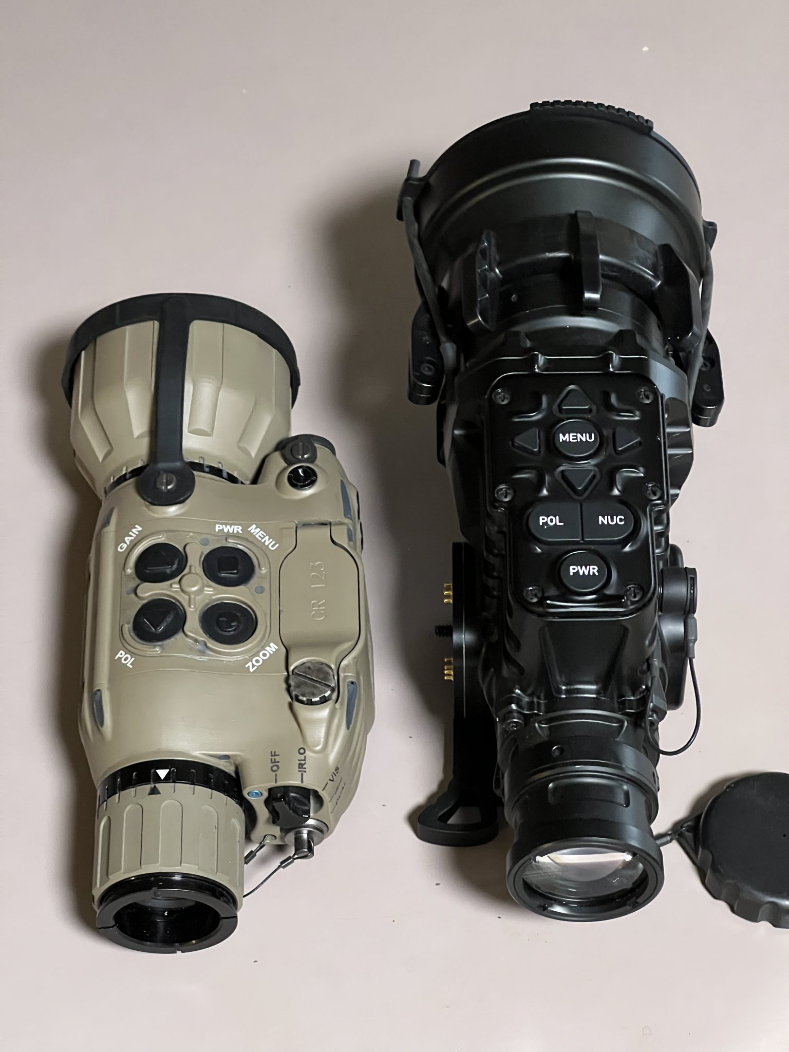

Again, Dennis and you are talking/thinking focal length. I was asked to measure the lens diameter.
Focal length is the distance between the lens and the sensor. Lens diameter is the distance from one edge of the lens to the opposite edge of the lens. Two different numbers !!!
As I said before focal length != lens diameter !!
Why don’t more use the folded design?
Folded design, in optics, is actually older than inline ... folded uses the "Z" type pattern (done with optical prisms in binoculars). But many companies that have made thermal clipons, made them by modifying their existed thermal weapons sight (scope) designs.
Like the gen1 Apollo thermal clipons from Armasight, are a Zeus with a demagnifying collimating lens on the back, vs the diopter lens on the back of the Zeus.
Many of the chinese clipons are also modified scopes.
The trijicon snipe is a 35mm patrol (aka a reap) with a collimating lens on the back.
That said, many/most military thermal clipons are folded, to make them shorter. A clipon has 2 relevant focal lengths the front end magnified side and the backend demagnified side and they have to match if we are going to be able to use our reticles to hold. We need the net magnification through the optical train to be 1x.
So to have longer focal lengths on both ends, we could make them shorter by using a folded design. Look at LWTS, SPARTN (INOD), UTC, Theon, etc all folded. Small clipons like the VoodooS don't have as much focal length so don't need to be folded. The M is seemingly a hybrid of the UTC and UTM, the UTC was folded, the UTM was not. The M is not, but the M manages to get the same or better performance than the UTC. Exactly how they do that IDK - but they have done it !!
Another reason to use folded design for thermal clipon is getting the larger lens up off the rail.
In front, we have Armasight 100mm (focal length) Apollo Pro, to the rear, UTC-x. Apollo is inline, UTC is folded. Look how LOOOONG the Apollo is compared to the UTC !! Also, the Apollo is 1.9ish center, meaning I had to add a 0.5 riser under the day scope to get it lined up (in the pic the riser is not yet in place).
Because the UTC is folded, the front lens is already on a "riser", though the offset is compensated for by the collimation so the day scope doesn't have to be raised up !!
I suspect the Apollo 100 was done as an inline unit, because it was way cheaper to use the zeus housing and just change out the rear lens assembly, versus making a whole new folded housing.
