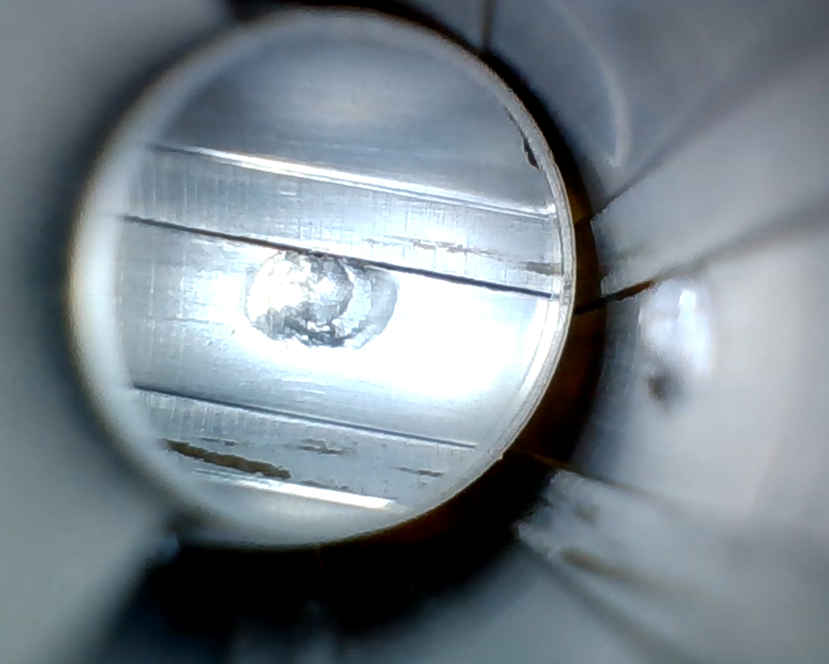

Hey guys,
I just picked up a new 14.5" pinned and welded AR upper. It showed up yesterday and I planned to throw an optic on it last night and test it out at the range today.
Out of curiosity I looked at it with my borescope before doing anything with it. I'm glad I did. I'm not sure what went wrong here but there is a protrusion at the location of the pin & weld. It's difficult to get a sense of scale or depth from the screenshot, but in the video you can see that it protrudes quite a bit, maybe 2x the height of the lands? I'm not sure what kind of issues this would cause but it can't be good for stability or accuracy.
I'm planning to contact the manufacturer and I expect them to make things right. I understand that QC issues are inevitable, so I'm not going to drag their name though the mud.
Just sharing this because I thought it was interesting and a good reinforcement for the habit of always inspecting things before you test them.
I gotta say, I don’t think I’ve ever seen a pin/weld go all the way through to the bore…ever. Most gunsmiths I know just barely ‘kiss’ the threads and stop before dropping the pin into the hole and doing a spot weld on top to hold it in place, a couple might go to the base of the threads, but no deeper.
Just wow!

I’m sort of thinking that this isn’t “just a QC issue” and is more like “no QC issue”. Shipping product without looking at the results (apparently at all) and not seeing an obvious issue like this sort of undermines” the “protect the manf” school of thought.
Take the angled mirror off and borescope it again, you will see the barrel from different perspective.
*edit, the video now shows it very well..
You should tell us the manufacturer. It would help any other customers with same barrel/upper. Before you know there might be a dude out there scratching his head why his groups are bad etc.
Fair point. This is a PSA Sabre upper. Allegedly this barrel is made by FN and cold hammer forged. Looks pretty rough to me even without the pin & weld fail.
I shoot barrels that are MILES worse than that. Potholes, not pitting. :D
New however, you should certainly be upset.

I’m not usually squeamish about a rough looking barrel. Apart from the pin sticking through the bore it looks fine, just not premium. I’ve never seen the inside of another FN CHF barrel, but I have seen inside of a Daniel Defense CHF barrel and it looked much nicer than this.
I contacted PSA support Tuesday through their online form. I got a confirmation saying they got my message and it’s in the queue for customer support. So far that’s all I’ve heard back.
No big deal...the pin is not protruding into the bore. And the bullet will slide on by, just like it does with the gas port..as long as the pin is really welded in and dont blow out under pressure.
With pressure dropping way put there, it shouldn't be a problem...But it's not correct. Ya don't drill into the bore, and many pin on the outer edge. Since it was done "professionally" it probably should be redone, as it was paid to be done correctly. But it's totally shootable,... if ya like the accuracy, keep on shootin it...if ya don't send it back...

It took a couple hours worth of sitting on hold and talking to a few different reps at PSA, but PSA has refunded me.
Long story short, they wanted to settle this issue with an exchange, but I wanted a refund. It took a while to reach a common understanding.
No hard feelings but I'll probably take a break from buying PSA products.

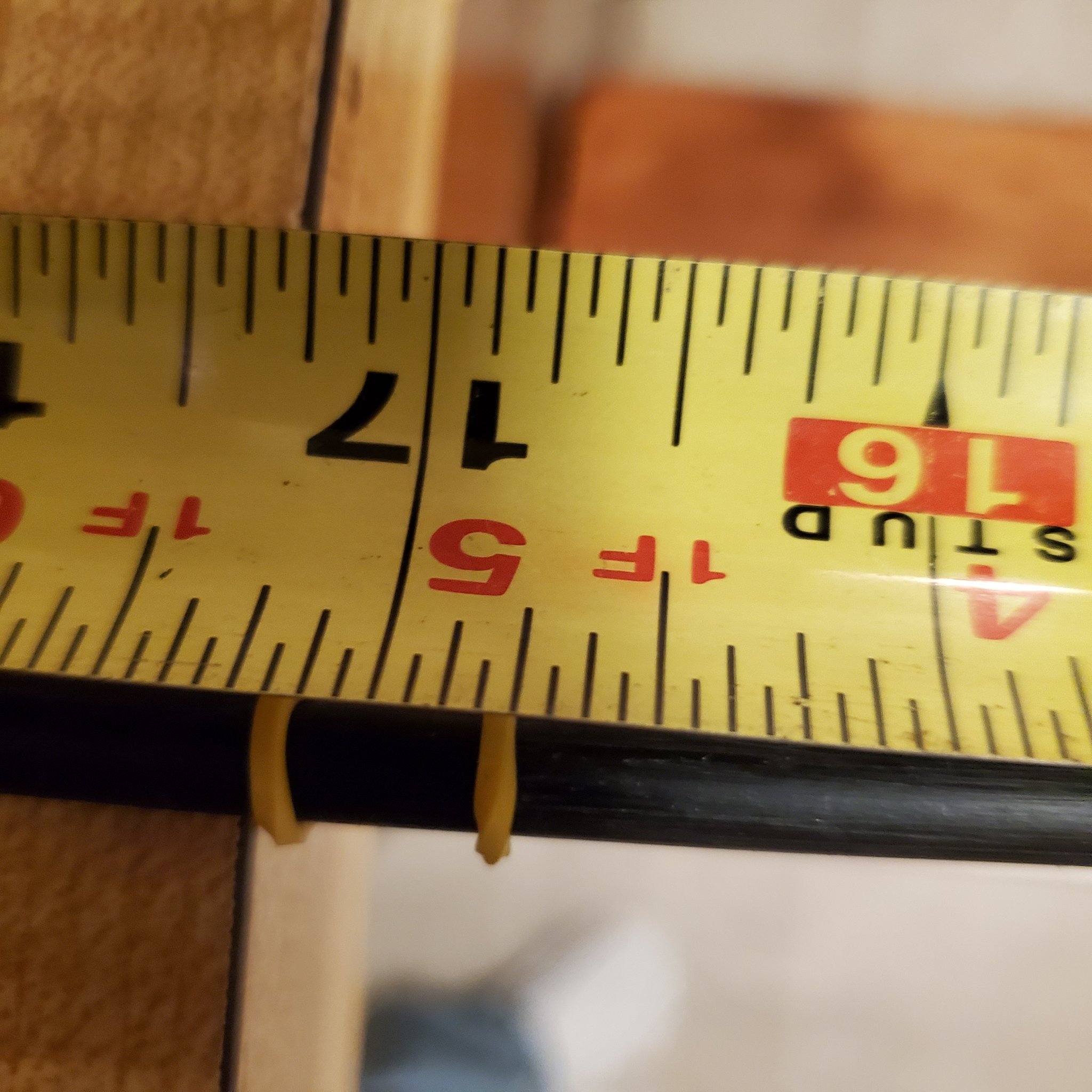

I have one 14.5" with a pin & weld...but have no plans to ever do another...it's only 1.5" difference,.. big whoop!,... and with a 16" no hassles, and its all legal, all the time.

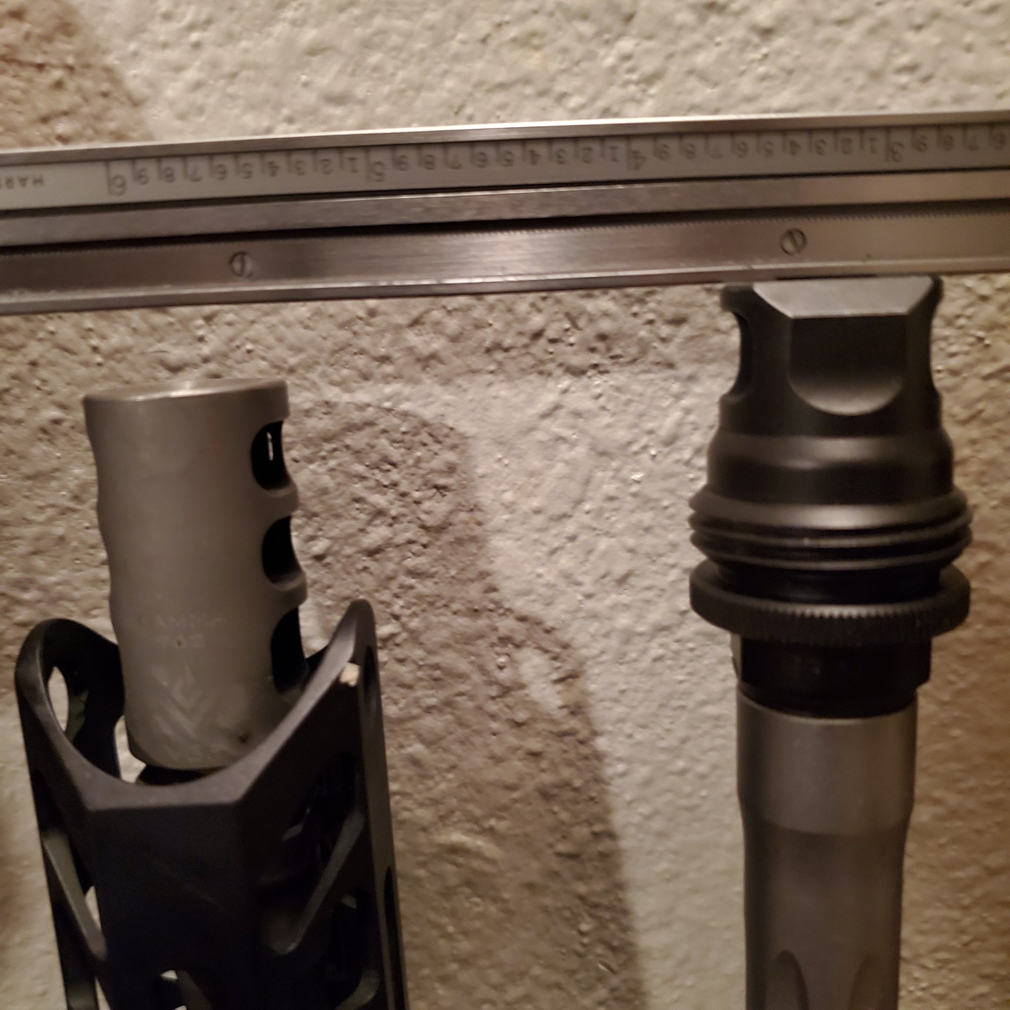

This picture has a 14.5" pinned 3 port vs a 16" single port ... close to the same overall length .
34 5/8" for pinned 3 port and 35.0" for 16" single port brake. If 3/8" is important to you than by all means go ahead...or a single port is not your cup of tea...just one example of what works for me, on light recoiling rifles...it just goes back to no hassles, with a 16" barrel, plus a small gain in velocity. A winning combo for me.
Not showing that the receivers are perfectly lined isn’t the most convincing photo…..lol
I lined them up took the photo...then "measured" the overall length with a tape measure...AS STATED. Can you read?....So even a moron can understand that 34 5/8" and 35" for total overall length of each ....so that you do not have to be concerned about the recievers being "perfectly aligned"...the tape measure tells you what length they actually are...lol. The picture is a visual reference. Cause clowns on here like to make a fool of themselves... as per your response...So in anticipation of that, I measured them to be sure of their length. Read it...
Only 3/8" difference. These rifles have the exact same manufacturer, Areo Precision for the uppers, and same favorite manufacturer for the stocks... that's exactly what they measure.
It was supposed to be helpful for those interested in using a 16" barrel, instead of a pinned 14.5" barrel, while still retaining close to the same length...I accomplished that.
Use the same or similar setup on a 16" barrel is up to the individual.
