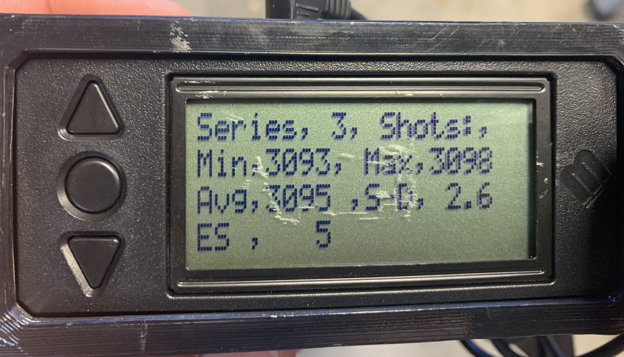

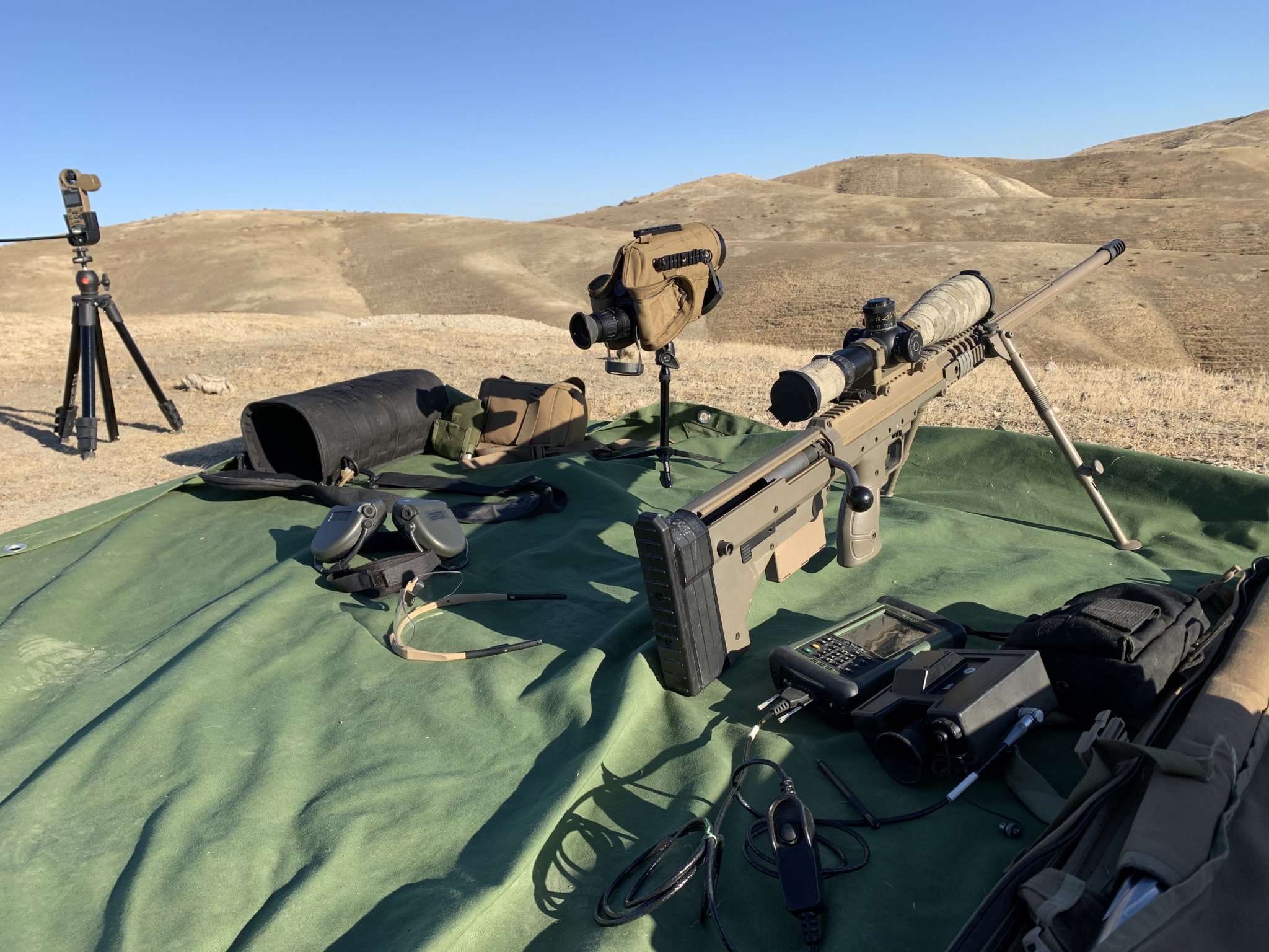

For the 212 in a .300 Norma Mag, I seem to have a solid load at 88.5gr N565 with a long 3.842” COAL, giving me 3165fps out of a 28” 1:8 barrel. I just came from the range to confirm the load at 100 & 300 yards and it’s a consistent 0.5MOA. Next weekend I’ll be testing them at much further distances.
My barrel has a long throat as it was cut for long 230-250gr class jacketed bullets, but it turns out the Seneca bullet profile is such that a long throat isn’t needed even though the bullets are close to 2” long. At 3.842” COAL I’m still seating the bullets out a bit, close to mag length in SRS, and jumping close to 0.1”, but groups are nice.
Something thats becoming a bit more clear to me is that this load is really approaching pressure signs. No ejector marks or cratered primers, but this time around it seems I’m getting the slightest tiny bit of flattening. Enough so that if they don’t perform well at distance, then I may start over using N570 now that I have a pair of big jugs of it. N565 definitely gets them approaching 3200fps, but I’m confident N570 could get them to 3100fps well clear of any pressure. And then when N568 is released, that might be best optimized powder.
Overall this bullet isn’t really all that picky it seems. My last trip to the range was shooting seating depth increments and all were pretty consistent at 0.5MOA +/- 0.1, which isn’t something I’ve seen outside of my 6.5x47L loads. Usually the periodic expansion and contraction of groups tends to be more amplified, from my experience.
If these perform well I plan to order a longer 32-36” barrel with a faster 1:6.5 twist to see what it can do with the 241s. Running the numbers, that bullet at 3000fps would rival a lot of .375CT loads.

Very impressive result sir!
I see PVA recommends a 0.165” freebore for the 241 Seneca on their web site. That is surprisingly short for such a long copper bullet, but i can see the reason for that: It has a very very pointed shape! It seems that almost 1.6” of the nose is sitting inside the barrel, before the ogive touches the lands.
Curious to know why you are considering a 6.5 twist barrel. What is the ideal SG if you need for a long mono to transition into subsonic region? I noticed that PVA recommends a 7 twist. Then again CEB on their web site recommends you go a full 1.0 faster on twist rate than “needed”, if you want the projectile to work reliably into the subsonic zone. So you may have a point there!

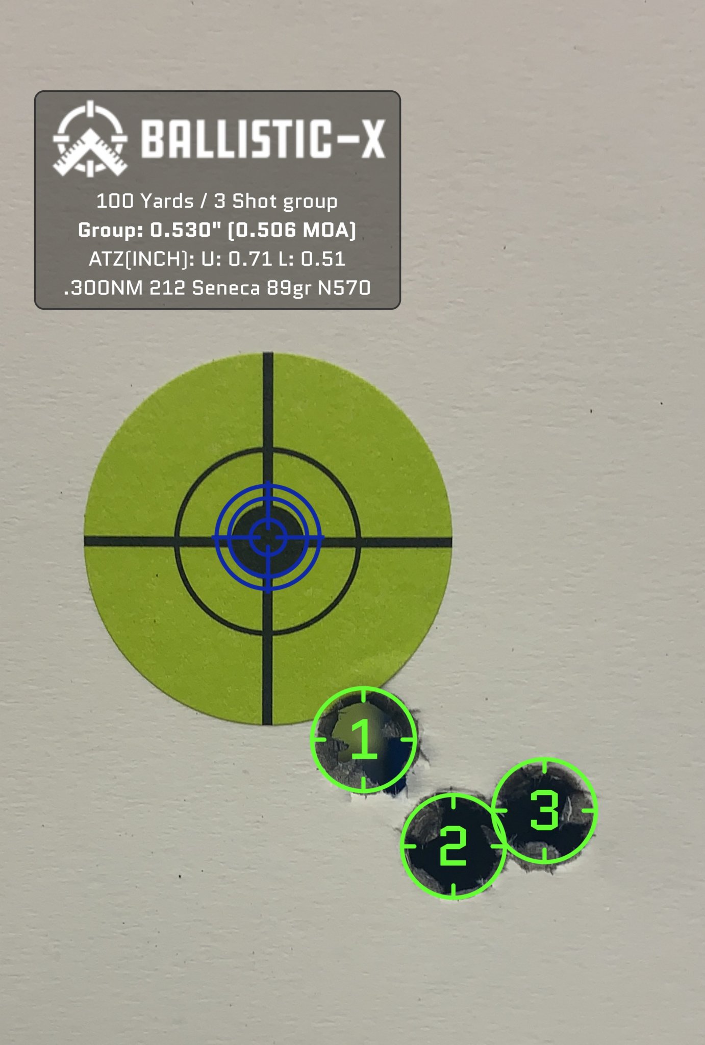

Interesting result.
Did i understand you correctly in that you made changes to both seating depth (longer COAL, same for both batches) AND you also changed neck tension/interference fit from 1.5 thou to 2.5 thou (so different for the two batches)?
No, I did a control group with the previous 3.842" COAL and previous neck tension before testing longer COAL and tighter neck tension. It's weird, but I don't think these bullets are all that sensitive to COAL changes, but they definitely prefer tighter necks in my barrel.
Curious what annealing method you use, and how often you anneal?
AMP as well, after every firing. I also neck turn for uniformity.
Reactions: NamibHunter
Thanks for the details, that is helpful.
Glad to hear the bullet is not overly jump sensitive, that will make it easier to tune the load.
Yeah it’s really unlike any bullet I’ve used before. The first time I shot a string of groups with incremental charge weights, I didn’t get the sinusoidal grow-shrink across the target. They were all really tight and my ES levels were all crazy low.
So yep, going back and revisiting N570 was a good idea. Velocities weren’t as high as N565 but I’m close and still a couple grains below pressure signs. I tested 87-90gr on this round and once again all shots grouped under 1 MOA, with 89gr being the size and ES winner. Again, these seem to like relative tight necks, so I sized them with a 0.3045” mandrel. COAL was 3.910”
Because these bullets are so pricey I’ll just load up a batch and test them at distance instead of further refining them.

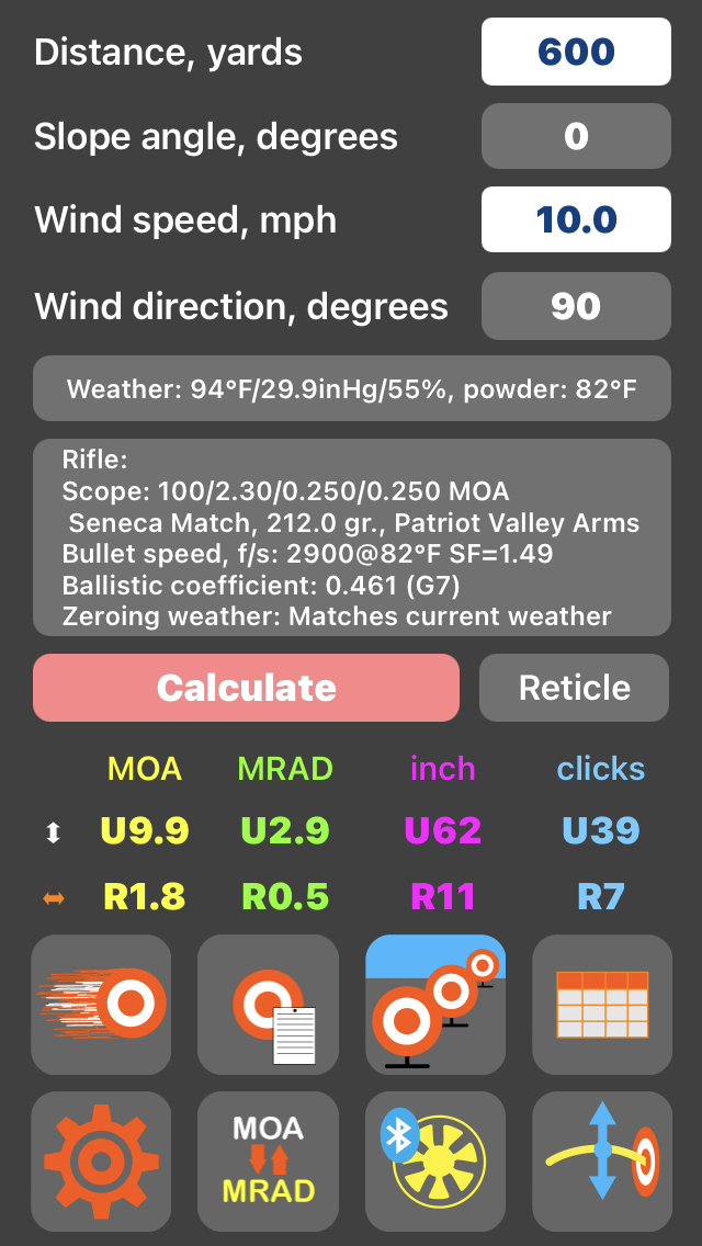

I was running numbers with 212 1-8 twist I wasn't to stable in my app. I live at 5400 feet too
Not sure how accurate Strelok Pro is for stability factor calcs, but i get SF=1.49 with an 8 twist barrel for the 212 Seneca at almost sea level. That is lowish for a mono, but it should be sufficient for the supersonic range? Are you concerned that it might not safely transition to subsonic in an ELR application?
Half the wind drift of a 6.5 Creedmoor firing 140 Hybrids. Amazing performance.
Need at least 1.50 to be stable full bc
Yep, fair point. You then need 2950 fps or a little more for the SF to exceed 1.50. Doable in a large magnum.

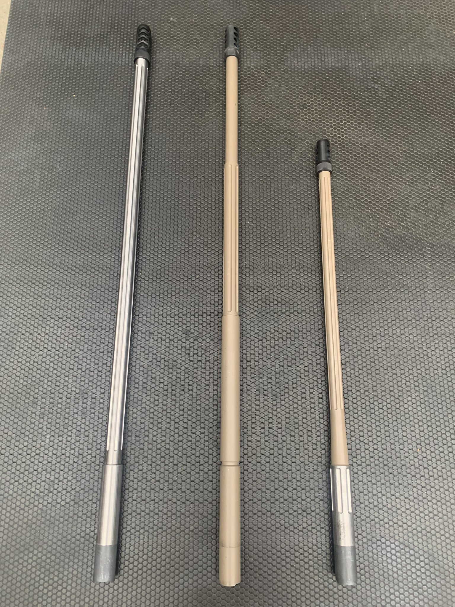

32” 1:7 Bartlein 5R
That long 32” barrel should get the speed up another 150 - 200 fps over book speed if you experiment with slower powders. Curious what action you are using?
I have been told that some actions (like mine, Curtis Axiom, and most factory rifles) are not beefy enough to host a heavy profile barrel longer than 28” without distorting the contact between the bolt lugs and action. Apparently, during firing the bottom lug may pull away from its mating surface. Is the theory correct that some rifles will get inaccurate if the barrel is too long or too heavy? How long is too long?
I believe there may be something to this: I have a 30” Shilen Select Match barrel on my Savage 12 (large shank) rifle in a V-block HS Precision fiberglass stock, and it does 0.6-0.7” groups, while the original 26” factory barrel did 0.25-0.3” groups when new. I am thinking about cutting it back to 27” and perhaps re-barreling to 6.5 PRC.
I know that some 338 and most all 375/416/50 cal actions are much bigger, heavier and stronger, and some can handle barrels up to 36”.
Any sage advice on max barrel length?
It‘s a first gen SRS.
I have a few heavy contour long barrels that I use with it. My current .300NM is a 28” with 1.045” straight contour. I also have two 36” .338LM Improved 40 barrels, one that’s also straight 1.045” and the one in this picture that’s step contoured from 1.250” down to 0.9” ish. The barrel tenon on the SRS is about 5” making it a pretty solid platform.
The only reason I ordered the 32” over getting another 28” is because experimenting in Quickload told me it was going to get the 241s up to 3000fps with ease.
For comparison from left:
- 36” 1.045” straight contour .338
- 36” step contour .338
- 26” medium Palma contour 6.5mm
