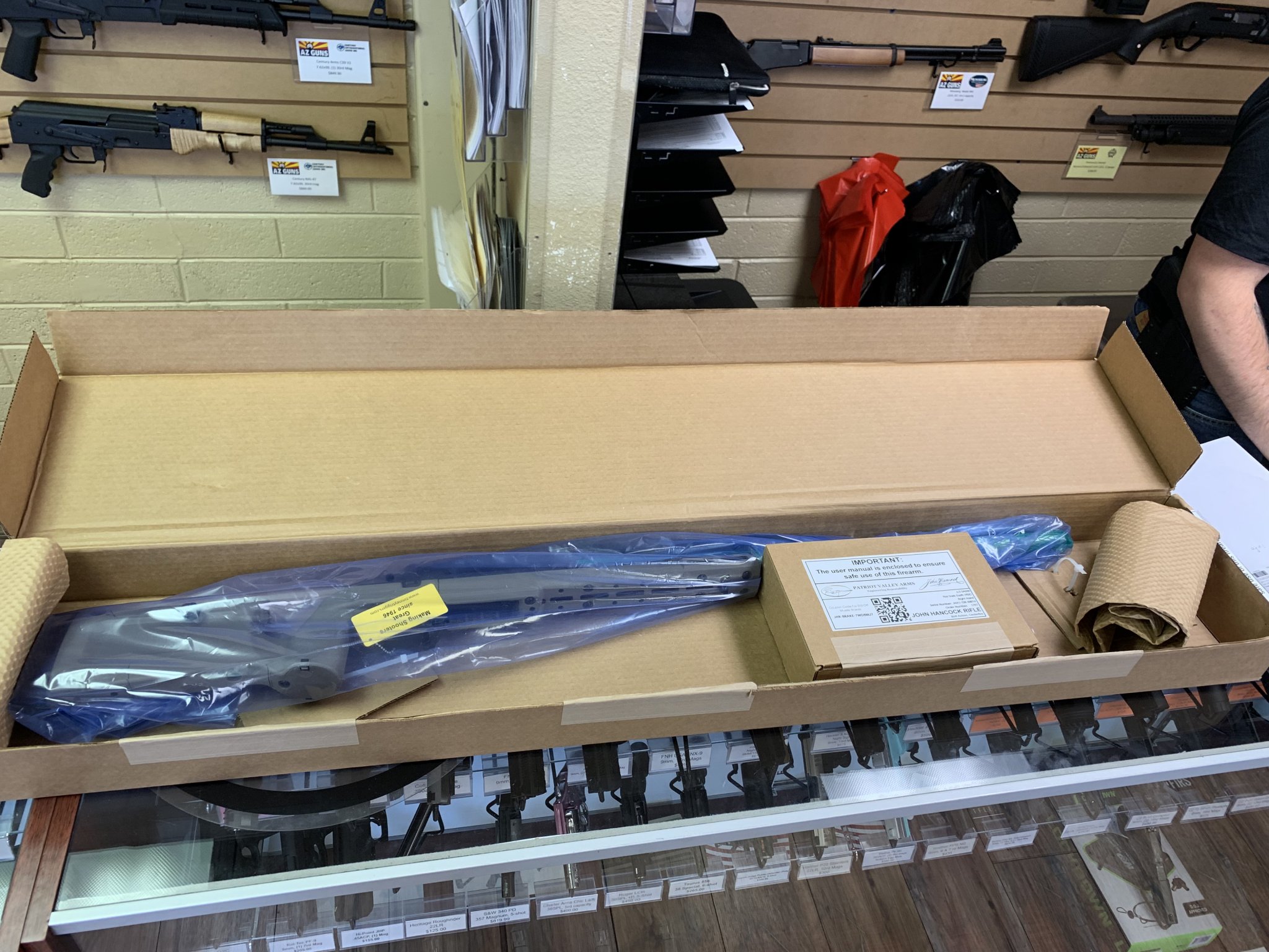

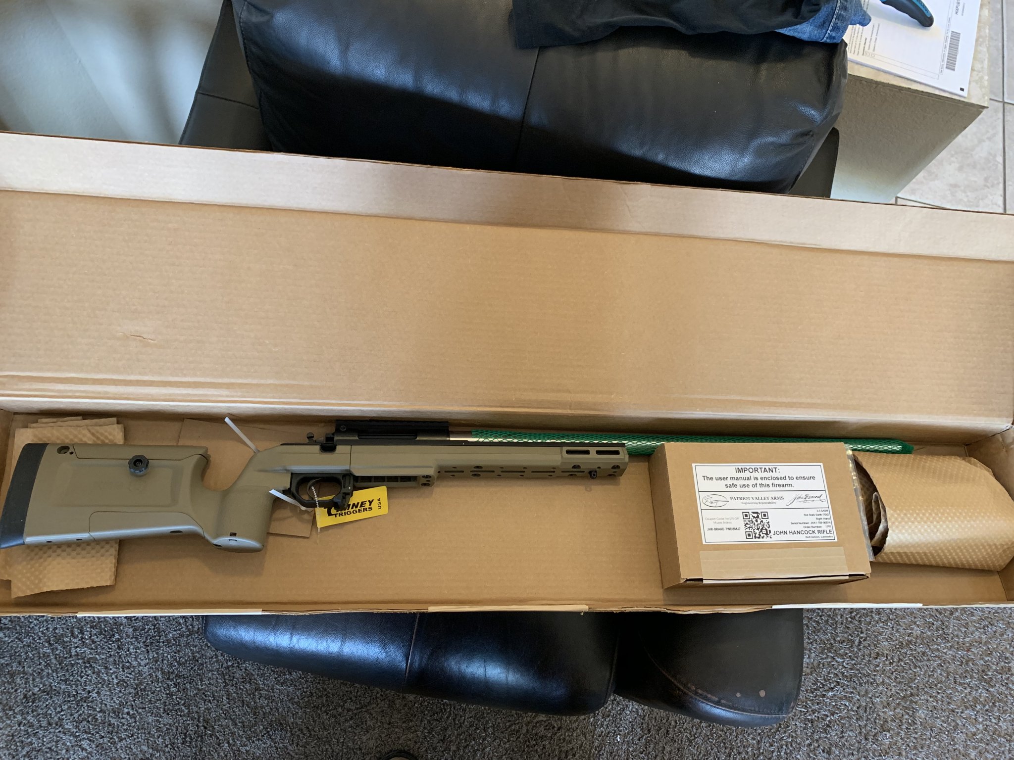

Guess what Big Brown Truck delivered today.
I was like Ralphie trying to get his bb gun open.
I've already used my discount code and bought a Jet Blast brake. Now it's just a waiting game to see what gets here first, my brake from PVA, or my glass from Vortex. I'll be out of town Tuesday, so I'll have to wait till Wednesday to play with it again.
This rifle to me looks almost like a work of art. My wife was even impressed, and my FFL threatened to take it home instead of handing it over to me. LOL
I tell ya, I think I'm going to be very pleased with this rifle for a long time.

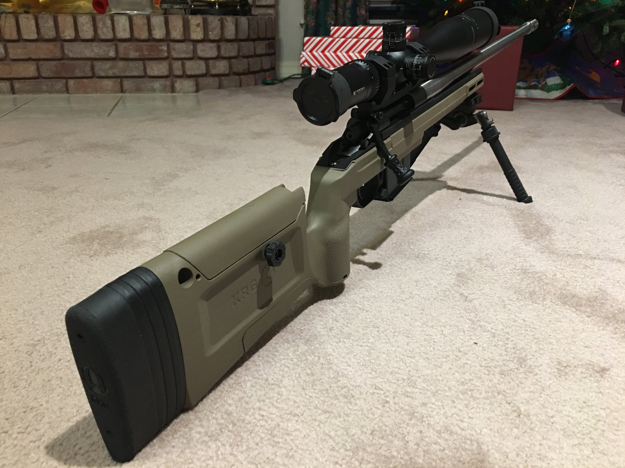

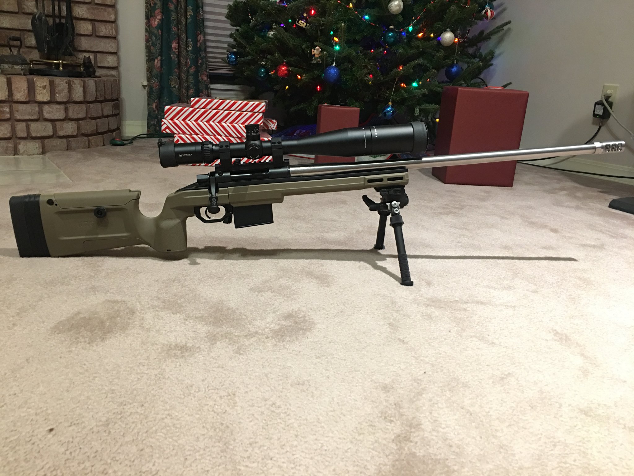

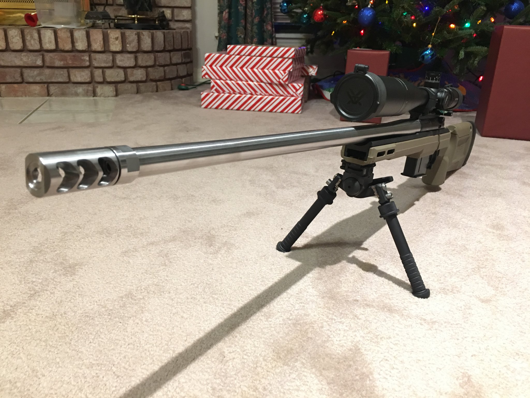

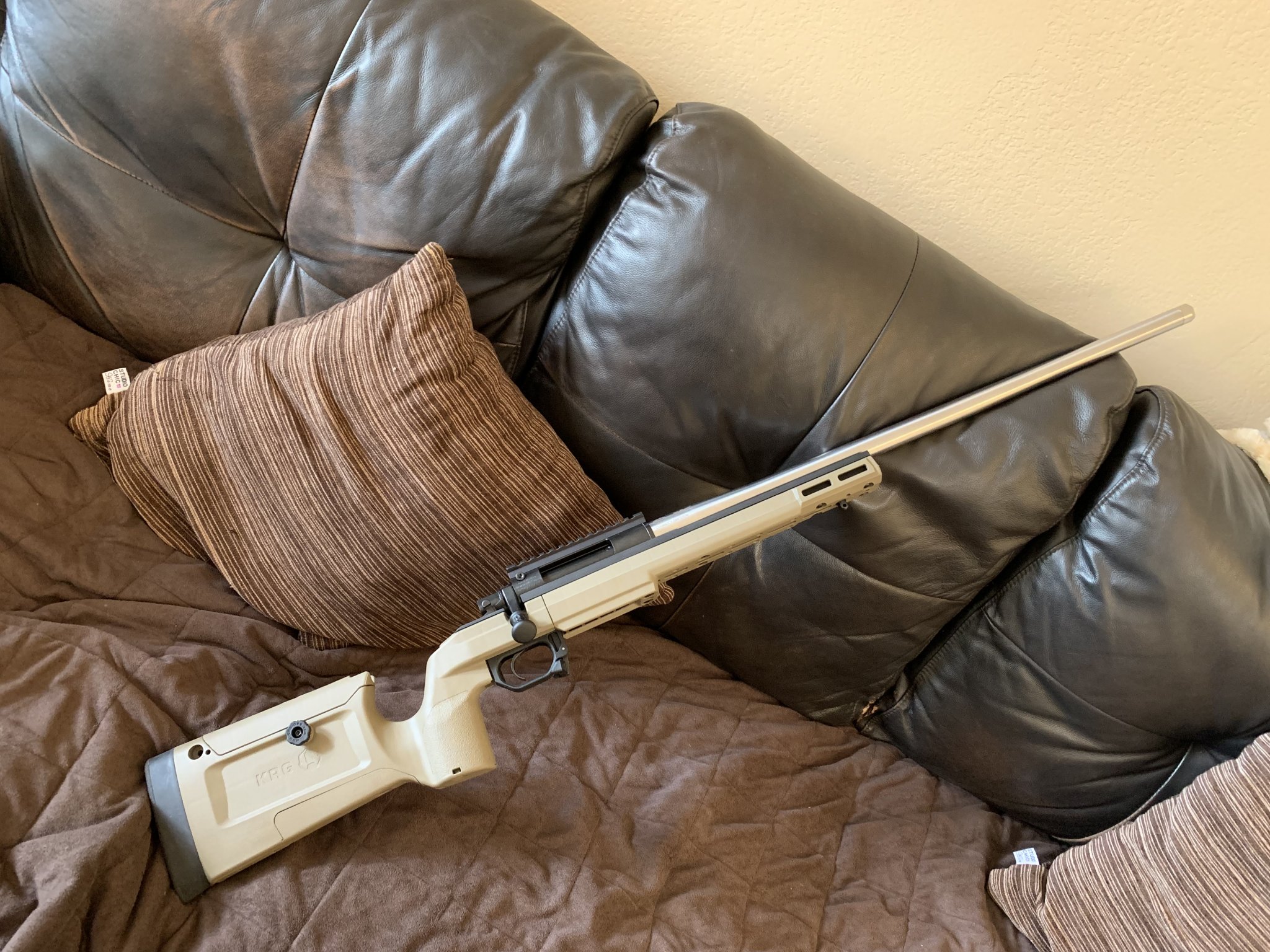

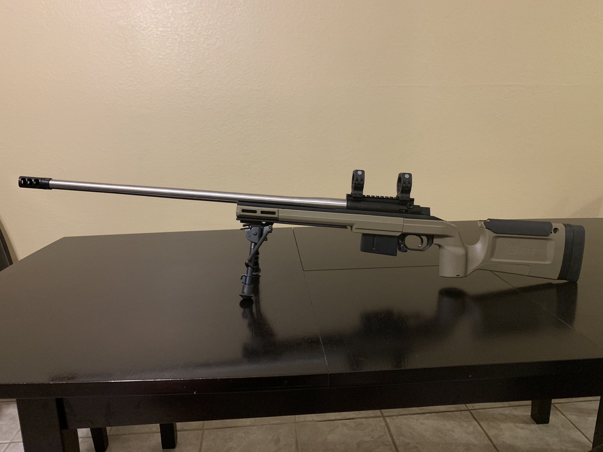

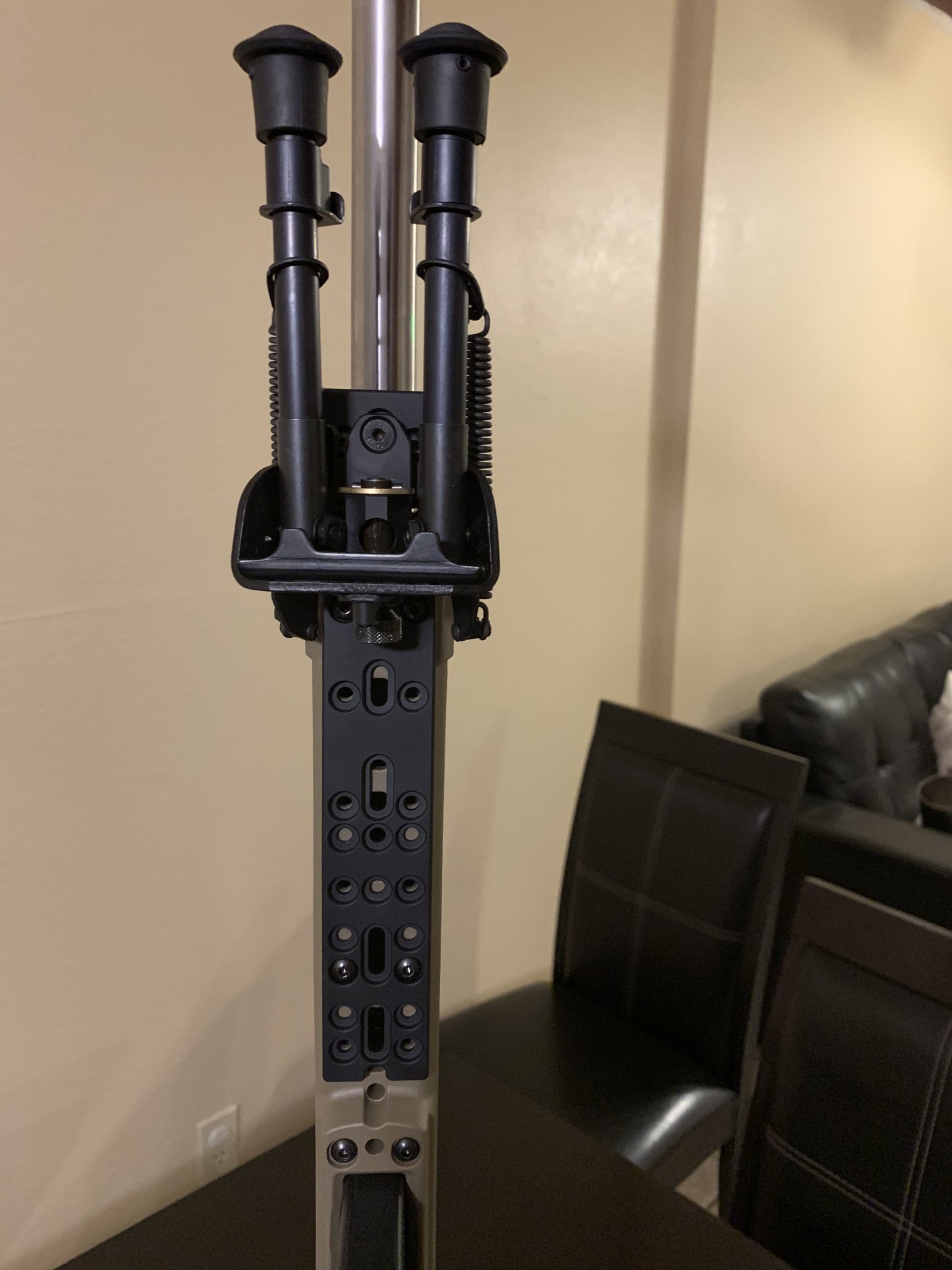

Dressed her up a bit. She’s still topless though.
6.5 SAUM
PVA JetBlast brake
ARC Rings
ARC mag
Harris bipod with KRG Swivel mount (for now)
KRG ARCA rail
KRG extended mag release
1/8” adhesive backed neoprene cheek piece.
Dressed her up a bit. She’s still tooless though.
6.5 SAUM
PVA JetBlast brake
ARC Rings
ARC mag
KRG ARCA rail
Lookin good there Joe. (y)

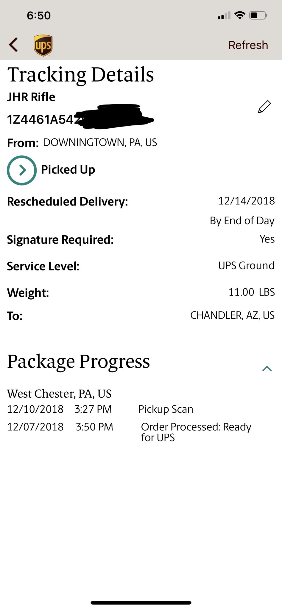

Thanks. Has yours shipped?
I ordered during the sale black friday week, so my order # is in the 38xx range. I haven't called to talk to anyone at PVA yet but I would assume/hope that it's going to be at least a few months till it's available. Might call after the holidays and at least try to get a time frame so I know roughly when the funds need to be there. This will be my first longer distance rifle, I don't mind waiting for something that for me will be special. Even most of my hunting rifles are single shots or pumps, lol.

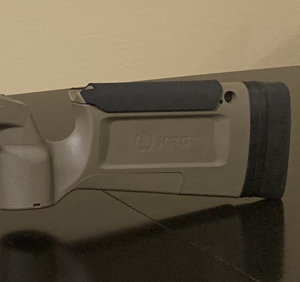

Neoprene closed cell foam cheek pad how to.
I’m going to post this for those that don’t enjoy having your face be against plastic. If you want to do a closed cell neoprene cheek pad, here is how and where.
https://www.ebay.com/itm/CCNS-Rubber-Neoprene-sponge-1-8x12x12-double-sided-Self-Adhesive/222973982331?ssPageName=STRK:MEBIDX:IT&_trksid=p2060353.m1438.l2649
First make a paper template.
Grab a sheet of printer paper.
Remove your cheek piece off the stock.
Cover your cheek piece with the paper, think taco.
Rub your finger on the edges to create a creased outline of the cheek piece.
Cut out the template on the outline.
Test fit your template and adjust as needed.
Once you are happy with your paper template, tape it using scotch tape to the foam side (not adhesive side) of the neoprene sheet. Use scissors to cut out the shape from the sheet of neoprene. You may also use a xacto knife for the areas that are hard to get at with scissors.
Once it’s cut out use a Dremel and sanding drum to blend in rough edges on the neoprene cheek pad.
Clean the cheek piece with rubbing alcohol to promote better adhesion, peel and stick. Stick from one side to the other making sure not to leave air bubbles under the foam. This is closed cell so air can’t escape after the fact.
This pad provides traction and comfort without soaking up sweat. When it gets dirty, just wipe with a damp rag.

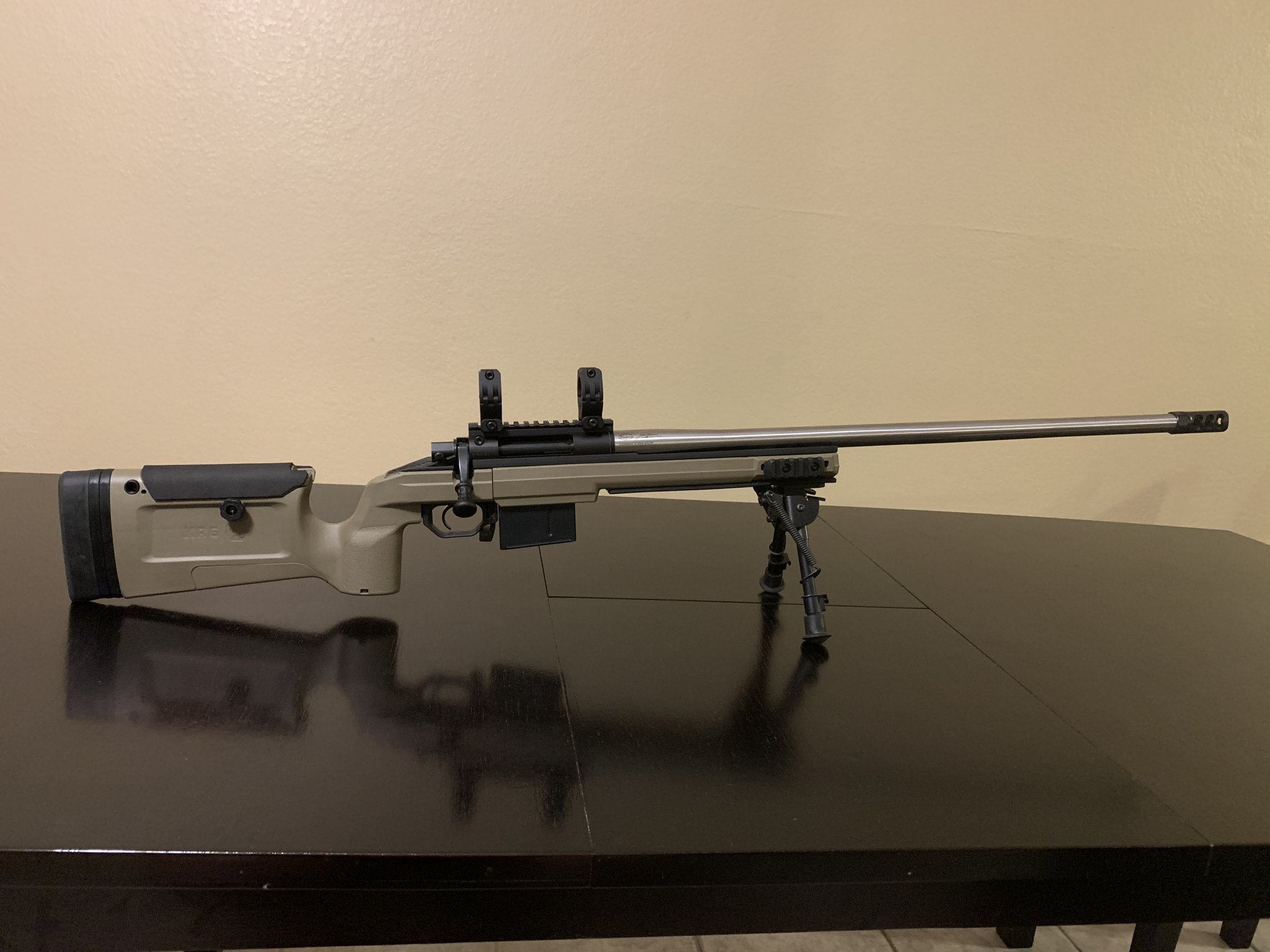

Well here is a pleasant surprise. I thought the 6.5SAUM JHR was supposed to have a 24” barrel but I measured mine and it’s 26”. I wanted a 26 anyway for added velocity. (Borat voice) Very Nice!!!
The 65 SAUM is being done at 26" for the 2 guys that ordered them. The factory ammo that was supposed to be on the market when the rifle was launched was shooting well for us in 26", a little better than 24".
The 6.5PRC is coming with 24" barrels as the Hornady ammo favors that and we have to consider the performance of factory ammo for a production rifle.
