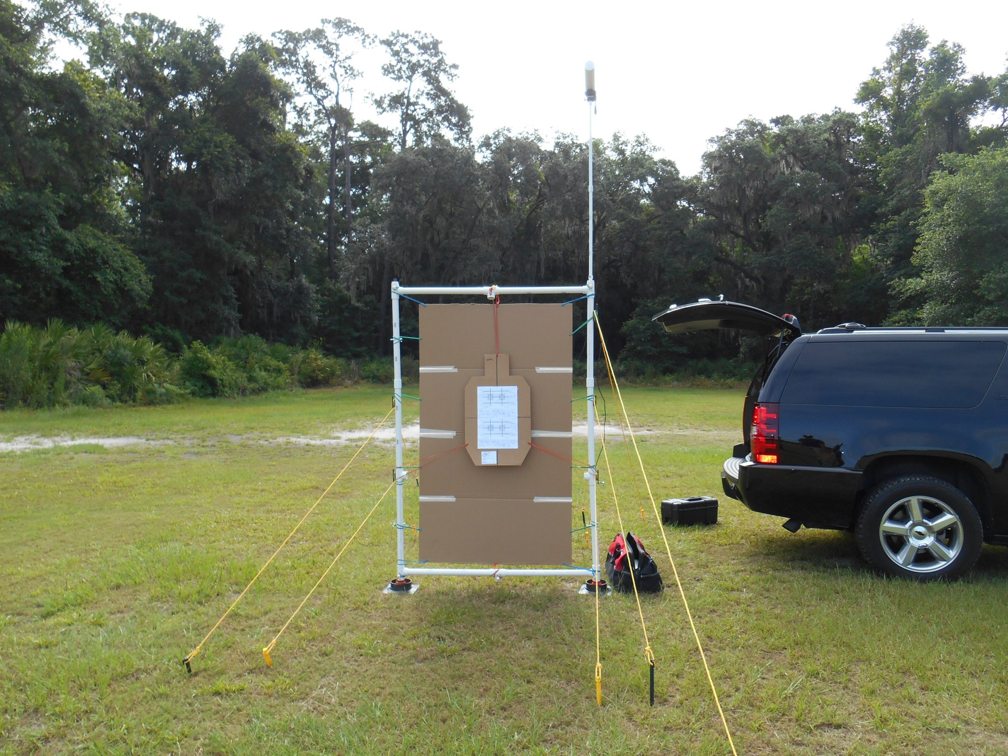

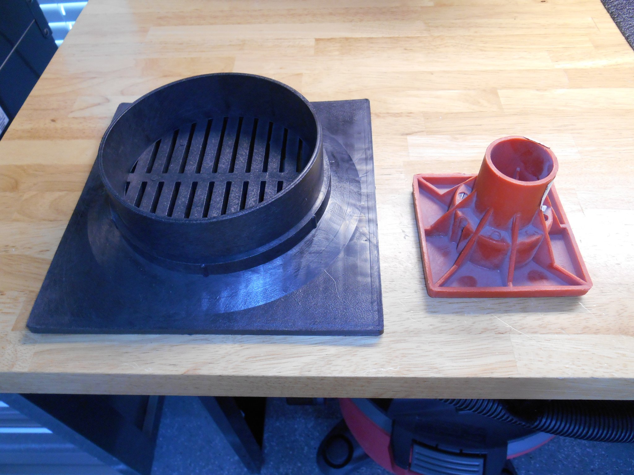

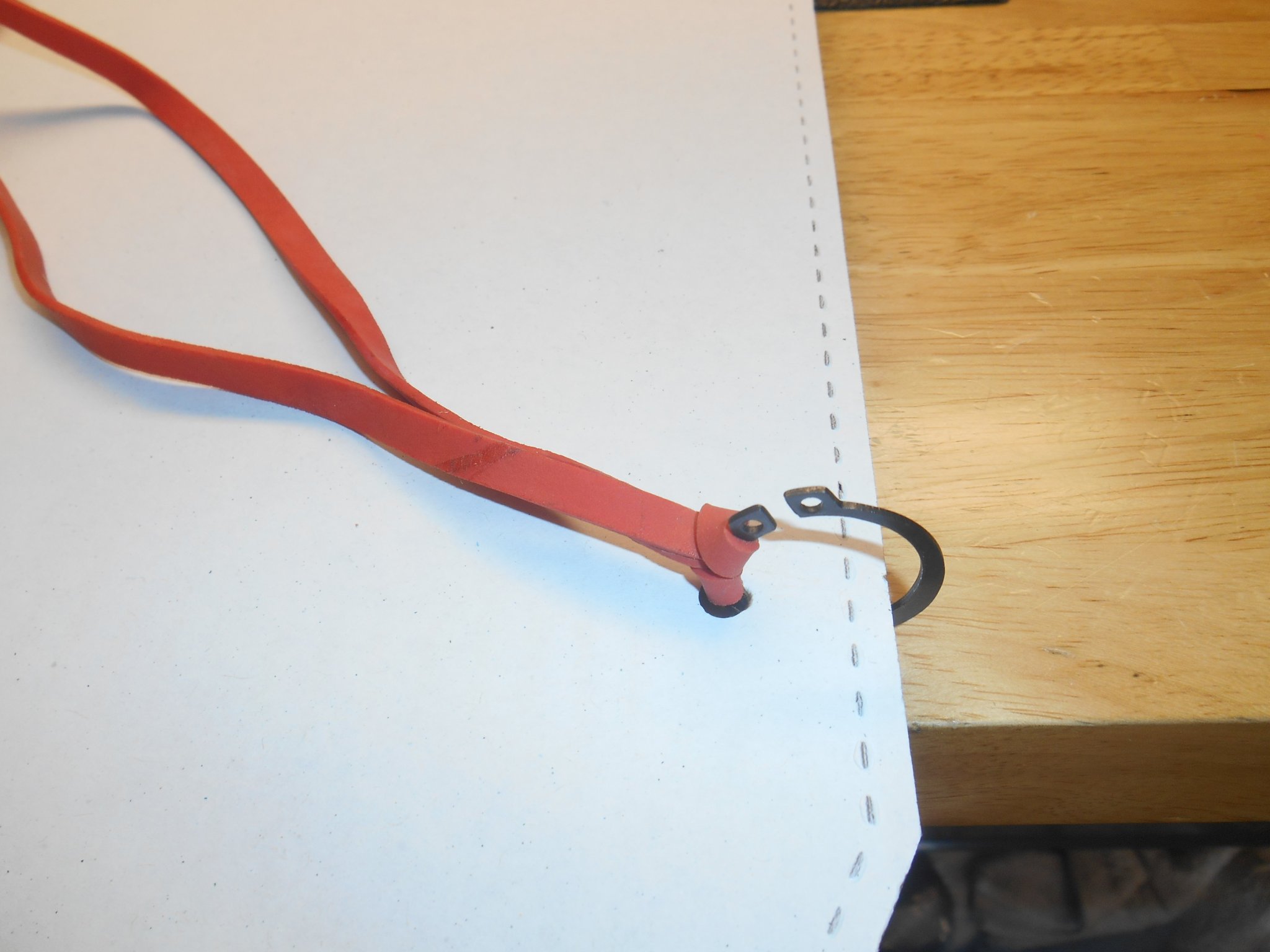

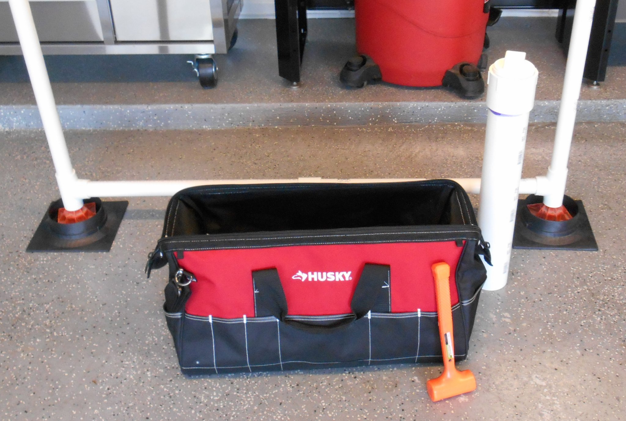

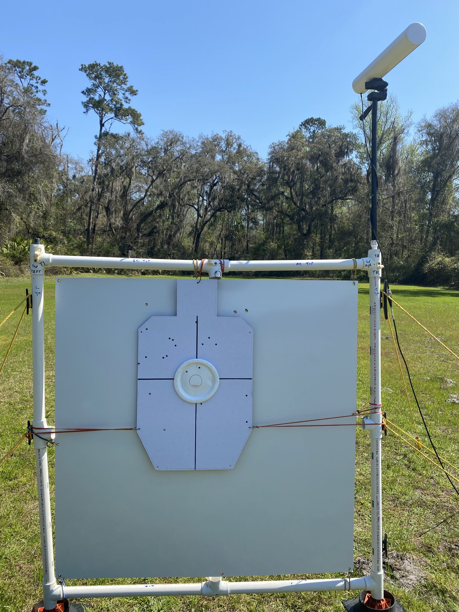

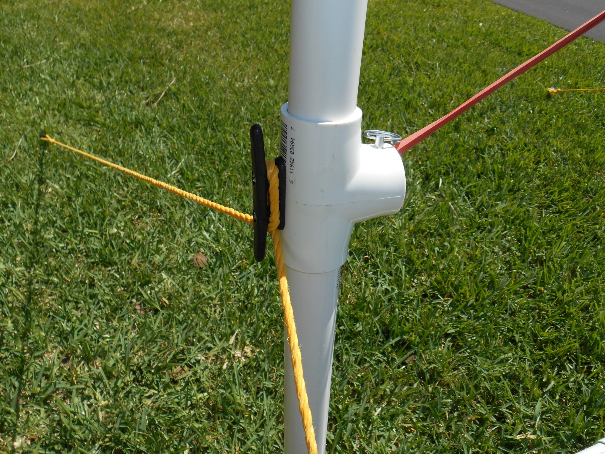

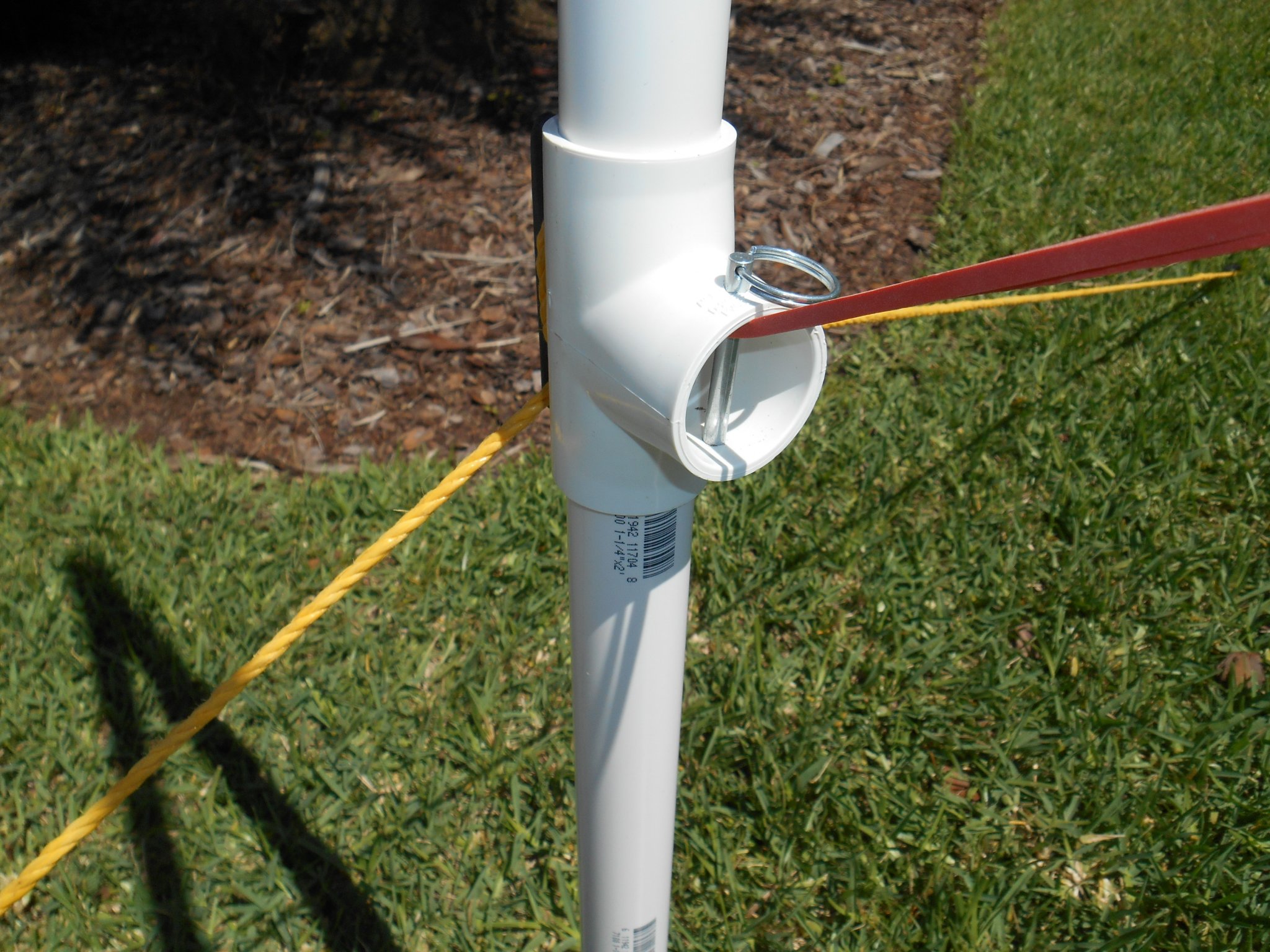

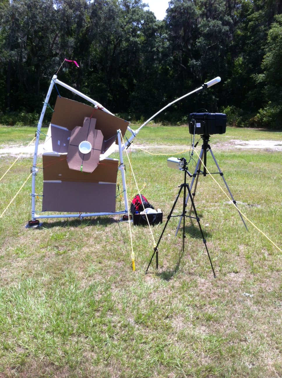

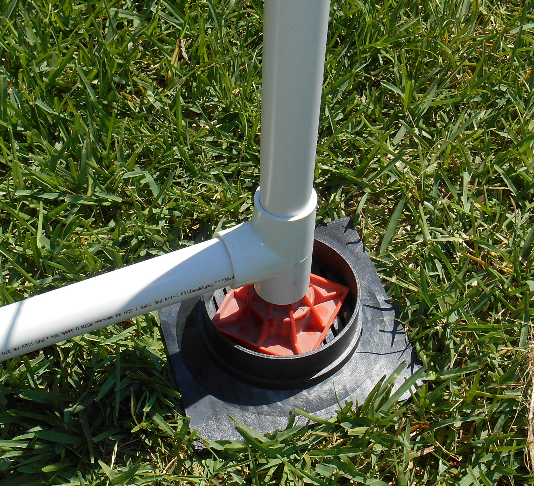

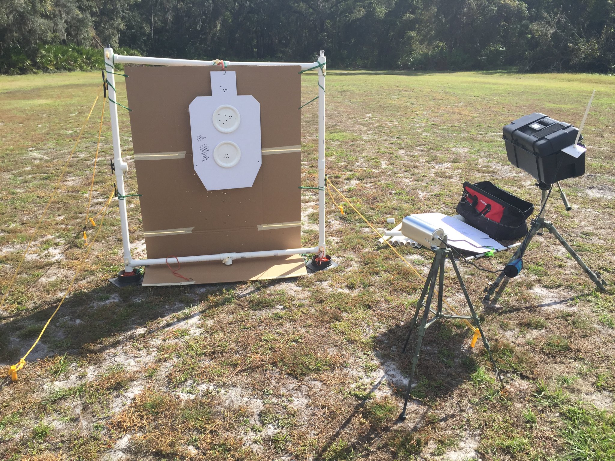

I made a 1-1/2" diameter PVC plug-and-play set, tall or high depending on distance, marine boat cleats to stabilize the frame that sits in footprints of 6" polymer drain covers that the tubes inset into via some scaffolding polymer base (all Home Depot stuff for pennies), heavy duty rubber bands connected to C-clips for easy target changing. IF you clip a tube (900 meters 16" 7.62) it's $2.99. Most targets have a brown side and a white side, shoot the white side, easier to see in cameras and spotting scopes especially 5.56. The larger backing cardboard is a HD packing box, "grande" size for ~ $5, really helps to see wayward hits in wind at long distances. A simple tool bag carries all the gear; put stakes in 4" pvc tube with screw cap (shown next to tool bag).

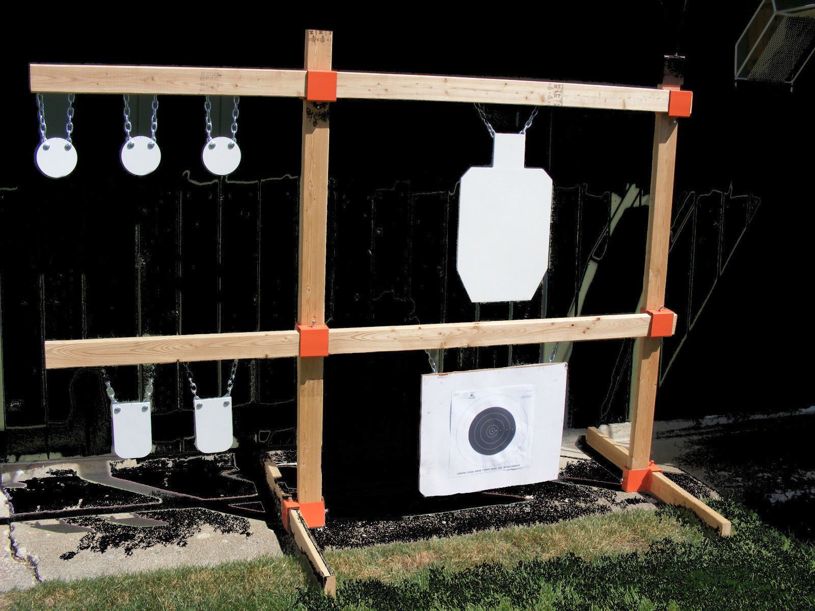

Check out the TargetMeister stand. I use it at my range and it withstands wind and bad shots. Just build the frame w/ 1 x 2's from Home Depot. I built my frame using small hinges (and using a pin or bolt to keep the halves from folding) so I could fold it to fit my SUV's back cargo area better. PM me and I'll send photos of my build, with measurements. https://targetmeister.com/

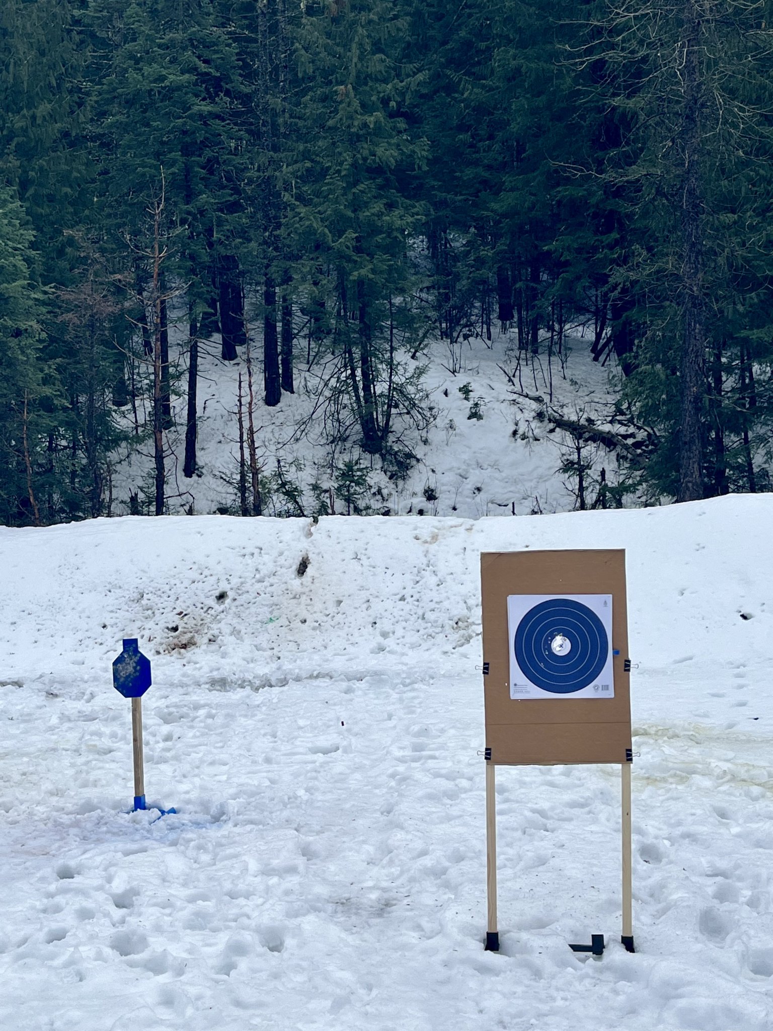

I have been using these and are very happy with them. The 1x2s are held in by spring tension. They are light , not bulky and easy to transport. It is the one on the right. They come in a two pack.
Target stands

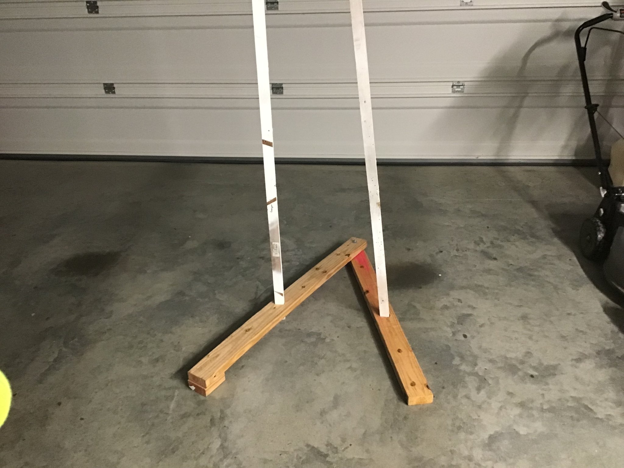

I made target stands from a 2x4 and furring strips. The 2x4 cut in half, joined at one end with a carriage bolt, then drilled a hole and squared it off with a chisel so the furring strip fits in it. When expanded and the strips placed in it stapling a USPSA target holds it all together.
cheap, takes up little room in the corner of the garage, will fit in a trunk of a car

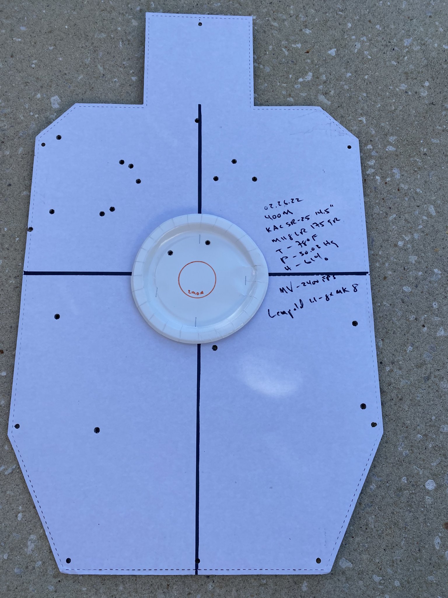

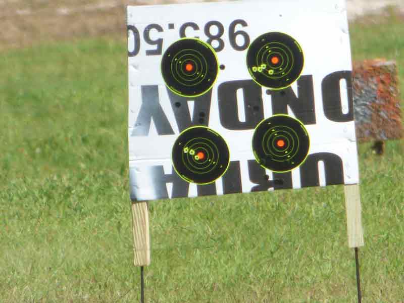

Tried a new 4x4 ft white backstop today; shooting KAC SR-25 14.5 " ACC Leupold Mk8 1.1.-8x @ 400 meters, round is still +2000 fps @ range. Thrifty board,4x8 ft cut in half @ Home Depot, so $8 each which translates to 4 rounds of 7.62 M118LR 175gr! Easier than the brown cardboard grande size I have been using. Target camera has no problem identifying wayward rounds. Note that white-on white-on white with low angle winter sun is not easy to see thru the scope; next time highlight the target edges with orange trim.

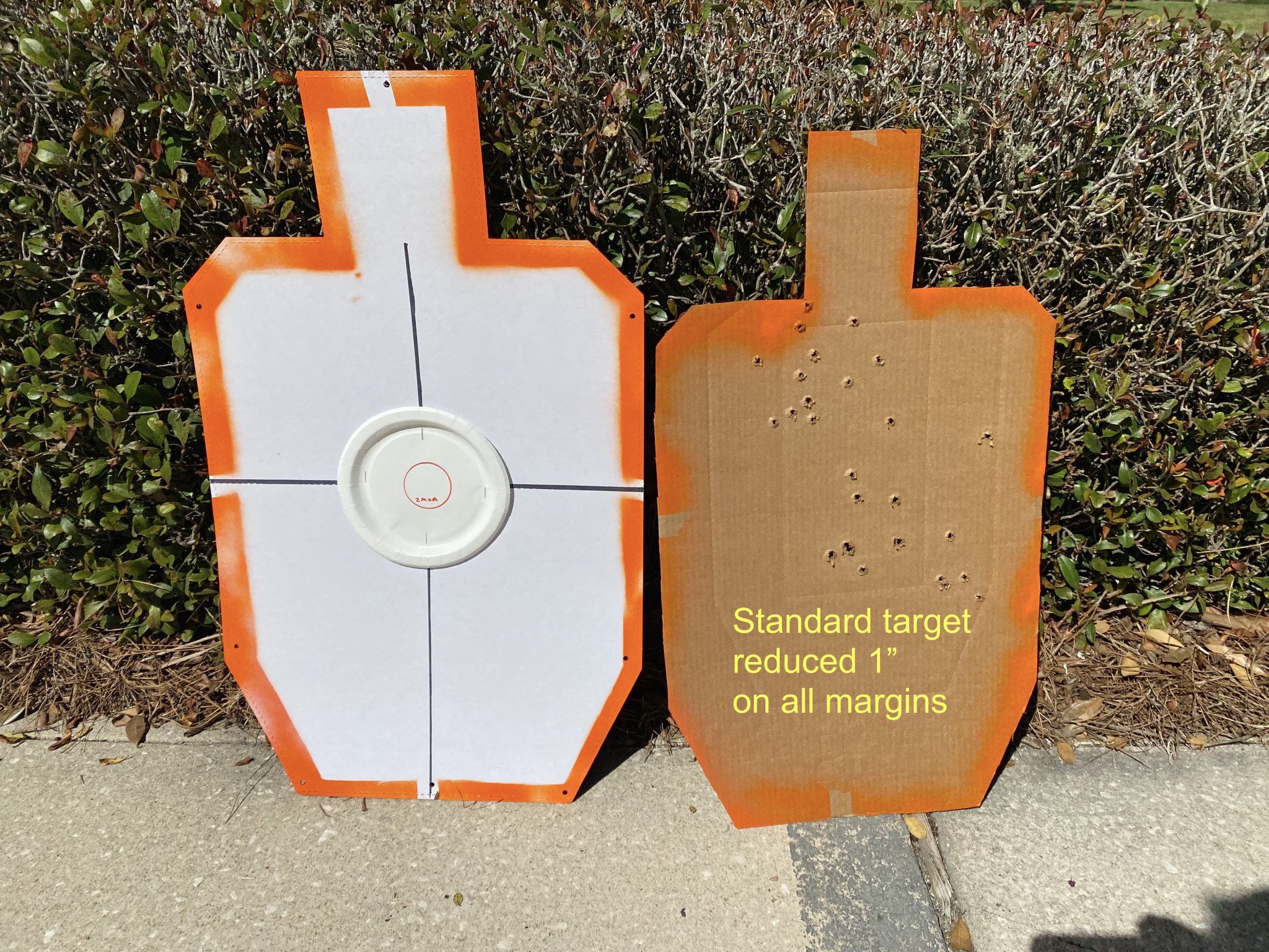

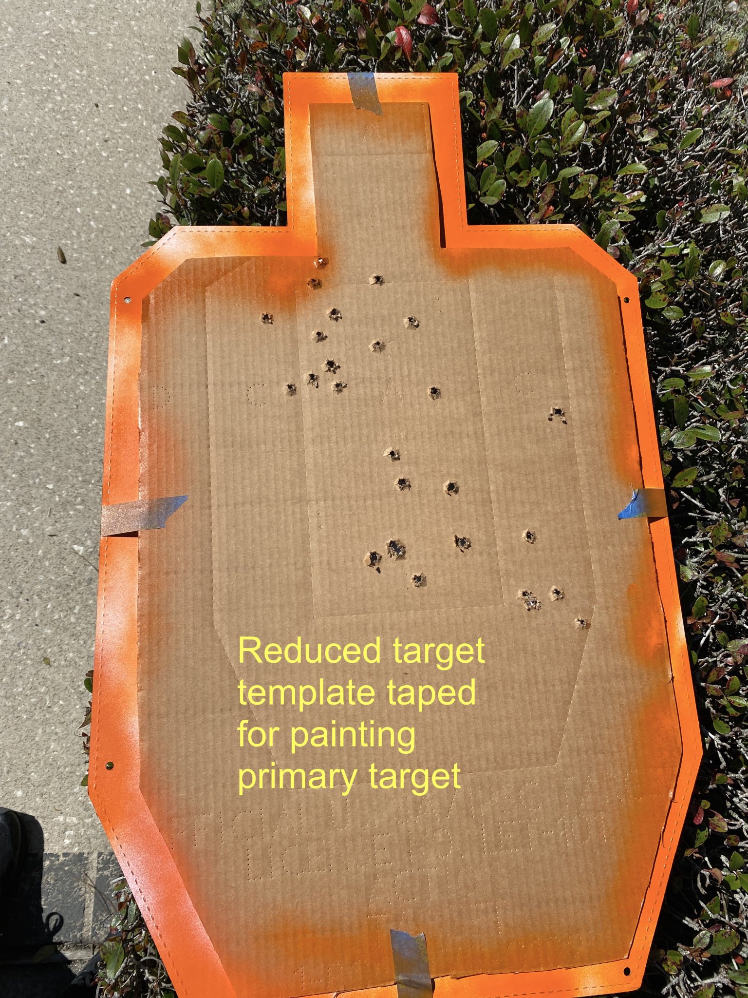

Fabricated a 1" margin reduced target that could be used for highlighting the margins of a standard silhouette target. Will be using it @ 500 meters next week for KAC 14.5" ACC SR-25 engagement. I am hoping this will improve the target visualization thru the scope.
