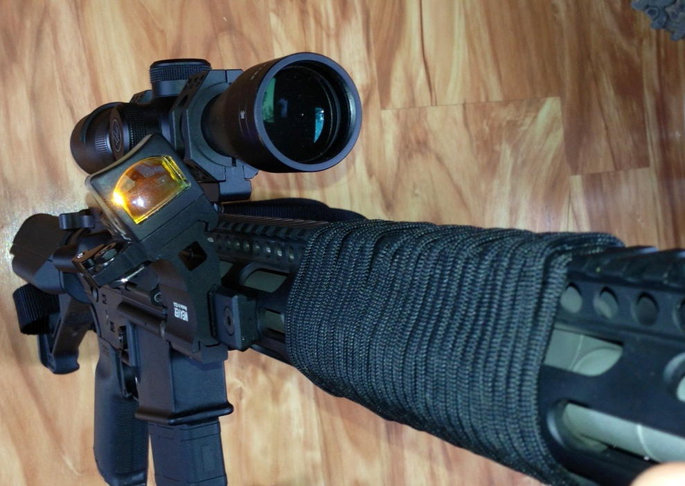

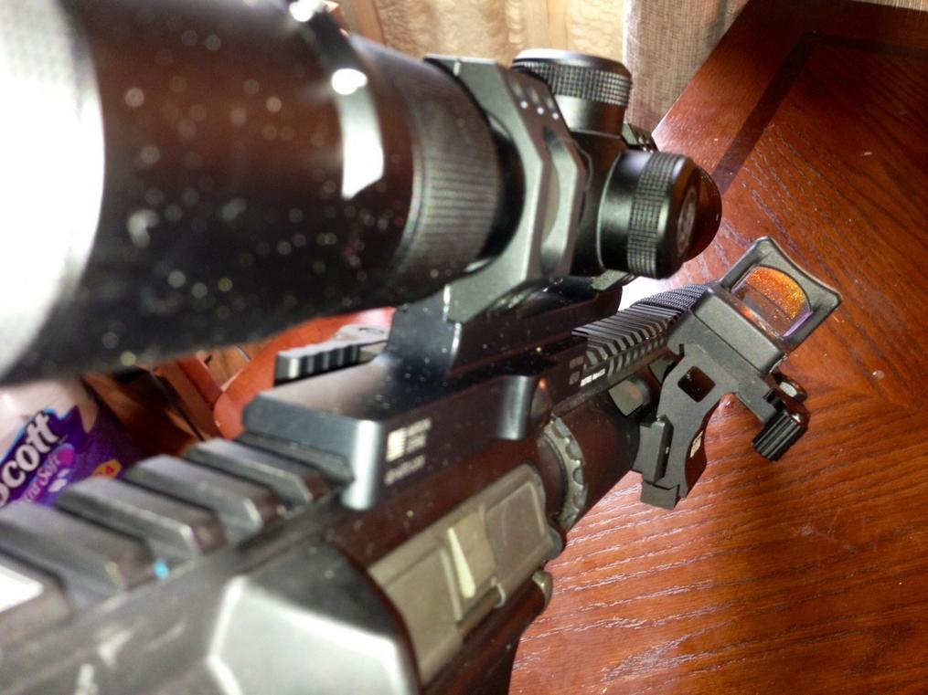

Here is my setup that I like pretty well for now (Vortex Viper 2-7x32 bdc w/ Trijicon RMR in Weaver 1'oclock mount)
