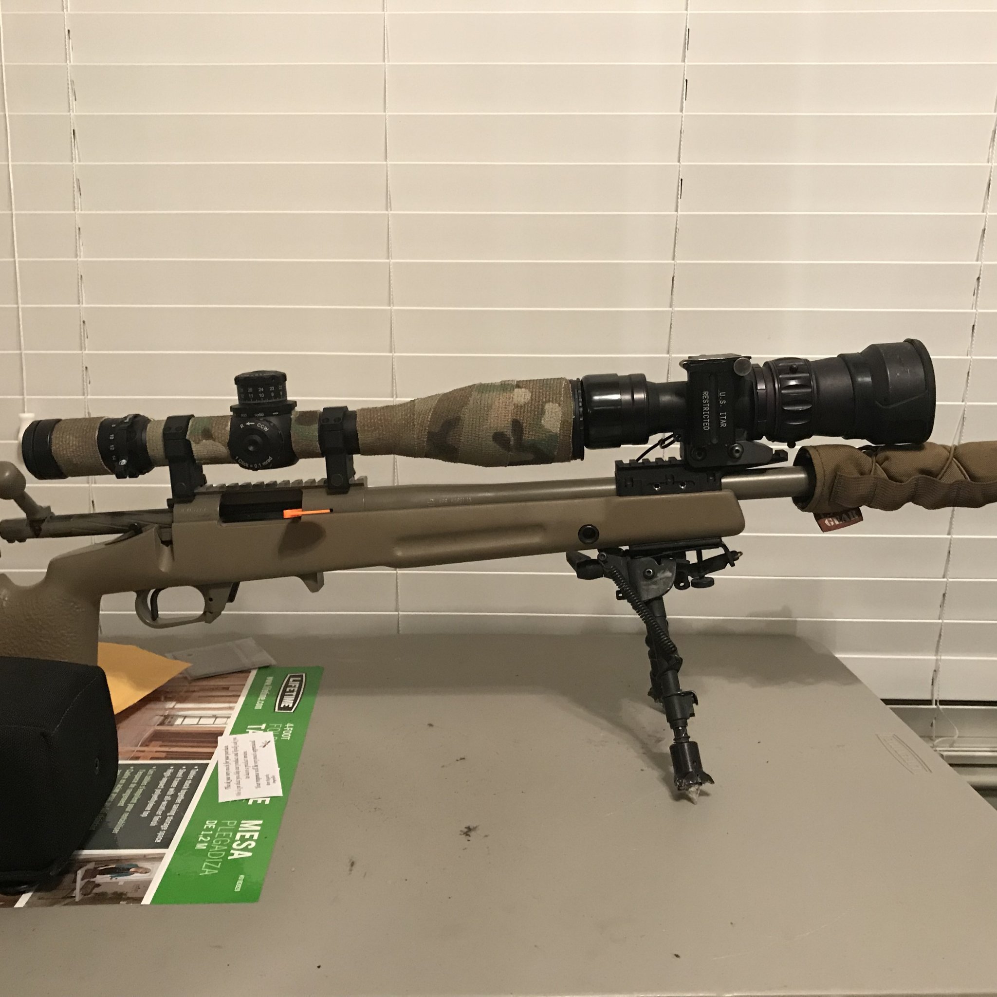

    I just switched over to a badger set in 1.375 and I have pretty good allignment with my PVS 30. My only gripe is I like keeping minimal height above bore but that’s just a preference
