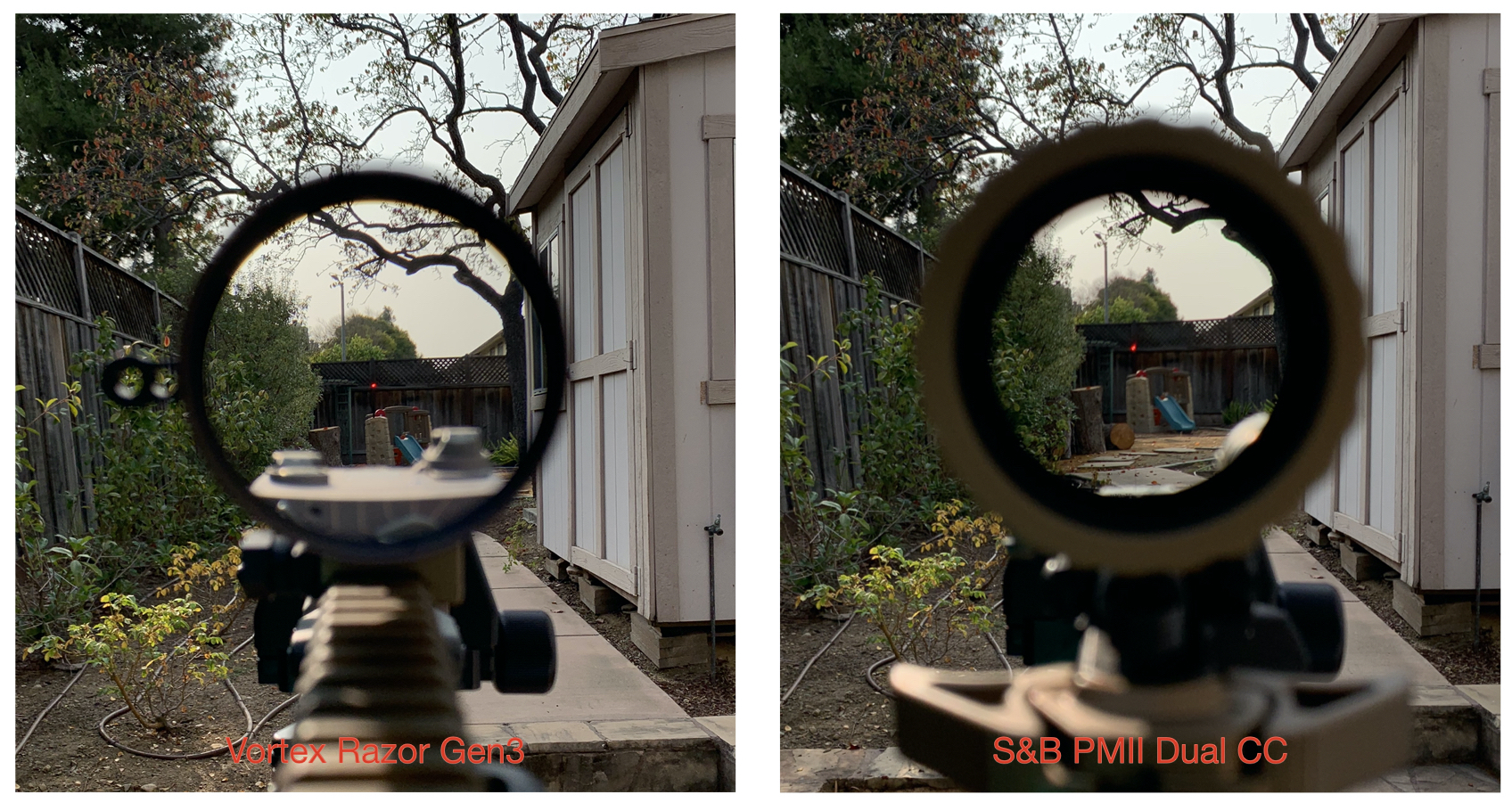

    The loss of brightness when leaving the optical center with your eye. Because it looks like it loses that "halo" (if that is the right word) and you just see the reflective surface when you move left to right. The etched dot might be the cause of that.
    Damn that looks like looking through a toilet paper roll. Does it have bad tubing effect or is that because of the video?
    Unfortunately that is what the image looks like. It isn't nearly as big as on the Gen3, so you see a lot of the scope housing. On paper they both have the same FOV at 1x, but I am not seeing that. I wasn't perfect on lining up the front of the objective lens between these two images and I was hand holding my camera, but they were mounted to the same tripod and at most they were only 3-4" different from to back.
    Air quality index was only 70 today, so I was able to go outside and take some videos as well. I compared the Dual CC to a Razor Gen 3 and Razor Gen 2 and found some interesting observations. As a note all scopes were tested at 1x and max brightness and the sun was starting to come down at my 10 o'clock.
    • Dual CC - Just a little past the eye box limit where the dot goes into the black, the red is no longer visible and you only see a clear etched reticle which isn't illuminated. @freedom71 You mentioned that the dot is always red, it would be great if you could check if that is still the case in the sun as that would be a difference between our units.
    • Razor Gen 3 - The red dot does dim as you move off center (as ILya stated), but it drops off very gradually and the total reduction in illumination is minimal. Compared to the Dual CC where there is a drastic drop off right away. However, once you get to the eye box limit, the dot completely disappears and you can't even see the etched reticle. My assumption is that this is due to the FFP reticle on the Gen 3 vs SFP on the Dual CC.
    • Razor Gen 2 - For fun I tried a Gen 2 which also has a SFP reticle. The red dot is visible until the very edge of the optic and barely dims until you get close to the edge.
    Seeing the same thing outside. Still can see red in the scope shadow. This is a quickly-made, rather poor video, but maybe you can see it:
    Yep, can definitely still see red within the scope shadow where mine is no longer illuminated. Does your dot ever go clear as it reaches the edge of the scope?
