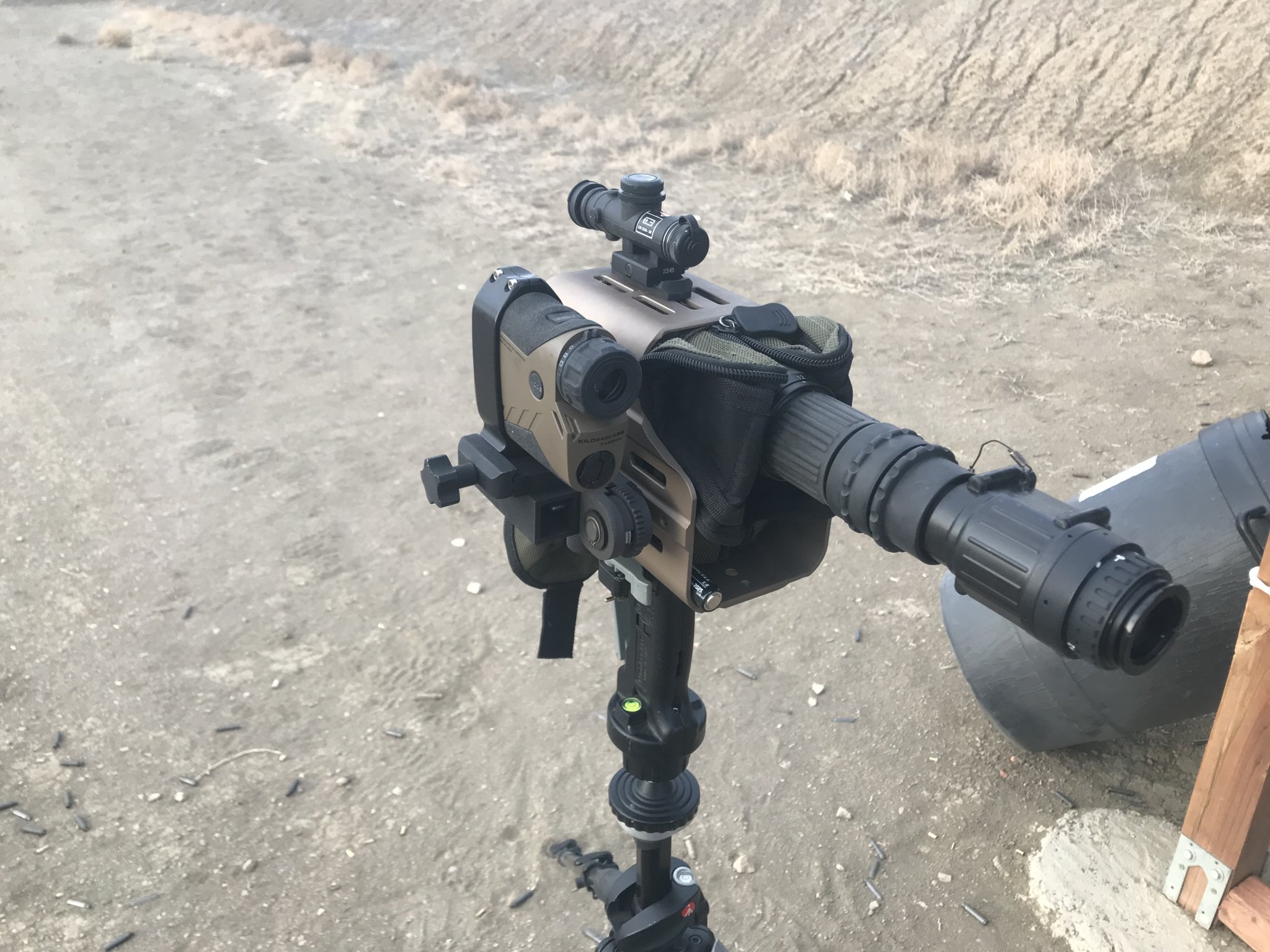

I actually do that with night vision usually - find the exact beam pattern and aim point reference point using an Elcan type mount base and a night vision unit. Helps me see exactly where the primary beam density falls vs the reticle. Only works on the 905nm units though.
I do think I'm going to try the Terrapin myself now that some good reviews are coming in.
Sorry, I am not making graphs ... fuck that,
Taking numbers and inserting them into a graph is for the other guy. They get the numbers from the same place you would they just graph them.
A book and graphs dont tell you to locate the aiming point on the LED circle, me in the field does that. Most default to a center hold for a laser that is incorrect, you have to MAP the beam location in order to actually HIT a target.
What chapter is that in the book ?
Lowlight, I didn't understand what you meant by map the beam location? Are you referring to figuring out exactly what the laser is hitting in relation to the aiming reticle? Did you need to do this with Terrapin X?
Thanks for the info on this RF, excited to get one
nfoley, just to save Frank the response; yes, and yes. You should do it with any rangefinder. The laser is rarely perfectly colocated with the reticle. My Sig, for instance, prefers the bottom third of the reticle.
Spot on - most reticles aren't perfectly aimed at the center of the beam density. Back in the day I used to do this with a triple target. Our range had 3 squares at 300, 600, and 900m that looked like they were stacked one on top of each other parallax wise. You could move the laser and see exactly where the laser hit.
Now I adjust the unit to be spot on the reticle on my spotter and measure its location in the TMR reticle.
My 2400 favors the top of the reticle some, for example. My terrapin favored the left side, but only a little.
A good tripod and multiple distant telephone poles and wires will give a fairly good idea. The only ones that have been spot on as far I could determine have been my Vectronix units. The Leica 2000B unit that I just received from Euro is definitely lower left. So much so that I can practically use the LL corner of the retice as my aiming pt out to 5-600 yds. I keep notes on each one I have and also put a sticky on the RF to show it’s beam/reticle relationship.
I am hoping that me new X unit will be centered as my prior Vect units.

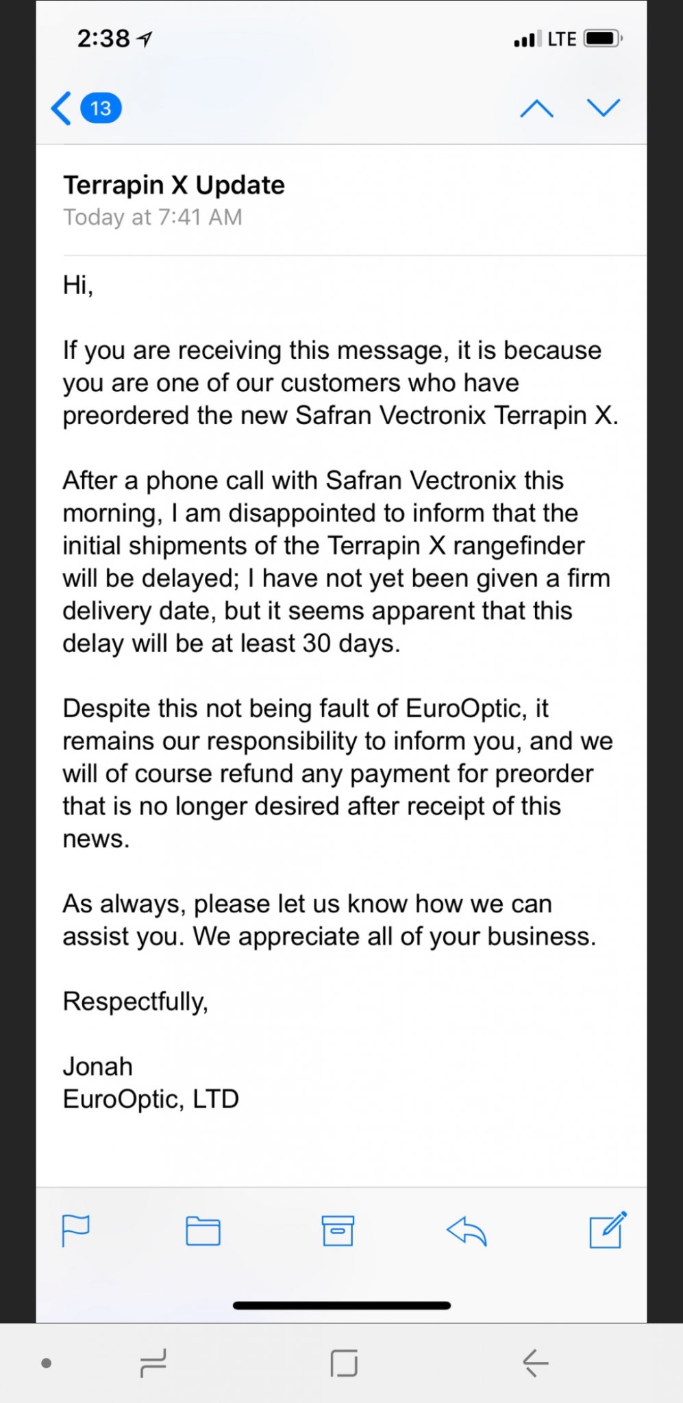

--> UPDATE ON WARRANTY AND DELIVERY OF TERRAPIN-X
If you have a defective unit, you will send directly to us, and after evaluation we will replace directly from stock or send for repair as needed. We will be your contact, so you know you are in good hands ;)
First round is still due to deliver end of this week barring customs delay and the balance of the backorders should be cared for in the following shipment which is slated to arrive to us by the middle of the month.
