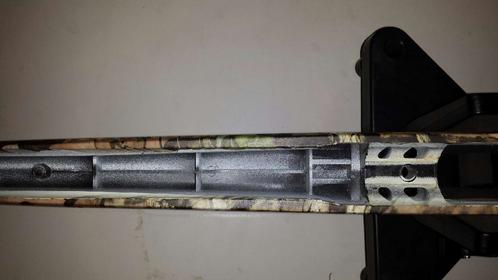

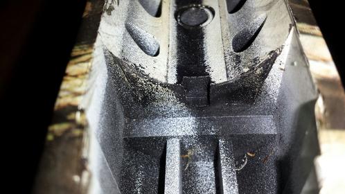

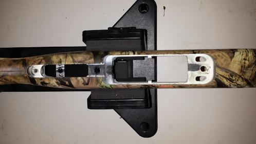

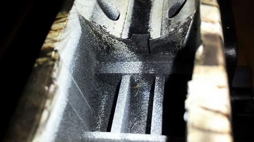

I came across this blog and as I have a thumbhole coming for my .270 from boyds and was thinking about changing the stock on my 220f.
I have a few questions so I can make a better decision what I want to do with mine. I want to know if you sorted out the issues with the thumbhole stock and your POI? ,Was it the pillars, if not what you might of found? If you were to do it all over knowing what you know now, what would you improve on in your build process? What stock model stock did you start with? Is there a heavier stock that you could have chosen?
Any Advice would be greatly appreciated.
