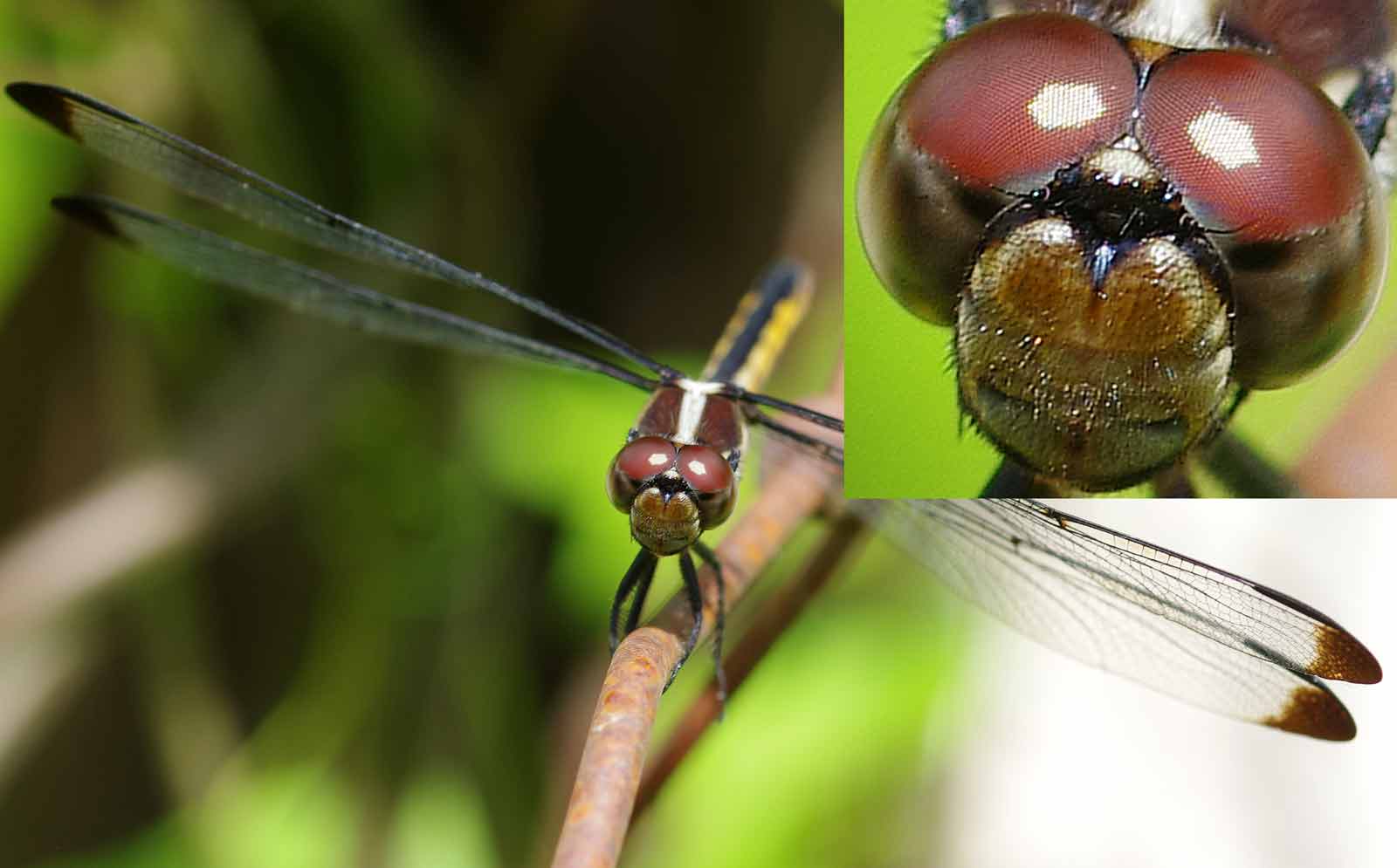

I have a cheaper FZ70 and FZ80 around $300.
Not that much zoom, but not that many dollars either.
I can do moon and bird video Handheld.
Goes with me as a target spotter at 100yds.
Better on a tripod but Macro to telephoto in one hand it's a lot more convenient that my DLSR and big lenses.
