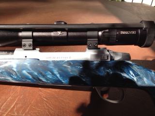

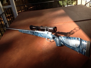

The rifle shown in the attached pictures was built on a Sako 338 win mag receiver.
We sent the receiver to Douglas and had a 24 inch 1/10 premium barrel installed.We then sent the barreled receiver to Macmillan and had the stock added.
It shoots very well and seems to like the 178 gr Hornady A-max load. I am planning to try the HMS 202 gr A-max load when I can get it.
I have no military experience and am rather new to long range (the longest range I have shot was 600 yds but am planning to try 1000 yds). The rifle pictured has a 3X9 Swarovsky. While I have had no problem with this scope I am thinking that I would need a scope with higher magnification.

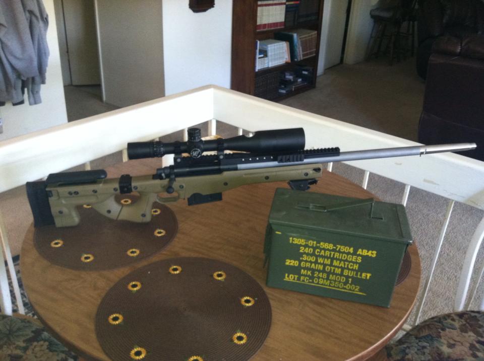

I went with the Nightforce ATACR with the MOAR reticle. My uses don't need ranging capabilities that FFP would provide. If you shop around, you should be able to find one for that price.
Nice rifle. If it is going to be a long range hunter, it wouldn't hurt to err on the side of a lighter weight scope, also it is less inertia under heavy recoil. The ATACR would be an excellent way to go for a SFP scope, though a it is fairly large. One of the best SFP scopes out there.

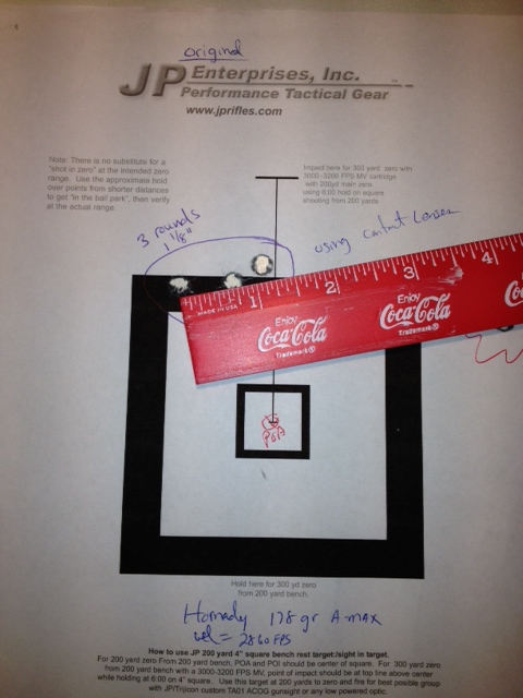

I don't want to insult you but after looking at your pictures 1 1/8 inch group size isn't that good with the amount of money you have invested into the action and barrel. If I were you I would do some load development or action bedding ( or both ) before spending a lot of money on an optic, make sure the gun is capable of shooting long distance before dumping a bunch of money into a loosing cause.
Just my humble opinion from over thirty years of shooting, please don't be offended from what I said.
Thank you for all your comments and suggestions.
The group pictured was shot at 200 yards but I have yet to find the best load for the rifle. Since I have not yet started reloading I have to depend upon factory loads.
Al
