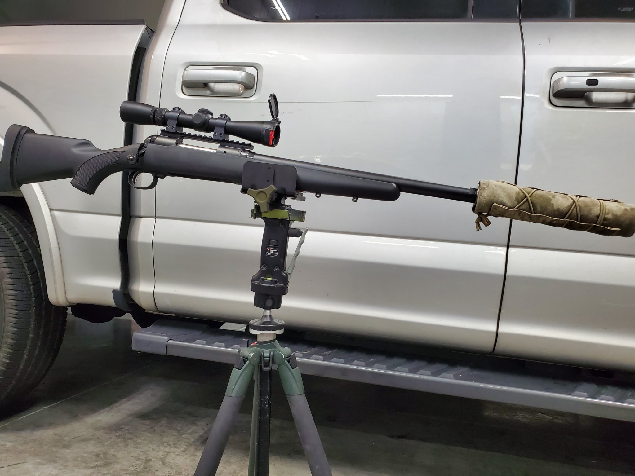

I also have a 20" swede, 2740 ish with the 143gr ELD-X. 8lb on the dot!

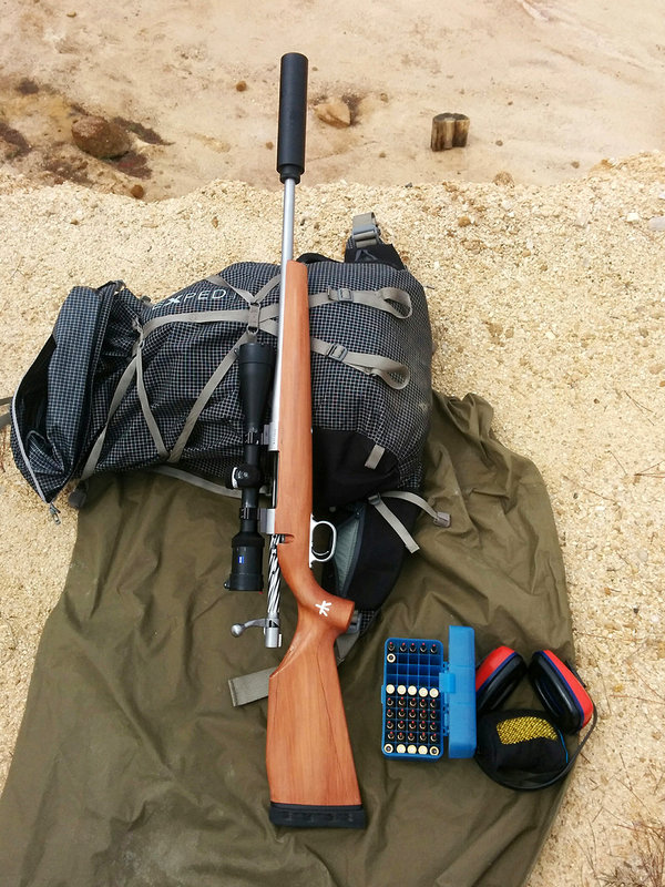

I have a couple of SS M7s in 260. Handy things. Shoot better than you’d think a 20” pencil barrel should. Never going to sell them, they’re pre J-locks.

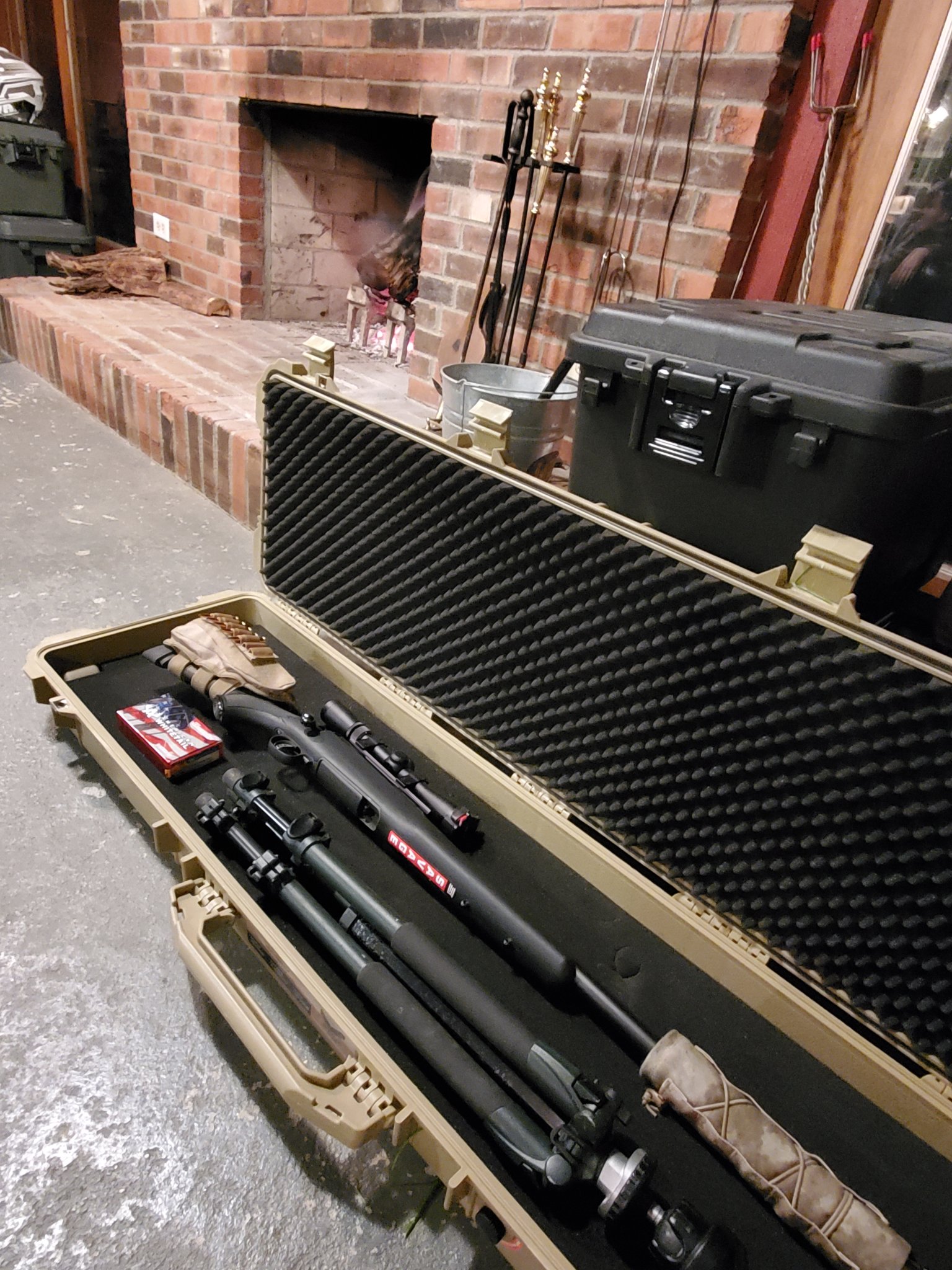

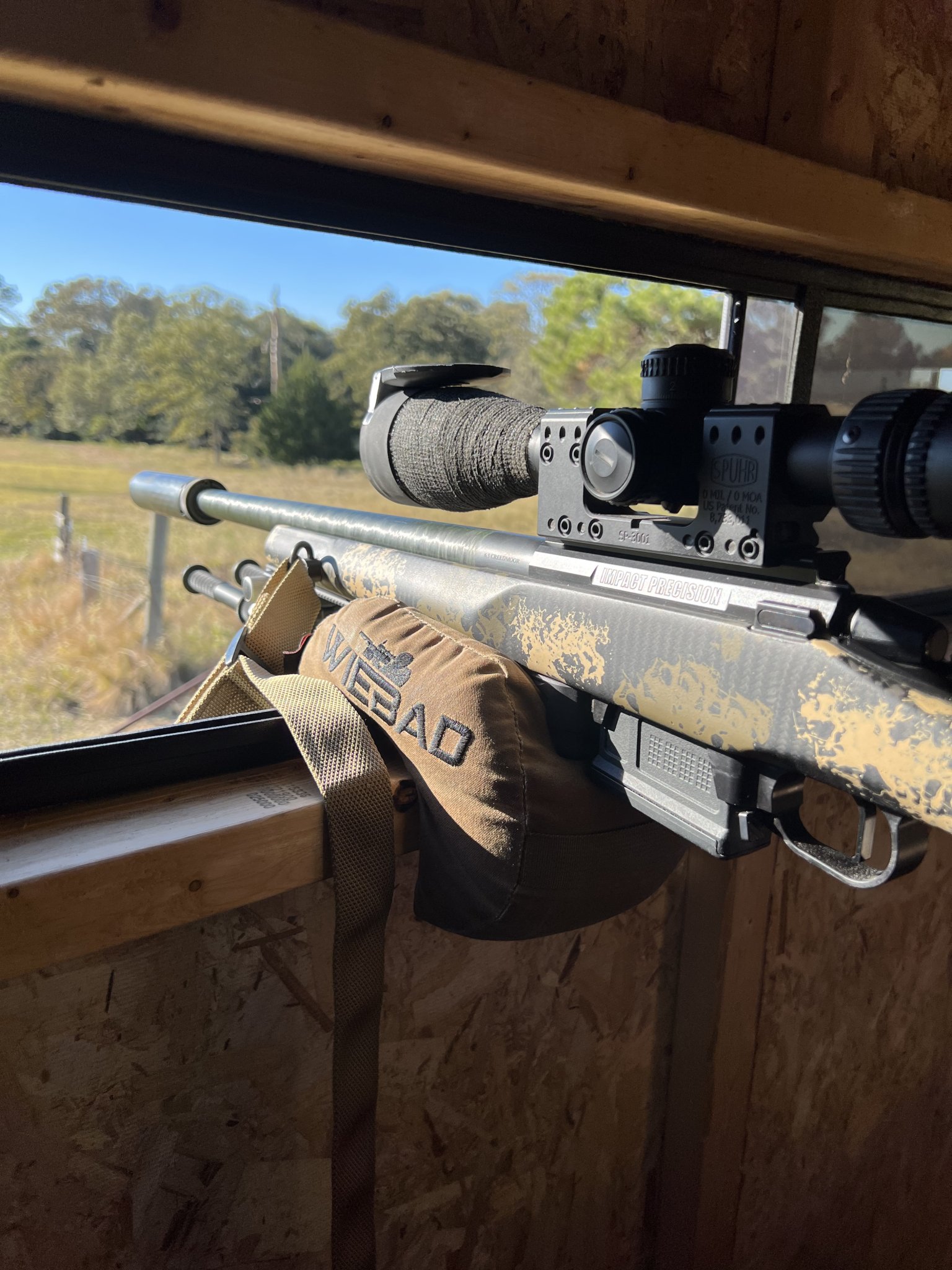

This rifle I put together for my son for deer hunting is awesome!

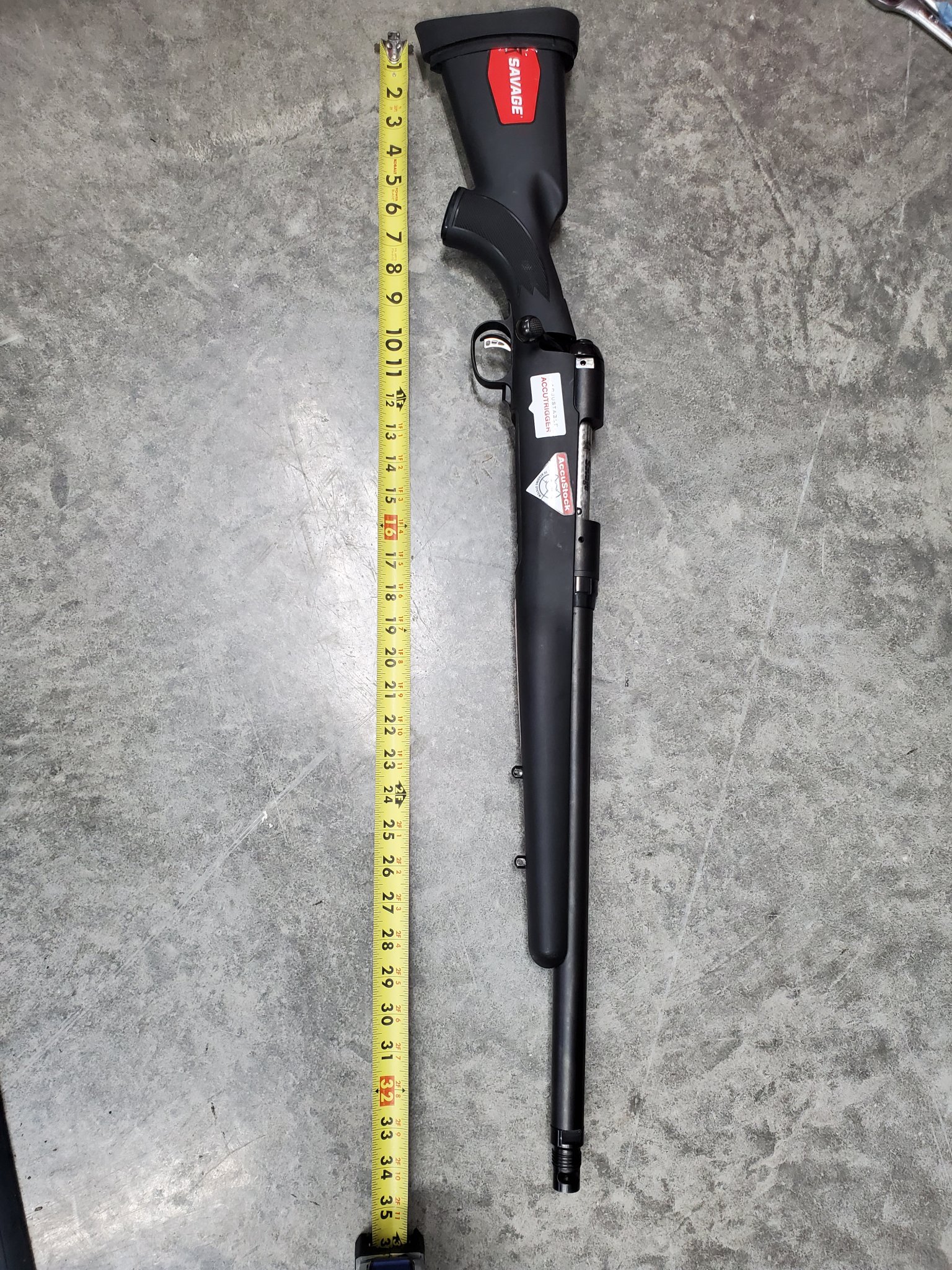

Unfortunately I have not chronographed it yet, but I have only used 129gr Hornady American Whitetail and it shoots great. It shoots about 0.75 MOA 3 shot groups. It's a 16 inch 6.5xm factory barrel and 9 inch form1 can.
My gunsmith states 0.725 is needed to thread and shoulder a barrel if that helps anyone with measuring a barrel/contour to see if it can be threaded at the length you want.
This rifle is 2 for 2 using the ammo above with complete pass through and deer not going far after shot.

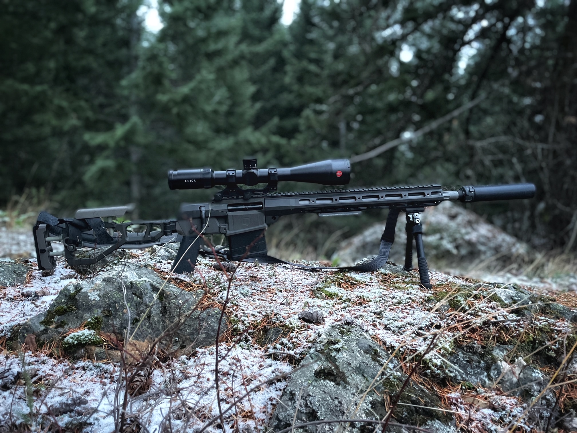

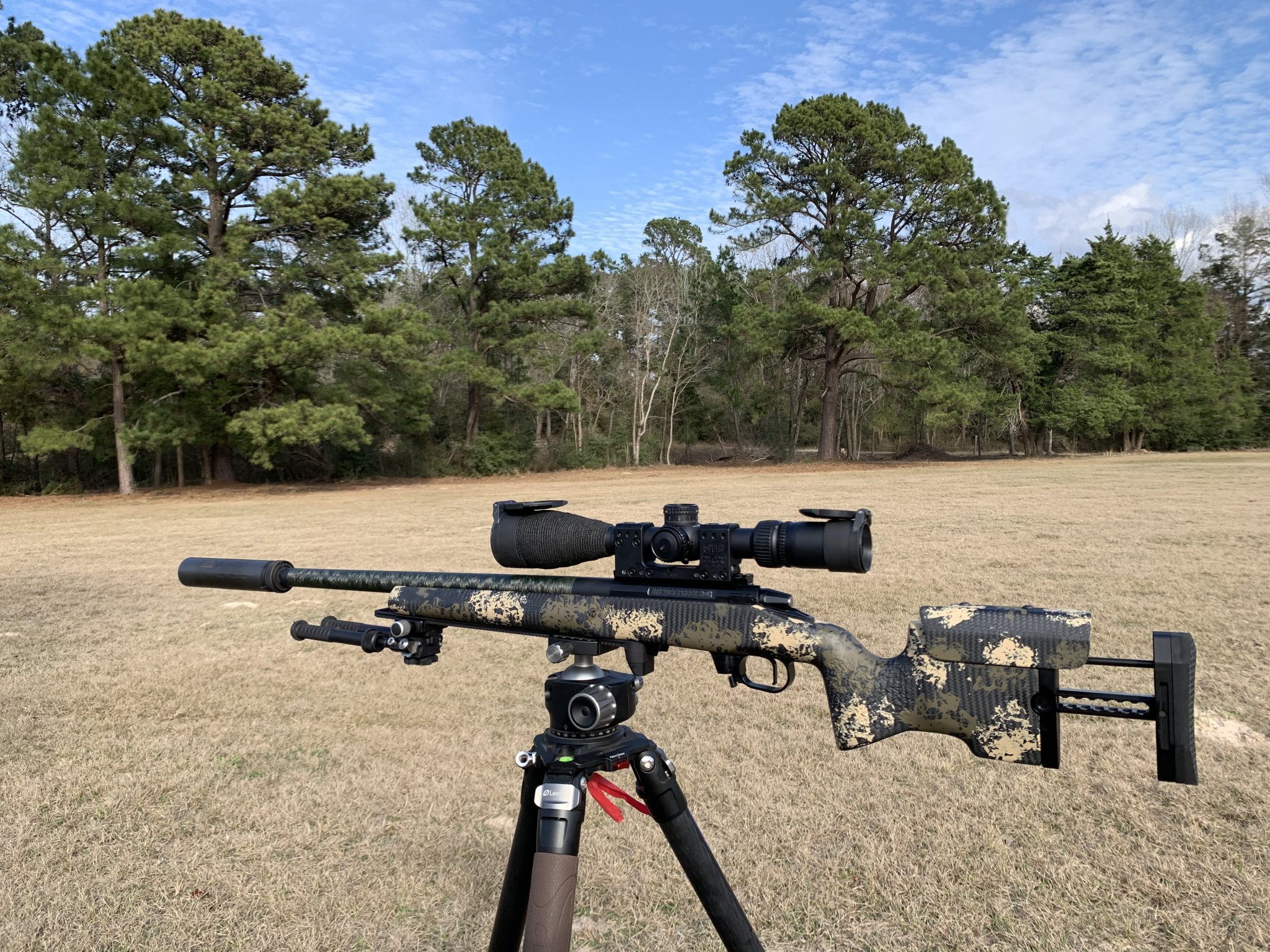

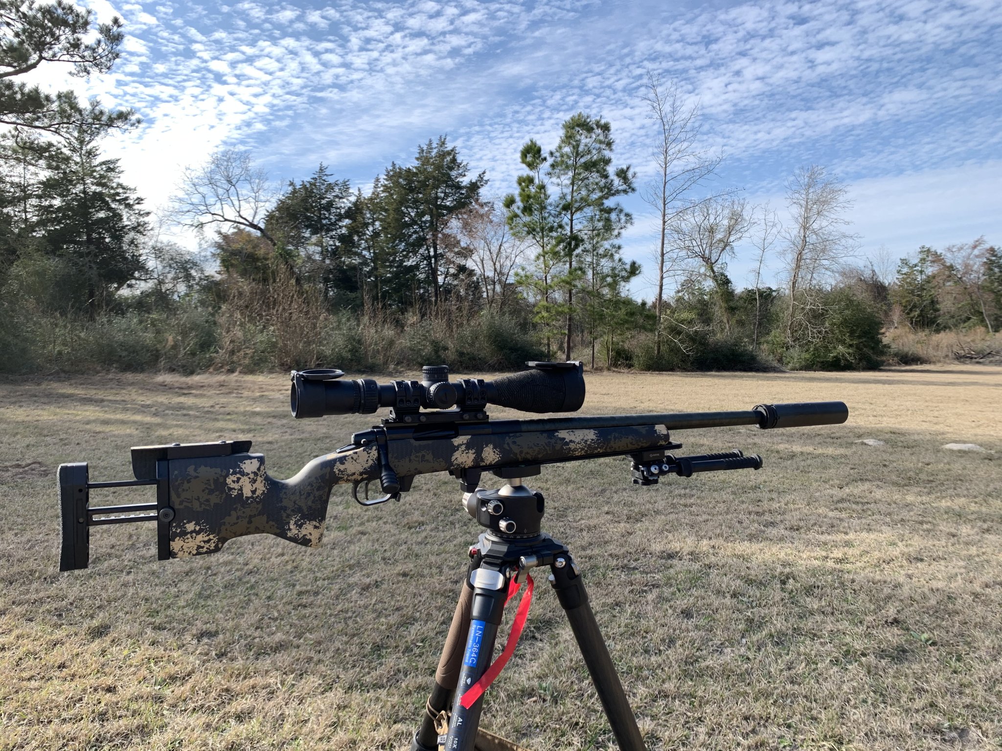

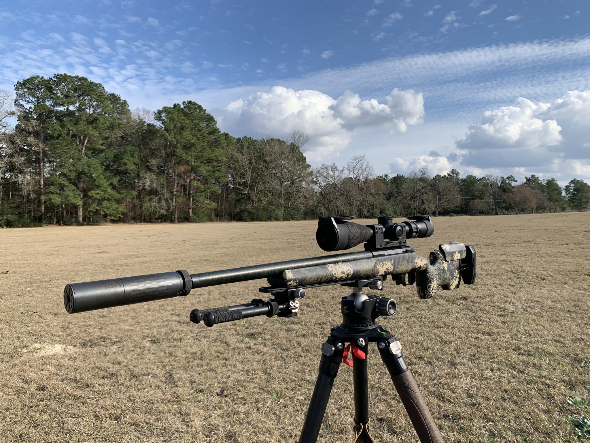

20” bart green carbon 6.5cm
CS 2.0 bedded
Impact action
Hawkins dbm
Area 419 ARCA
Spuhr 3006 vortex amg
Omega can
Atlas
