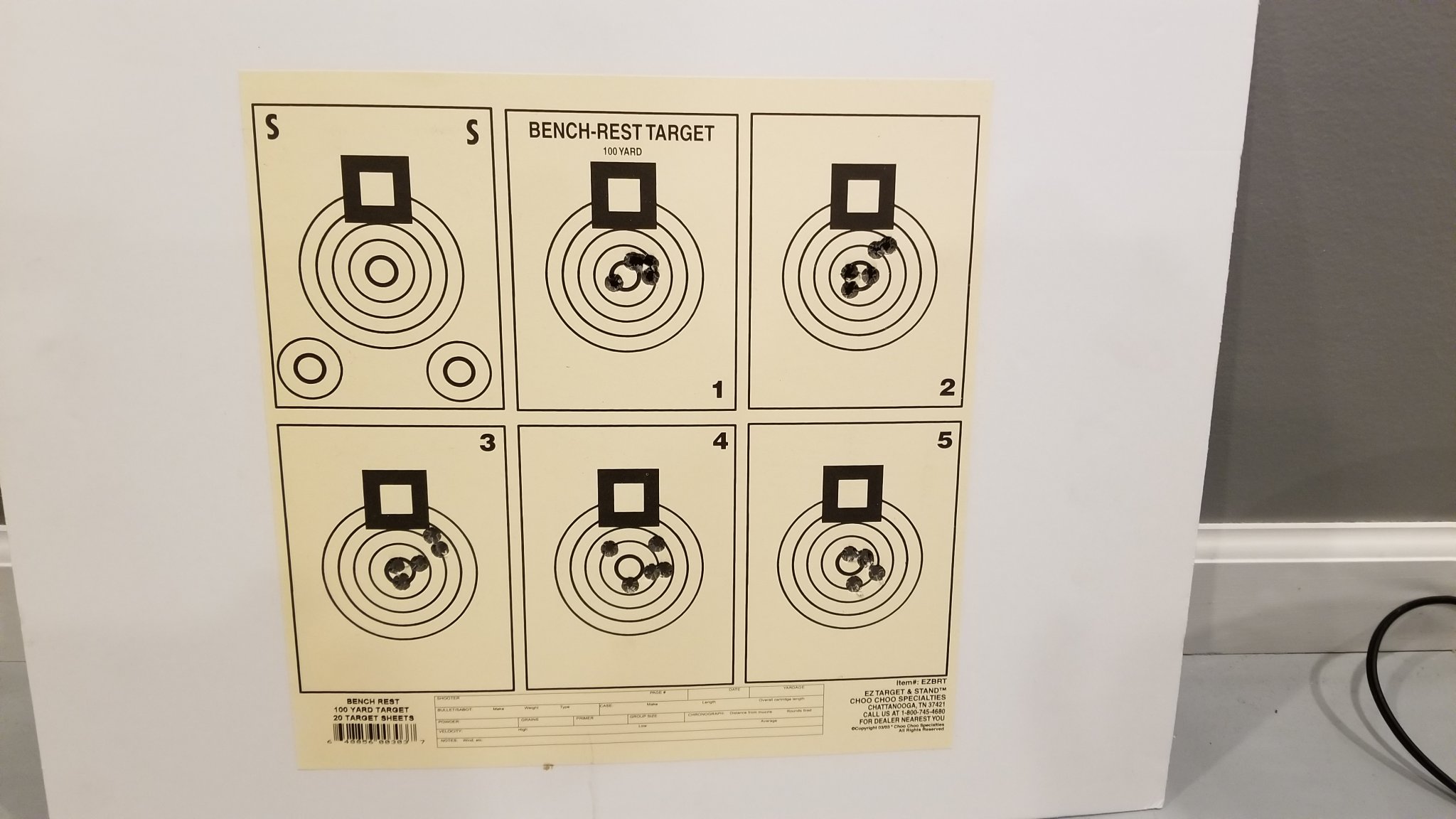

Hey guys, i shot these 5-5 shot groups today with a Rem 700 5R Milspec.... the rifle is 100% factory shooting off a harris bipod with reloads..... not really sure how i feel bout these groups, what are your thoughts/opinions ????
Factory ammo? Doesnt look terrible at all. Try a different ammo and see how it does.
Its reloads...."close to the node" but needs fine tuned..... low right was off hard serface and the other 4 were with feet in soft surface....
The surface your feet are on wouldn't make a difference unless you're using your toes to load the bipod. That can be done without using your feet.
How's your fundamentals?
I meant feet of the bipod, not my feet.... im not sure if i buy into the whole load the bipod idea anyway..... as far as fundamentals, hmm, i would say better than average ?
Try to work on the supported prone position to where the precision, ( group size ), approaches what you can do off the bench.
Will do..... im hoping to use this in my first few PRS matches....
Yes sir, between .5 & .7 MOA... my caliper batteries are dead and it doesnt have a scale on bar so couldnt measure exact size...... i waited bout 5 minutes between groups...
That will win a match. Recommend you do dot drills weekly. 10 dots on a sheet of paper. Get down and fire 1 shot at 1 dot. Get up, walk away, then come back, get down and fire 1 shot at the next dot. So on for 10 rds. Call your shot every time and use your POI to do some self assessment of MMS fundamentals.
I will do just that, im also gonna work on my load development more too...
Listen to Reubenski.

I find that shooting a bipod of a hard surface is very critical of my body alignment. When I follow through after the shot breaks, and my sight picture is lost because the rifle jumps, I find that the shot will be out of the group- If I am well aligned behind the rifle and there is no hop, I find the shot will be more well placed- I can call the shot in both cases and the call seems to match the placement- just my 2cents for what it is worth-

Go buy a box of Fed 168 & 175 smk.
See how those shoot and that’ll tell you what your rifle likes. If you can get near 1/2 moa with factory ammo, a ton of your loadwork is done. You know about where to start.
Try some FGMM as a comparison. Also are you using a rear squeeze bag?
I do use a rear bag, the bullet i use is what FGMM uses and i beleive the powder, primer & brass is far superior to the factory FGMM...... all my 308's seem to love 43-46 gr charges & its good for velocity and groups..... do you do your charge weight testing with 3 round or 5 round groups? Do you look for group size or nodes in velocity?
Looks fine. Keep practicing.
Your POA slightly varies between groups if you look at where the center in the groups is; watch your head position to fix this.
If your velocity is where you want and the ES/SD is low I'd try to mess with seating depth a little and truck on from there. It's not going to get much better but you can waste a ton of time and ammo trying to prove that the hard way.

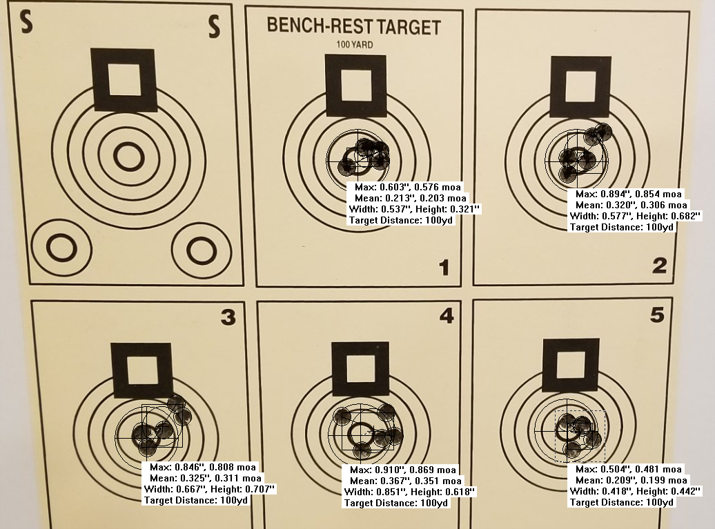

Photo not being totally squared up makes it a little goofy, but 9 ring is .9375 on 100 yard IBS. Can't argue with <= .5 on group 5... .717MOA avg for whole target and less than .25 offset horizontal and vertical both when averaging all 5 groups so you're zero'd up nicely
Wow, thats pretty damn cool how you anylized and broke down the data from these groups!

"OnTarget Precision" its not the worlds most elegant software but it works and its cheap. You can learn all sorts of things that make you ashamed of your shooting if you start tracking -all- the groups ;)
