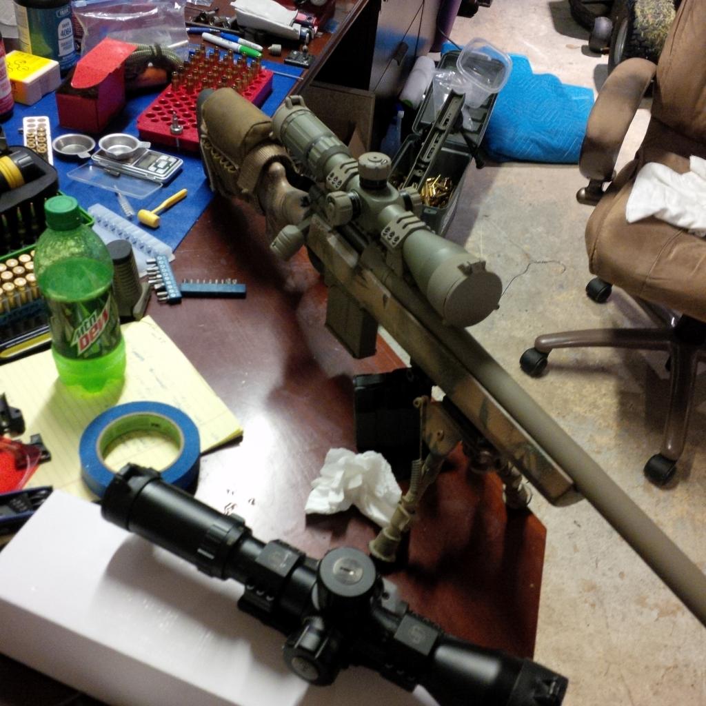

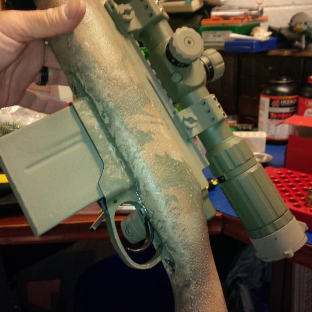

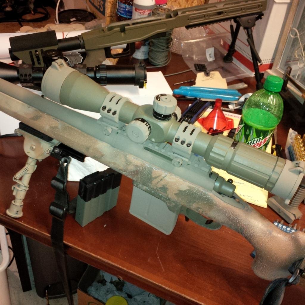

With my dremel, a 5/8" spade bit for my drill, some 100 grit sandpaper, a flat and round file and some patience, I got it done. It is very easy to take out too much of the rubber material around the inlet, so since the stock was already painted, I simply squeezed in a little waterproof/paintable caulk to fill in the gaps and then dabbed some camo over it after it dried.
Custom work? Hardly, but I don't have "safe queens" or show pieces. I am a function over form guy all the way. But I think it looks OK for what it is...a very affordable and desirable upgrade to a stock that you already paid for when you bought the rifle. I mean, for $99 (not incl the mags of course) and a little labor, you have a VERY lightweight stock with DBM capable of MOA or better with a little "stiffening". Anyway, if anyone is ever interested in how I did it (gotta have the spade bit), I will describe it in more detail...
