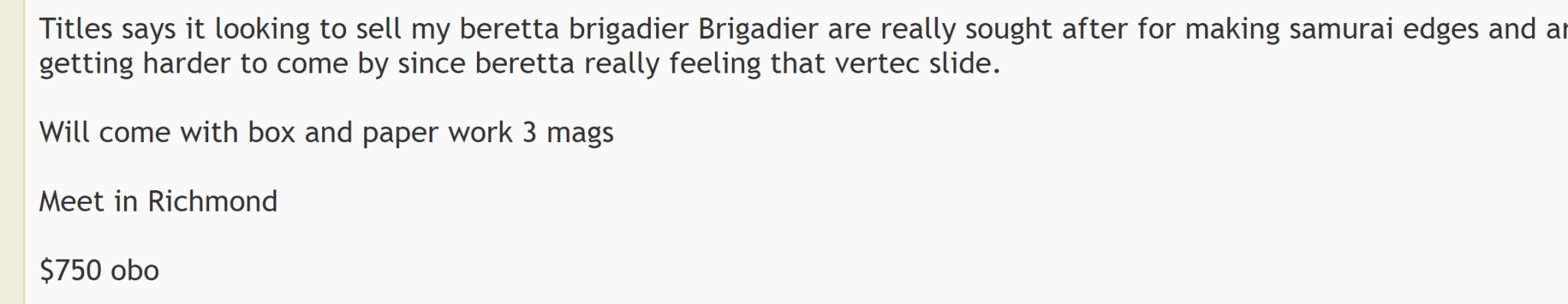

OP, get your $$$ back and buy this one, if youre interested Ill hook you up with the seller or you can find it on virginia Gun Trader under Handguns for sale.

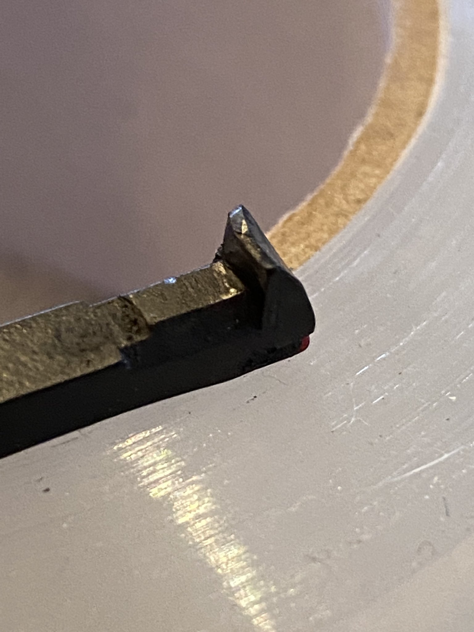

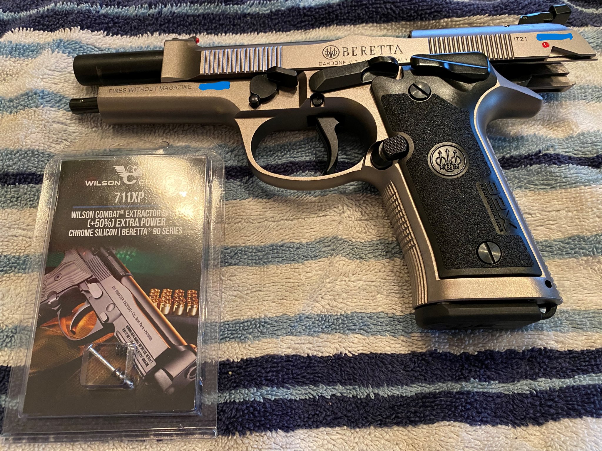

Update: The 92 is all better now! It extracts spent cases... who'd a thunk that was necessary?
I actually ended up doing the repair myself - found a YouTube video explaining how to deal with the staking of the pivot pin (which, to my surprise, consisted of ignoring that it was there in the first place and just wack the pin out as usual). Pin came right out with a punch and a couple wacks of a hammer with the slide supported on a role of mailing tape :sneaky: .
You can see in the close up of the old extractor what happened (sort of... hard to photograph): corner chipped. I am honestly baffled at how low quality the original extractor is. I mean it looks like shit. The replacement I put in was machined smoother, the chamber indicator red paint actually exists, the extractor claw is more defined, etc. Like WTF Beretta? Talk about "top notch" quality control.
Still going to see about making an aftermarket alternative with some design changes (in particular an improvement to the chamber indicator) and hopefully a better quality metal - like whatever Wolverine's claws are... something like that. Don't want anymore effing problems!
Decided to install the Wilson Combat +50% extractor spring and their fluted steal guide rod (replacing the factory plastic one). The factory spring seemed fine but with the Wilson spring... I wanna say the gun is extracting better. It's certainly shooting out the spent case farther than it did originally (I think, anyway). What's obvious, though, is the gun cycles notably smoother by hand with the metal guide rod! Love that.

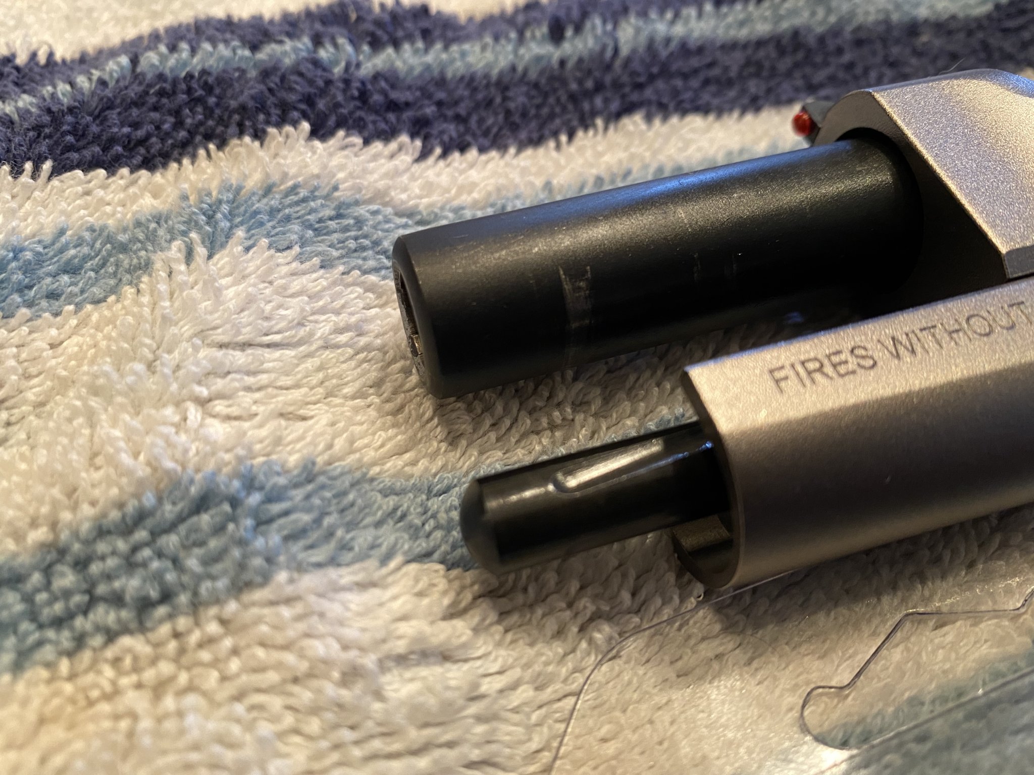

Beretta 92 comes with a plastic guide rod? And that crappy extractor? That really sucks for the amount of money it cost.

The first release of the 92x Performance had a steel guide rod, mine did anyway. If yours came with a .25 cent plastic one that's more proof of Beretta's lack of product awareness and what consumers consider a "high end" handgun.......... incredibly dumb on Beretta to save a quarter on an expensive pistol:mad:
Consumers are retards, I still wanna know what kind of ammo he was running because I've never seen a broken extractor that soon even on a hipoint. I don't own a beretta 92 either, they feel weird in my hand, something just seems fucky about this thread though.
It has a plastic rod to make IDPA max weight. The gun was released for IDPA competition and barely makes the cut. No IDPA I’ve ever been to has ever weighed a gun, though. 🤣

@BCP For effing sake, dude... there's literally pictures of my gun and the extractor failure was real.

There's even a picture for those of us that can't read good.

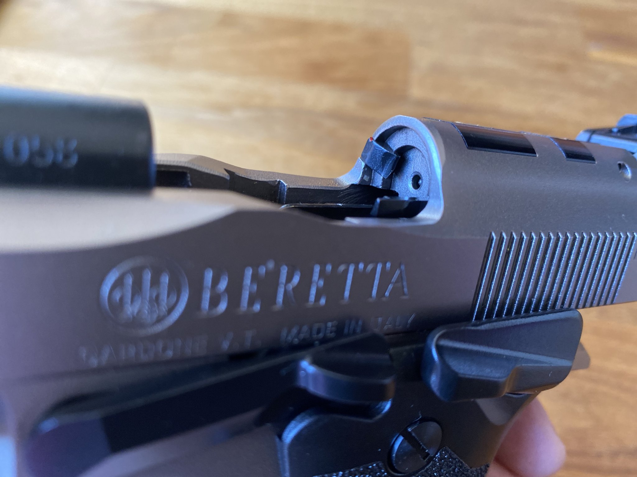

I don't want to join a Beretta forum or some crap so I'll just bitch about this here. Purchased my Beretta 92X Performance Defensive on December 6th. Went to the range, got used to it. Shoots great. Go to an IDPA match, first time bringing the 92X along. All goes well until round three. It starts stovepiping everything. Can't extract. Gun totally locks up. I have to do some finger gymnastics to get the spent case out of the barrel while pressing down on the next round so it'll just... cycle.
Show the gun to the guys, one of which is a gunsmith, and he immediately points out my extractor's claw is cracked/bent (see photo). After no more than 100 rounds.
Of course the pivot pin that holds the extractor in is staked, so it's going to be a pain to remove but... I can live with that. But... after calling Beretta to find out what they're going to do to make this right, they inform me I either ship my pistol in to their service center (at my expense, which would cost 5x more than an extractor part) or they'll send me an extractor. I chose the latter. Then she told me they're on backorder potentially for the next 4 months. Fuh-king-great! There goes IDPA. I guess I save ammo?
So I'm like... how about we just replace my pistol since I haven't even gotten past a few boxes of ammo and a month with it before it failed? She's like... well, you'd have to mail it in and we'd opt to repair it first. I say, yeah but you don't have anything to repair it with so how exactly is that going to work? She says they'd hold on to it until the part was available. Right... so not only will the part not be available for some odd amount of time but you'll be in possession of my $1,500 gun? I think not.
