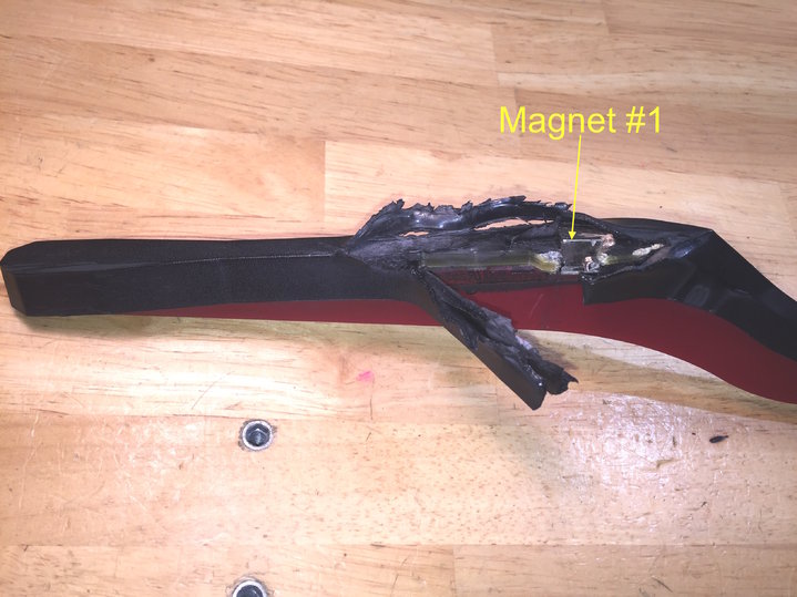

First MV was 2647 fps. Then I field stripped this V3 with a .308 on the 2nd shot.
Note to self: double-check tightness and alignment of all prototype mounting points after first shot.
