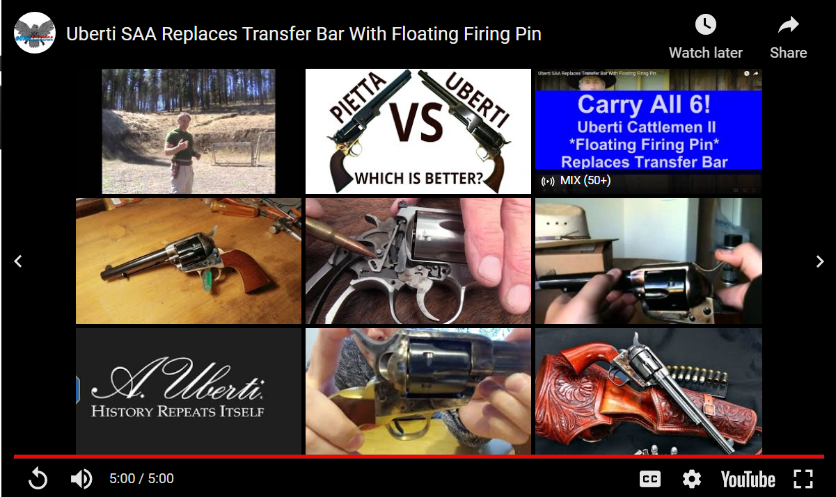

Pietta has been around for quite awhile, and has produced many SAA clones without the transfer bar. You can still purchase non-transfer bar models, and most people prefer the non-transfer model.
So I'm still curious how the nomenclature used by Pietta reflects the difference.
Second, is the difference the "floating firing pin" as used by Uberti?
