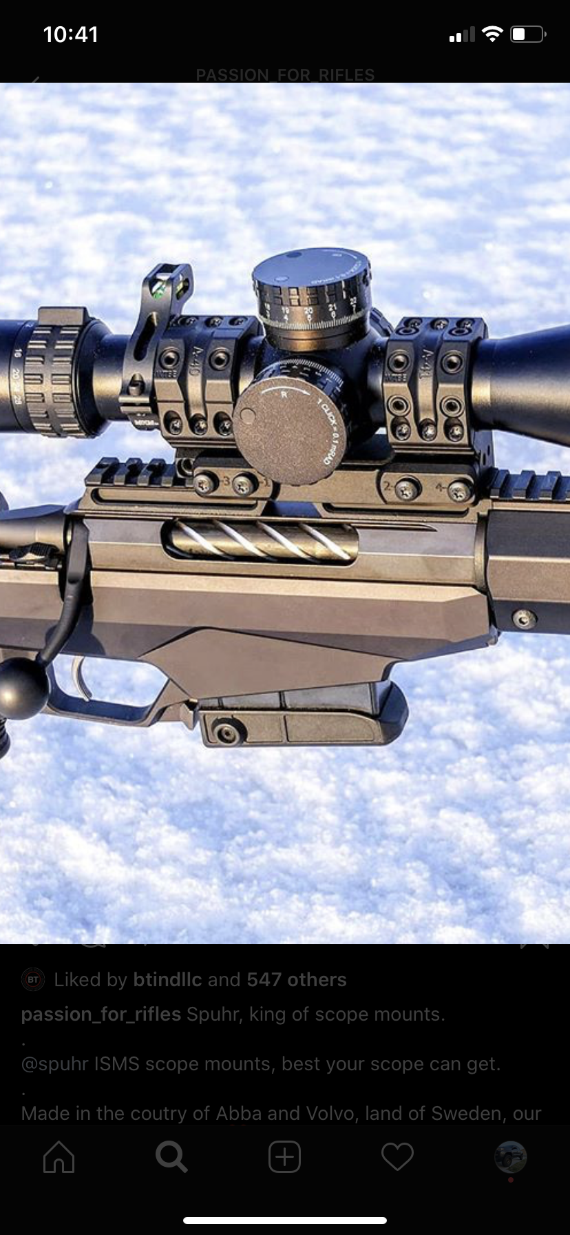

Hey guys,
What do y'all know about compatibility with the Spuhr SP-4601......The turrets looks kinda fat and chunky on this bad boy and I wanna make sure they'll clear the rings before I purchase.....Thanks guys...
Hey guys,
Plenty of room. I included a picture from passion_for_rifles on Instagram also known as @viking78 On here.

Hey guys,

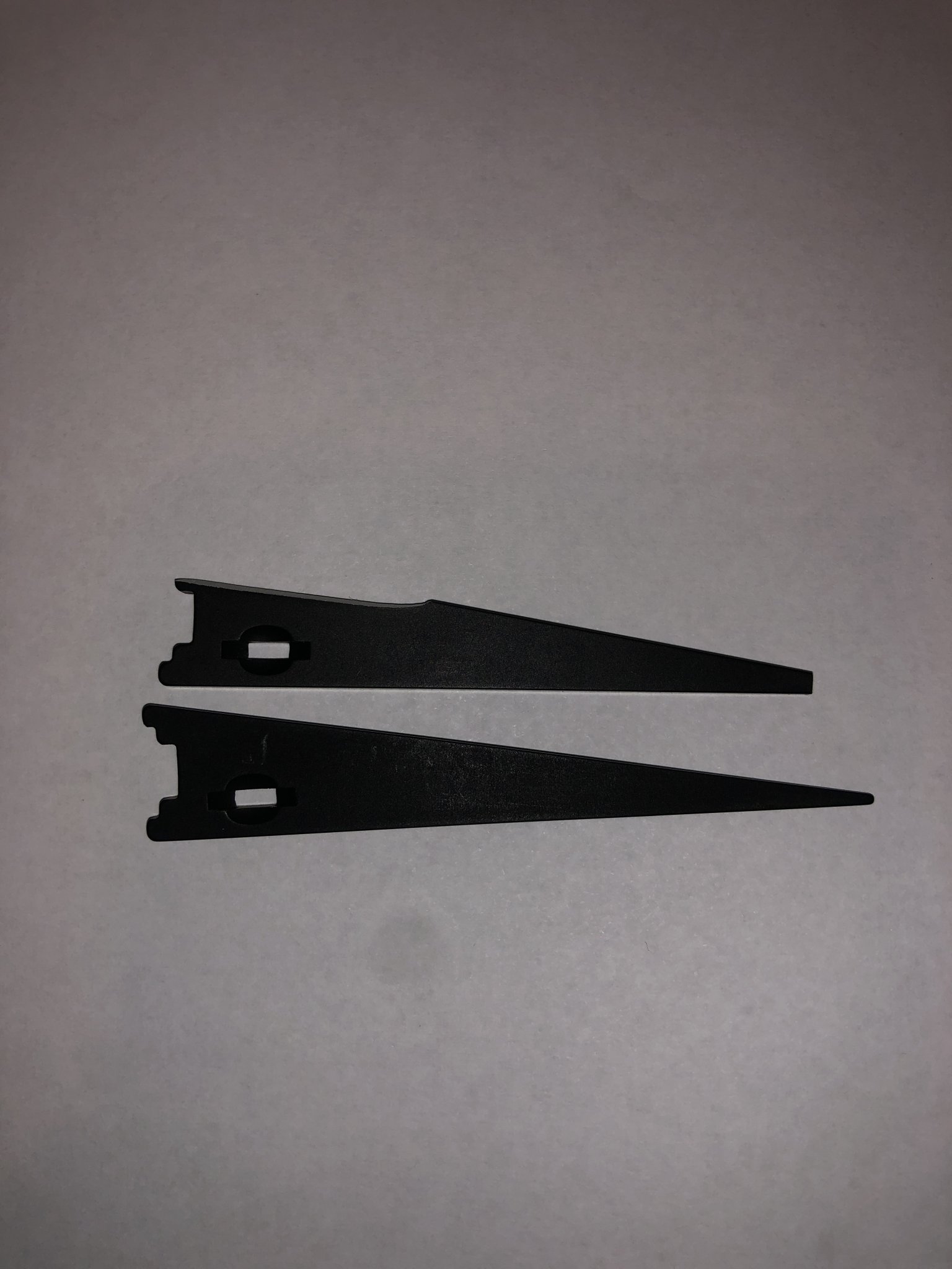

Only thing I know of that will be an issue is the leveling wedge. If you decide to use it to level the M7, the wedge will need to be modified to clear the parallax knob and maybe the windage knob. Using the wedge to level mine in the SP-4302 I had to modify both ends to clear and sit flush with bottom of turret housing.
Yup... 2nd that, 😉. Your “modifications” look allot better than mine, though. Glad I have several extra Spuhr wedges laying around 😳
