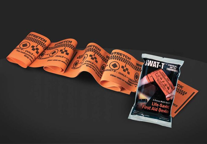

    While the other guy was taking care of psycho my coworker tried to use the SWAT-T we are issued.
    His hands were so covered with blood he couldn't open the plastic package.
    Luckily shooter took quick care of business and was able to apply a TQ.

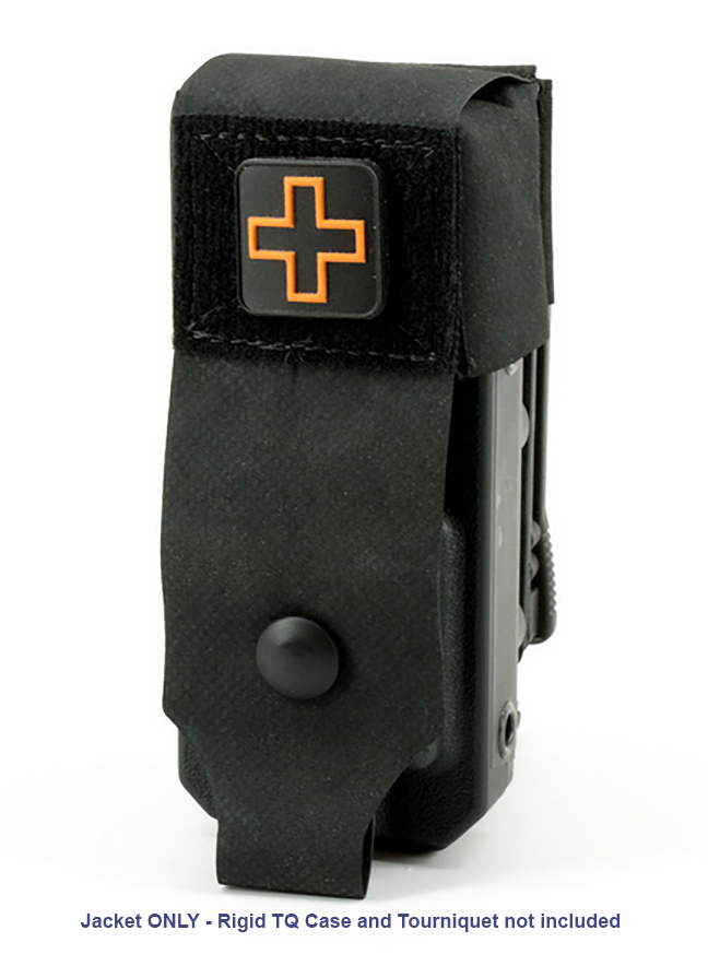

    I tossed an extraneous piece of gear from the belt and made room for an Eleven10 hard case TQ holder with a real SOF-T wide TQ.

    The SWAT-T we are issued is a rubber exercise band.
    7080627
    I think it would be okay to create a pressure dressing but it goes a bridge to far to consider it a TQ.
    Its design almost calls for it to stay in its manufacturers packaging to protect it from sun/filth as well to prevent having 6 feet of rubber band tailing you around.
    TQ I carry in the Eleven10 case is staged to deploy, no plastic or rubber bands. Anyone considering one also look at the tear away top cover to keep the TQ from being worn while being worn.

    And that issued rubber band is like tits on a boar for actual TQ use you are right.
    Your dept is opening themselves up for losing a guy....... between crap product and having to keep it in packaging.

    Nah I didn't mean dirty application . Torniquets have velcro which is a man made shit magnet . I meant that if you have to carry on your kit exposed a cheap sandwich baggy will keep it clean until needed and is easy to acces as opposed to heavy plastic wrapping from the manufacturer .
