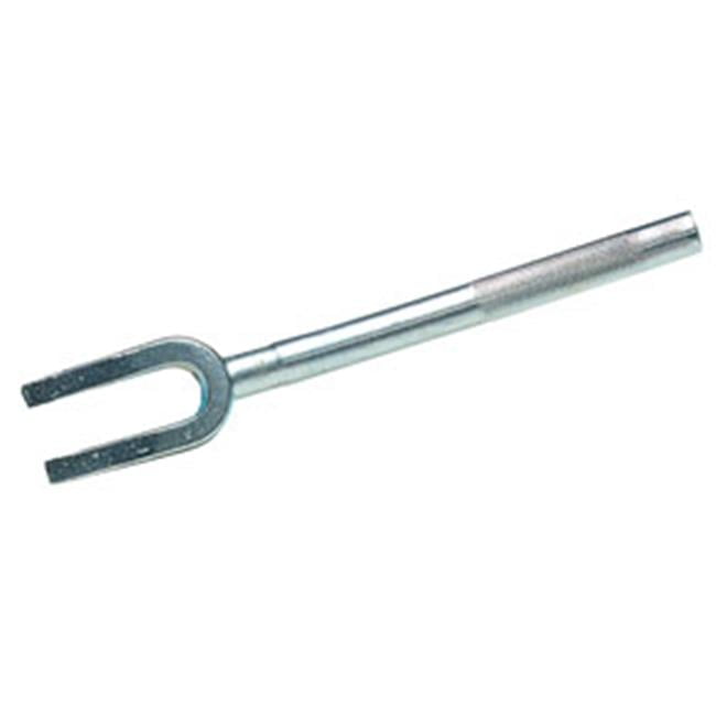

I do construction for a living and haul a lot of heavy trailers and so get rims stuck regularly from all of the heavy breaking and heat it produces. I too have tried everything from a 2x4 being held against the rim and smacking with a sledgehammer (and tire), heat, penetrating oil blah blah blah, they work usually but I now have defaulted to using a ball joint separating fork. This tool is the most reliable method I found.
Wedge it between the back of the wheel and the brake rotor and smack it hard with a regular old framing hammer (You usually have to hit it multiple times to break it loose, emphasis on hitting it hard). I've had it so long I don't remember where I got it but it looks like they have them at Walmart. I'll try to post a picture for you, I left a link below.
The only problem with it I could see would be on some wheels It may not fit between the spokes, but I've never had that problem as of yet. Feel free to DM me if you have questions. Good luck brother!
