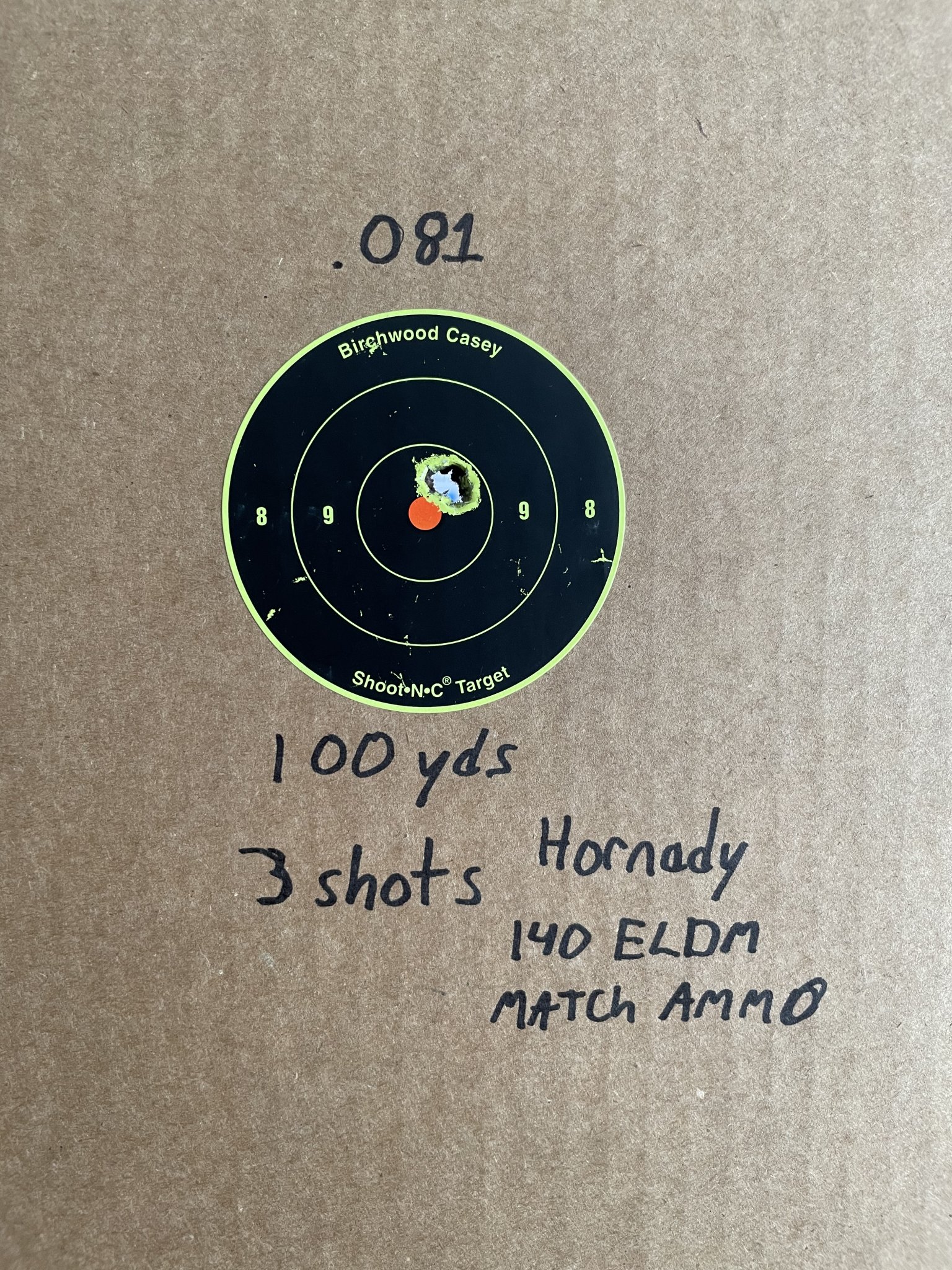

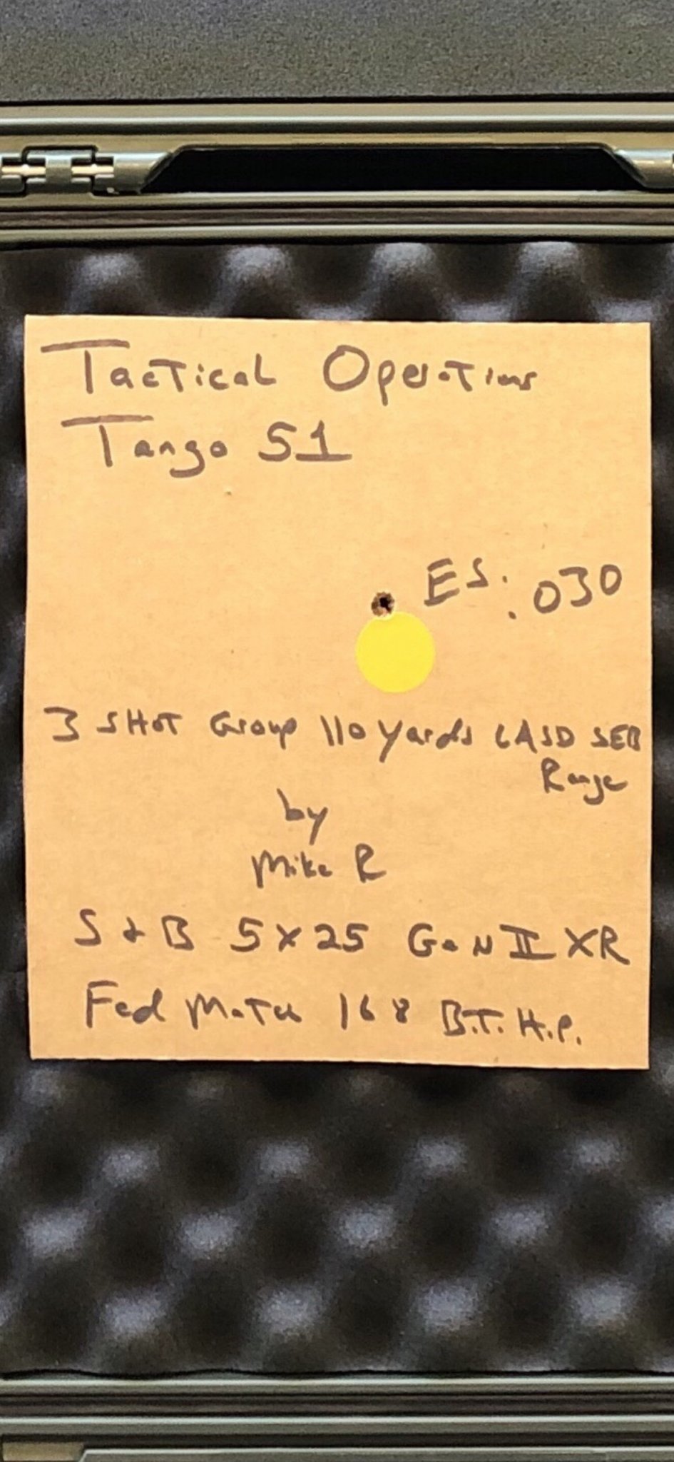

That many guns and 3 shot groups. It does show consistency but not 1/8moa.
If I recall correctly I posted that because of the debate on 5R rifling and 4 groove rifling and the 5R wouldn't do 1/4moa with box ammo.
That all being said....and I don't care if it's 1/4moa or 1/8moa. You want to put a guarantee out there you have to back it up with some data. Show me a rifle that will shoot 25 rounds and the average group size works out to even 1/4moa fired back to back in one sit down. That's killing the target and you can say you have a 1/4moa rifle.
I know how ammo is tested. If you find a lot that will give you sub 1/2 moa and do it consistently in your rifle. Buy a pallets worth.
You build a qty. of guns and get 1/8moa consistency out of them.... I'll tip my hat to Mike and Terry.
If you take one gun....and everyone has what is called a wallet group....but when I see a rifle that will stack 5 x 5 groups and agg a .125". Take it to the benchrest nationals....you will clean house.

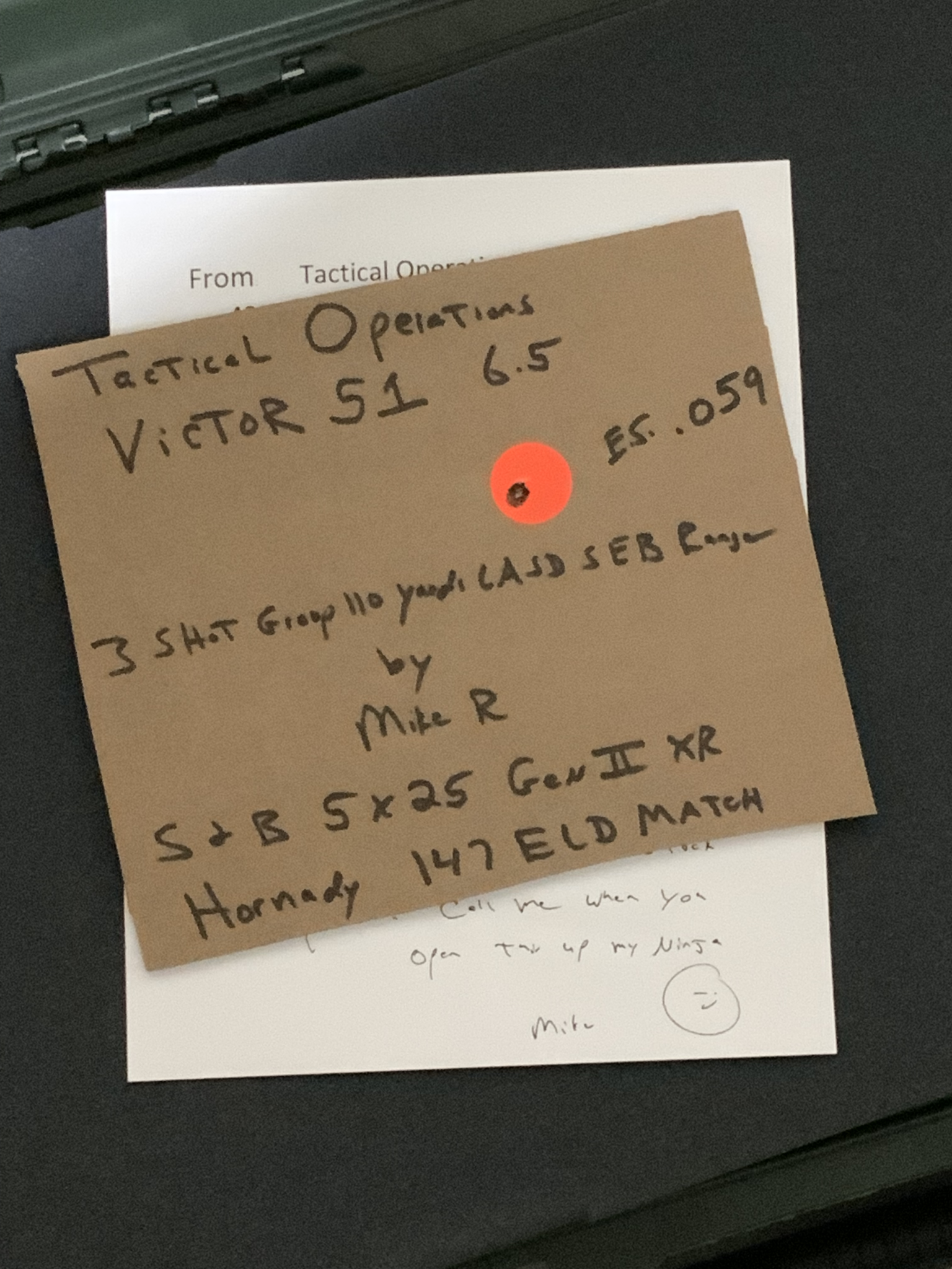

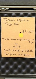

A real quick point about guarantees because we have already been through on here with Mike 15 years ago.
At that Time GAP was huge on this site, and through that GAP Pack connection Mike was ridiculed over his guarantee, to the point Rogan called Federal to get them to say they won't guarantee Gold Medal Match. Well the end results is, they were wrong and Mike was proven right.
Accuracy guarantees can absolutely be given because nobody says that guarantee is "your" guarantee. It's the Rifles promise when it left the shop it could perform to a certain spec. Mike Provides the Target, he usually provides more than one target too. So the idea you can't do this is completely false.
I used to "proof" AI Rifles for MHSA, would take them to the indoor range one exit up from their shop, and perform the departments required proofing. That might mean, 10 rounds with no suppressors and 10 with the suppressor, they re supposed to be "X" in size in order to pass the spec the individual department requires. It's like a guarantee, and it helps diagnose things when Shooter B can't match the spec.
Sure there are a million variables, but we all shot groups everyday and know what consistency looks like. But trust me, we went down this Mike is lying, No Guarantees, ammo won't hold, shooter can't shoot, well I have a dead prairie dog at 935 yards that says Mike's Rifles are plenty Accurate for me with factory ammo.
The proof is in the execution, if you are happy with your execution, and the rifle performs to your spec, drive on my friends

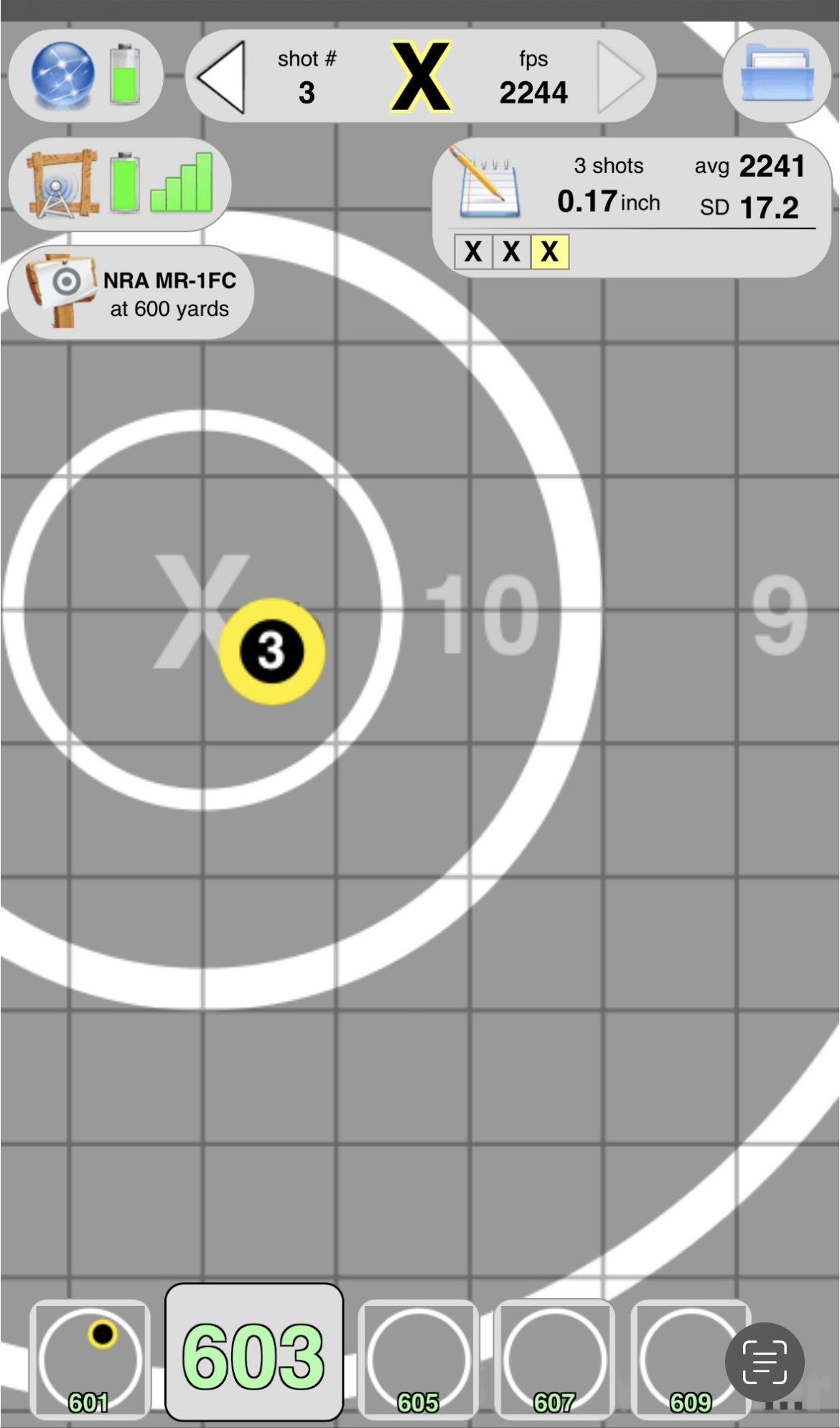

I don't know this guy from Adam, but his performance requirement is 2 inches or better at 600 yds for 10 shots. Mathematically speaking, his 3 shot groups should average less than 1 inch... which is like 1/7 MOA. There's also an interesting discussion of stats and relevance, etc.
Plain link:
Whole thing is worth a watch just to rustle jimmies for the "look at my SD over 3-5 shots" crowd generally ;-). Grouping comes up around 3:40 or so.
