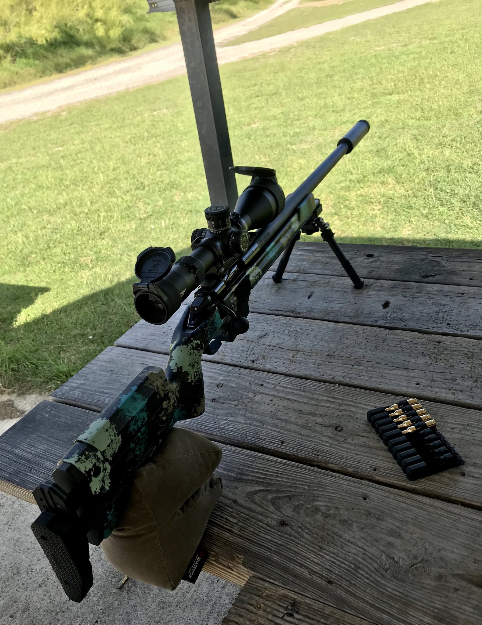

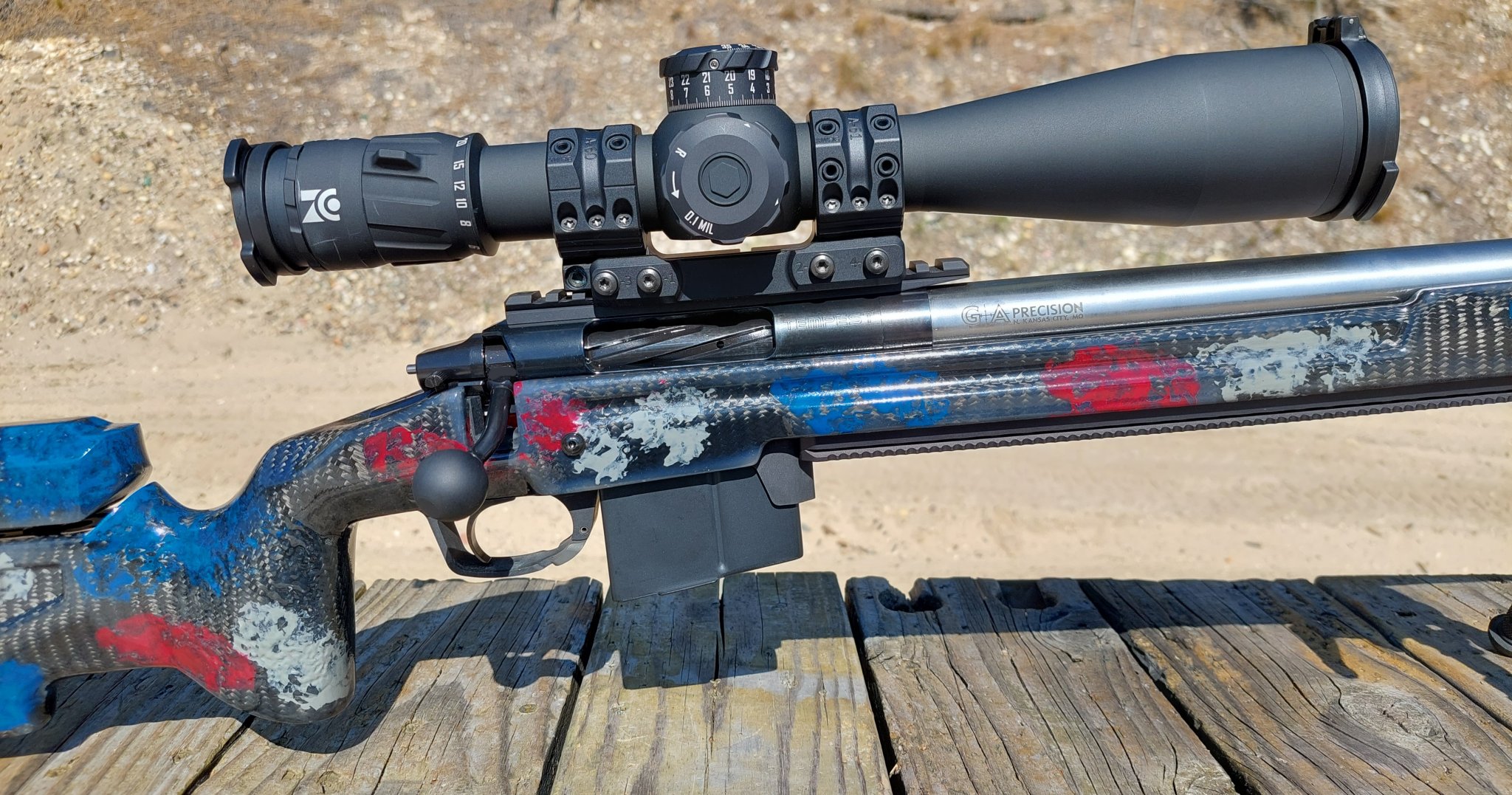

Shot it today!
Nice builds always wanted a Tempest so I ordered one and picked it up on Friday. I dropped a trigger in and whoa is that cock on close something to contend with if you don’t operate the bolt with authority. I dropped a Bix and Andy Tacsport pro in it with the Bullet Central trigger hanger and it is stiff to say the least. I watched the video of George operating his with one or two fingers so I am hoping once I get a barrel and some rounds through it, that it will become smoother.

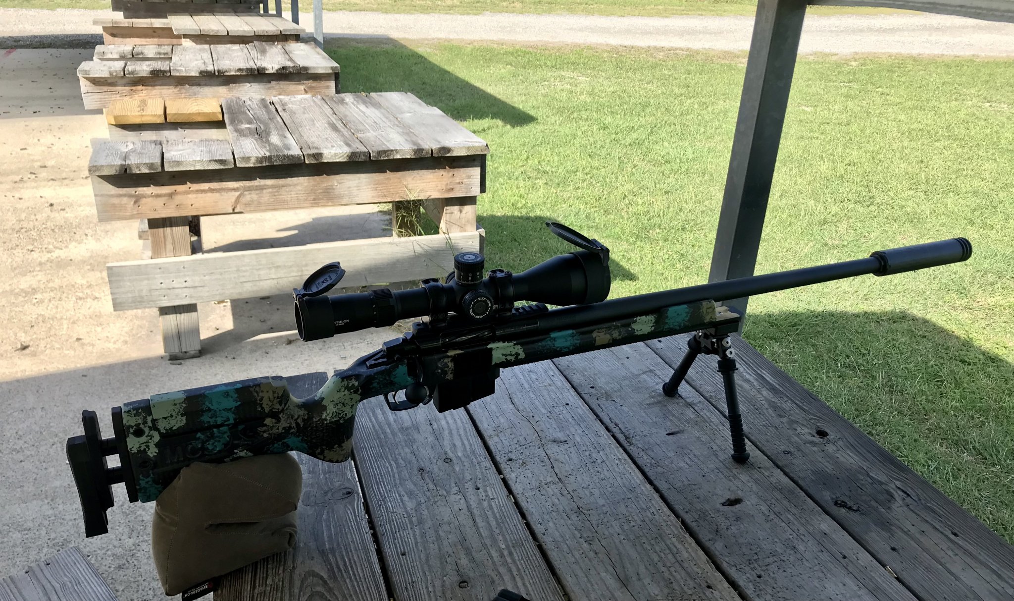

First off I would like to say the folks over at GA Precision were very helpful in getting my trigger issues sorted out. I figured while it was there I might as well have them spin up a barrel in 6cm, and I must say that this rifle is a hammer.
